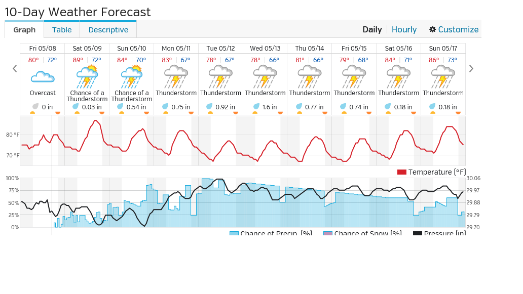

Lol wow I'm still amazed there is snow out in Arizona! Here in Oregon we normally see lots of rain right now but we not getting it for the second year in a row. The jet stream is pushing down further and missing us.
Found it! 2 weeks of rain. We are lucky to get 2 weeks all year!

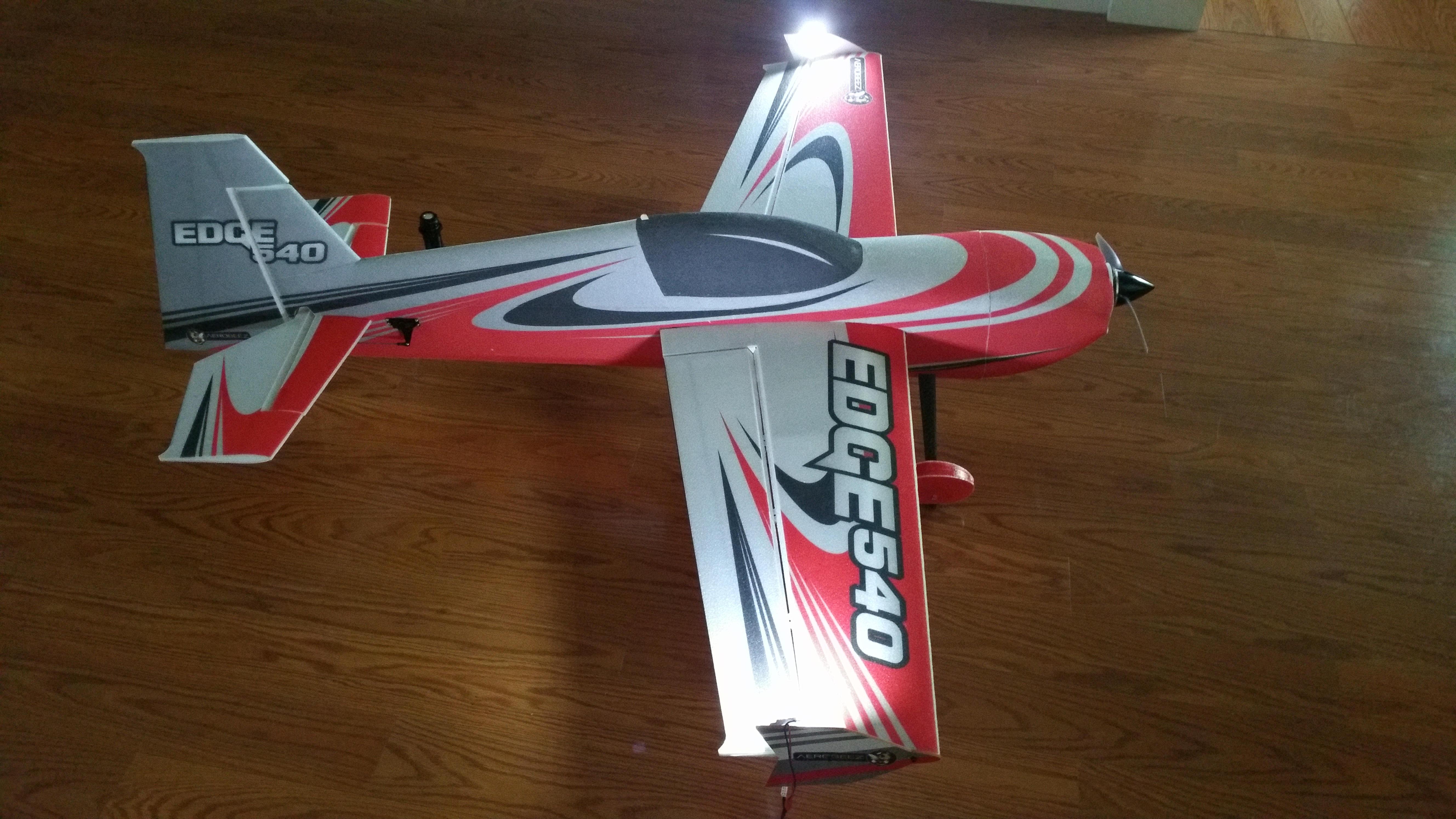

Bad weather means I get bored and do projects... So lights are going on the 55" Edge so I can fly when there is no wind . I have never done this on something big so we will have to see how it works. Making some little posts to stick them on instead of the sfg is probably in order but they seem plenty bright.

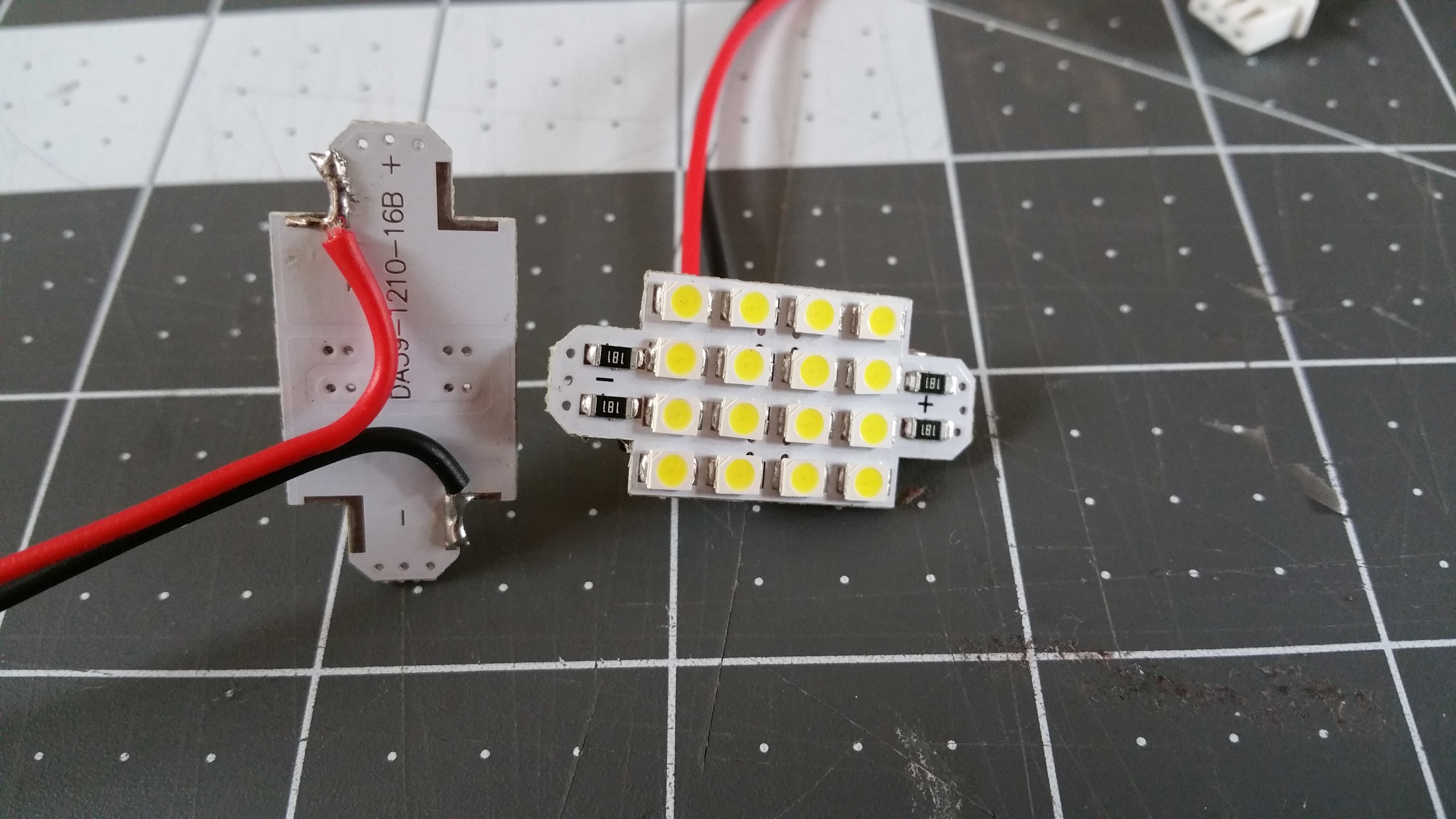

These are the lights:
2x 42mm Car Interior 16 LED White SMD light 3528
http://www.ebay.com/itm/2x-42mm-Car...-Dome-lamp-Bulb-211-2-578-212-2-/121195366780
There are lots of sellers for these, and there are a variety of bigger and smaller sizes and 10-20 packs for around $20. These are 25 lumin.
I just carefully cut the metal connectors off and soldered on my own wires.
Resistors are built right on and there are 2 solder points on each terminal. I just wired them all off a little 2S in parallel. I did it off a 2S battery while I was testing ... a 180mah ran 4 for about 15 minutes and the resistors didn't even get warm (it isn't noticeably brighter on 7.4v 2S rail vs 3S). 3S is too much for them though ... resistors get hot in a couple minutes ... not quite sure how these are actually 12v unless they plan on them being intermittent usage. An epoxy dip will help act as a heatsink and make them waterproof.
The Aerobees side-force generators screw on ... so I'm going to get some clear plastic board to make little posts and screw them on the end (with or without the SFG).
Size of the actual board is 16mm x 33mm and the led block is 16mmx21mm. They weight pretty much nothing and I'm going to outfit my Crack Pitts with a couple.

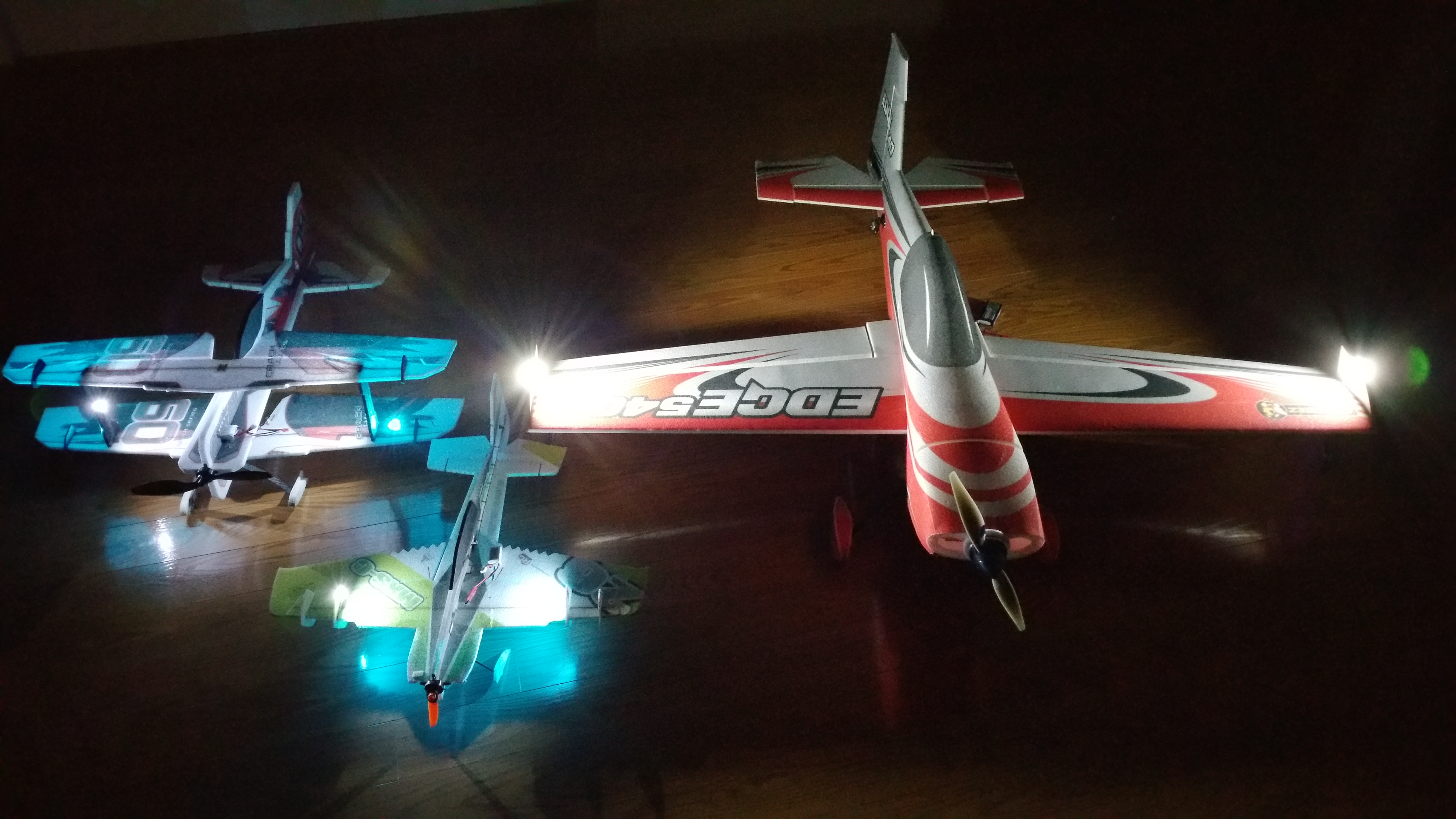

[MENTION=4]3dNater[/MENTION] Here is a night shot with a Crack Pitts and MSXc mini lit up for comparison with TwistedHobbys setup. Plenty bright enough if you keep it close. The left side of the Edge is 3S and the right is 2S. I only have the top set installed right now. No real difference. uploadfromtaptalk1431152707562.jpg
