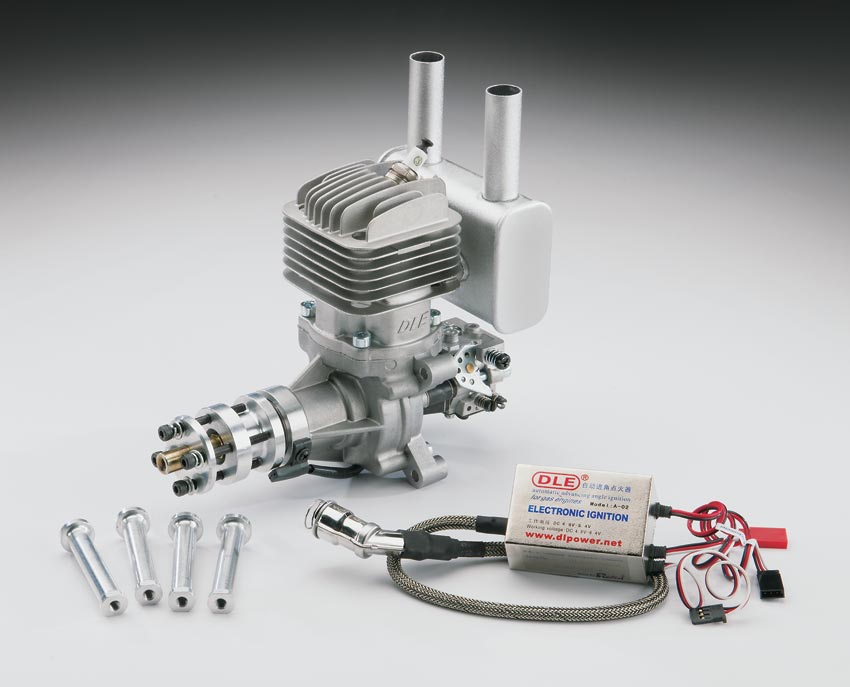

I appreciate that petrol engines run hotter than other IC engines but when I purchase the engine the flexible exhaust manifold was wrapped in what looked like ordinary PTFE tape. The engine has had about 3/4 gallon of fuel through to date (30:1 mix running Xoar 19x8 prop) and this tape has burnt off and needs replacing.
Can anyone tell me is what type of tape it is best for the job? I assume it might a high temperature version of PTFE but then I ask the question why has it burnt off after so few flights? I would like something a bit more permanent. Any help would be appreciated.
3dmike
Where did you get the flexible exhaust manifold? It should have come with a standard rear muffler like this. Maybe you're using a silencer/pipe?
Xpress
Usually when headers crack open or tear we like to use this stuff called "Rescue Tape" or self fusing tape for an almost permanent fix to the teflon tape peeling away. I use it on my giants and keep a roll with me just in case.
