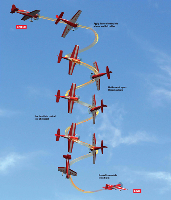

Knife Edge Spin from MAN
This is how I do it: down EL with Rudder same direction as roll, in the case of the pic, left. Then, inverted blender, which would mean switch rudder from left to right.
