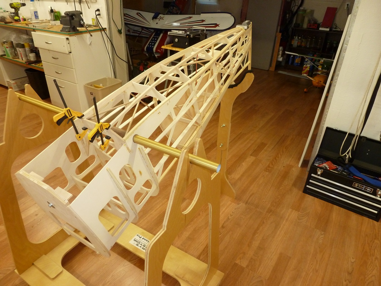

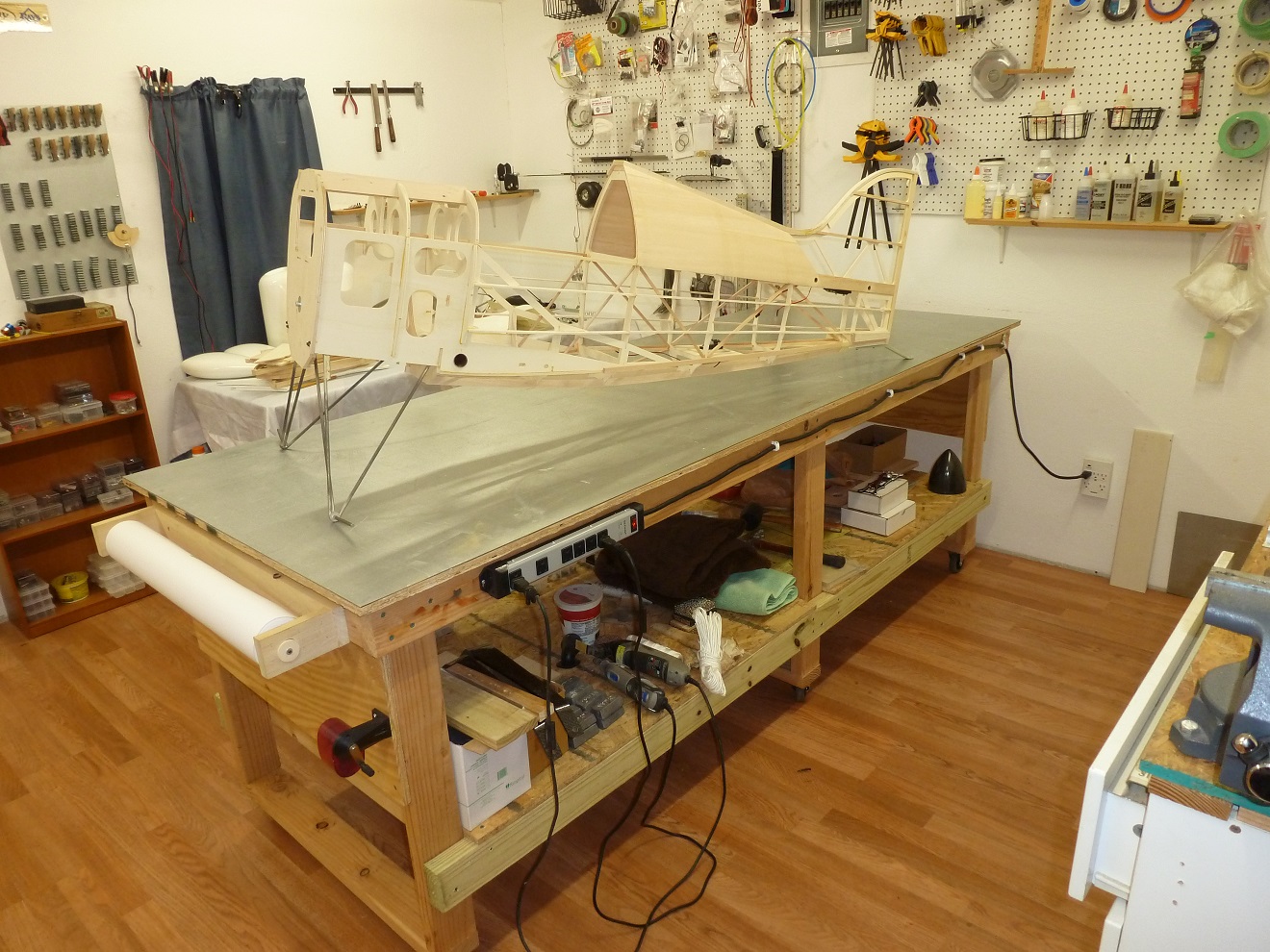

Things cured up enough to get it on the stand and install the stringers and tailwheel ply. I think I'll go ahead and put the legs on it before moving it aside for the wings.
