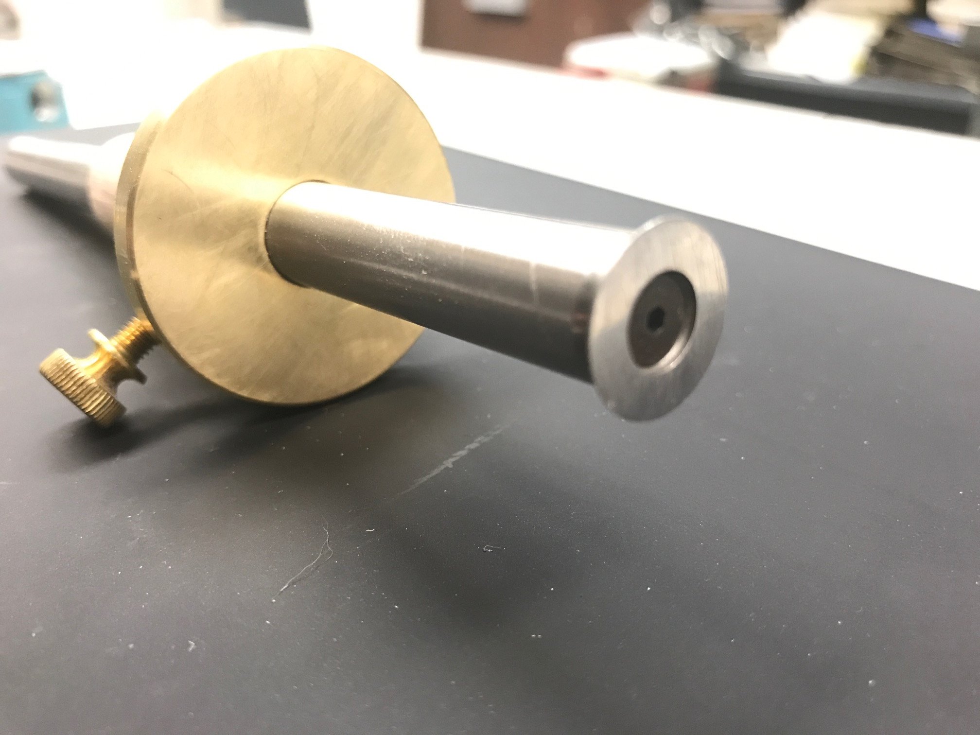

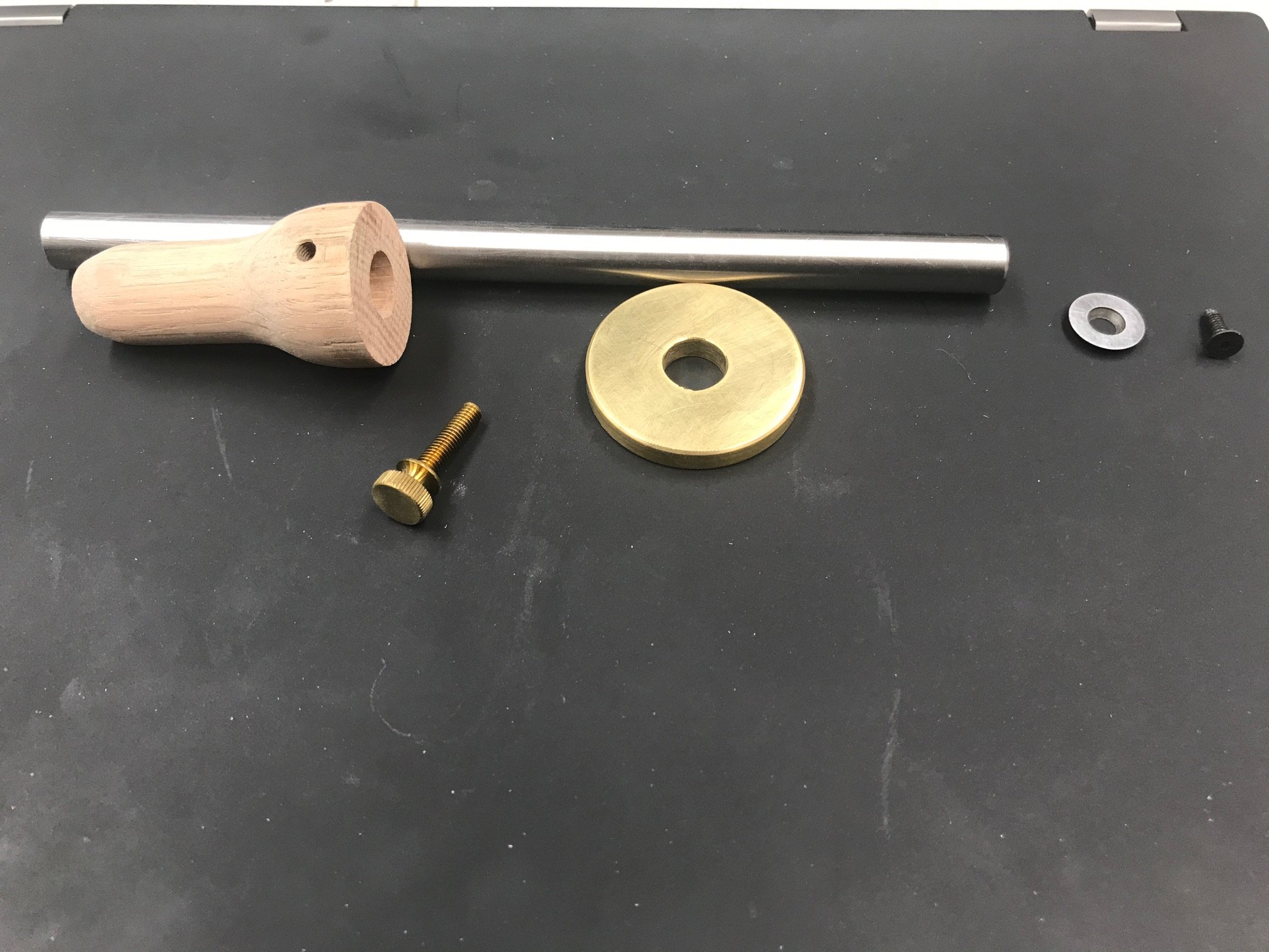

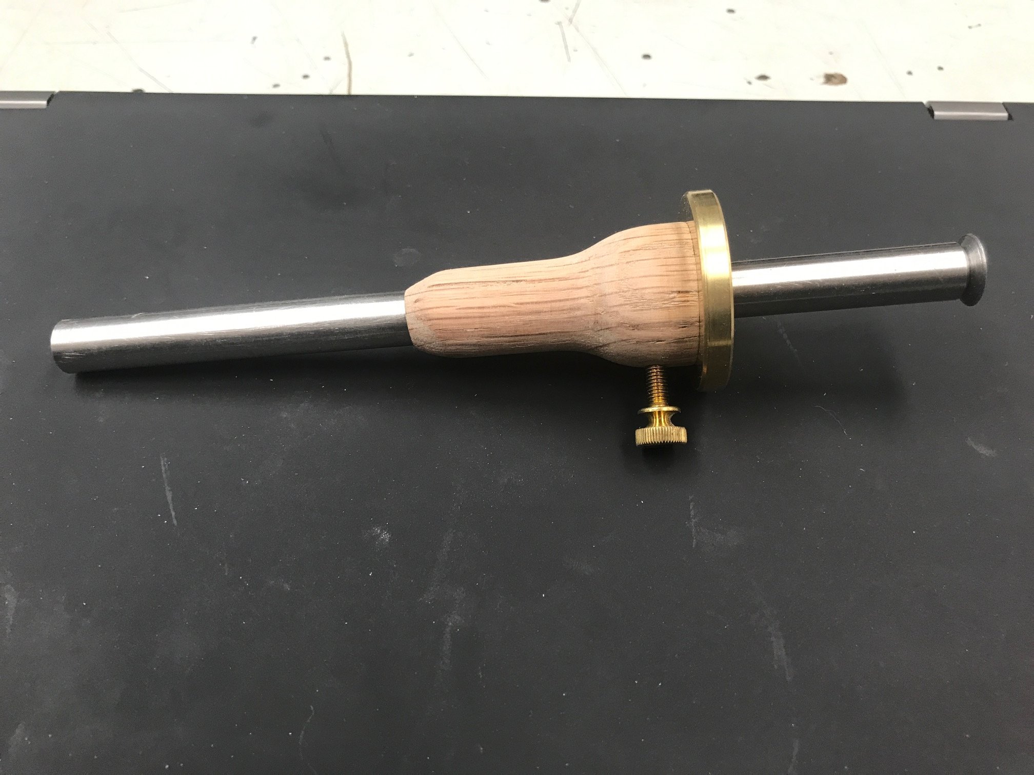

Still need to epoxy the brass piece to the wood and apply a finish to it but other wise it is done and I'm happy with it. Most proud of myself for making the blade myself.
Ok, I’m dumb. What does it do, how is it used?
Loosen the set screw and adjust it for the depth of say the tails on dovetail joints. Tighten back up then you can scribs a line on you piece of wood. Better than a pencil as it gives an actual groove for your chisel to rest in when doing the final clean up with a chisel.
Alky6
Thank you. Makes sense now.
