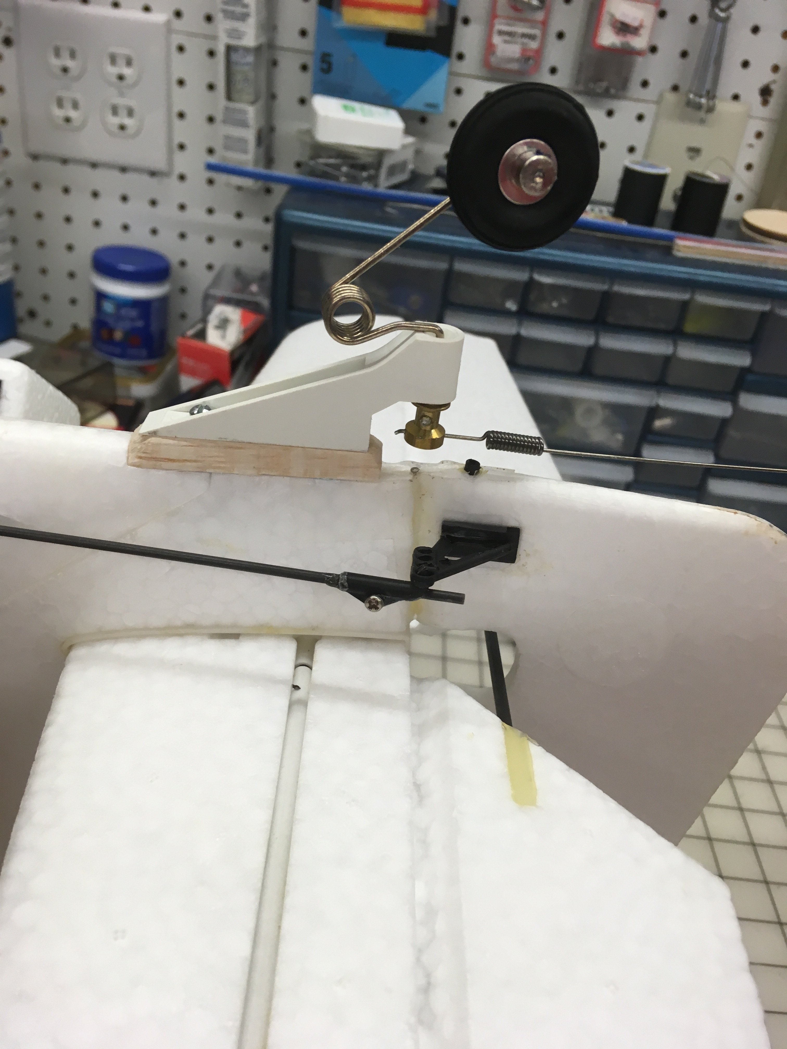

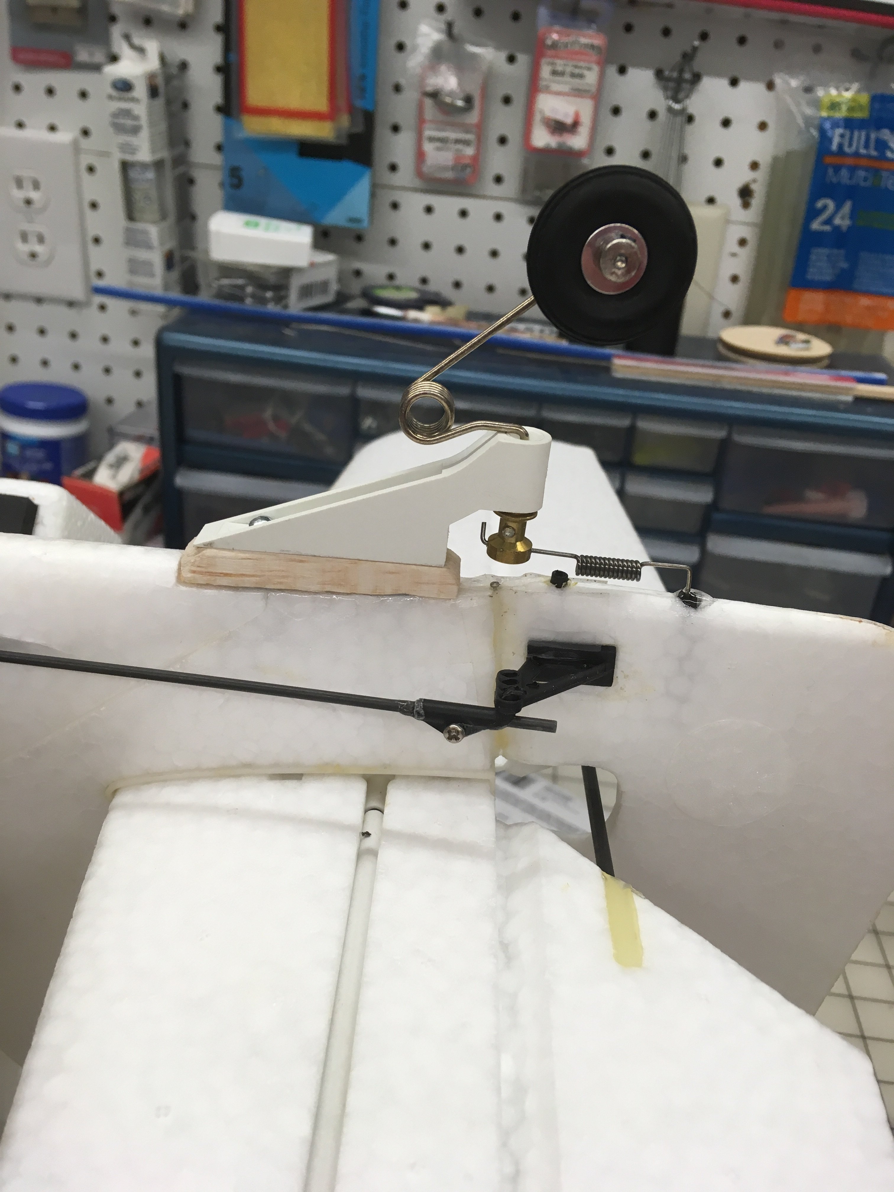

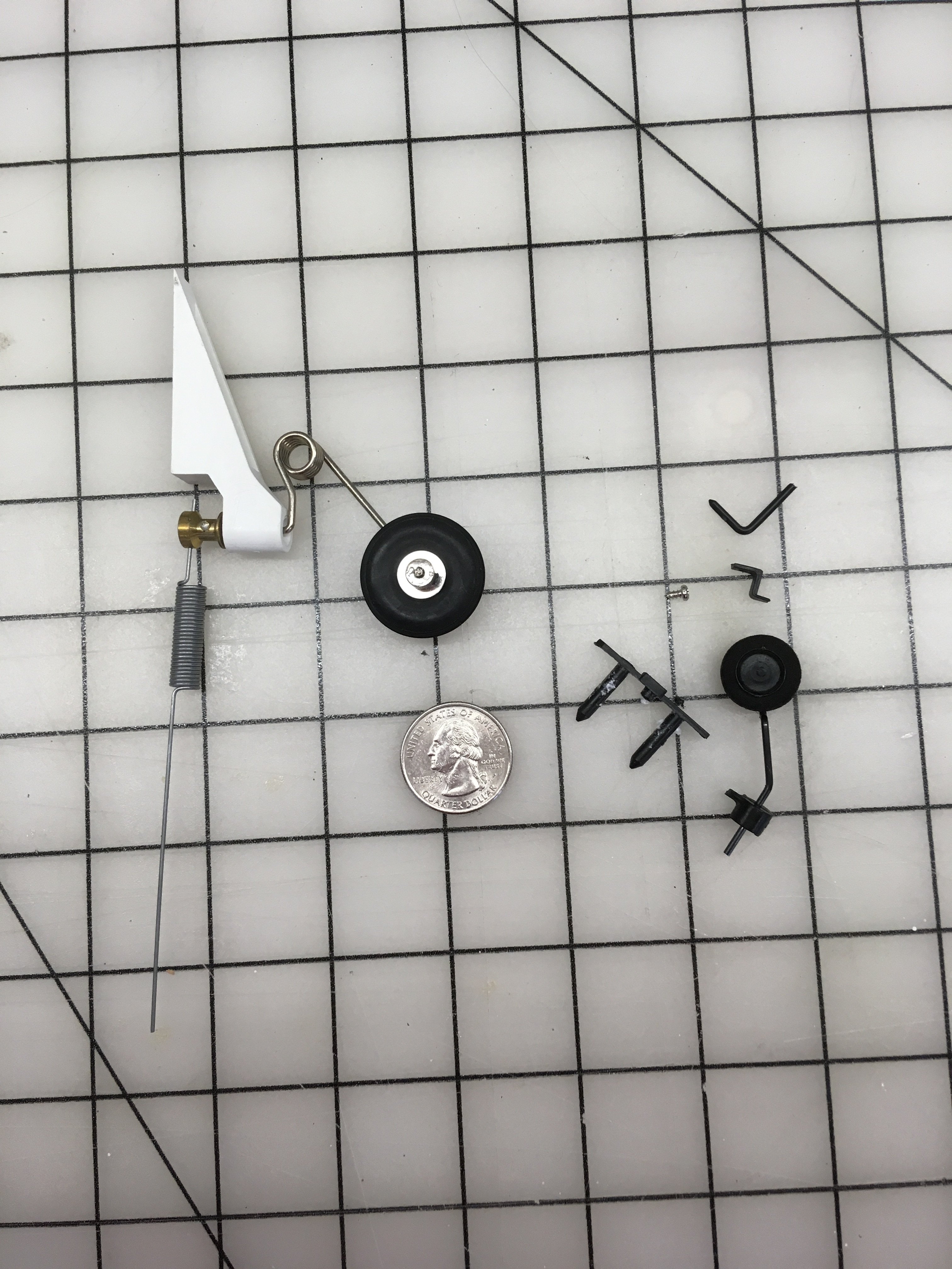

The puny tail wheel assembly on my Flyzone Switch finally gave up the ghost last weekend. So I decided to replace it with a Sullivan Tail Wheel Assembly.

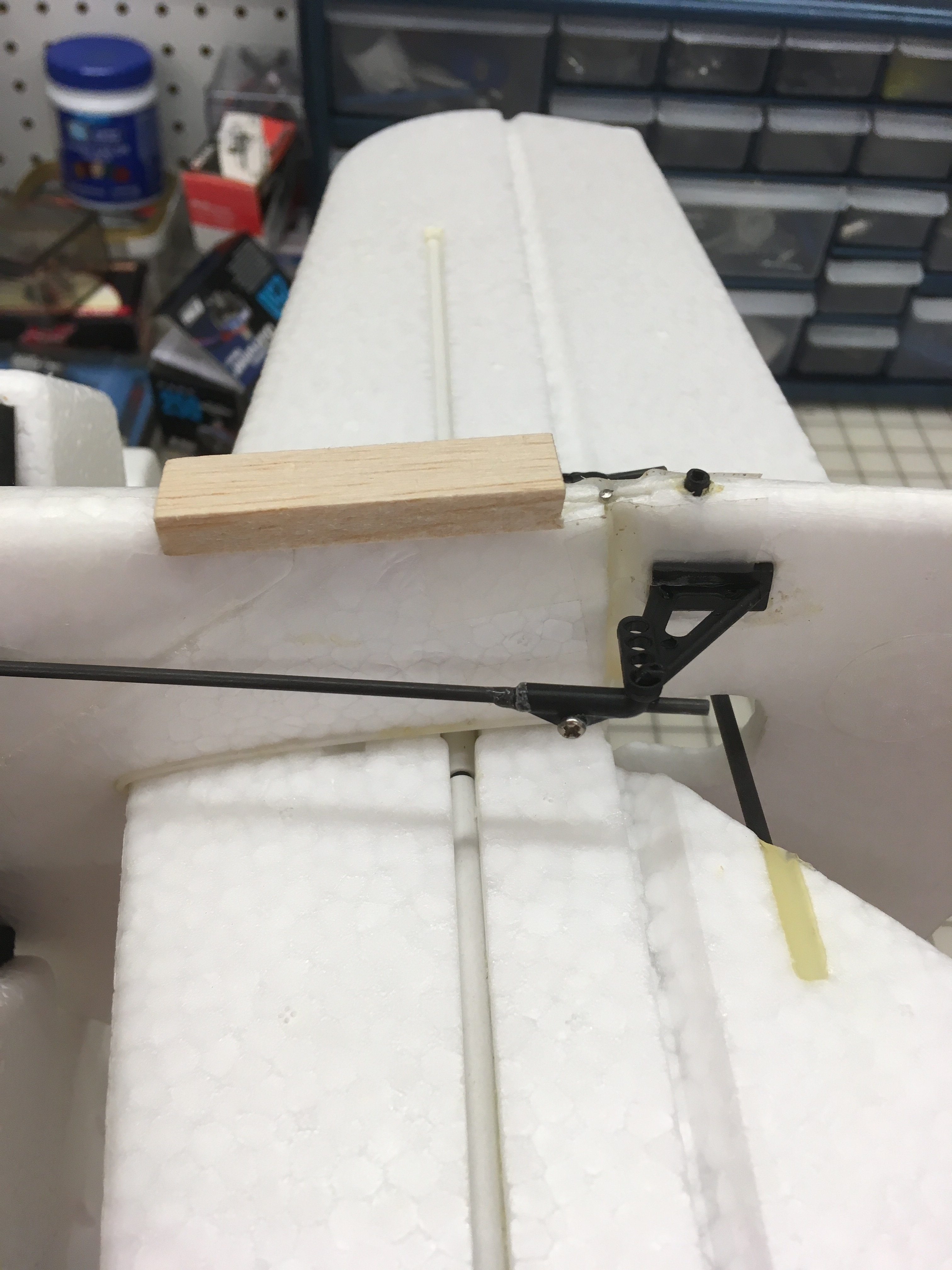

Had to use some balsa to beef up the mounting area. I think it will work well.
Used some E6000 glue to hold everything together. Hopefully it works out well. For a cheap little foamie, I really love flying this thing. Had it for several years and it’s still a hoot to fly.
