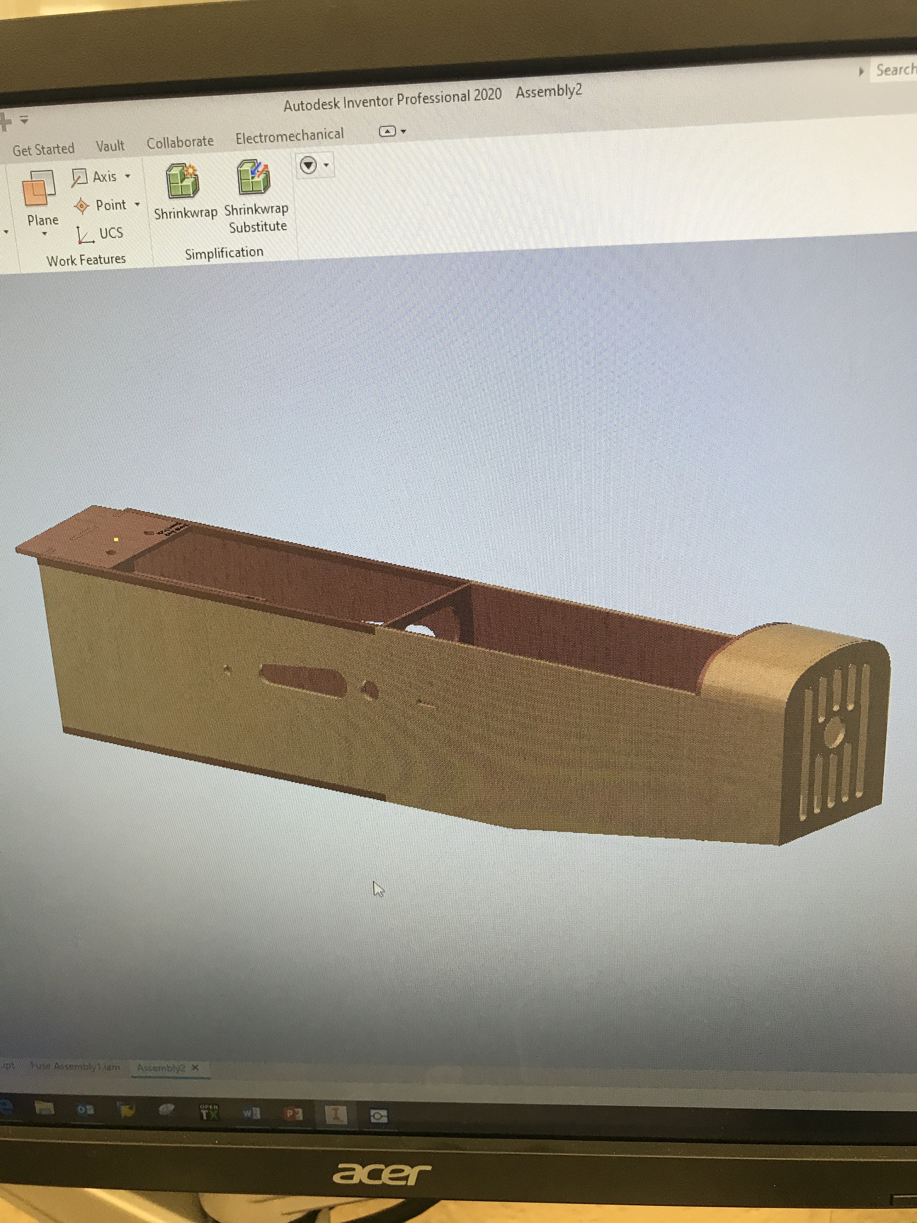

Photo of where I got on the fuse today. Tomorrow I will try to finish up the hatch tomorrow then I can start filling in all the sticks in the tail.

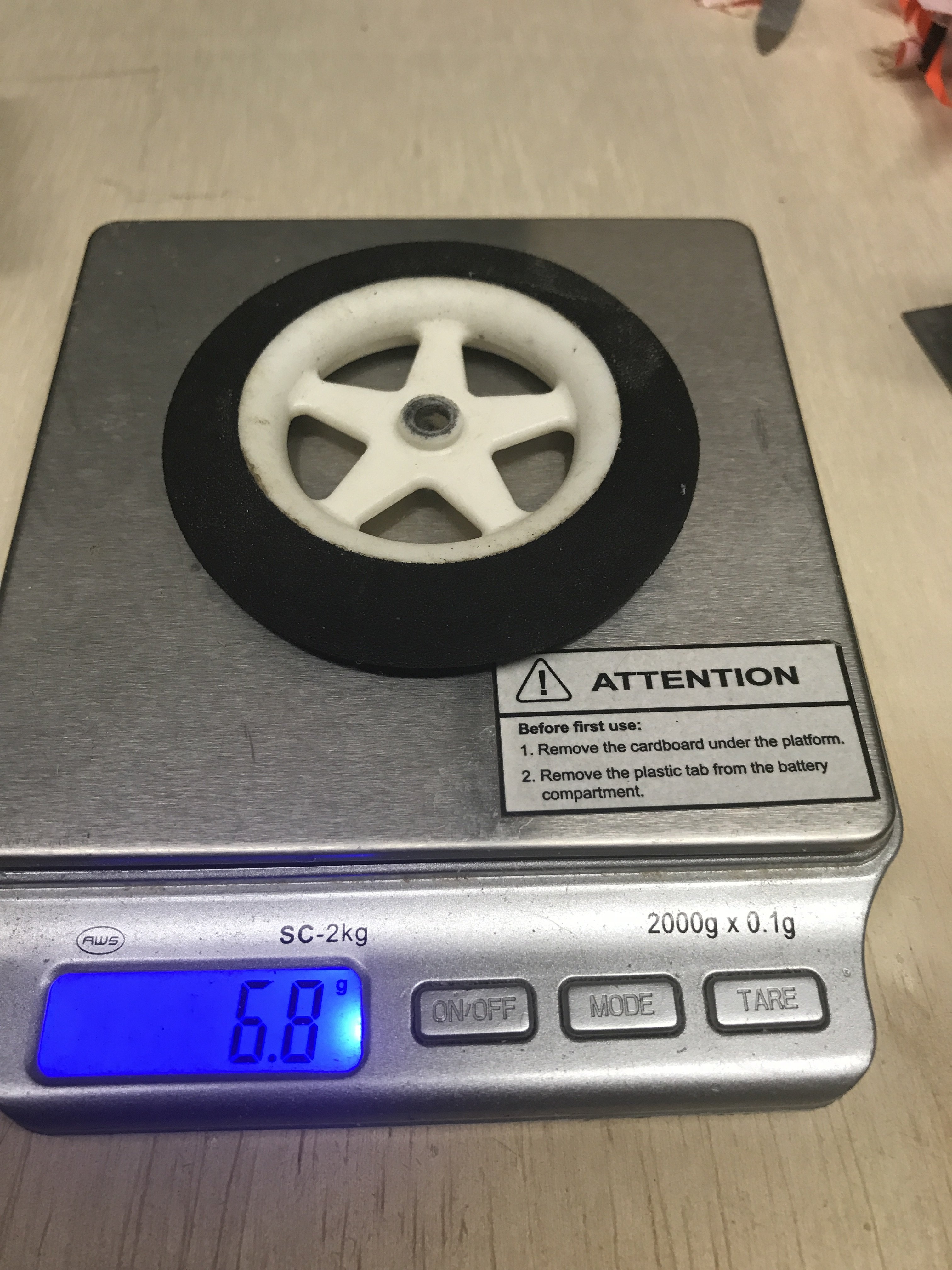

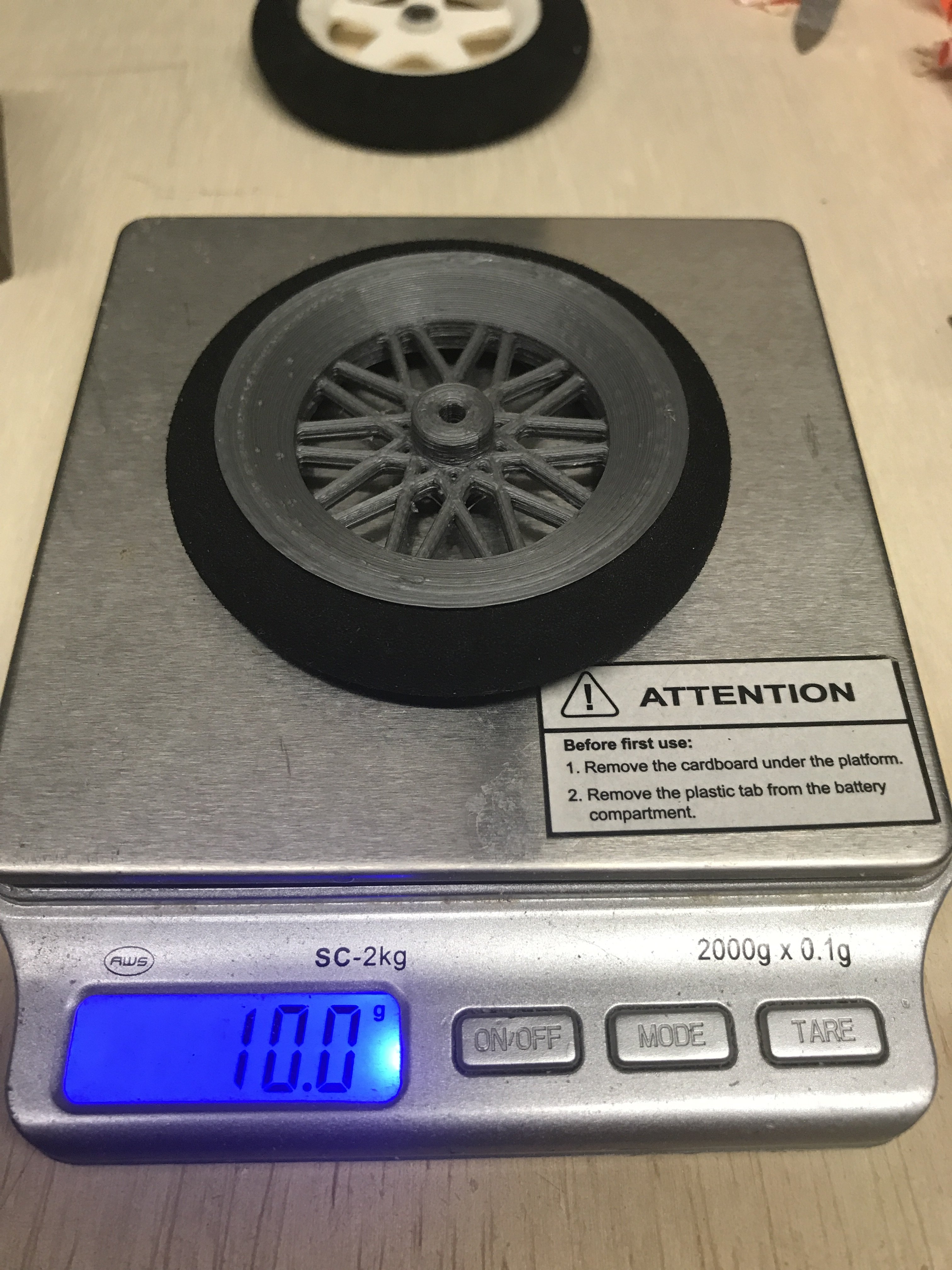

Also was happy to see when I put my wheel on the scale that I printed that it’s only 3.2 grams heavier. Got a few changes to make it it and I think I can get the weight to be almost even.

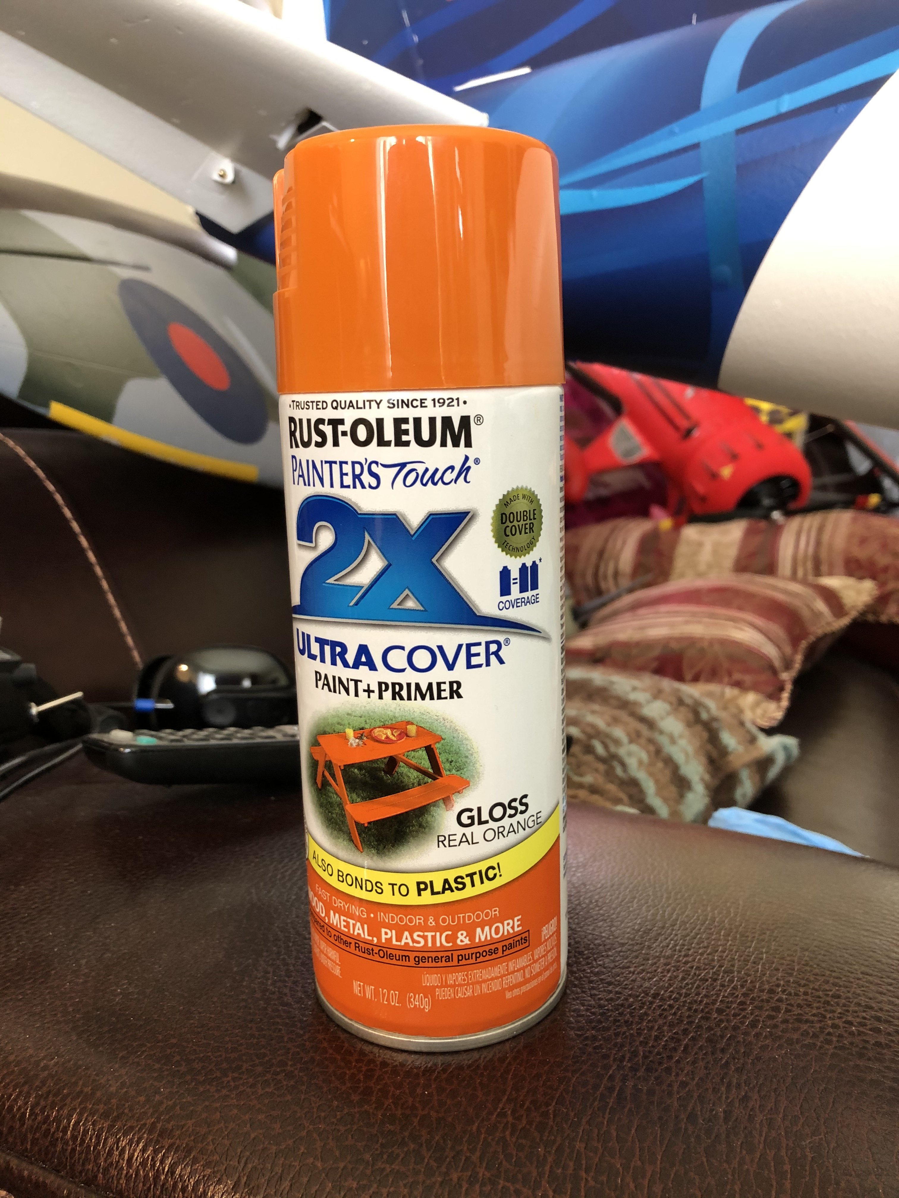

@Wild man what type of paint have you been using on your UMX planes? Got my umx timber masked off and ready for paint just trying to decide what paint to use.
I have been using Rust-Oleum 2X Painter's Touch (Paint+Primer) Our Ace hardware had the stuff on sale 2 cans for $7.00 bucks so I stocked up on it various colors, in Gloss, Santin and Flat colors. I picked up 20 cans. I should have enough to last me for awhile LOL!!!! Make sure if you use this paint stay back atleast 1 1-2 ft from your project the accelerator they use in the can if you get to close the first light coat may melt the foam. I have not had this happen yet but there are a few that have.

Thanks, I reckon I will use the spray paint I have on hand then. I was thinking you may have been using something that you didn't have to worry about an accelerant in. Stay tuned for a new and improved UMX Timber in the coming days.

I've liked the Krylon Fusion. But yes, light coat first is the tip for success there.
I have and actually use both. The Krylon and the Rust-Oleum with the same results, just depends on what I can get the best price for it. The Rust-Oleum does have a larger selection of Colors though, at least in the stores around here
