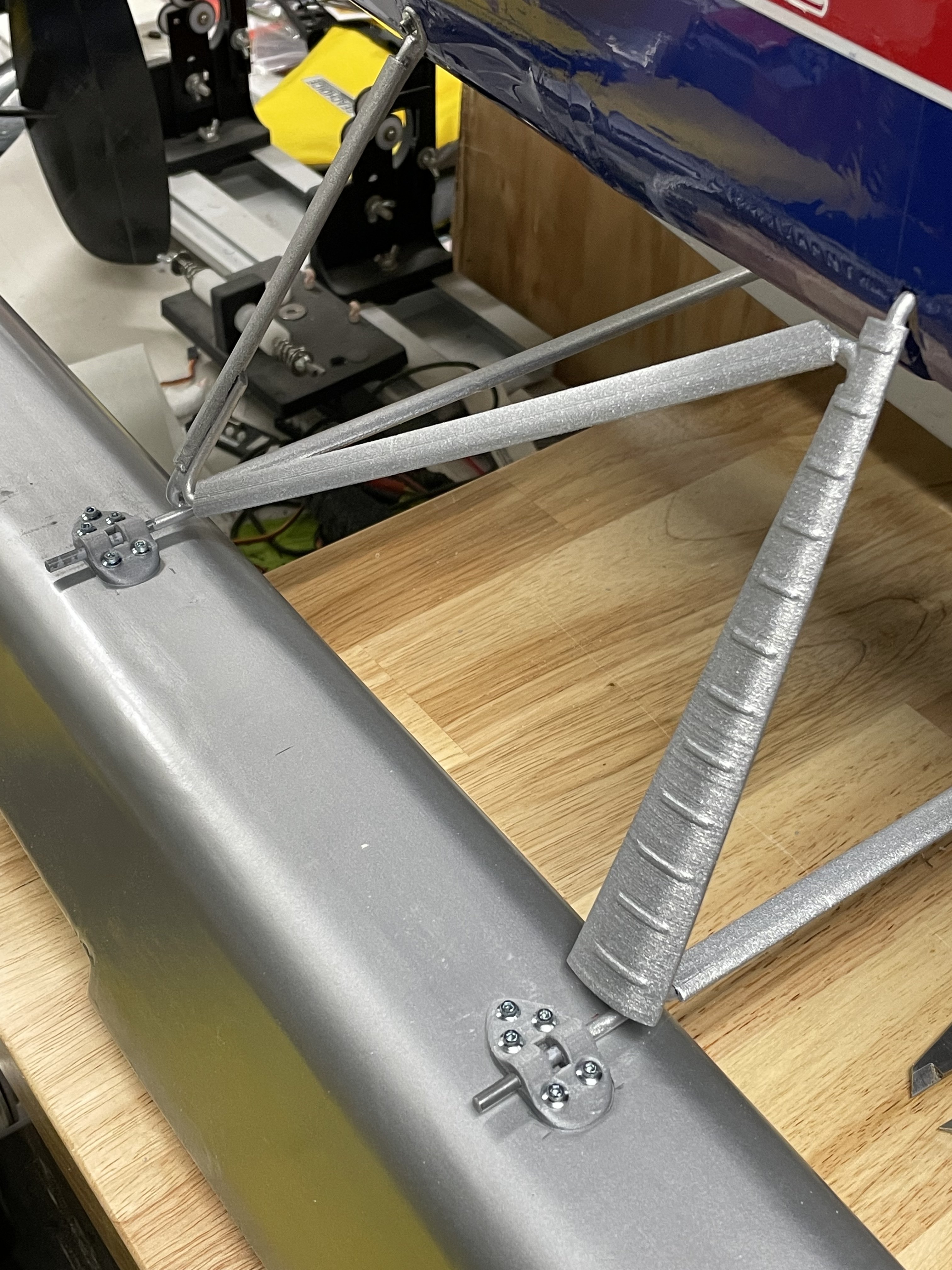

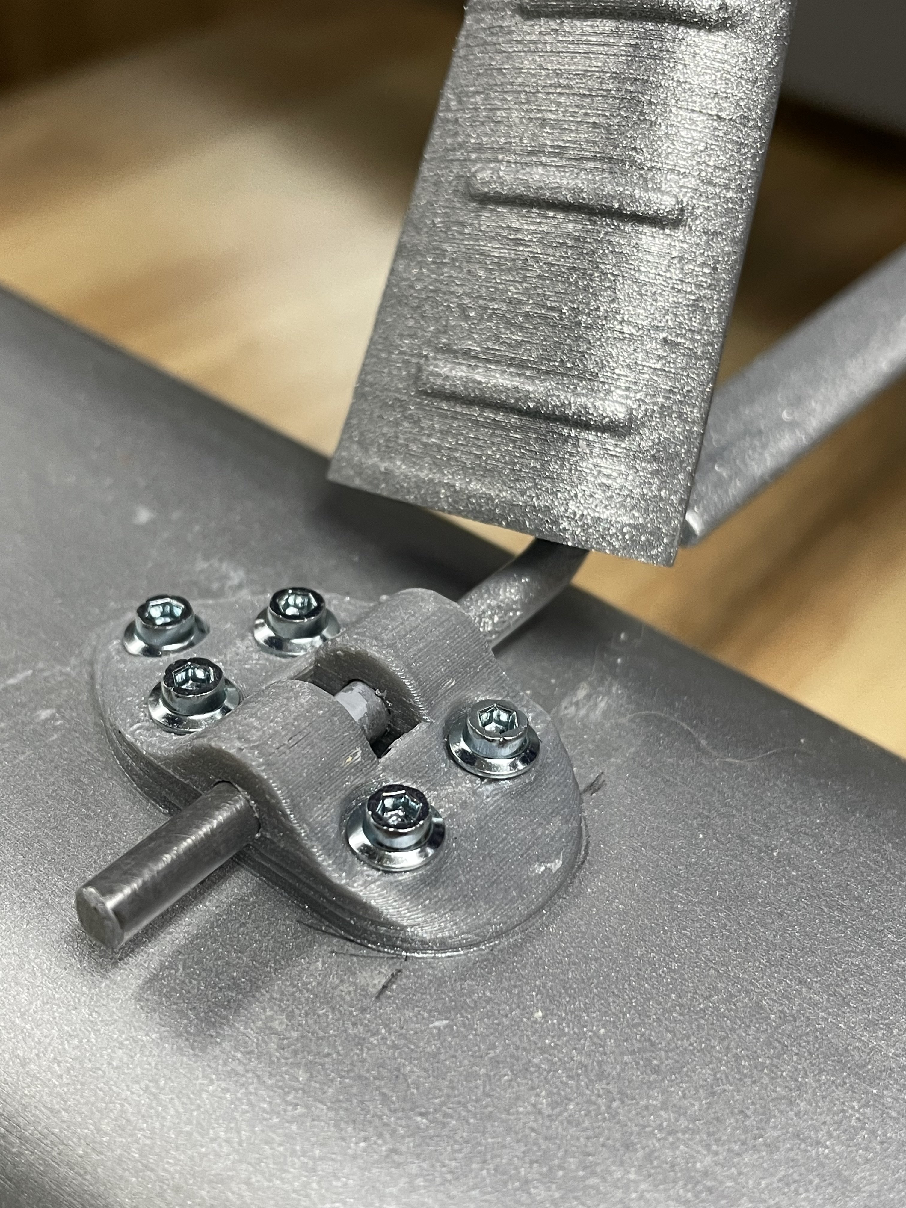

Another big milestone. Finally figured out all my geometry and screwed down the float fittings. I’ll need to take them off to install the wheel collars. Only thing I’m not liking is my CG is a little close to the skeg… well and that empty (no battery, water rudder stuff and esc) the plane is 7.75#

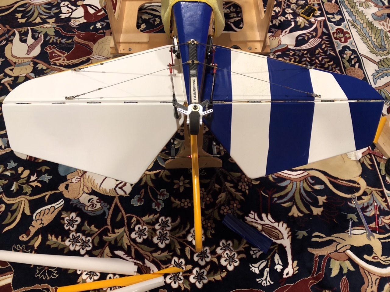

Started yesterday afternoon with what I thought would be a simple repair to patch the elevator covering. Wound up stripping the entire stab and elevator.
Two hours later…
At least Sheldon kept me company while I took over the upstairs for my workshop.
Didn’t have any blue Ultracote so this will have to do for today’s flying.

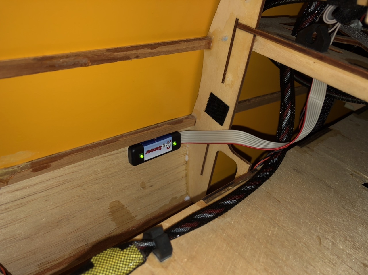

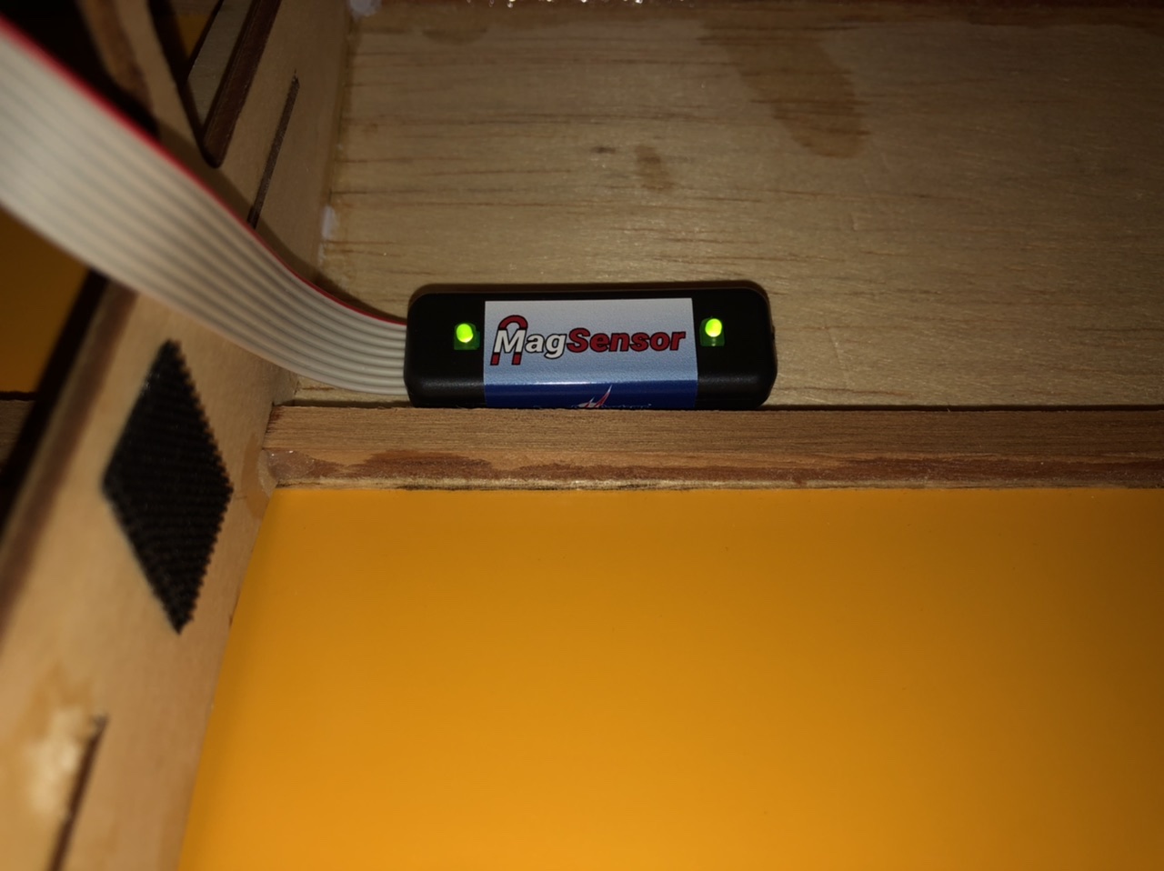

Always hated the thought of butchering the fuselage to mount the large PowerBox SensorSwitch, so I finally purchased a MagSensor switch earlier this week.
Targets mount on the outside of the fuselage. Hovering over one of the targets turns one of the circuits on or off. Repeat for the second target and second circuit.
