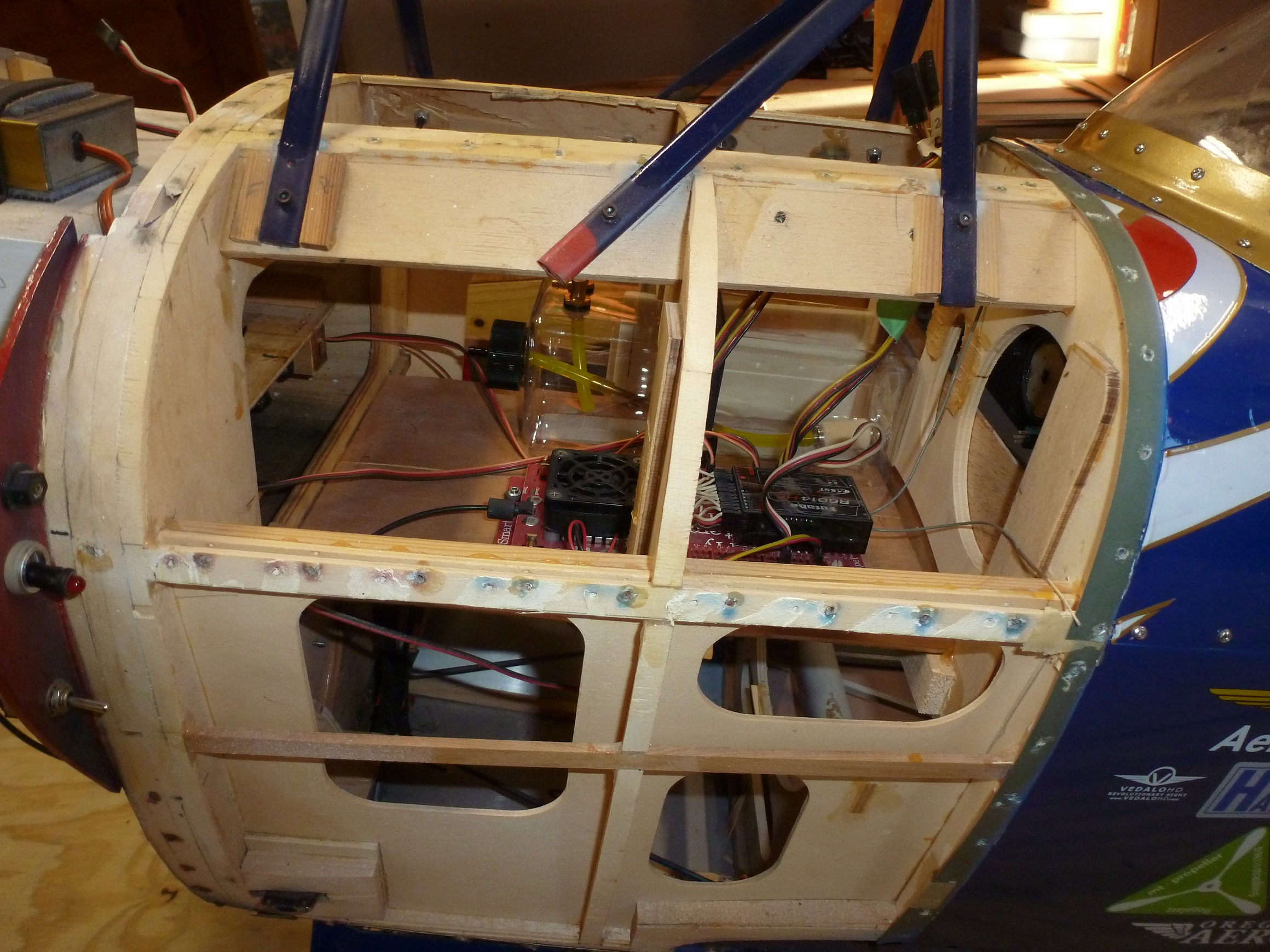

But being as a large portion of weight removed came from the front, the switches and Smart Fly will be moved from the rear (see pic) to the front.

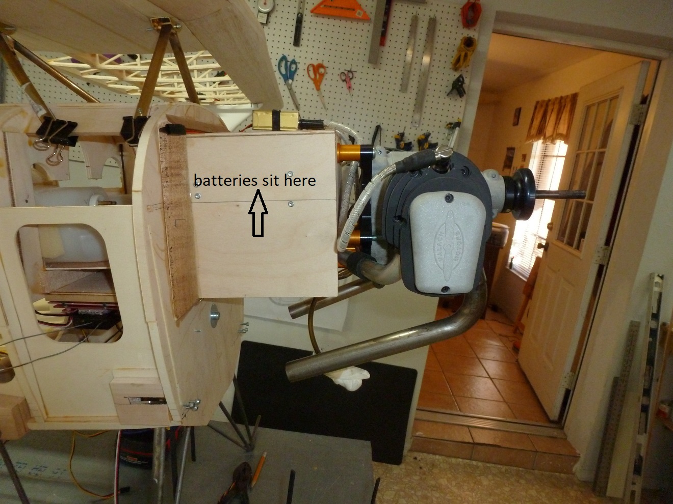

Edit to note; I went and looked it over and I have no reason for not using TechAero's other than just wanting to try SmartFly's. And as it stands I don't think I want to eliminate the battery (they sit in the engine box) for sake of having to add weight to the nose.

The fuel line came yesterday, the tank came today, just need the batteries. This morning, I used a LiFe battery to test the Comp12, everything worked as advertised. And I realized I have a toggle on/off on the ignition power so those three big switches are out. Took a little time and installed the tank and Comp 12 this evening, tomorrow will be fuel line and servo lines.

Do you need the switch because the batteries remain in the plane?
Yes, they are buried in the nose. The two batteries for the Rx are terminated by the remote Pin Flag shutting the Comp 12 off. The ignition has to have a separate power source, hence the third battery, and even though the Comp 12 shuts the Ignition off the ignition unit still draws some power. Back when I was doing events most required an external shut off, the Pin Flag for the Rx and the toggle for the ignition met those requirements. For now, if it was not for needing the weight of the third battery I would have put a Tech Aero in it and been done.
