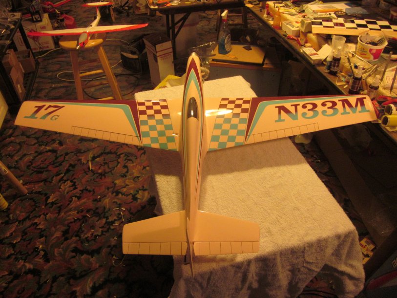

Cool, I still have a Prather Lil' Tony unfinished hanging on the wall. There were several guys at my old field that raced Quickies and Run What You Brung airplanes. At our field you could fly around yourself so they'd practice there all the time. Our field was too small to hold a race for those, so we raced 1/2a and later .10 sized airplanes.
I can still remember from back in the day what a K&B 7.5 with a pipe screaming it's guts out sounds like.
My .10 scratch built racer from back then. I converted it to electric since this picture and it's much fast now.

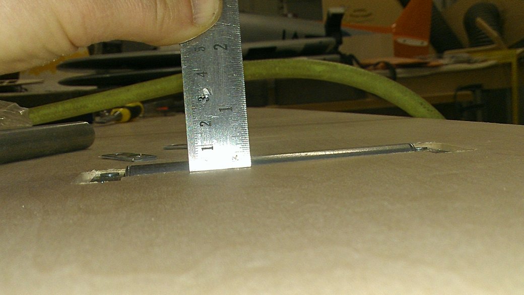

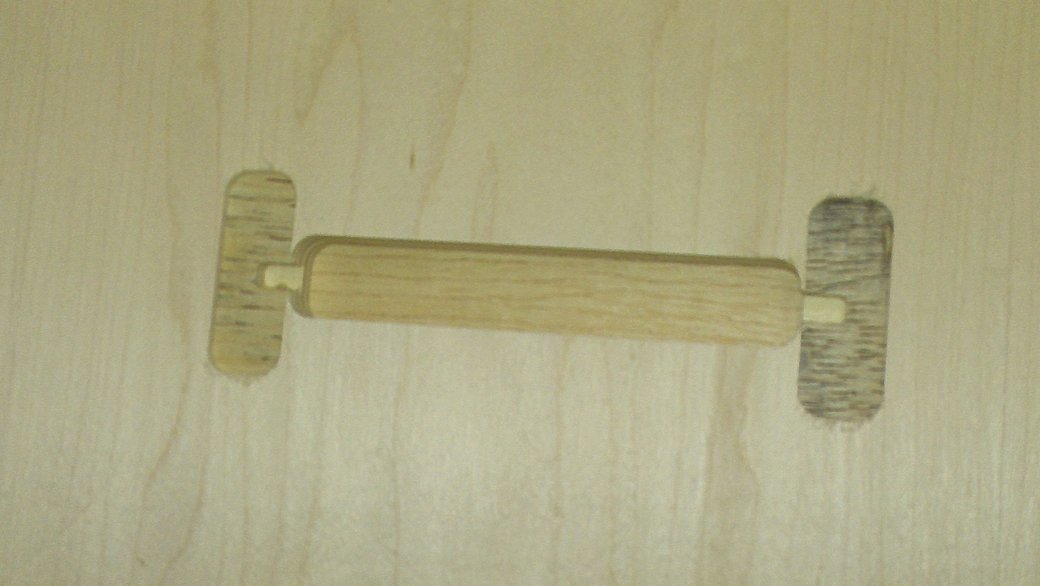

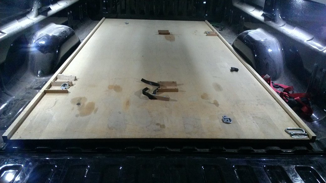

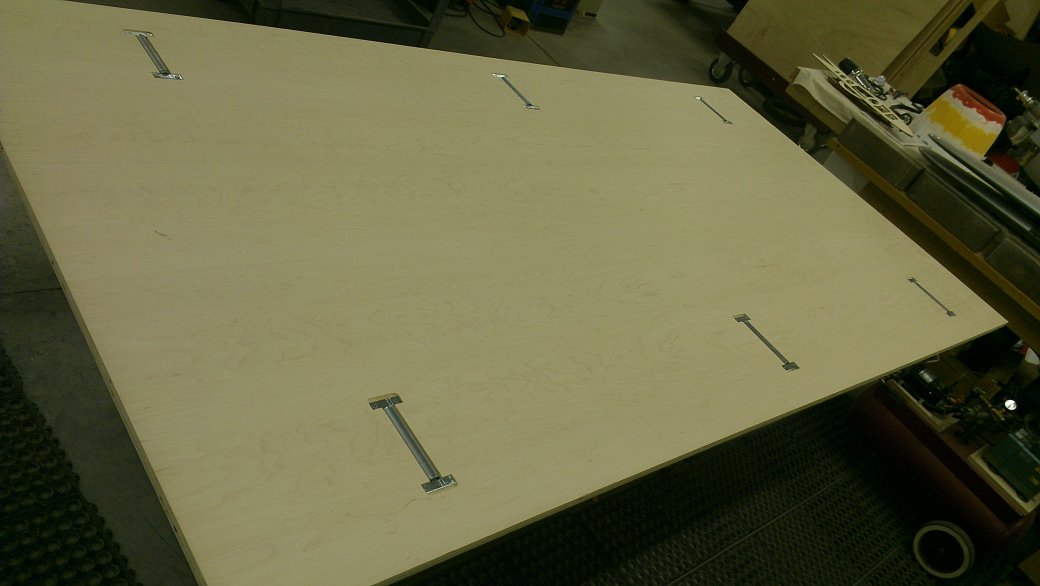

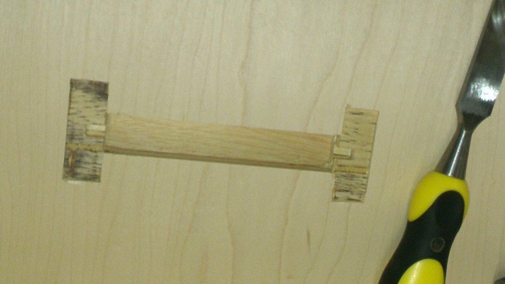

Last year we got a new truck so I could haul two 35% planes to some events that we don't want to haul a trailer to. I made a plywood slide with outdoor carpet strips on the bottom to make it easy to slide. Problem is after a year of use it has gotten harder and harder to pull. @thelaw being a tough girl pulled off one of my handles already.
So I've been pondering a way to put wheels under it and this is what I came up with. I did some searching on the toy-store of hardware stores.....McMasters. Found these sweet rollers that are just the right size and $9 each. So, for $100 or so I have everything I need including some marine spar outdoor varnish to actually finish this one to be more permanent.
It'll take me a few days with finishing to wrap this up so here is the start of it. Lori was CNC'ing plywood today so I drew this up in about 5 minutes and had her cut it for me. Then a few minutes with a chisel to square out the corners and install the roller assemblies.
