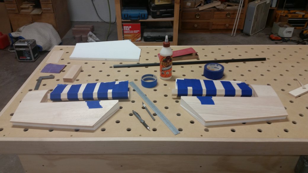

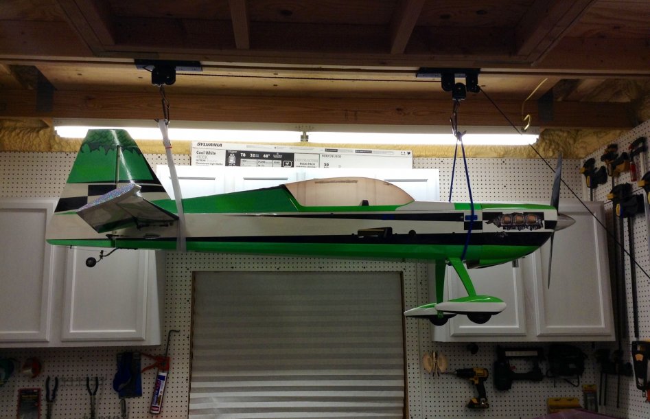

Ok I am as cheap as the next guy but I like this one you need to explane how you do that. See a lot of sticky tape and so on but what you are left with on the plane looks goooood. Let the rest of us cheap-skates now how to do it Pleeeeeaaaaase.
Looking at your rudder hinges can you tell me hoes they are need a few of them. Please

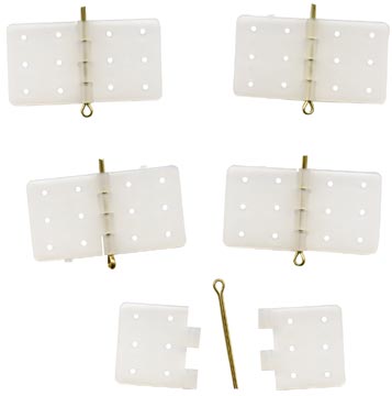

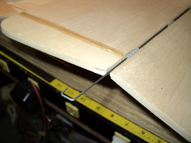

Hey there Snoopy1, those look like Dubro Heavy Duty 1/4 scale hinges (Dubro part # 257). They come in a package of 15 hinges with cotter pins as in the attached pics. I take the cotter pins out and replace them with .047 music wire to get remove-able controls as shown in the attached photo. Just use some tape to hold the 90 degree bend in place and you're done.
