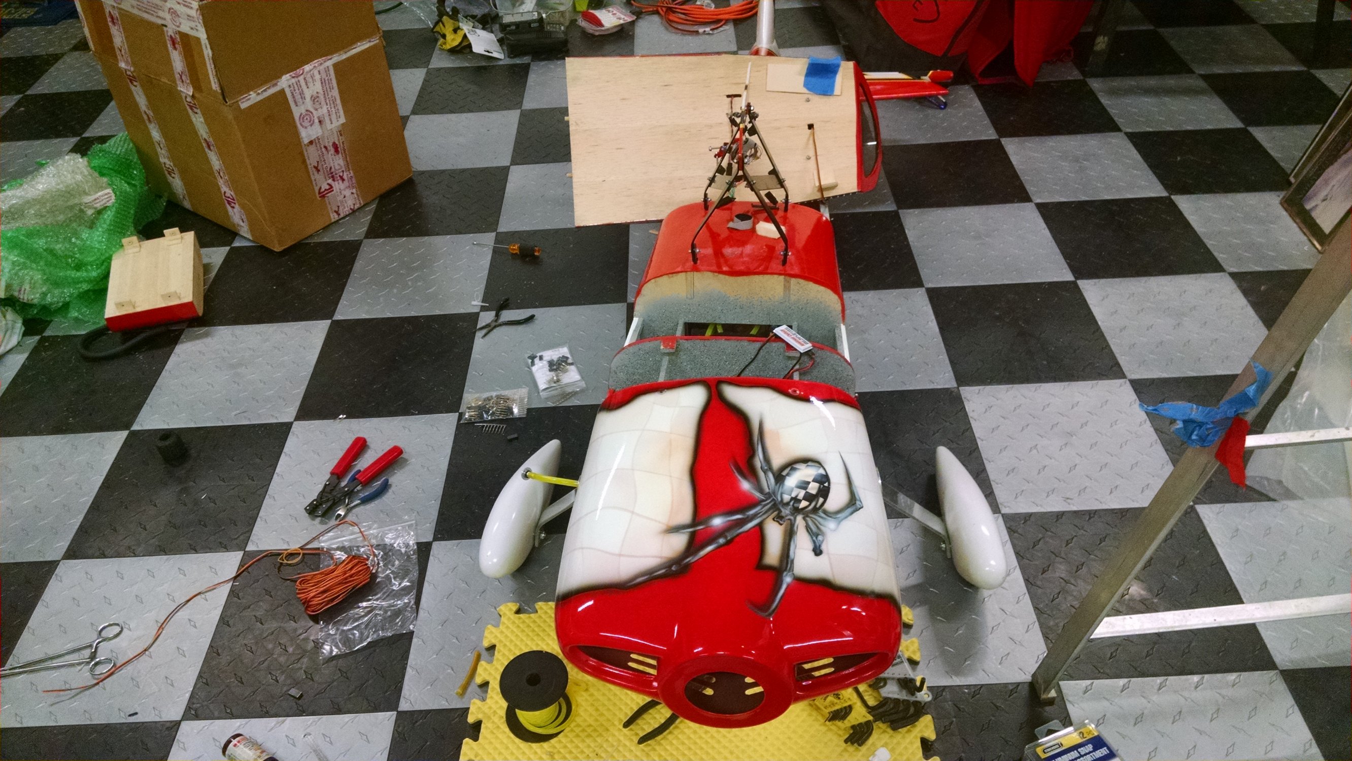

Putting the ultimate back together! Got my engines back from AI and this one runs great! New hall, hub, gaskets, carb kit. Couple loose mounts with glue drying. It'll be ready later tonight

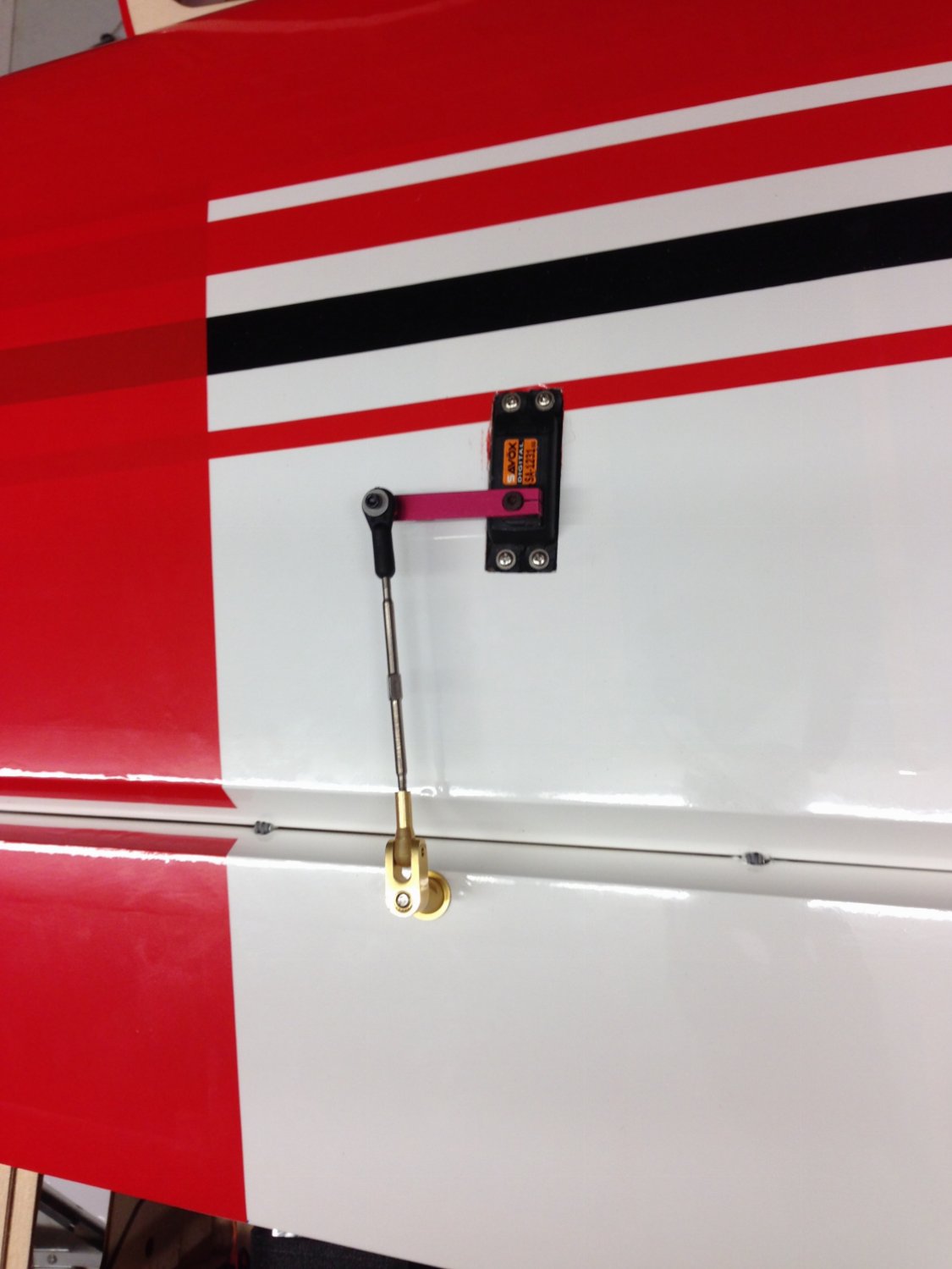

Installed two savox 1231's on the ailerons of the Sukhoi this morning before work. Prolly all that will get done for a week or so but I will be back on it.
keep an eye on where the rod threads into the aluminum ball link. the links stripped out on my brothers after about 50 flights. put the dubros on and no problems after that.
Sent from my SM-G930P using Tapatalk
Will do thanks bud. I know I was thinking of doing the dubro ball links like terryscustom had showed in one of his videos but purchasing the savox servos depleted my budget for a while.
