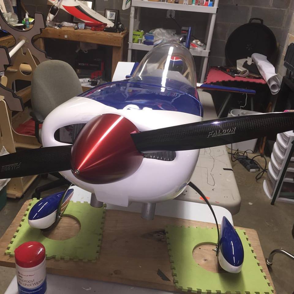

I worked on my Pilot Edge tonight fixing some damage I did playing around landing in the wind.
I've got a tail wheel assembly coming from Chief, but I don't have much hope that I'll get it this week. They don't seem to ever get in a hurry. I may cobble it back together for the weekend with some carbon tow. I found a crack and some delamination on the main gear, so I wrapped it up with tow and soaked it with thin CA.
I need to get this thing fixed because I've got a friend and his son coming to town from Detroit this weekend to do some flying and I'm out of airplanes.

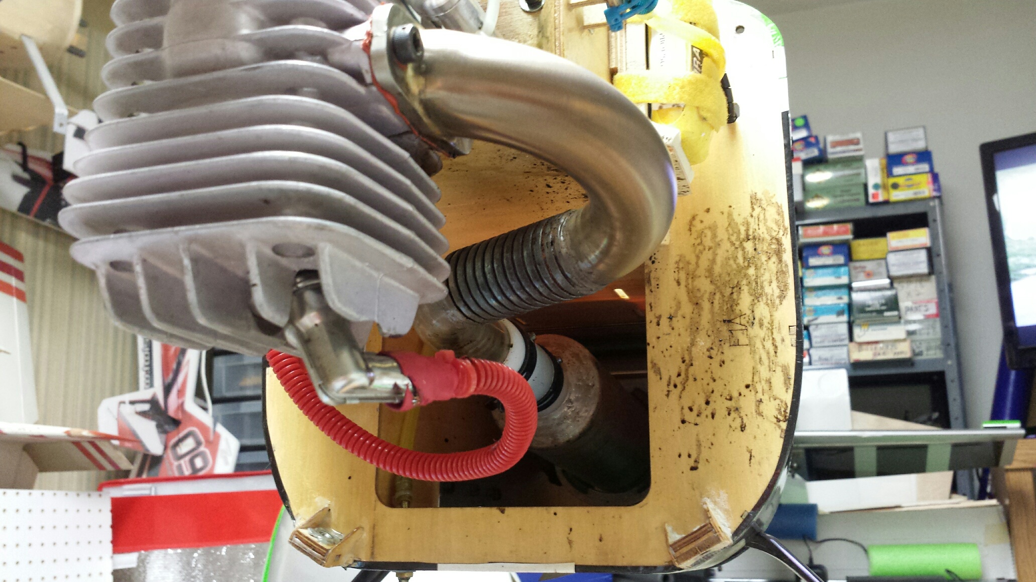

I needed to pull the cowl off to fix the gear and found out I have a problem with the Teflon tape on the header, it was gone!

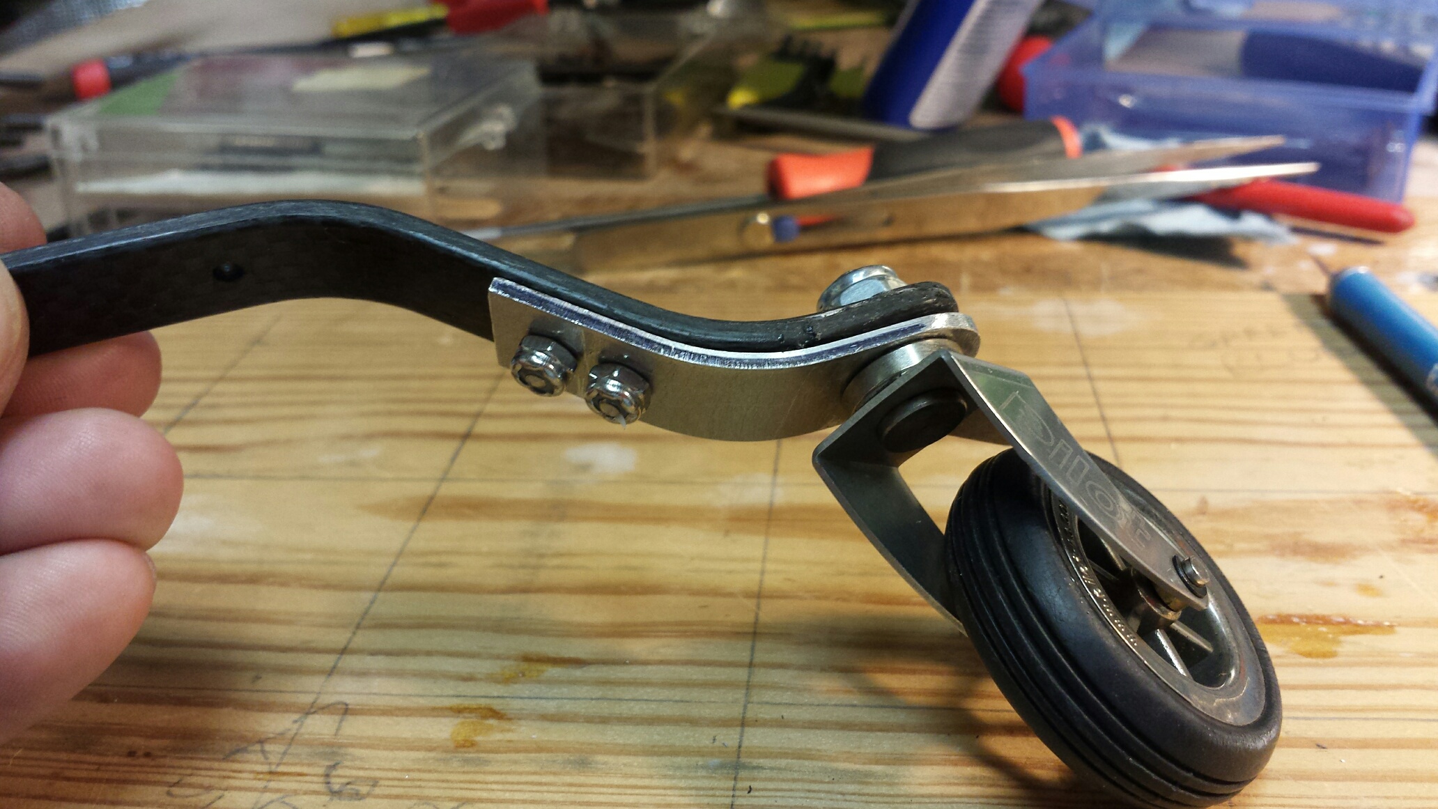

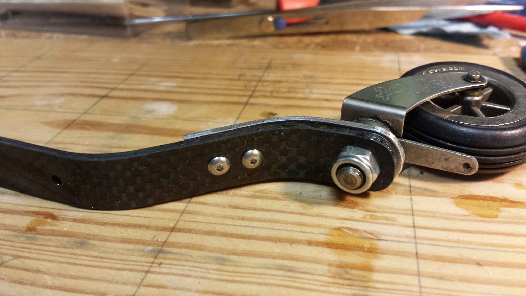

Since it looks like Chief cant seem to get my parts from the warehouse to the shipping department, I patched the carbon spring for my tail wheel back together tonight with an aluminum splint.

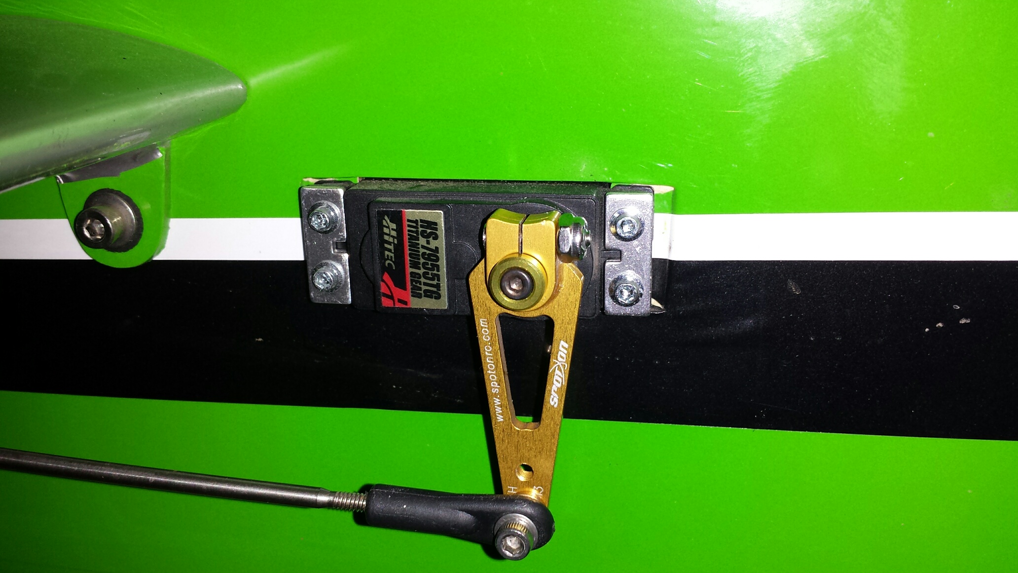

I also noticed one of my Spot-On servo arms was getting loose on the the servo splines. I got rid of their tiny metric bolt and tapped it for a 4-40 and added a lock nut. I had to put the 4-40 socket head in my drill press and taper the head
with a file so it would fit in the hole in the arm. Hopefully that will do the trick.
