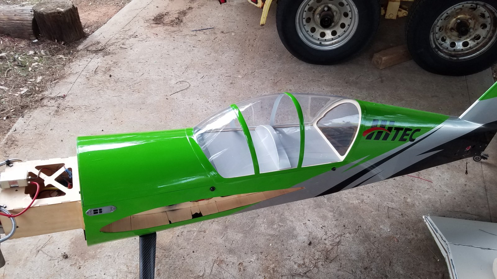

I finished swapping the GP61 into my Pilot Edge last night and took it flying today. I was expecting it to be a beast, but it was far from it. I had this engine in a 21 + pound Extra before and it pulled it around great. putting it in an airframe that weighs 4 pounds less should have made it a rocket. I tacked it and it's 700 rpm off where it was before. We tried tuning on it and the high speed needle wasn't very effective. I pulled the plug when I got home and it's black, and that's with the high at only 1 turn out. The only real difference between when it was in the Extra and now is a different canister setup, and the more I think about it I think this canister might be clogged. The performance of the DA50 with this canister in the Edge that this GP replaced was getting progressively worse. I thought was just pure age since it's serial number 5429 which isn't far from my 11 year old one that is 4779. Now the more I think about it I may have given up on the DA to easily. I'll try cleaning the canister this week and see what happens.
