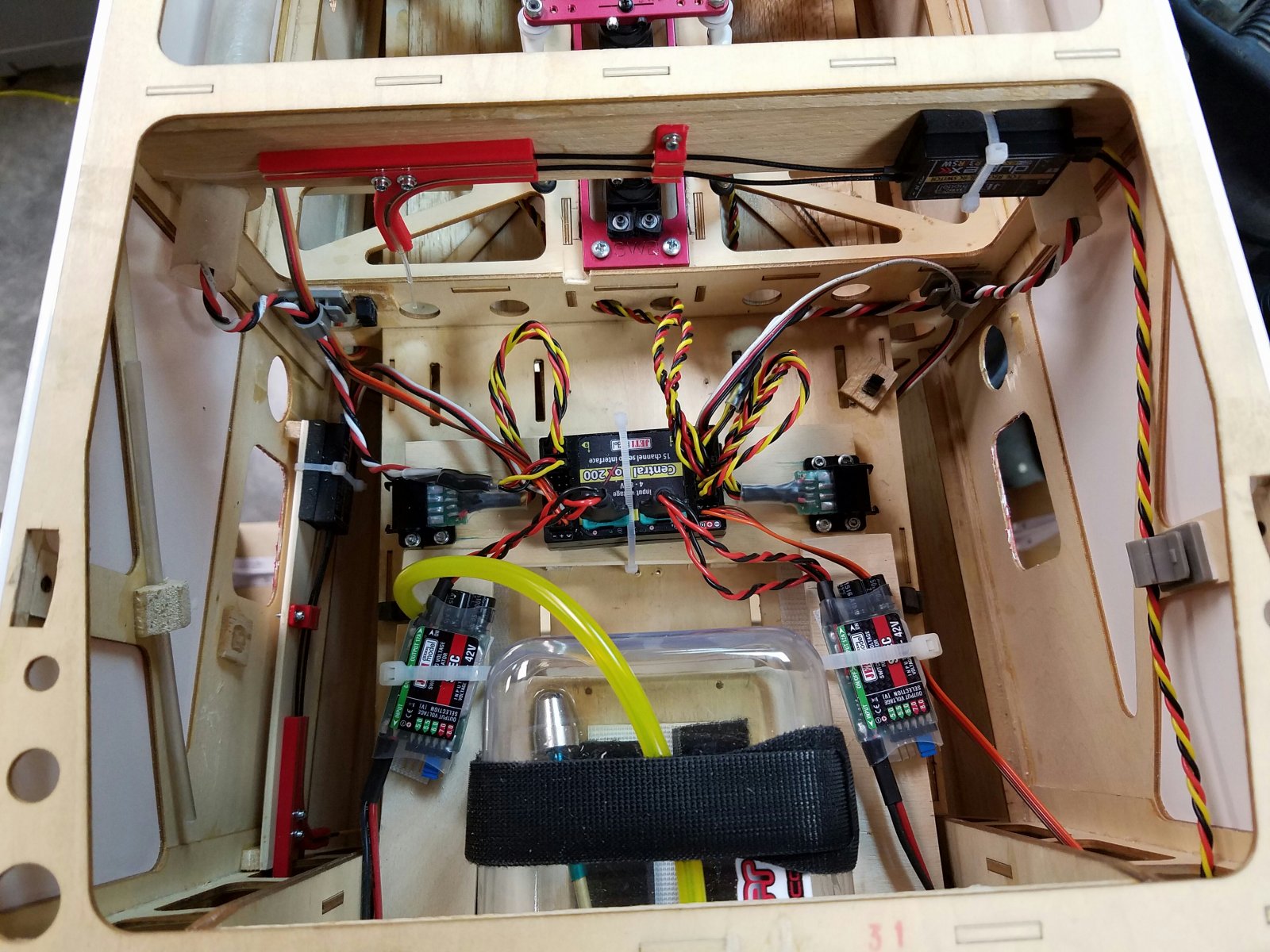

Finished installing the cb200, dual rx's and remoteswitch in the Red 330 LX tonight. Trying to keep it as clean as possible yet still accessible in case access is needed.
View attachment 92497 View attachment 92498
Ok what are the 2 devices on either side of the 200 box yellow, black and red wires go into it held down with four screws.
The devices either side of the fuel tanks are voltage regulators. Just trying to understand all what is there. Not very familiar with Jeti systems. Interested because I need a new radio system soon. Thanks.
thurmma
They are MPX connectors for the wings. I use them so there is only one plug for each wing. Makes it much easier to assemble/disassemble the plane. Also, keeps you from plugging a servo into the wrong channel :) I have been doing this for the last few large planes that I have built. The connectors lock in place and are keyed so they can only go in one way.
