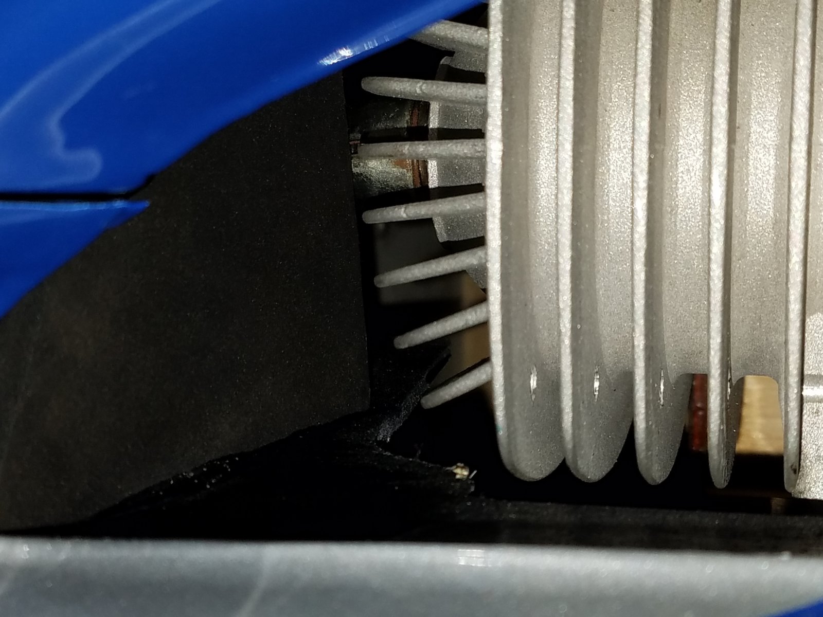

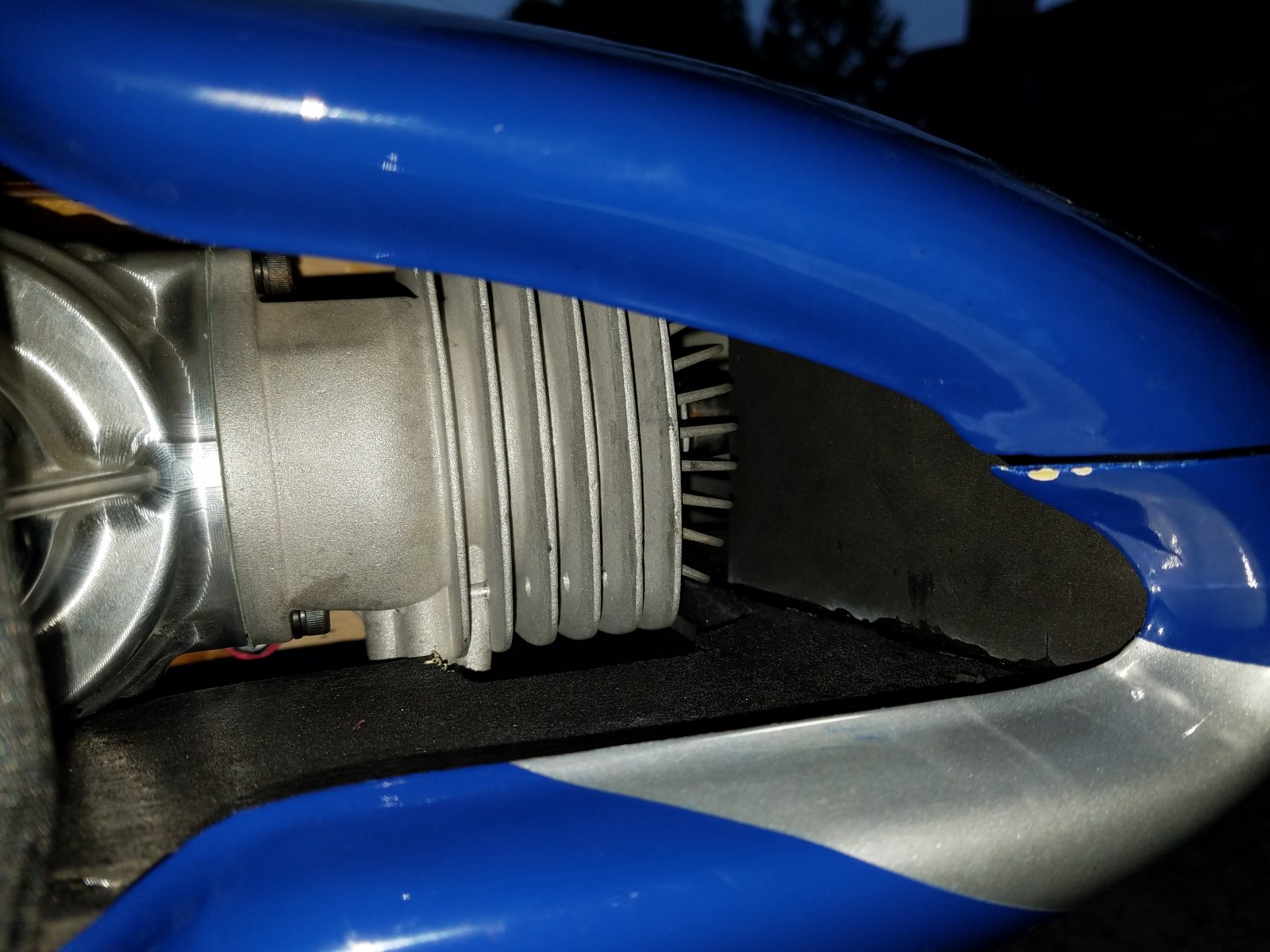

The baffle saga continues. Needed something to direct air towards the engine since there was a nice 2" gap between the cowl and cylinder head, whipped up a quick baffle on each side to force the air back to the cylinder.
Still thinking about trying to do something for the top of the cylinders....

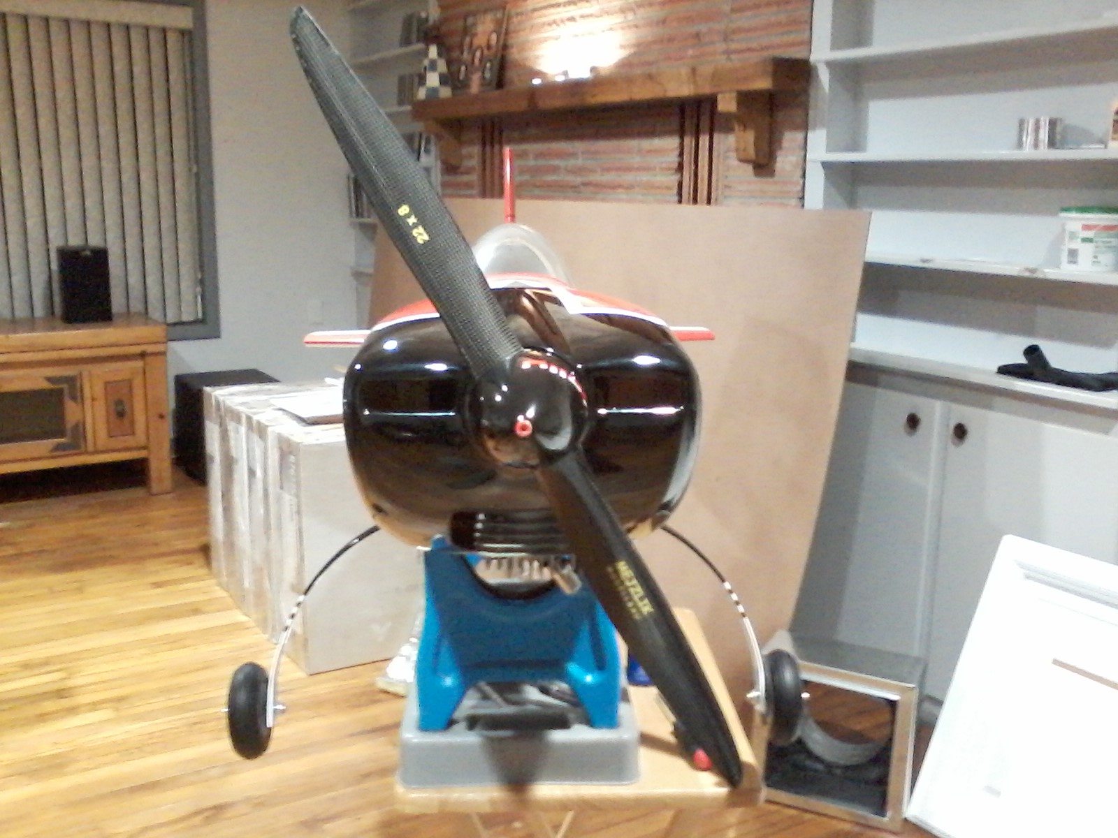

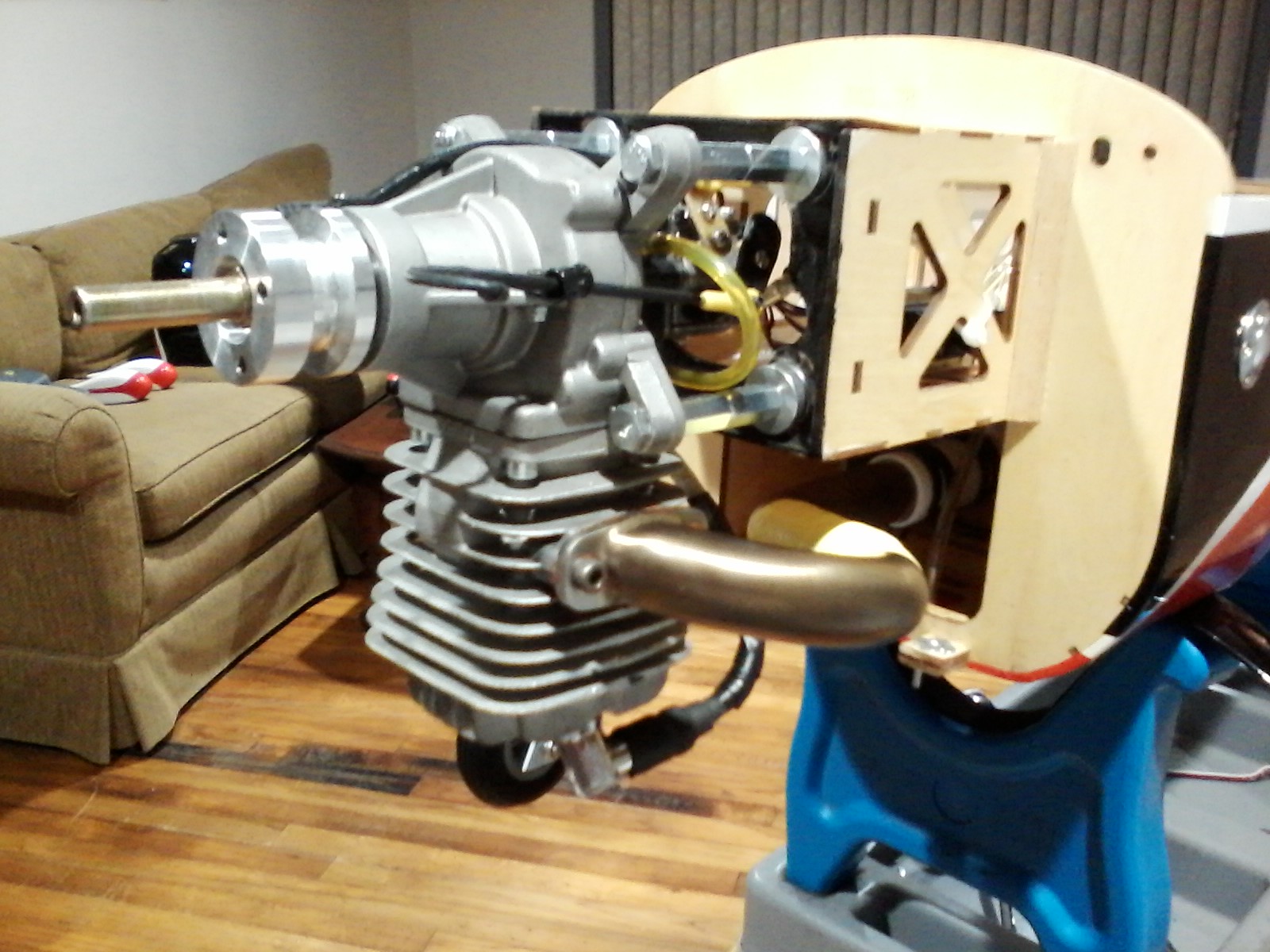

Got the 10 year old DL50 mounted back on the airframe. The new stand offs put it at the sweet spot. G2 DX8 and AR8000 receiver should be here Friday. Just need to finish mounting pants, install radio and batts. Balance and go FLY:).View attachment 95703 View attachment 95704 View attachment 95705
