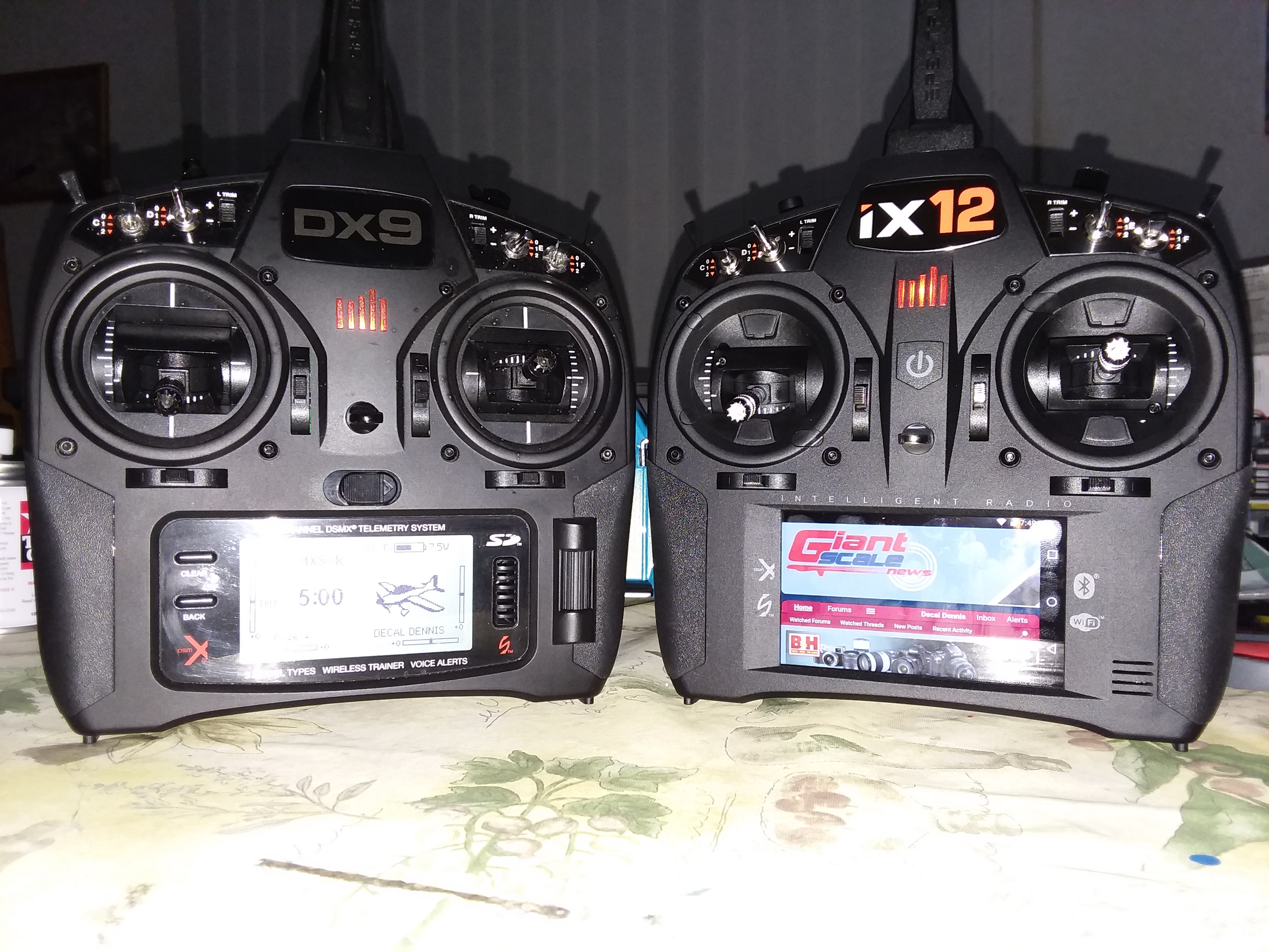

Pretty much the same frame as the DX9

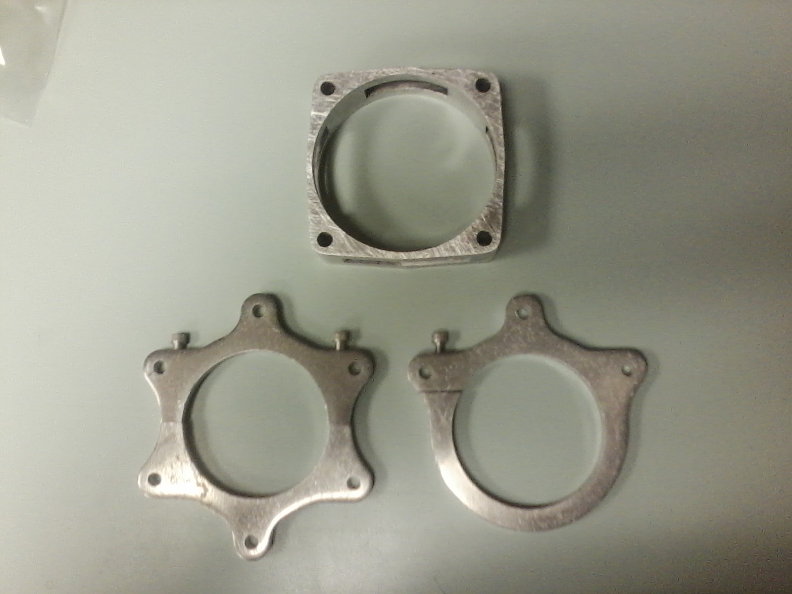

Boy that is a neat idea using the muffler as mounting plate for the motor. The only thing I can see is getting that muffler into a fuselage. That can make life a little interesting.
I agree there buddy. The good news is I don't have to worry about that. But what I have seen of my friends Byron P-47 is; the brackets that hold the muffler get bolted to formers in the fuse and cowl and the muffler really does act as the motor mount. Basicly bowls down to just three bolts holding the muffler and engine in place inside the plane! Don't know as if I really like that but it is what it is.....a Byron Originals.
The machined spacer you see acts as a "spacer" only in the configuration of direct engine prop drive. I believe the machined slots in it were for the belt drive prop versions. The crankshaft extends outside the back of the mustang 50 for that application.
