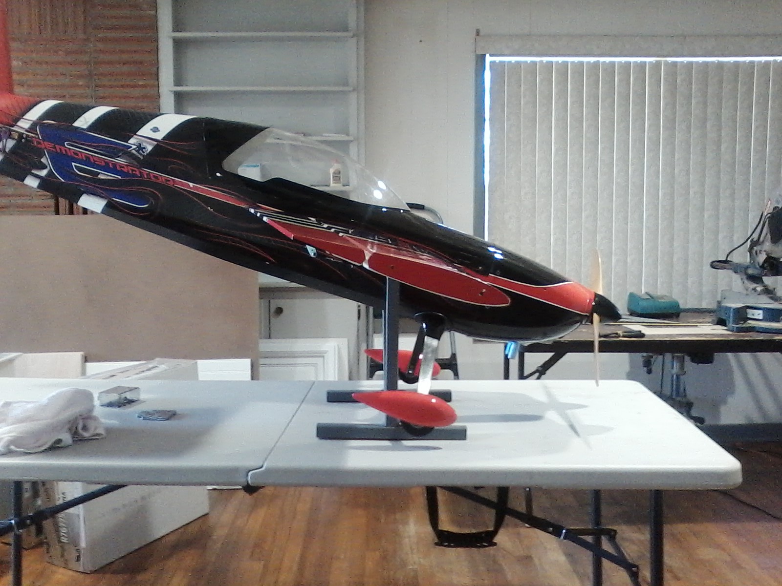

I have a RedWing 30cc Extra 330 sitting on my work bench for 4 years. I started working on it and something always came first, work, house, you know on and on and on. So for the last three weeks I've focused on it and last night everything was done except to CG the plane. Last night I fired up my computer and searched online to determine where to CG the plane. (Note to self, I should have done this first.) I learned I purchased the first production run of the plane which is inherently TAIL HEAVY. I installed a DLE 30cc to keep the model as light as possible only to find out after the fact that I should have installed a DLE 35 to offset the tail heavy model. I moved two 3600 mah batteries into the motor box and it's still tail heavy. I have a TruTurn heavy spinner, so I replaced the stock carbon fiber spinner and it's still tail heavy. I have DLE 35, however, since the RedWing is no longer in business I would have to modify the cowl again and we know how that will look. I can use dowels to repair the motor box and fender washers to spread the load and install a DLE 35. I haven't used weights for years to balance a plane but I decided I've spent enough time on this plane and it's time to move on.

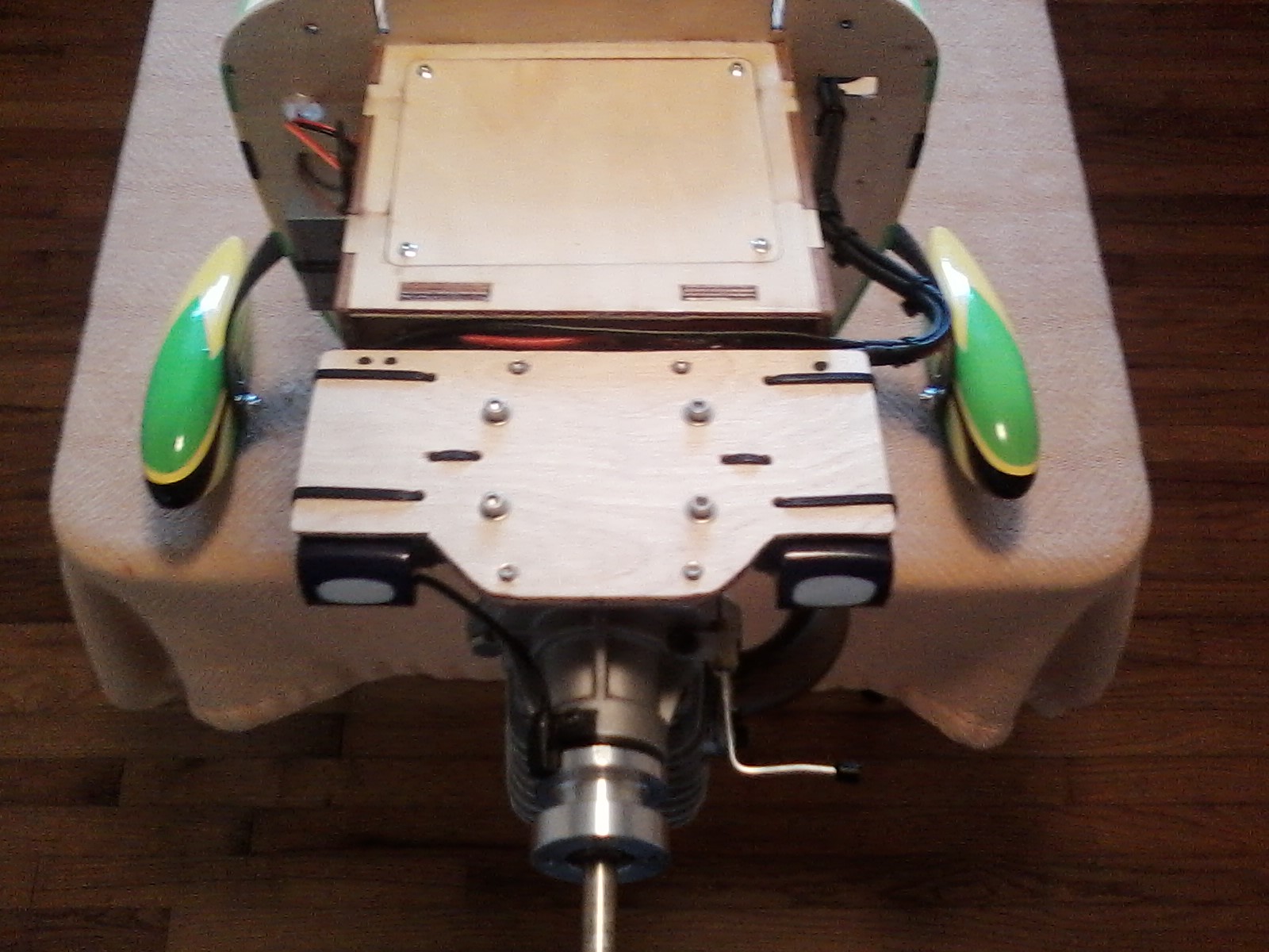

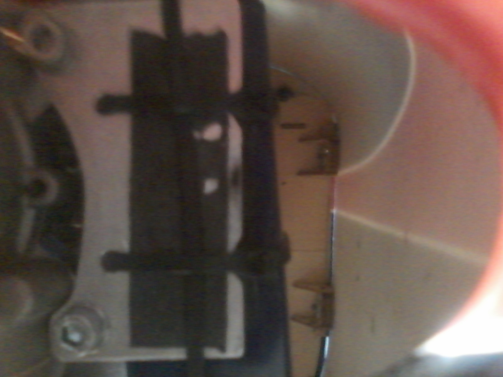

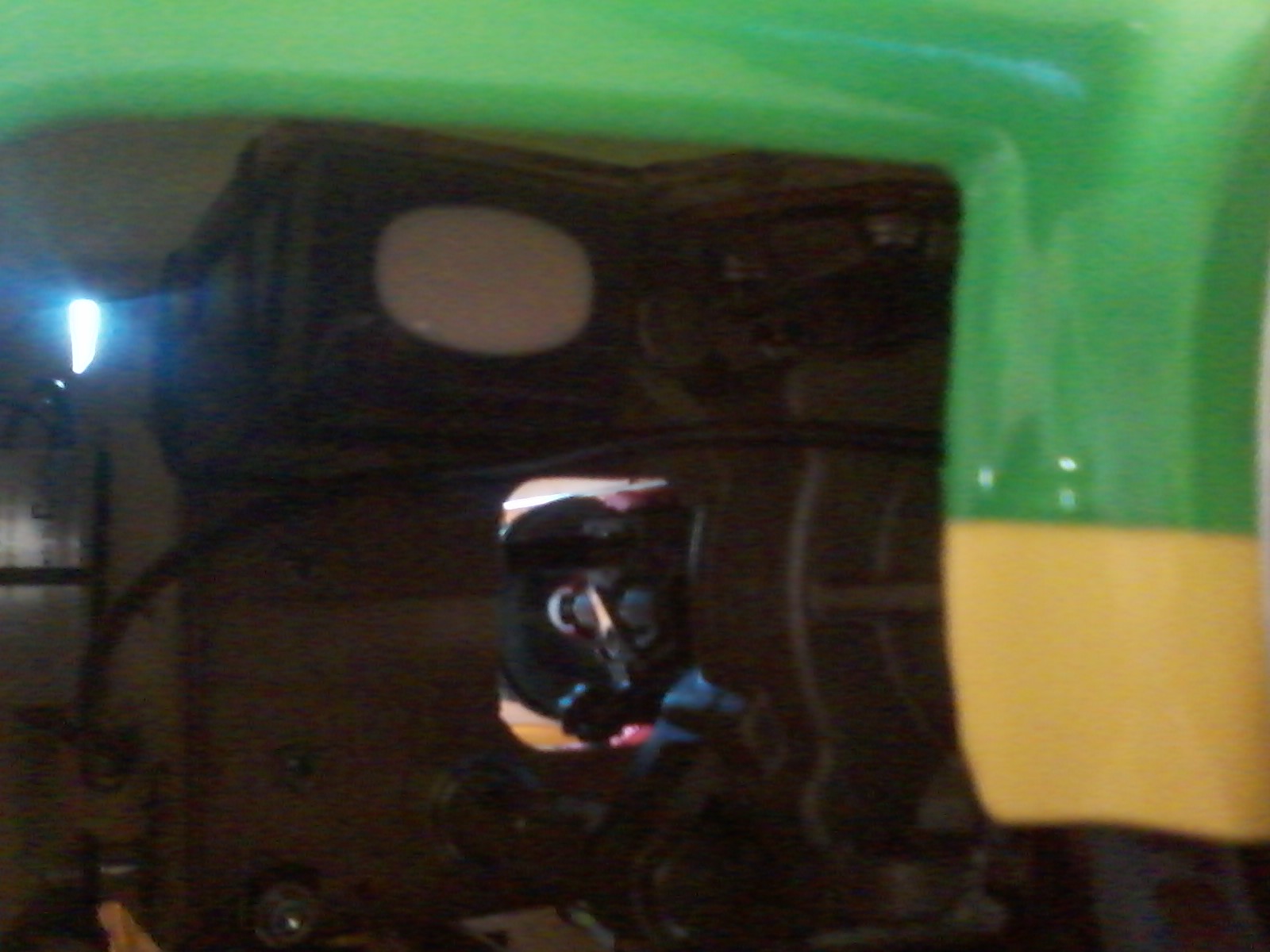

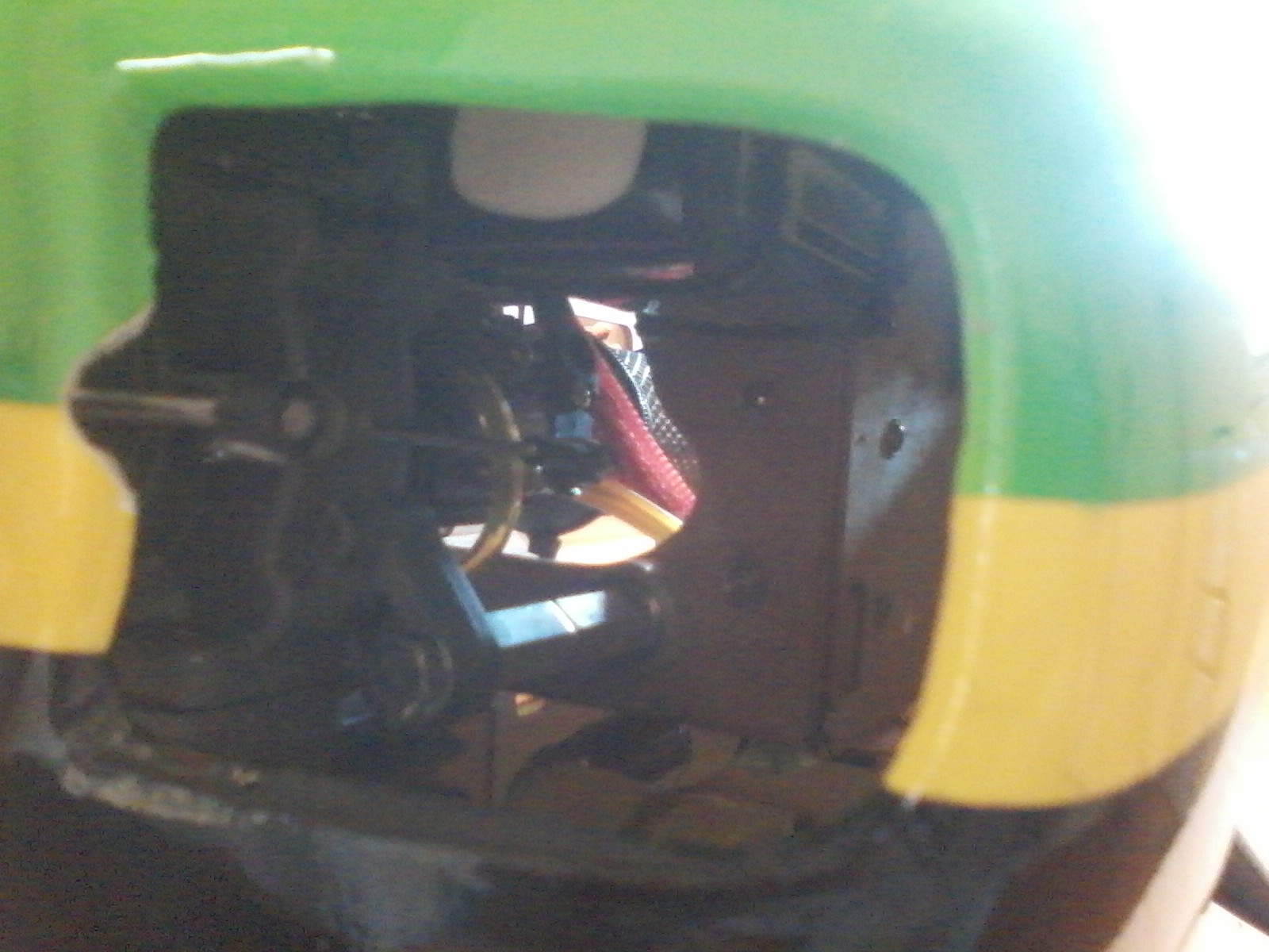

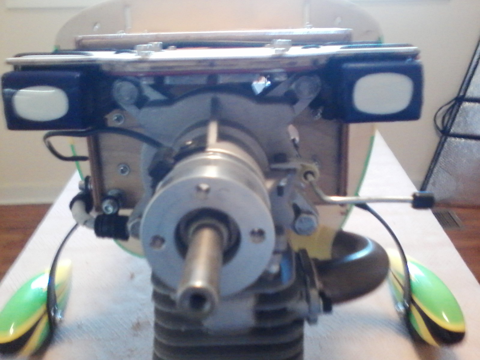

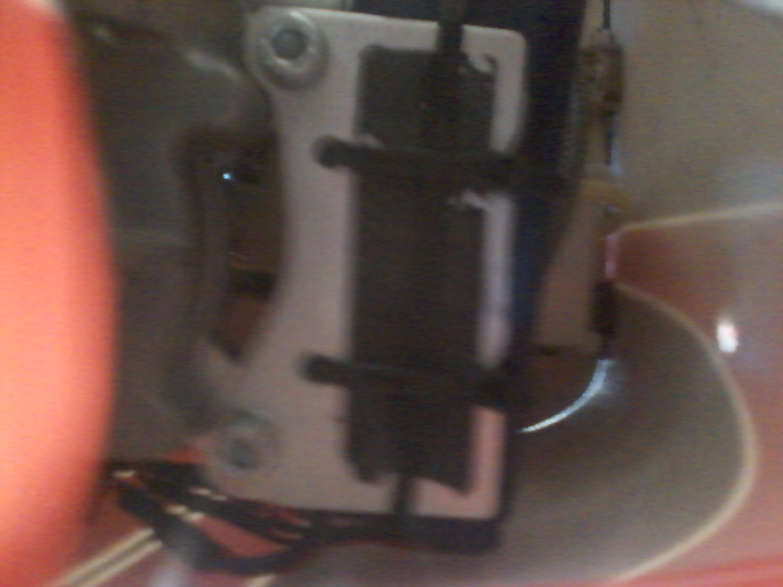

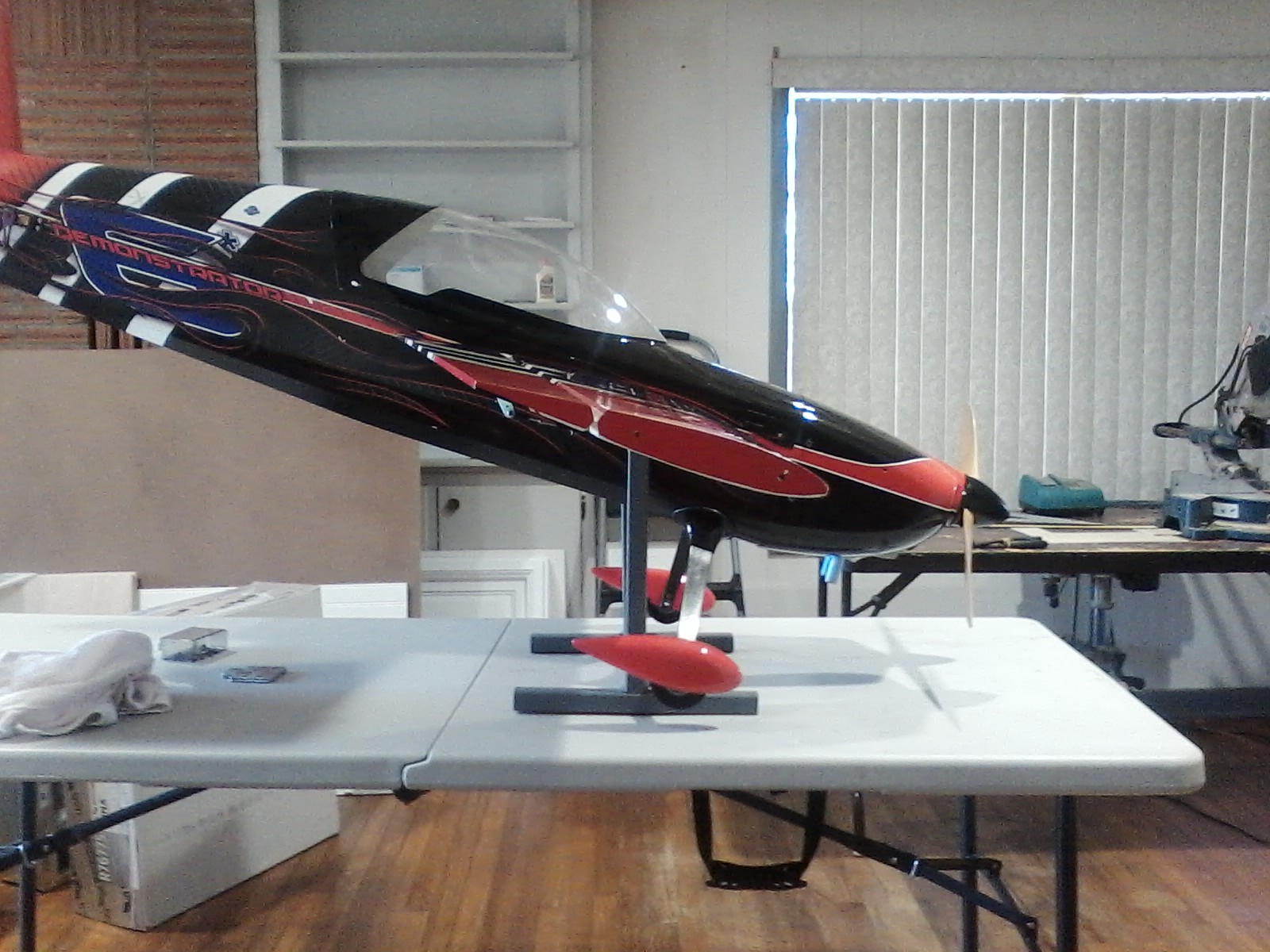

Just get a little creative and make you some battery trays that fit over or on the sides of the engine. I had to do it with my 90" Extra 330 and a buddy's 74" Demonstrator. Works out great. Both planes have two 3000mah lipo Rx packs up front. I pulled out almost 8oz of dead weight from the Demonstrator and 9oz from the Extra.
0101181544-00.jpg 0101181613-01.jpg 0101181613-00.jpg 0115181238-01.jpg 0115181239-00.jpg 0115181223-00.jpg
View attachment 101536 View attachment 101537 View attachment 101538 View attachment 101539 View attachment 101540 View attachment 101541
Well, I'll be a blue nose gopher....that will work. Thanks for the suggestion.
