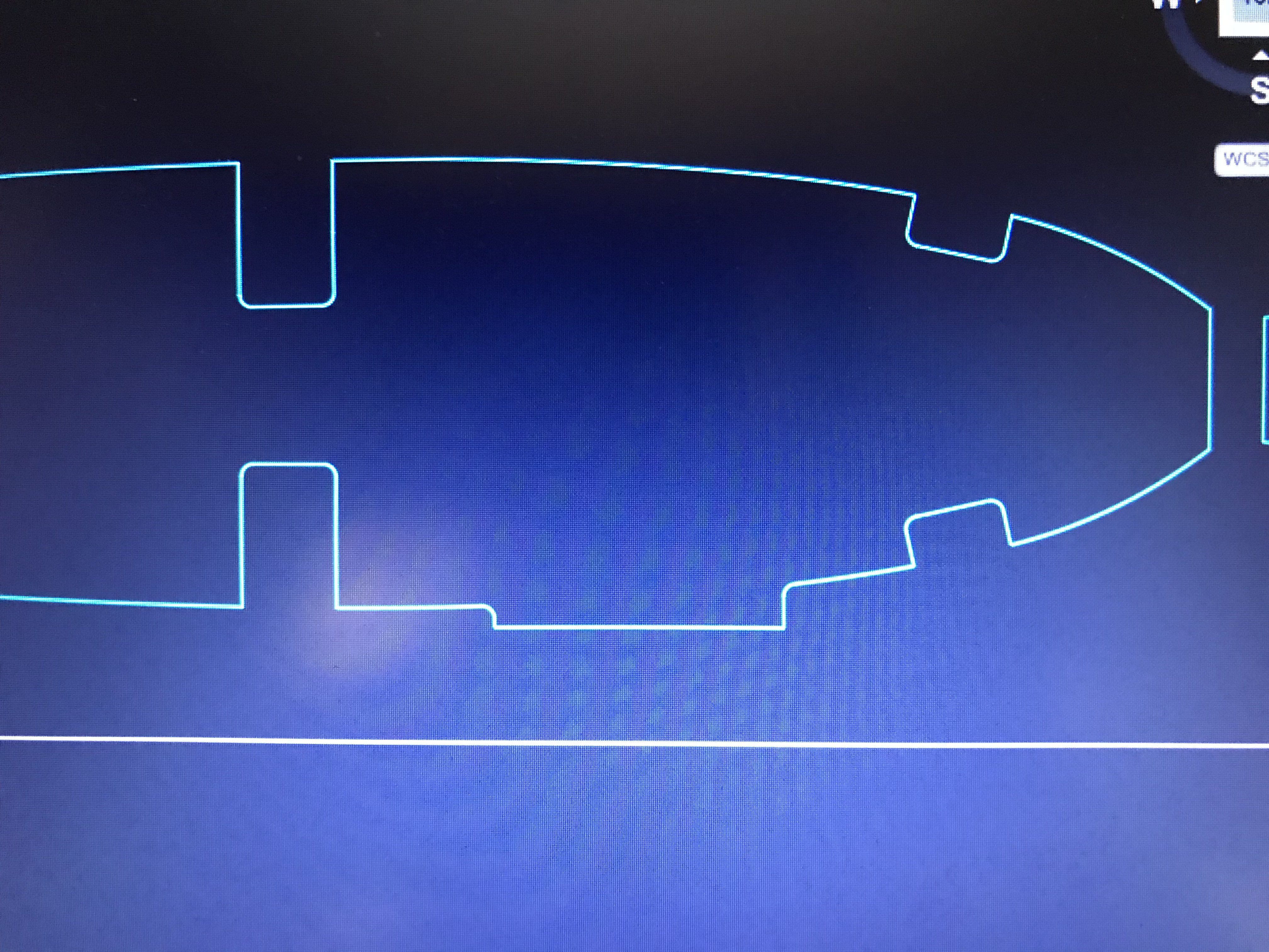

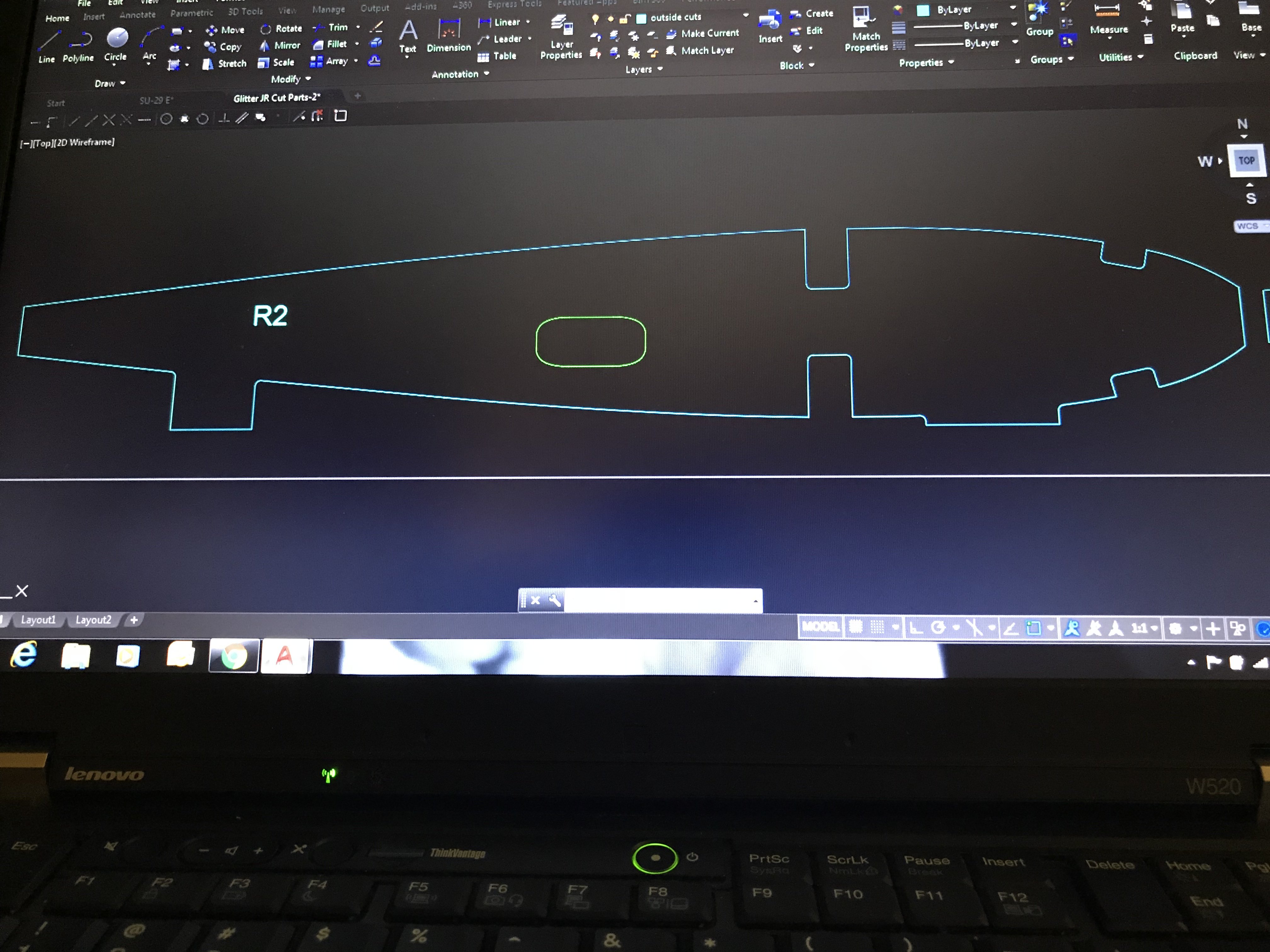

Do you take into account the diameter of the router bit or just sand the parts square afterwards. What I am trying to ask is the slot for a spare will have a radius in the corner that radios do you sand it square. What thickness can he cut in ply and balsa.
So you can see in the pics here that I draw the radius and just sand it square afterwards. Green lines meen cut on the inside of the line and blue lines meen cut on the outside of the lines. Not sure how thick of ply he can cut but I know he can cut up to 1/2” balsa at least. I know he is cutting some 1/8” ply for me but I would assume he can cut thicker. He built a pretty heavy duty machine. Anything 1/4” and smaller he uses a smaller bit so the radius of all inside corners needs to be .032” and anything 3/8” and thicker the radius of inside corners needs to be .063”. These are the numbers he shared with me. I will shoot him a pm and ask if he minds me sharing his email with you to discuss it further. He is a super cool dude. Flew with him out in TN a couple years ago.

Thanks for taking the time to help and answer my questions. I will now look into drawing up the ribs and see how to continue for there.

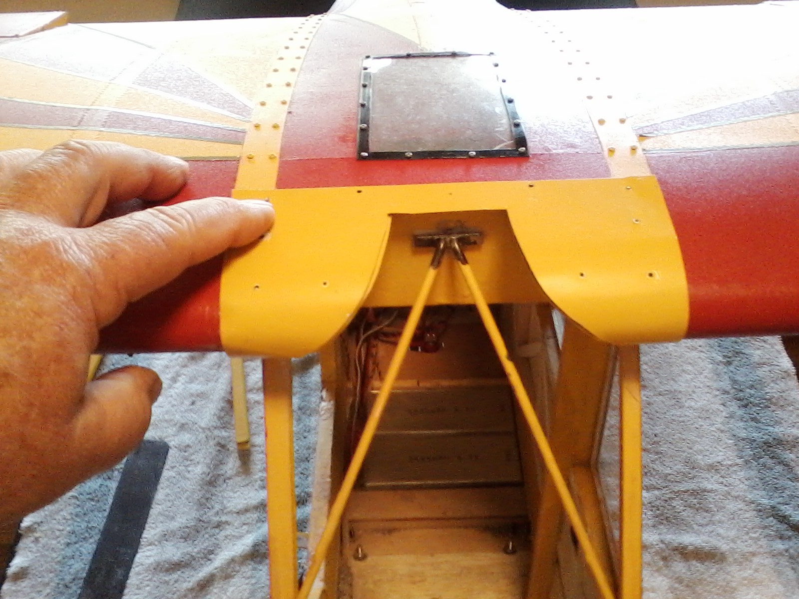

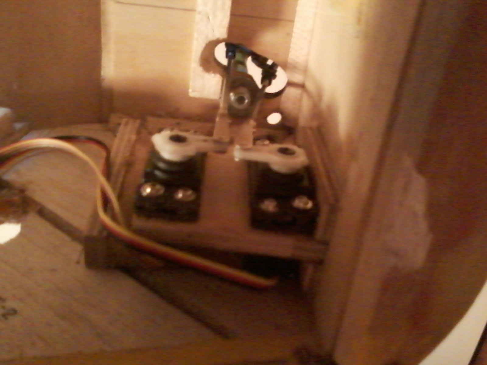

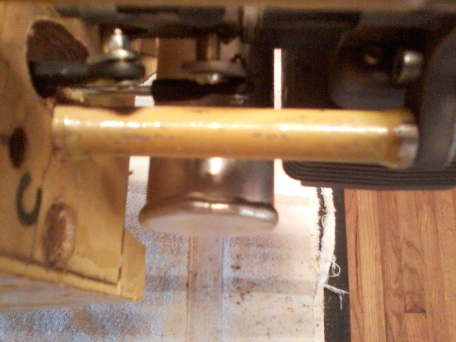

The HS-225 mini servo showed up yesterday and I just got it in the plane tonight. Made new choke and throttle push rods with ball links on the carb side and clevis on the servo side. Trial fitted the wing too a bit earlier today. Fits perfectly. Thumb screws went right in. All repair work except for cutting a new wind screen is done :).
