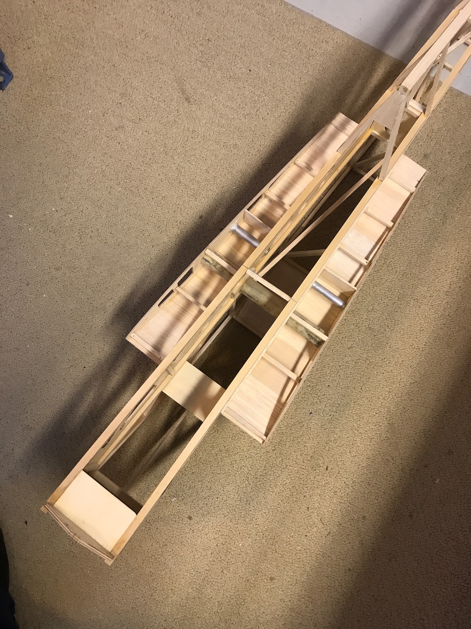

Ok a picture is worth a thousand words. This what I am dealing with. First trying to keep the plane light and do not want to install M6- 25mm long steel screws, nylon is preferred and if not available then aluminum.

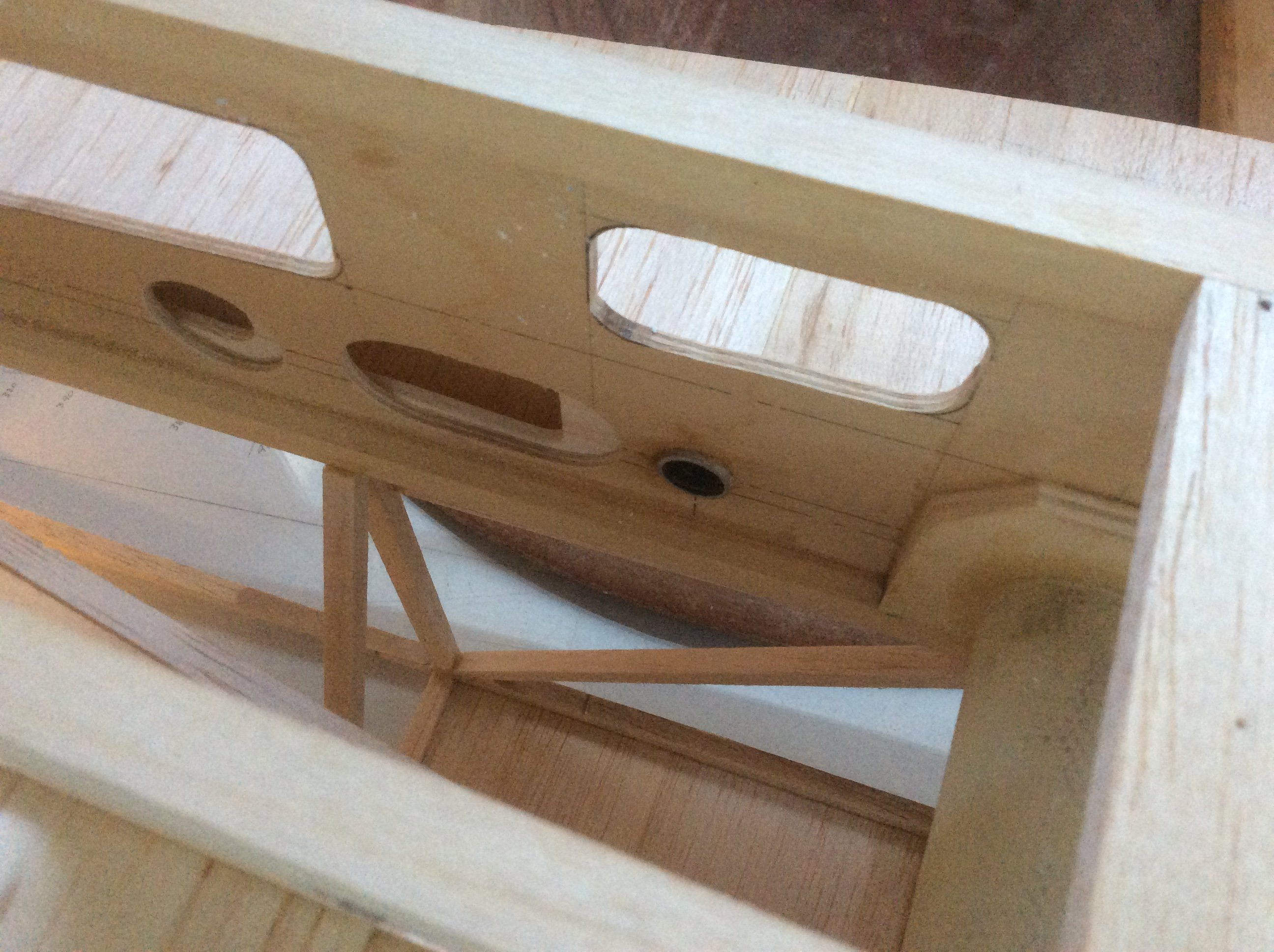

This picture shows the tube in the plane. This were the screw is inserted to bolt to the wing.

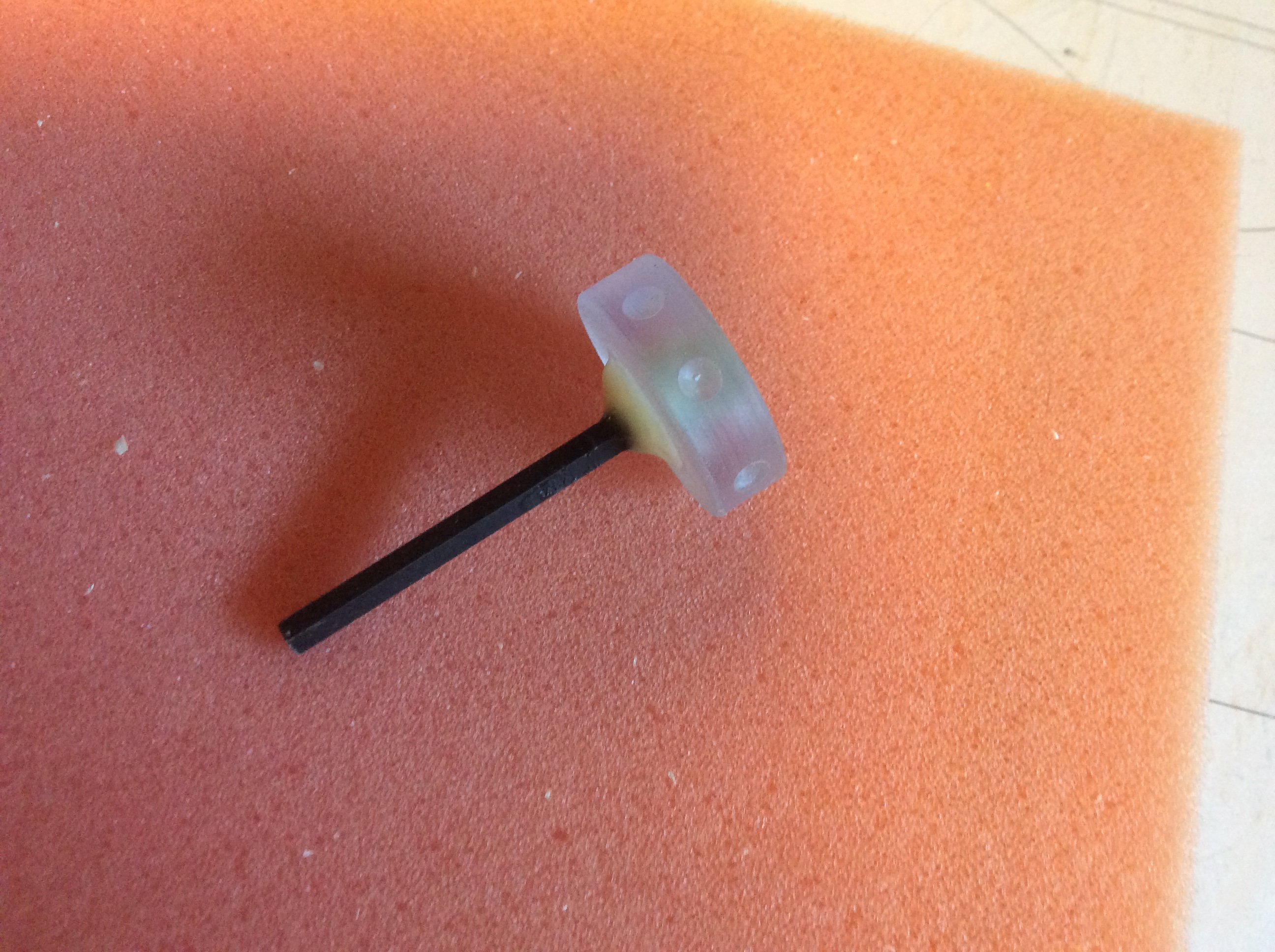

This shows the made Allen wrench that fits the width of the fuselage and fits down the tube to tighten the Allen head screw.

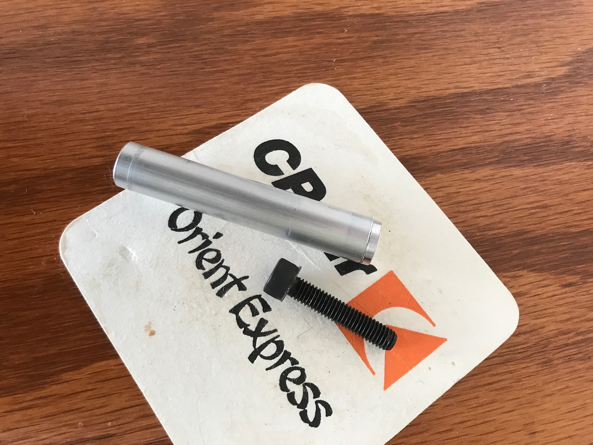

This showed the tube that was made to fit in to the fuselage and extend out of the wing extension

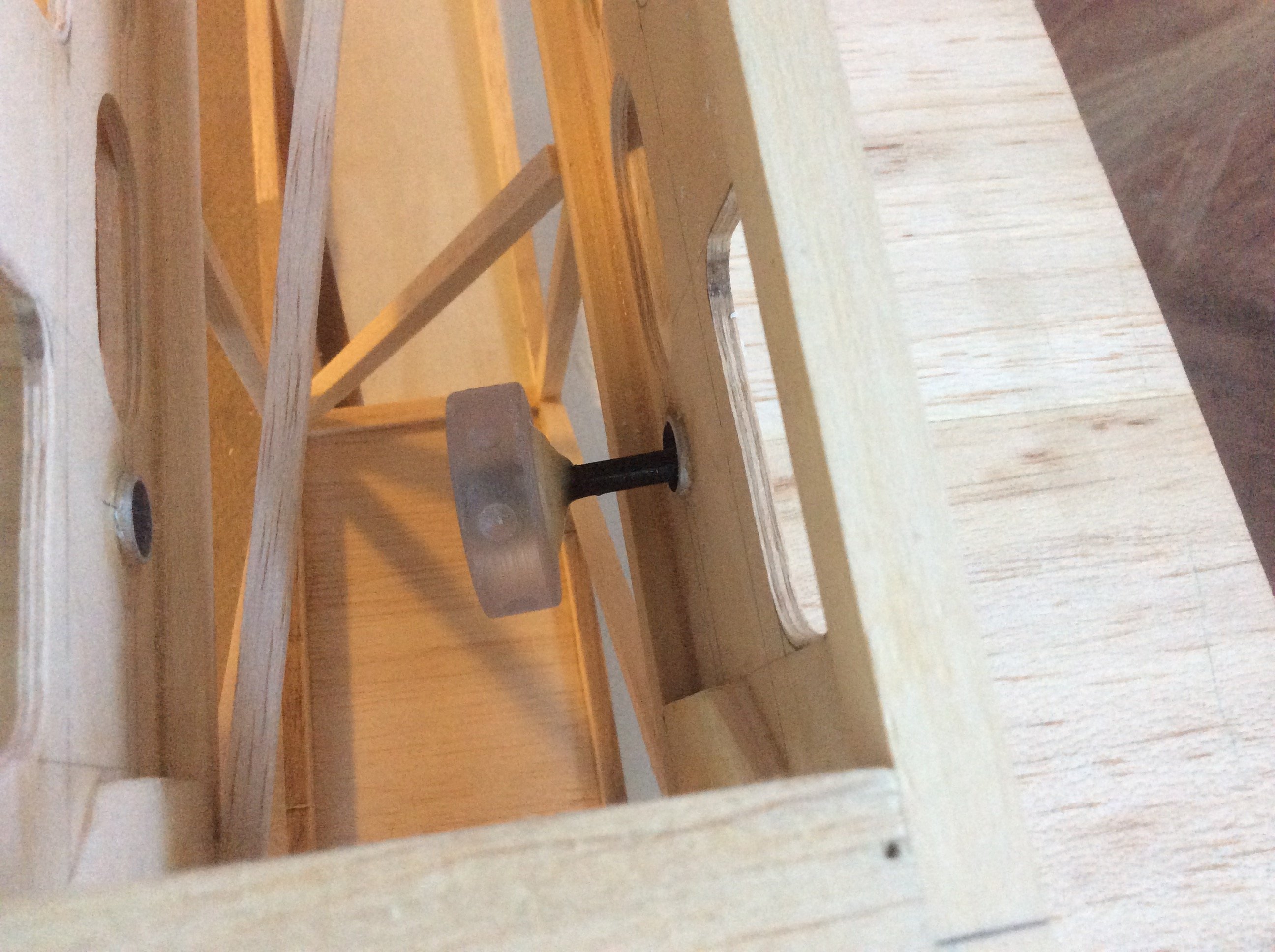

This is the Allen wrench that was made to fit the fuselage and be able to tighten the Allen head screw down the tube.
