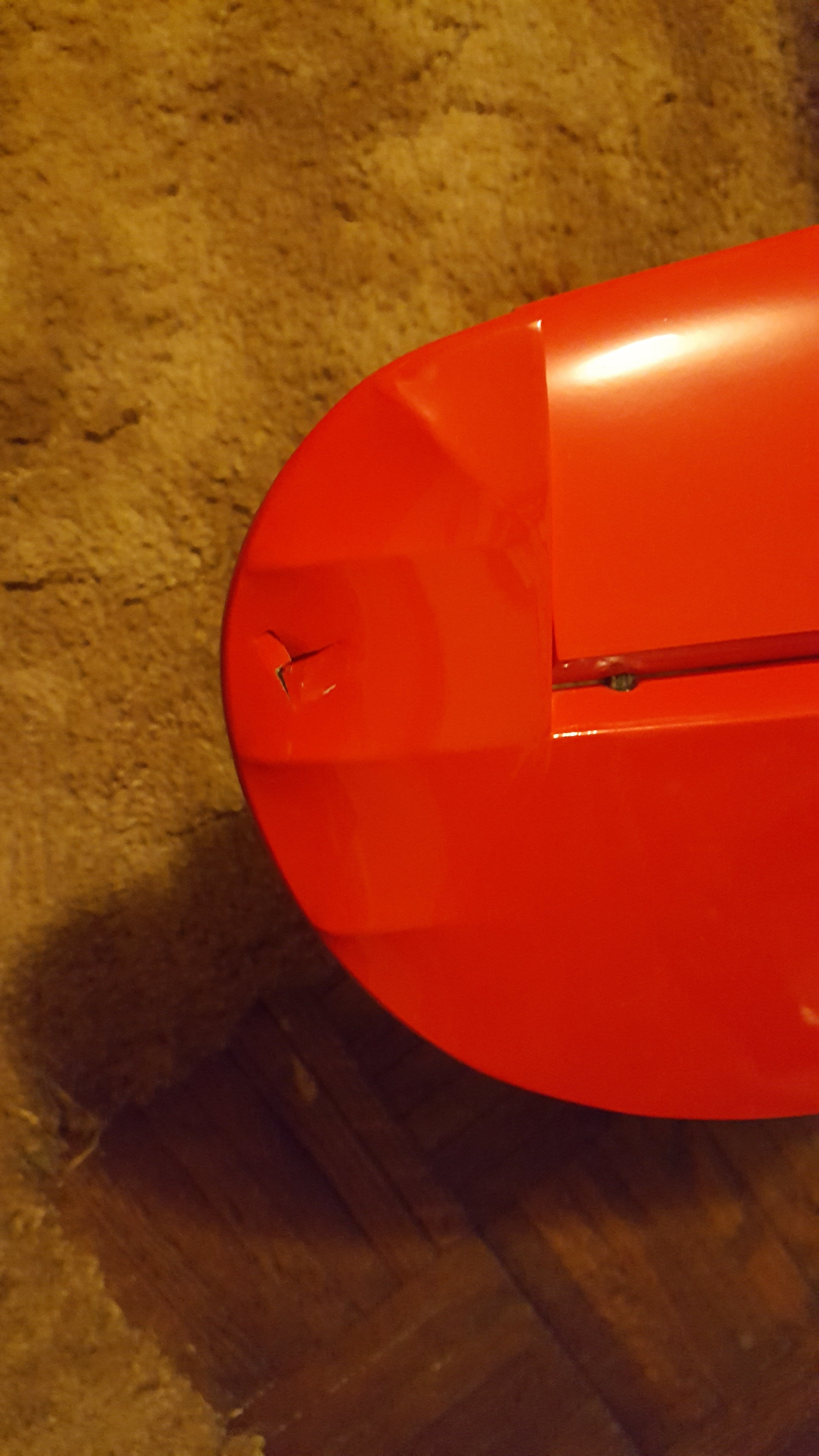

Here is an upcoming workshop project. My 94 year old father dropped something on Miss Moana and poked a hole in the painted Solartex covering on the left elevator.
It'll buff right out. LOL. I am betting he feels as badly about it happening as you are going to feel about fixing it. We all know accidents happen. Lord knows I have made one.... Hee hee…. ok, two. I know you will do an awesome repair Doug.

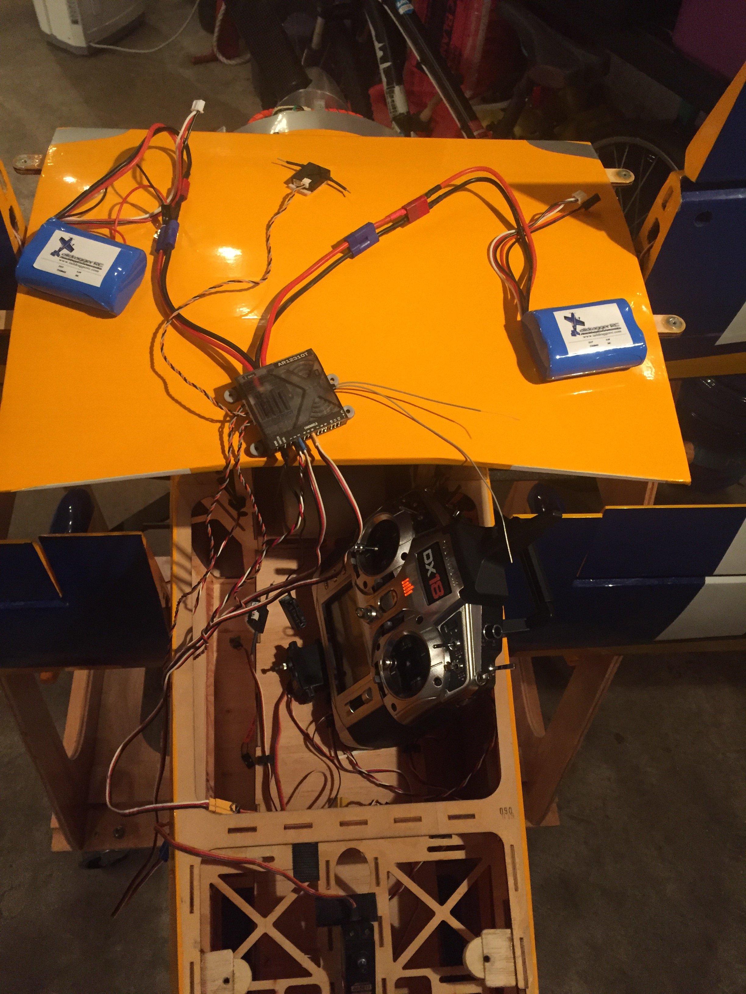

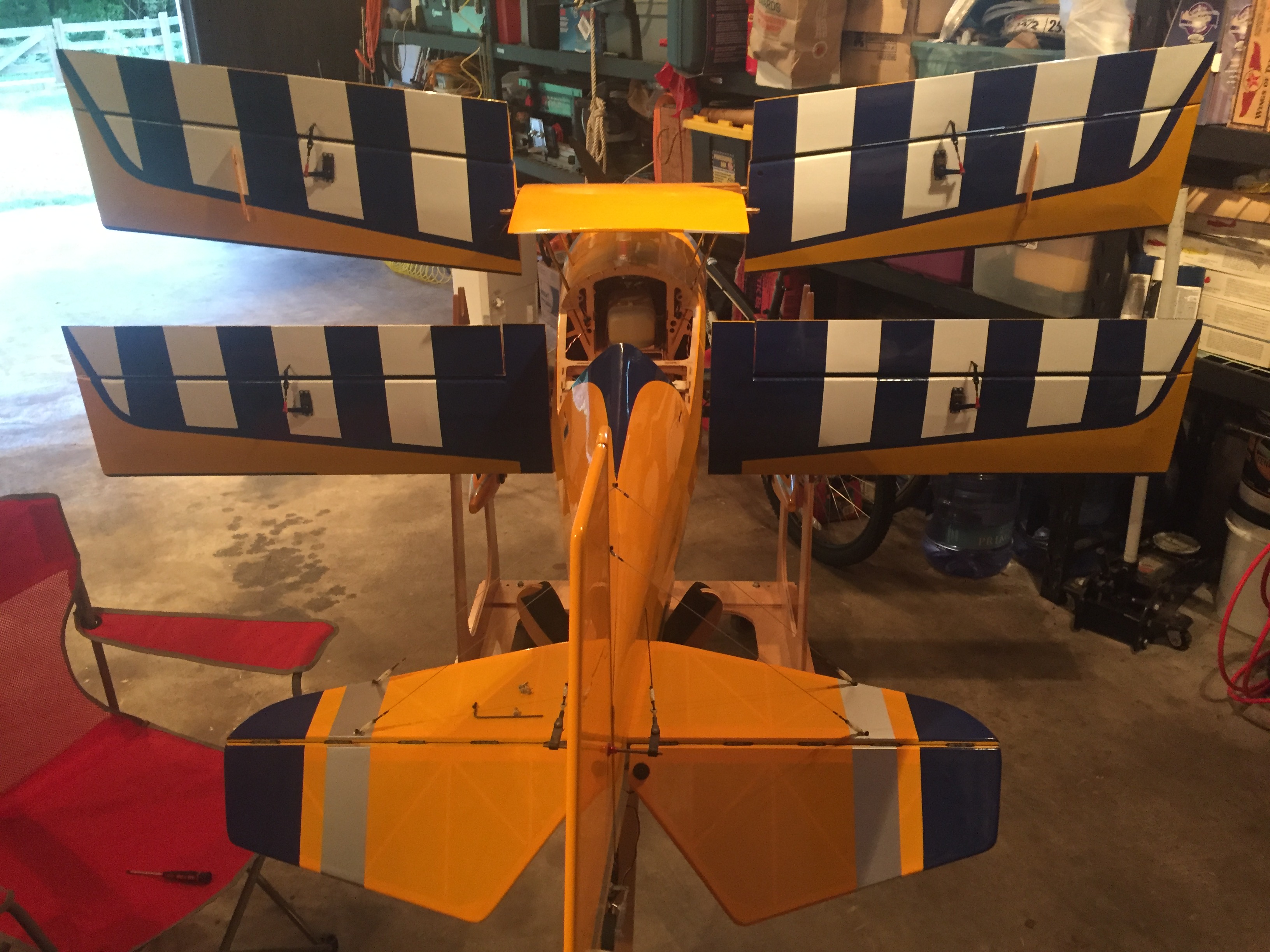

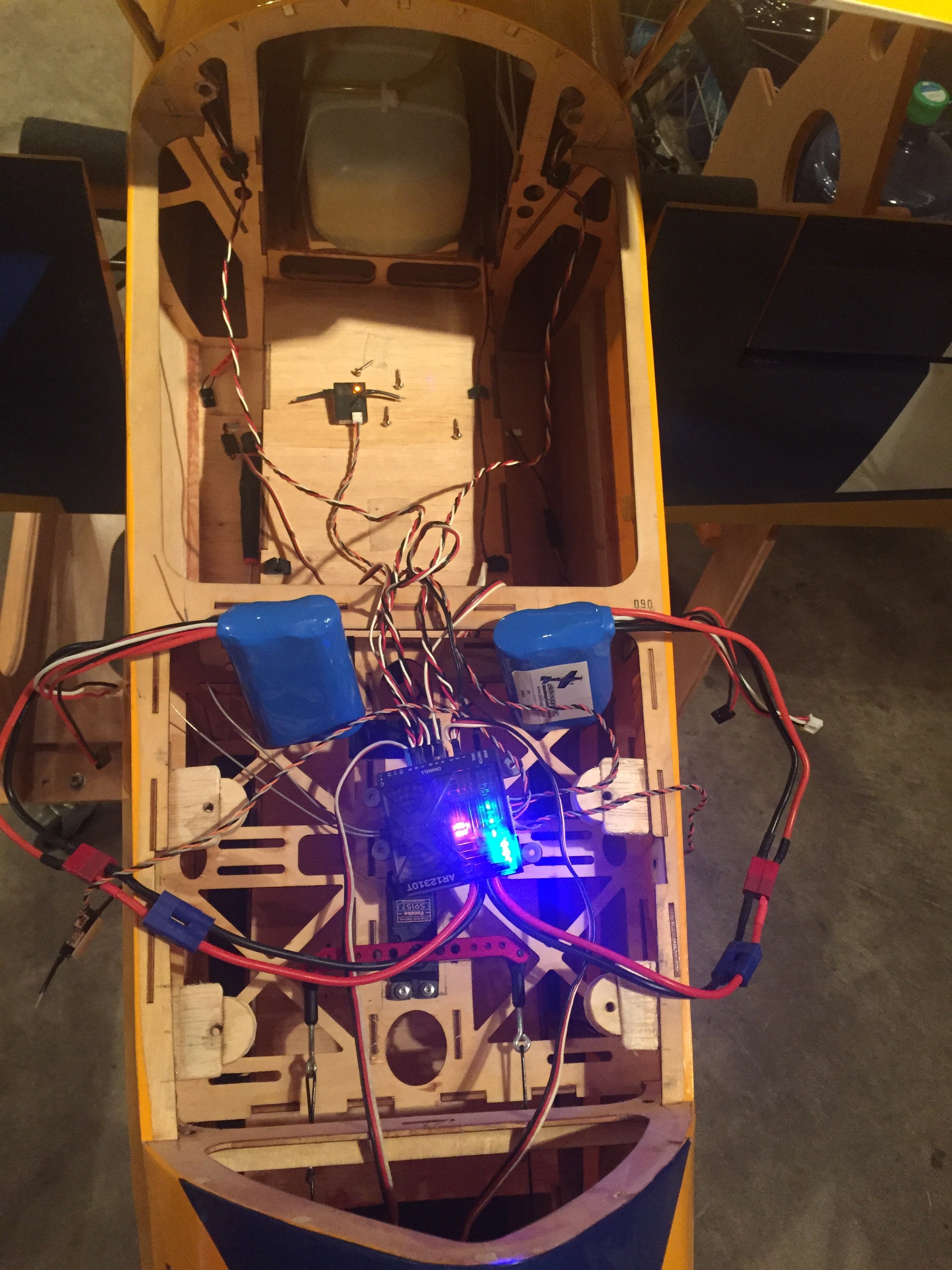

Fun with electronics. Picked up the new to me Python two weeks ago, and now making it mine. When first powered up, one of the elevator servos was dead. The seller generously sent two replacements which arrived yesterday. With both elevator servos changed, then the old batteries, switches and wiring were replaced with a Spektrum Powersafe receiver and new A123s from TDRC. The rest of the night was all about fiddling with adjustments and programming. Today’s efforts will focus on making the wiring tidy and addressing a few other odds and ends. Next weekend, attention will be on the fuel system, once parts arrive from Jersey Modeler. Slowly making progress.

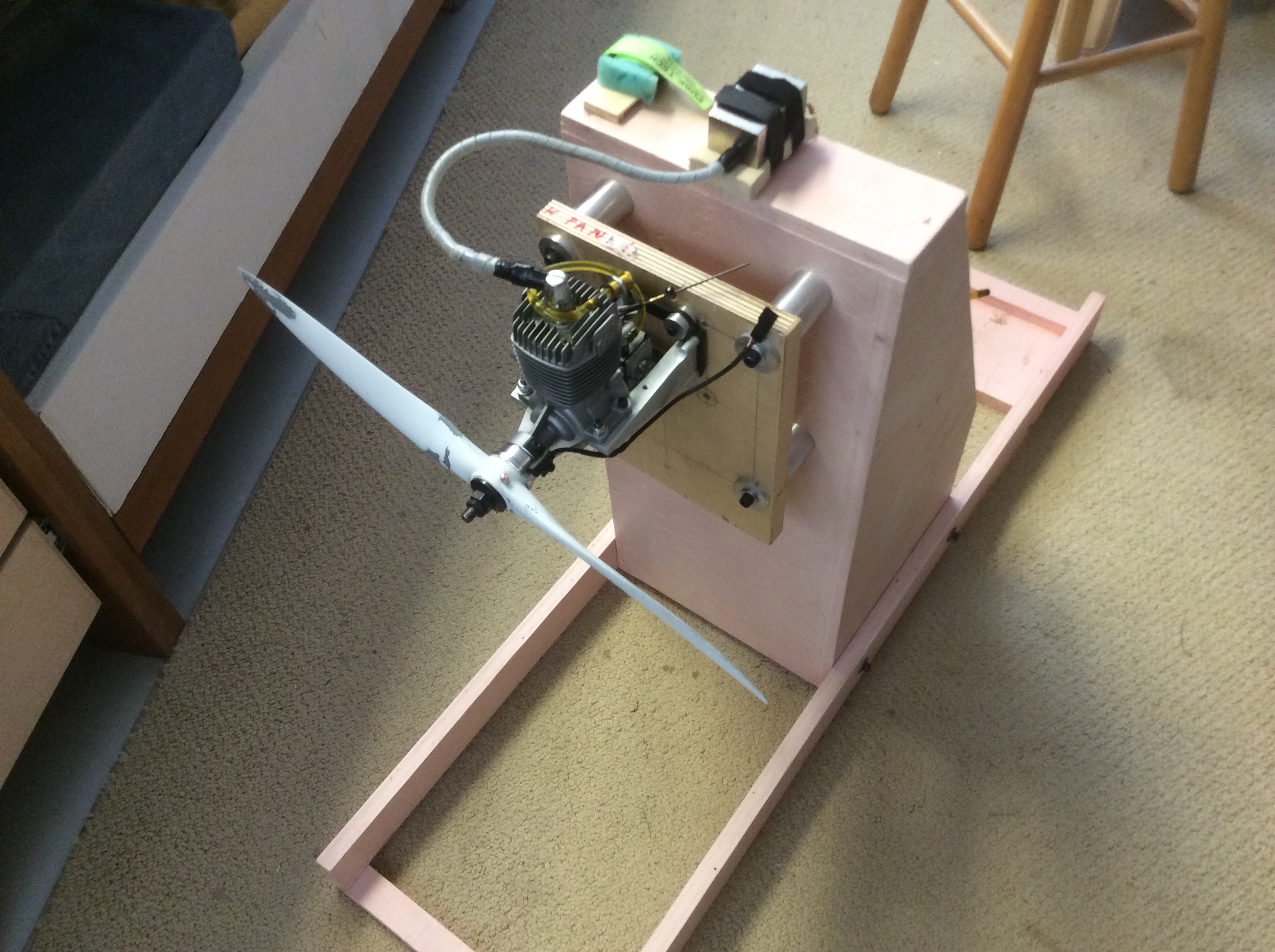

Well been busy in the shop got everything cleaned up from the Demise of the Edge. Will never know I Owen one except for the partial fuselage hanging in shop. Rebuilt the engine today stripped it down washed it with diesel and reassembled the motor. Put a new spark plug cap on the ignition. Made a new choke arm for the carburetor and it should be ready to go. Installed it on the test stand and fired it up tuned it and it ready to go again. Just like new. The only thing I could not fix is there is a dent in the muffler. Will have think about that one, but if I build a 20cc profile for the motor and the rest of the parts the muffler will have to different so when the time comes I will order a new from J-Tec.
