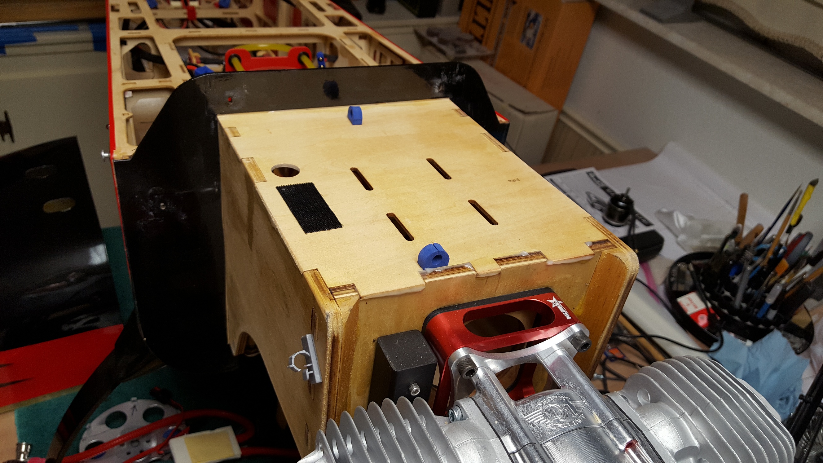

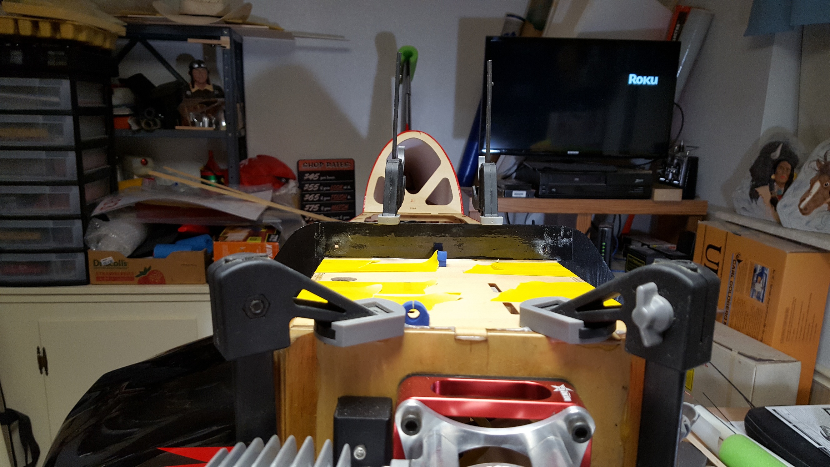

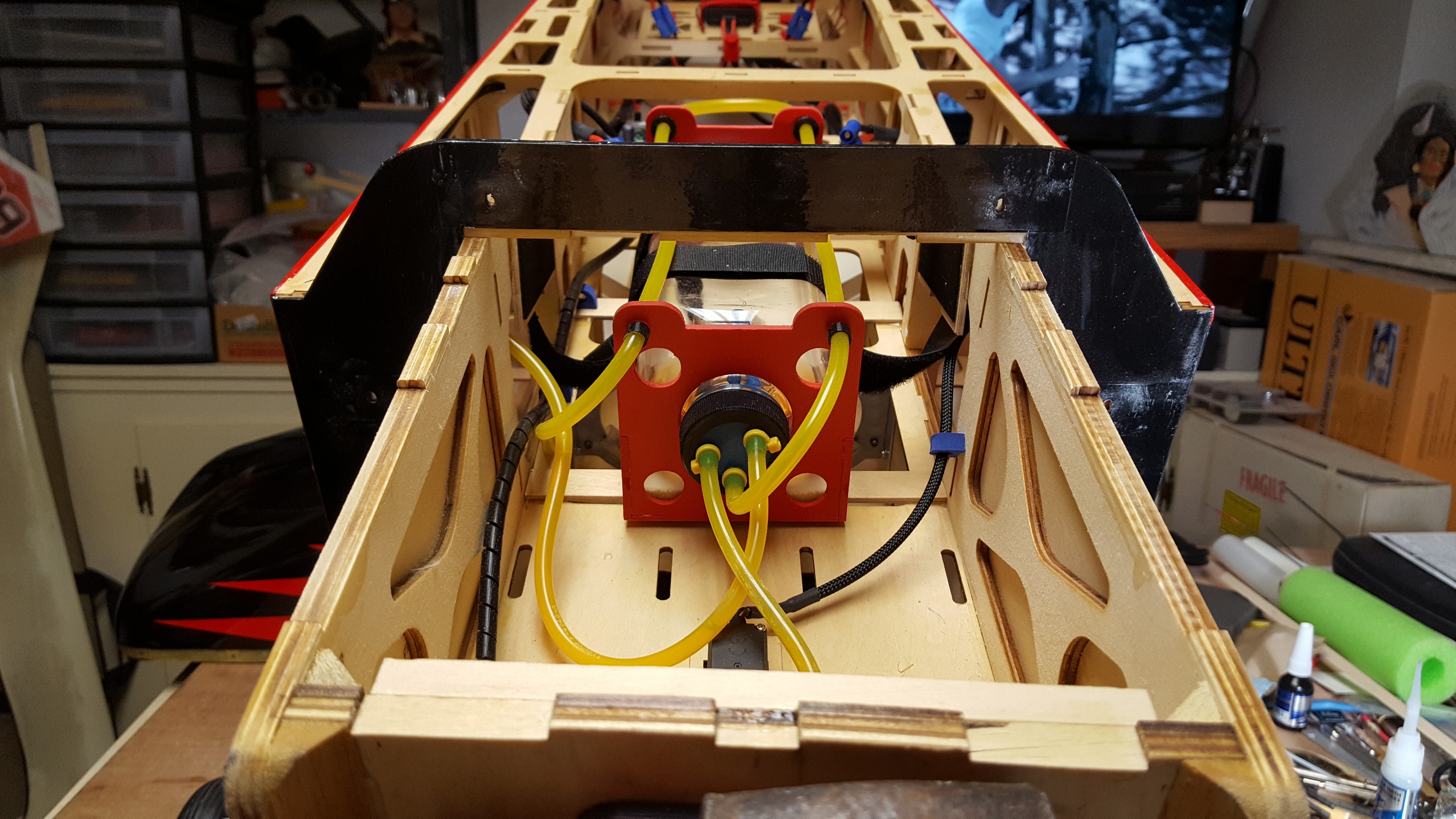

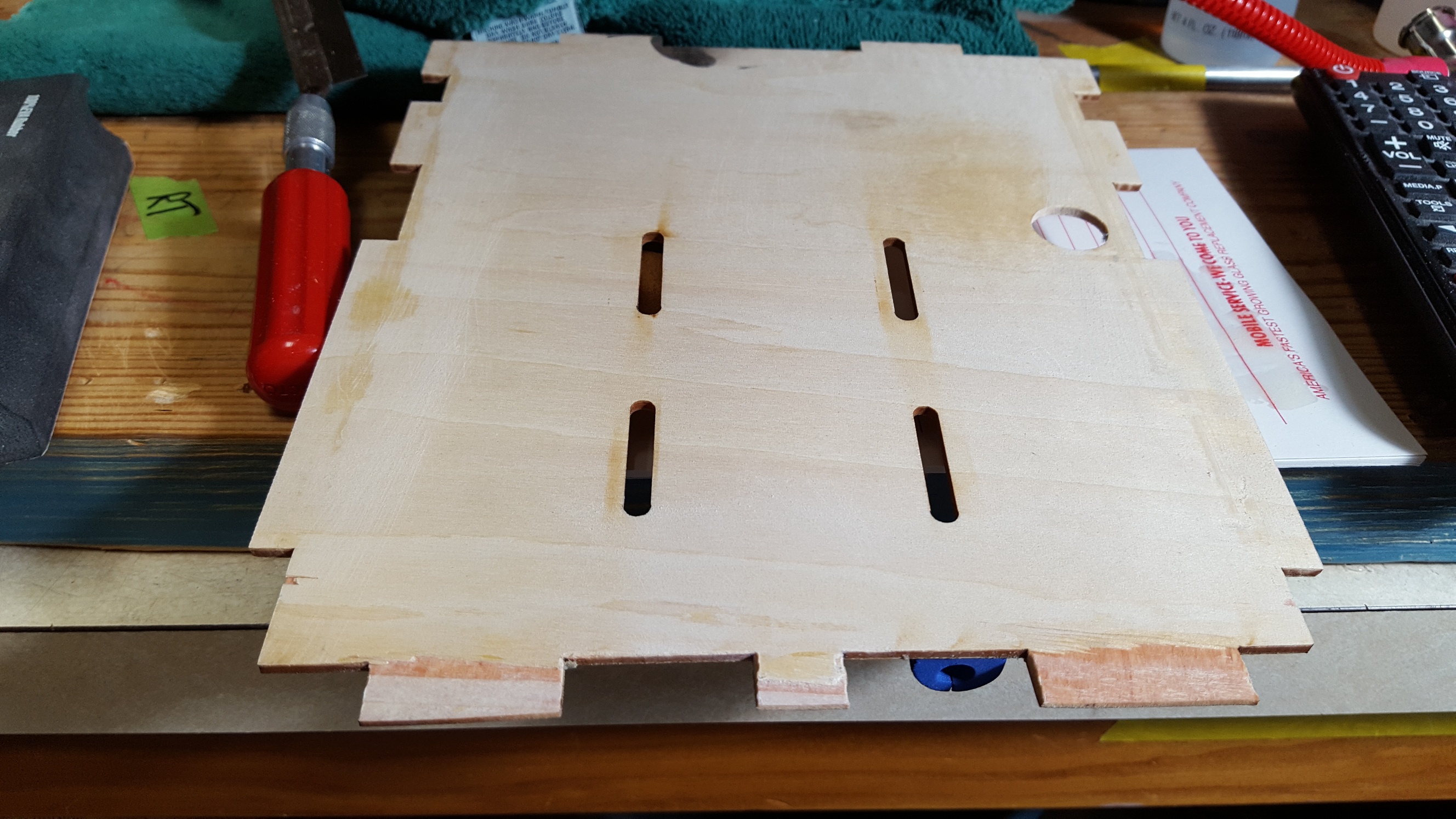

I epoxied the top of the engine box back on my Extra tonight. I also added some triangle stock to to the top of the firewall. It's obvious why it came off if you look at the picture of the top plate. It's upside-down in the photo and it's clear they had no glue at all on the tabs that lay on top of the sides where all the good glue area is. I still have some clean up to do, but I think it will stay on this time.
