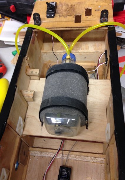

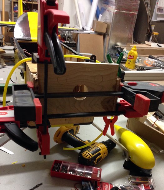

@wecoyote got the fuel tank strapped in place and the firewall glued in place on my Carden Cap 232. Once the epoxy dries I will install the aluminum angle behind the firewall to add extra support.

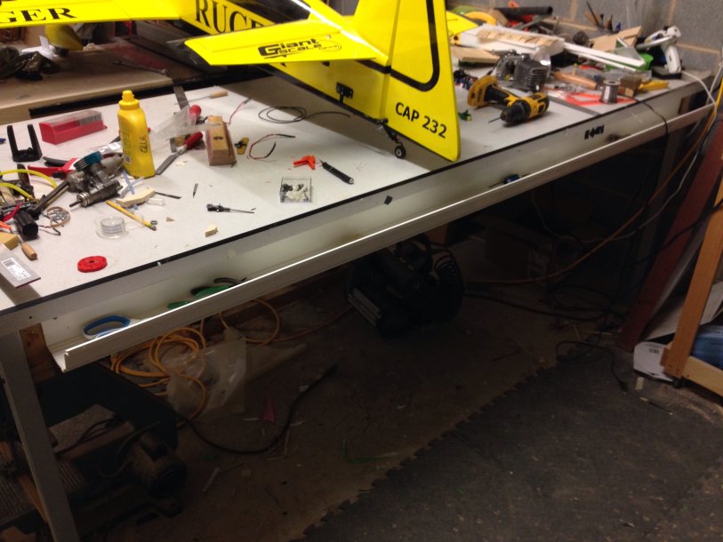

Also another little trick for everyone else. Wife sent this to me on Pinterest and I liked the idea. Go to lowes or Home Depot and pick up a piece of vinyl gutter. A 10' piece was only like $8. Cut it to fit the front of your work bench and then screw it in place. Great place to keep all those tools that get used a lot but you don't want them on your work bench as well as helping catch small parts that may try to roll away.

I have to go to Home Depot today anyway, so I will be getting a piece while I am there :)

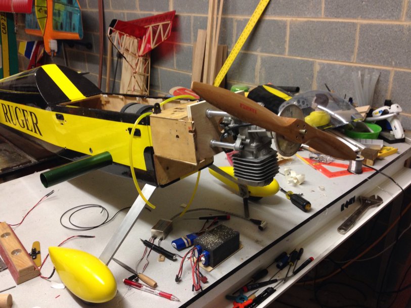

So I got the motor mounted. In all my efforts I didn't get the firewall the way I wanted it but oh well. My buddy I got the plane from said it needed a little bit of down thrust. So I set it to have the right thrust it needed and the down thrust I thought it needed. Well when I line everything up with the cowl it has the right thrust dead nuts on but the down thrust is pretty much zero so I guess I will be adding a washer behind the top two stand offs. Needless I'm happy though. Now to open up the lower cowl a bit to fit around the motor and cut out an opening for the exhaust then I can wrap this baby up and get it ready for a maiden.
