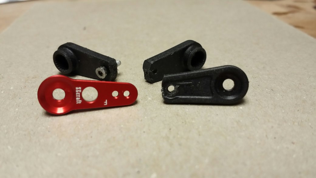

Last night I installed new servo arms on my Goblin 570. The ones that were on it were too short, cut way to close to the ball, and the ball was tightened so much it crushed the plastic arm. After that I went through the setup on the Microbeast FBL controller. If I had the right size 5000-5300mah 6S batteries it would be pretty much ready to fly.

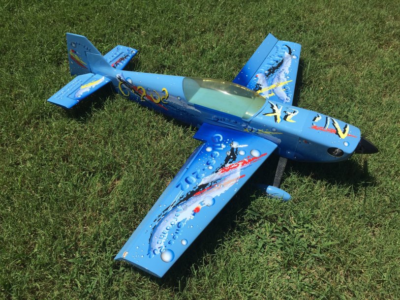

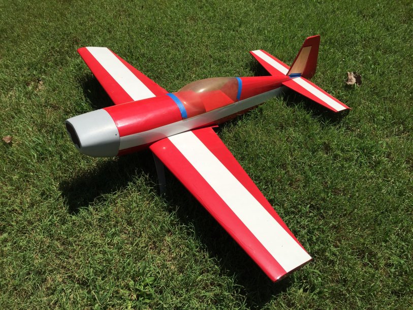

Decided it was time to clear out several airplanes which could be of use to someone else.
Heard about a swap meet coming up where proceeds go to the Wounded Warrior Project. Definitely will look into this.

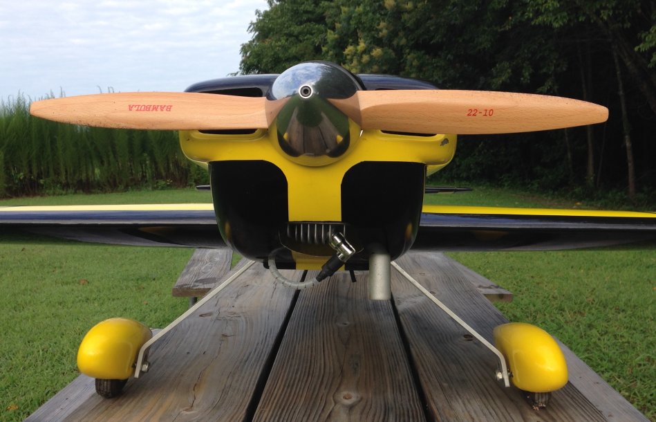

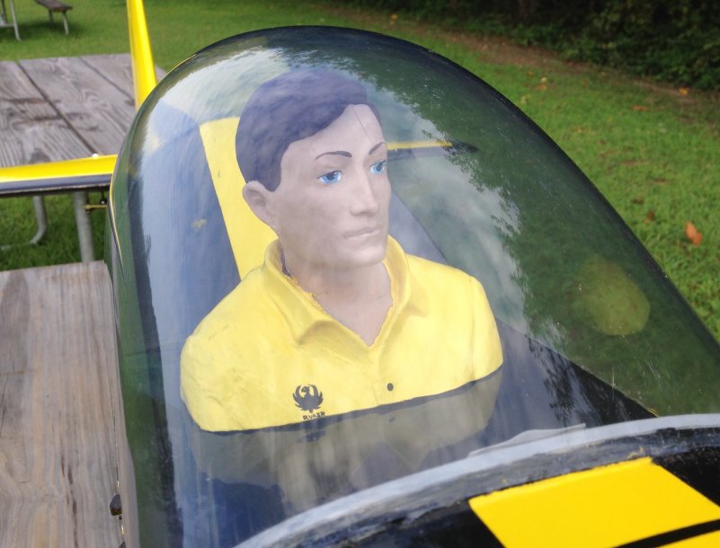

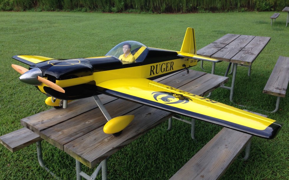

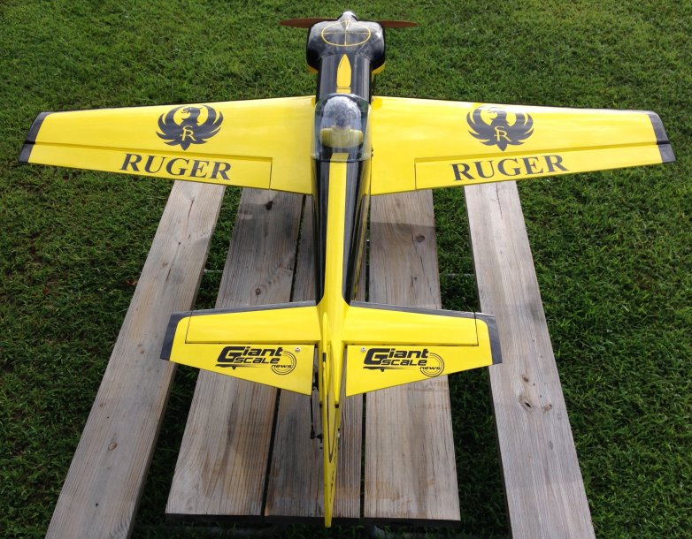

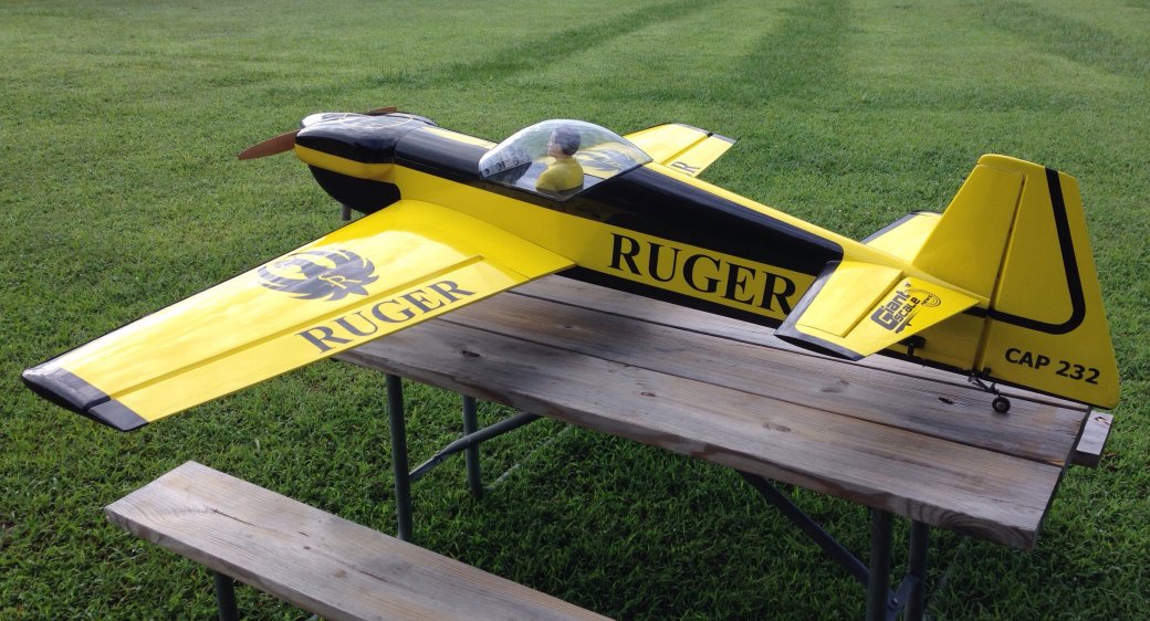

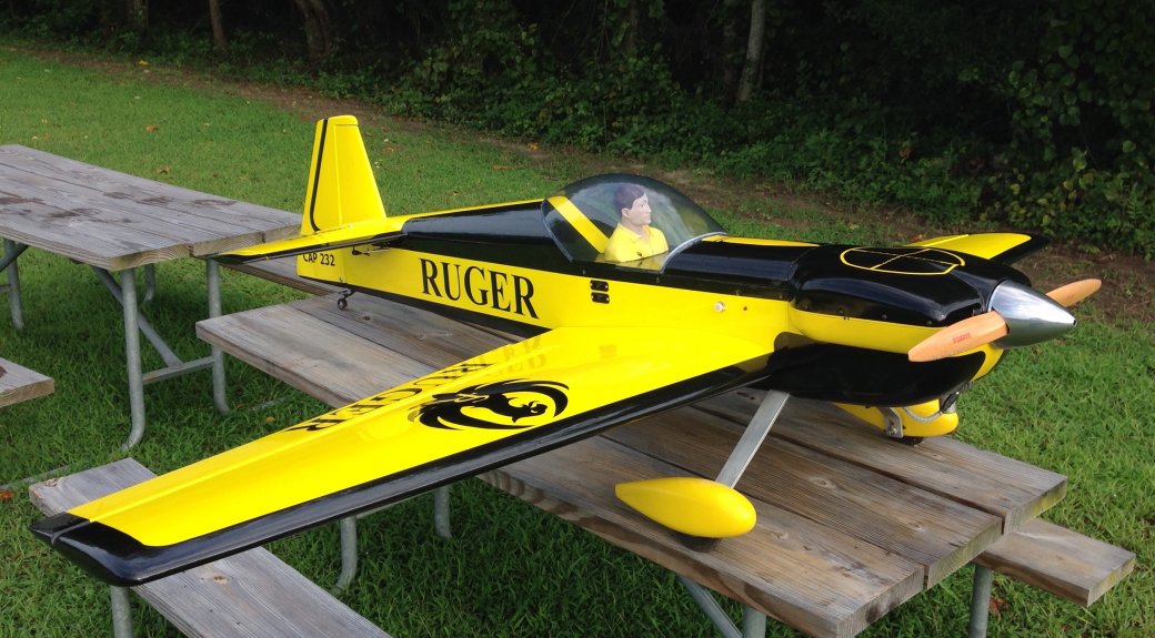

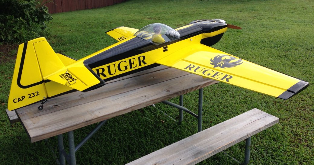

Carden 30% Cap232 pretty much RTF. Picked it up in a trade with @wecoyote Still need to final balance it but other than that it's ready to go. Initial check of the balance shows without my flight batteries in its slightly tail heavy but I expected that. I'm running a dle 55 whereas tom was running a evo58 which is much heavier. What I found the evo is 64oz without ignition and muffler and the dle is 53.9 with ignition and muffler so figure once you bolt those items on and the slightly larger prop the evo could turn I prolly knocked 12oz off the nose. If all else fails and I need more wieght up front I will be moving the rudder servo forward and turning it into a pull pull setup over the push pull it has now.
Will try to get a weight of the plane this afternoon once I wake up from my nap.
