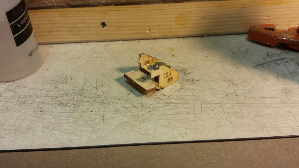

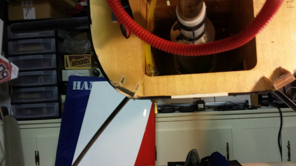

My Pilot Edge has been developing a rattle that I couldn't track down. It sounded like the hatch, which has been an issue in the past when the carbon tube pins wear, but ever since I added the fuzzy side of some Velcro to the fuse where the hatch rests to keep it taut that hasn't been a problem. The cowl bolts weren't loose and the cowl felt secure. I was beginning to think the can mount was coming loose.
Last night I pulled off the cowl and found that the lower cowl mount on the right side had come unglued and was loose in it's slot. I cut away as much glue as I could get to, and ended up having to do a little damage to one side of the bulkhead to get it out. I epoxied it back in with some milled fiberglass in the epoxy. Hopefully it will stay put. While I was at it I wicked some thin CA in the other side and added some milled glass for strength.

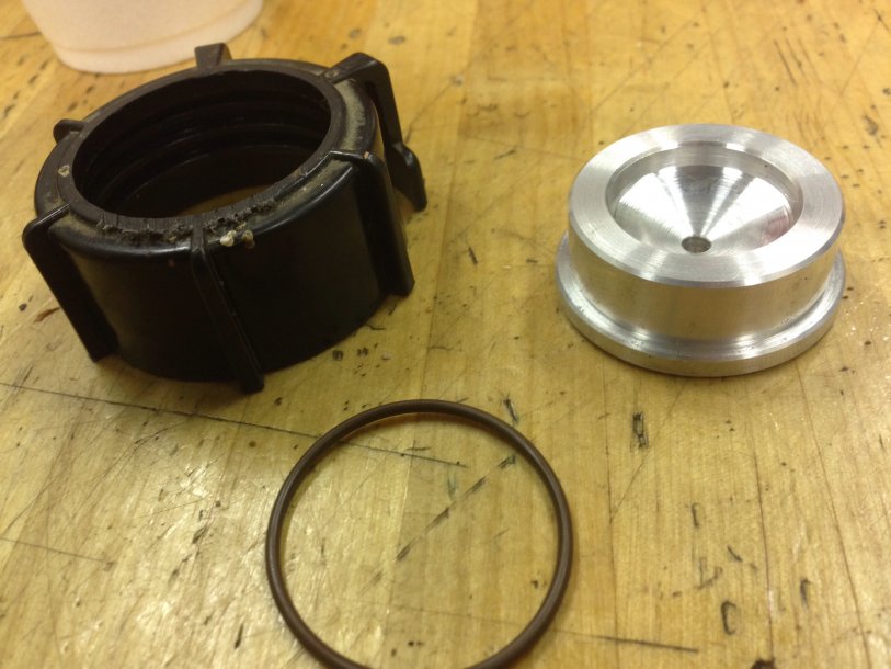

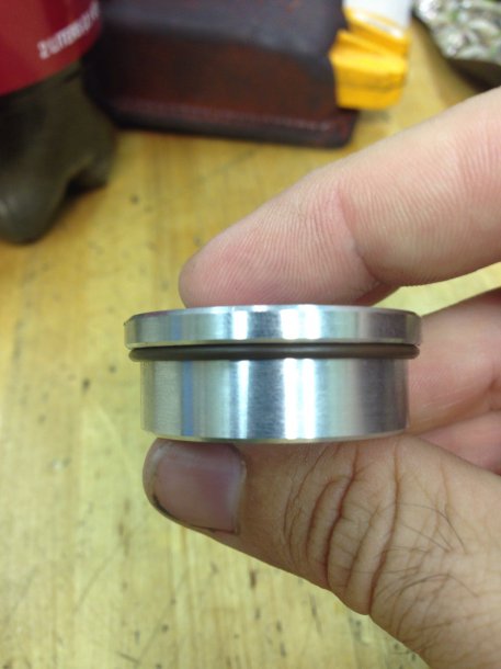

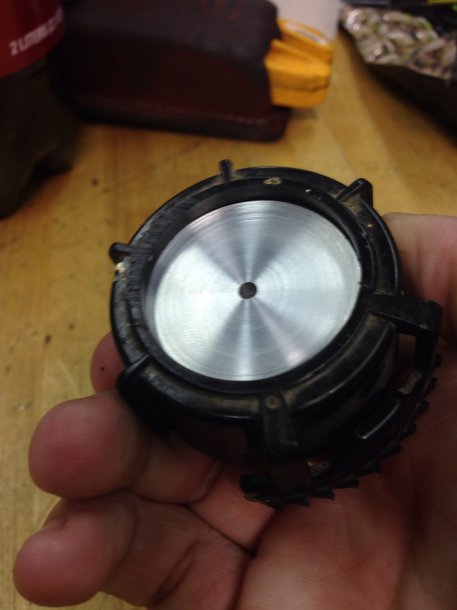

Decided since my first gasser will hit the air this Sunday I needed a propper fuel jug. Took one of my 1 gallon cans and made my own stopper to go under the cap. Even machined a nice grove for the oring to rest in. Once I get home in the morning I will drill the center hole out and tap it to fit one of my brass bulkhead fittings I have on hand.
Also ordered a cheap electric pump from hobby king to try out. Only $7 so what the hell. As soon as it comes in I will fab up a nice little holder for it and a lipo for the side of the tank.

Mine lasted over 2 years before it got loose. My slow and low 3D sucks, so I make up for that by flying it fast and hard.;) I'm not kind to it, and this is the first little issue I've had other than bad axles.
