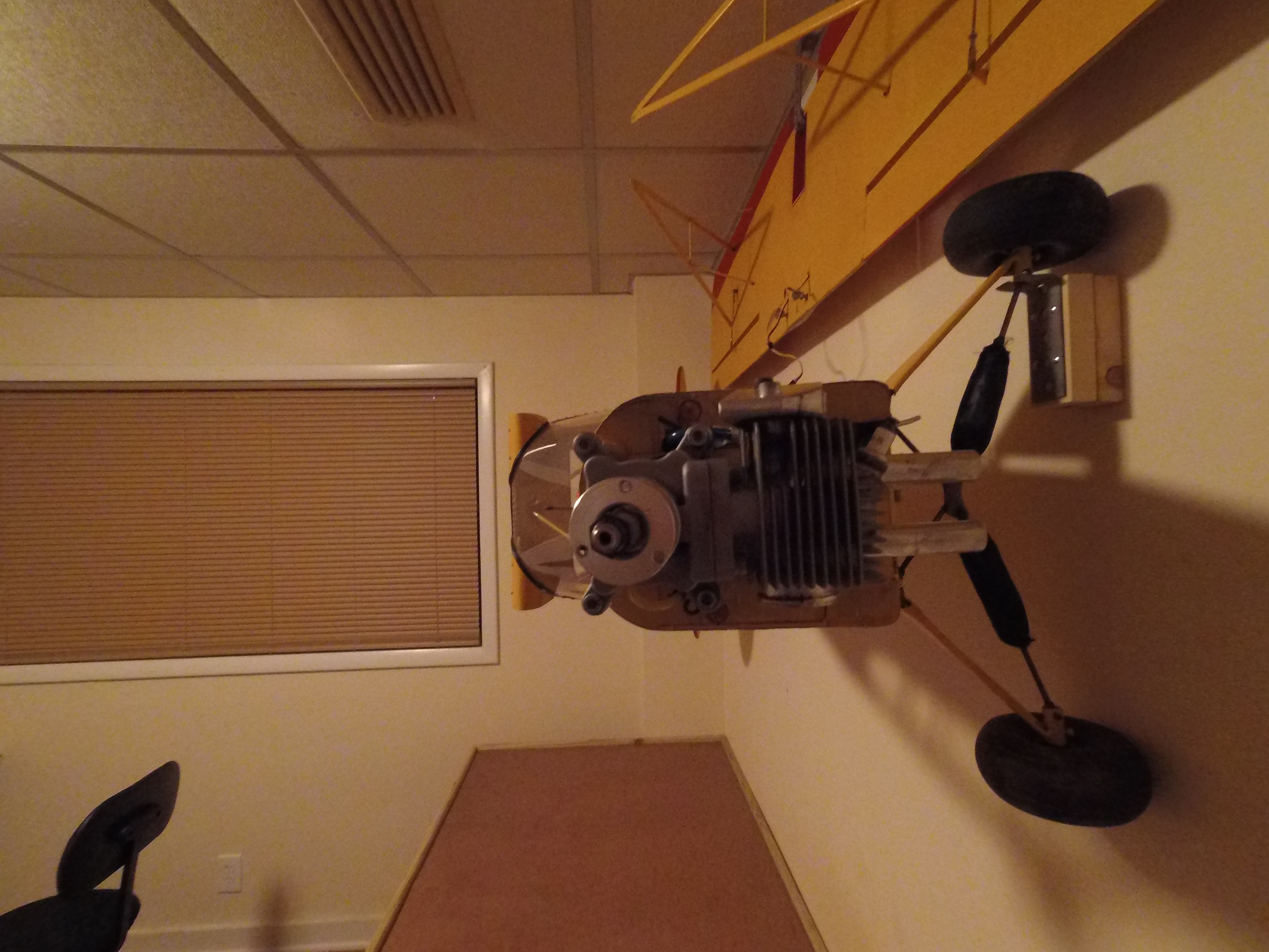

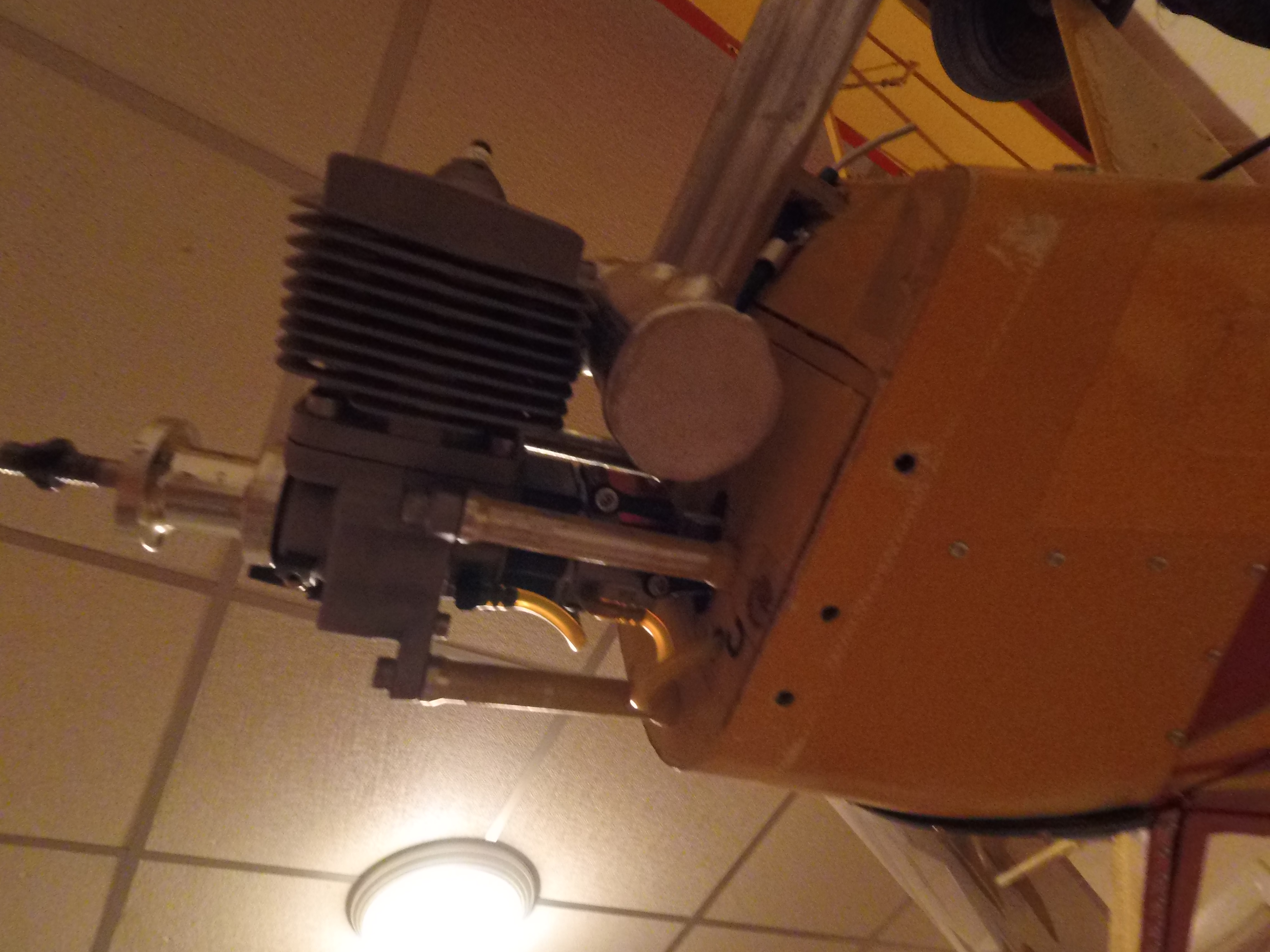

So anybody got a Zenoah G23 or G26 laying around their shop they want to part with? Thinking that will be my best option on the Nieuport kit I picked up.
Not a Zen but I got an RCGF 26. Has a bowman ring, new carb and a custom low profile pitts muffler. A real nice Falcon 18x8 prop comes with it. You will need to get a new ignition for it. I will do you right if you want it.
