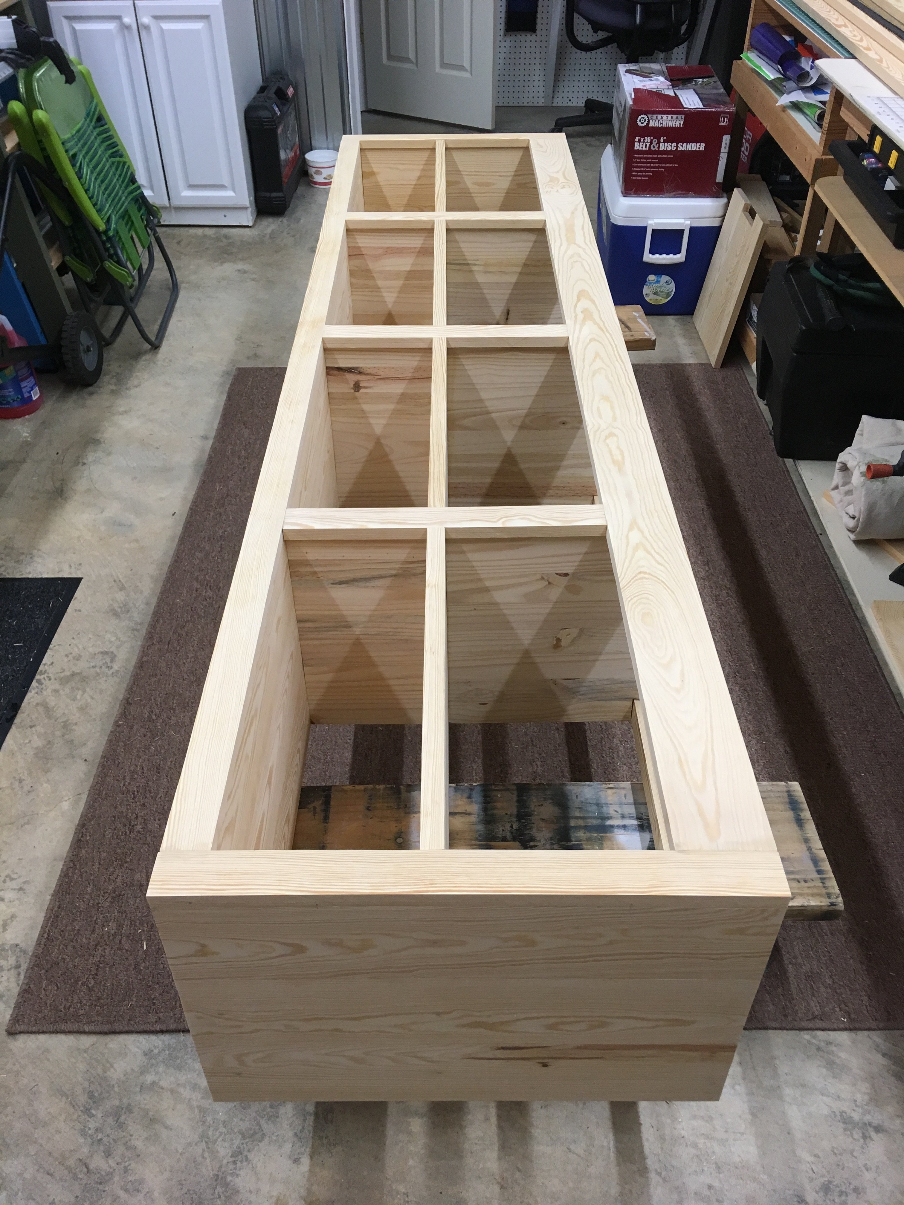

Making some progress on my daughter’s entertainment center.

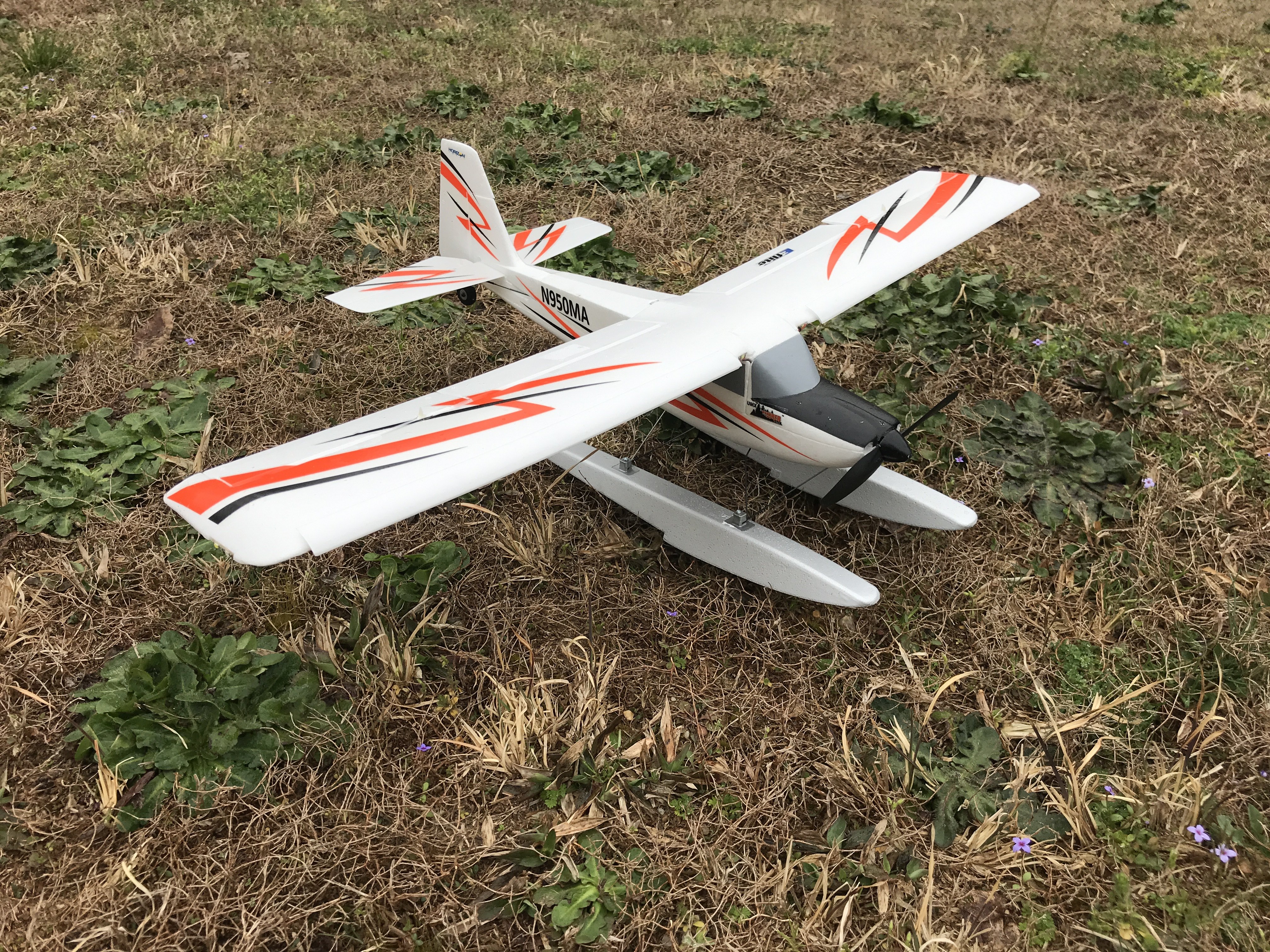

My Timber X is officially on FrSky guidance. Still a little more programming to do though. Got it fully setup with barn door ailerons but now need to get the programming into it for the full span ailerons and once I get the proper 8 channel receiver I will get crow and and full span flaps programmed into it as well.

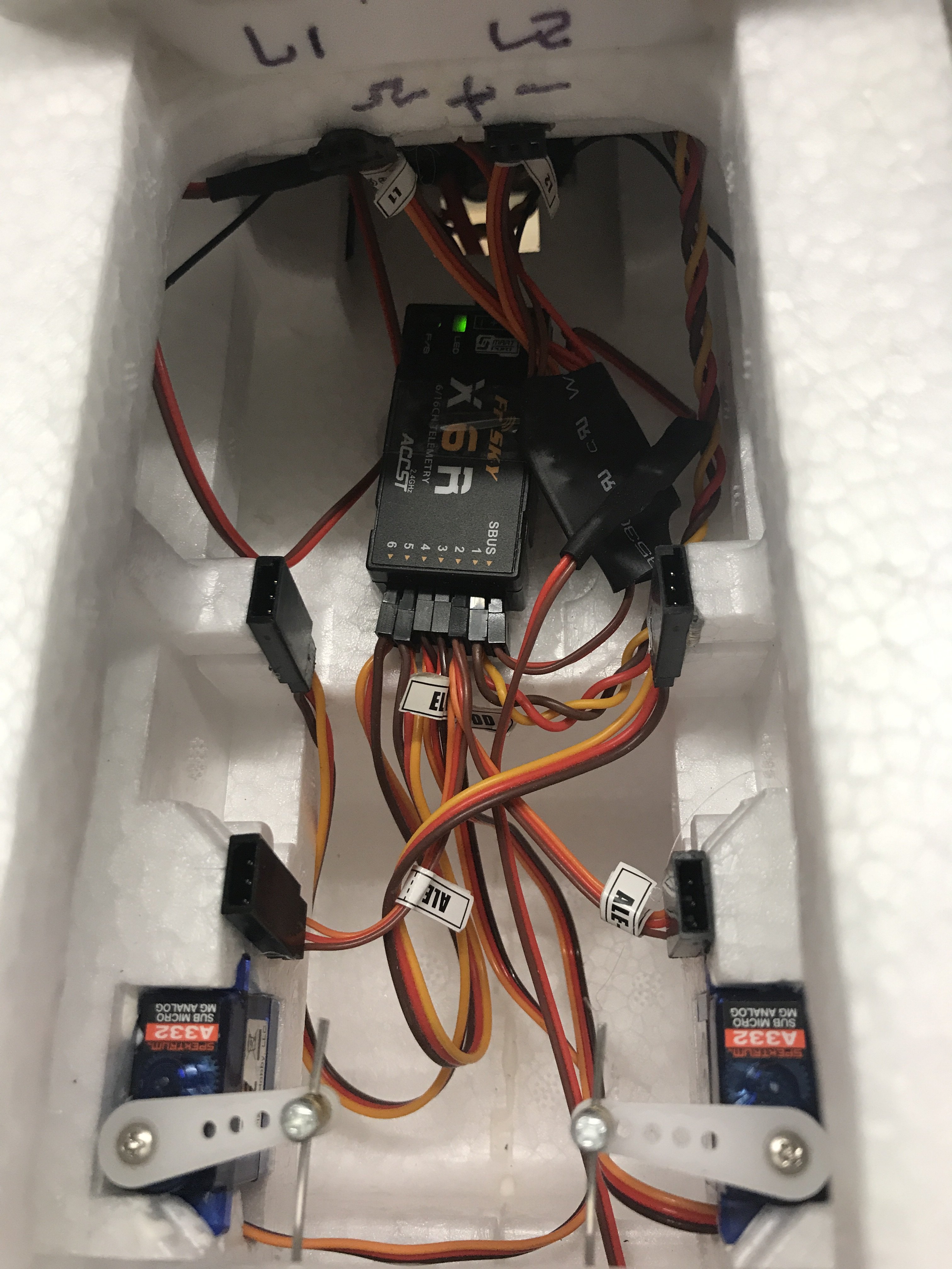

Also there are six different plugs to plug up when installing the wing. To make it a bit easier I hot glued the plugs inside the fuse to the side it goes with to make it easier to hook up at the field.
