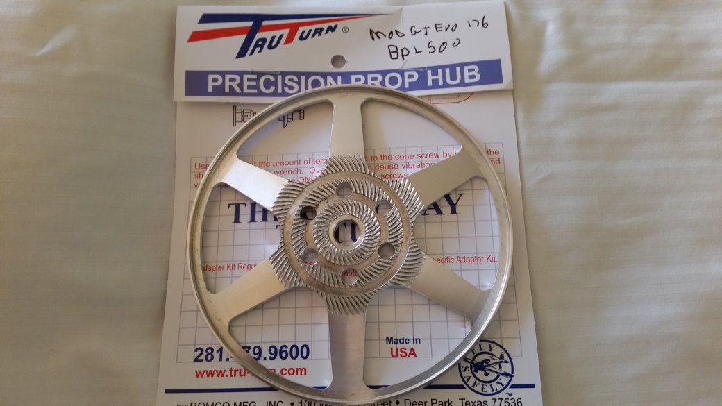

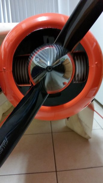

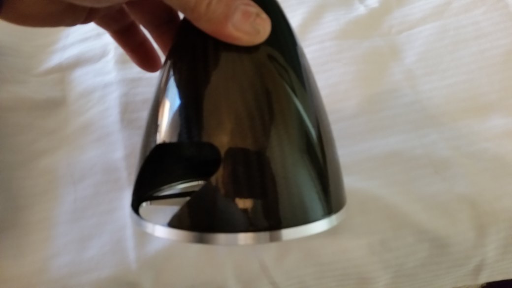

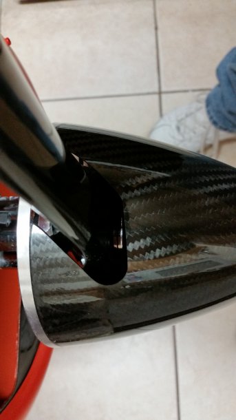

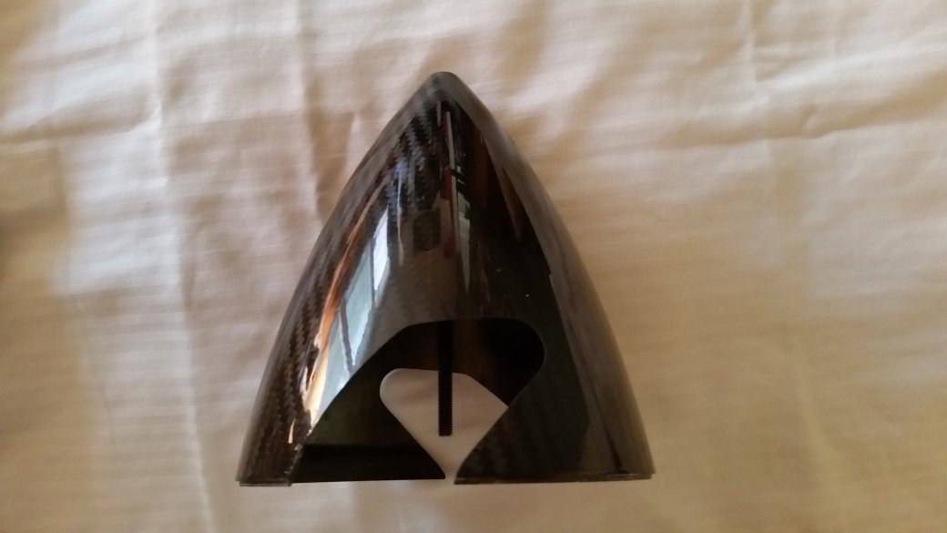

Whoo hoo! Tru turn back plate arrived today. Not only perfectly drilled for the 176 but it also accepted my CF spinner like a glove. Although the spinner was slotted a little larger for the 3W prop, it should be just fine with the Falcon. You all know what happens next! It's flyin' time.
20150217_111932.jpg 20150217_111955.jpg 20150217_112026.jpg 20150217_121741.jpg 20150217_121819.jpg
Yup.... I was thinking that. A little extra "wiggle" room. LOL.... I also "indexed" the back plate just so I can watch the spinner to make sure it is not slipping into yet another brand new prop. :way_to_go:
Stats: I so wanted to go flying today. 65 degrees...3mph winds. Not a cloud to be found. Oh but no...things to do. I did however do some run ups on the Sukhoi. Low needle needed a bit of a tweak on the rich side. Transition nearly perfect compared to the maiden flight. High speed also needed just a tick rich. With the Falcon 32x11, it is now twisting 5900 static. Temps are right at 220 on the ground. I expect a much more manageable prop usage with the Falcon.
