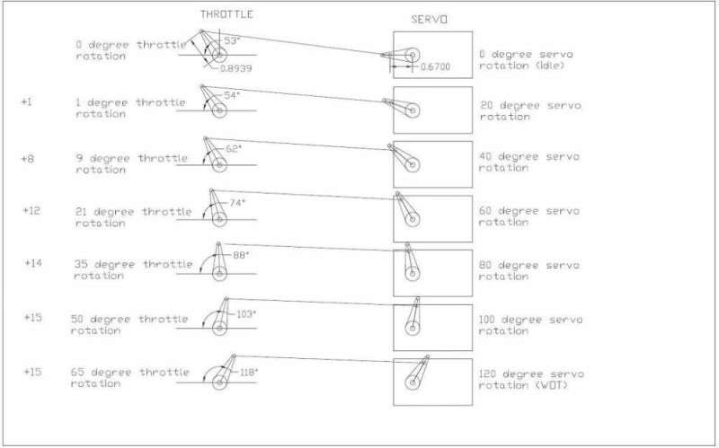

hey rob i was just wondering around the site last nite and saw this whole "ask joe" thread....i dont know how he gets his own friggin thread, who is this joe kid anyway? HA!...im not sure if you are still subscribed to this thread or not but i had the same issue with my gas 89/dx7....so heres the story...wrote a song about it, wanna hear it?, here it go....
as we all know theres no throttle curve on macro on the dx7...bobby (bobby808813) on rcg http://www.rcgroups.com/forums/member.php?u=272809 sent me a diagram of how to *properly* set up a throttle linkage. I have no idea how joe flies with no curve unless he has his linkage set up like the one in the diagram bobby sent me cuz the curve on gas is TERRIBLE if its not set up right. I mean i guess it can be done once you get used to it but in this diagram it makes the throttle curve super smooth and linear just like an electric....if i still had the diagram i would post it somehow but i dont think i do..ill peek around and see if i can find it...you will be amazed what the geometry will do with no curve....
aronph
ThrottleGeometry-1 (1).jpgi found it
aronph
i followed this as closely as i could and didnt feel the need for a throttle curve after i got it tweeked where i wanted it...trust me...try it

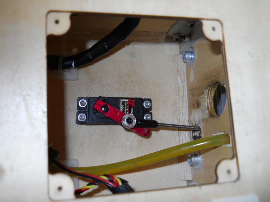

Thanks for the info Aron, I had that link sent to me. I was able to get pretty close to that point but when going back to electrics the still felt soft. So I have it in my new radio and got 1 flight with a bit of expo. Then others were using 40% so I matched the 40% to another graph on my radio(I have to manually input the expo, can't just way use 40%). Waiting for the rain to stop around here to fly again.
The pic shows my idle position.
Rob

aronph
thats close to how mine is but th servo arm is allmost all the way lined up with the servo...if the arm was straiter you wouldnt need th curve maybe?
