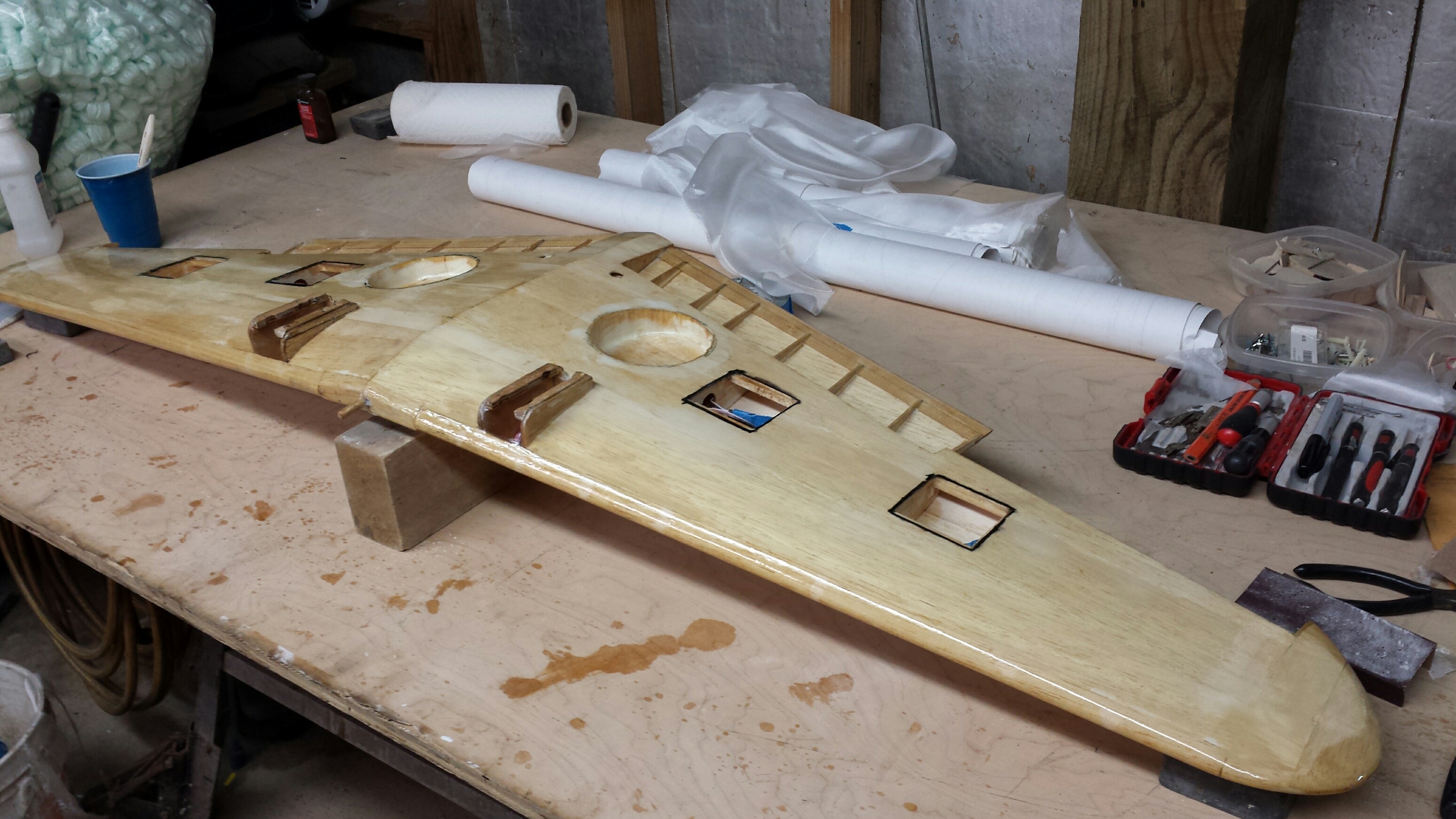

The third and last finish coat of resin on the underside of the wing, 20150306_193652_resized.jpg

Dont worry your English is better than my Dutch. Judging from you log it looks like we are in the same spot in the construction. Would you mind weighing your wing and Ill weigh mine to see how much weight the glass added.

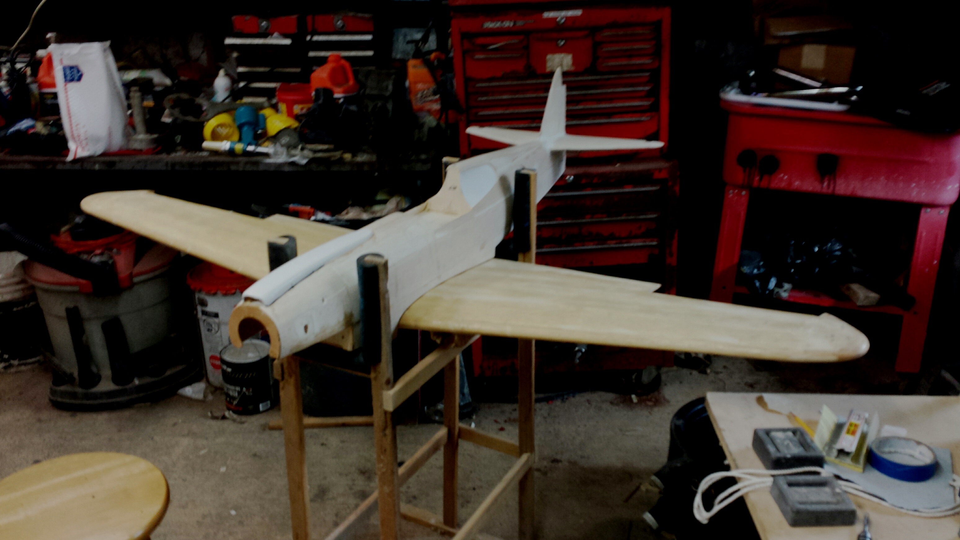

Pictures are more need than real life ;) it is my first wood build. and there are some points i will do better next time.
My wheel wells are not exact circle. becouse i make them to much to the left side the wheels did not fit. Things like that. But i am happy overall.

If it will make you feel better it is my first build since 1960. Your work is very clean and looks good. I centered the wheel cut out with the axle then used a 4 in whole saw to mark the wells. then cut them out.

My wing is 716 gram (25,25 oz) inclusive 4 servo cables.
It is like your photo without the belly pan.
i am curious how mutch the glass adds.

The wing glassed weighs 1020g so the glass weighs 304g so inceases the weight by 42%
