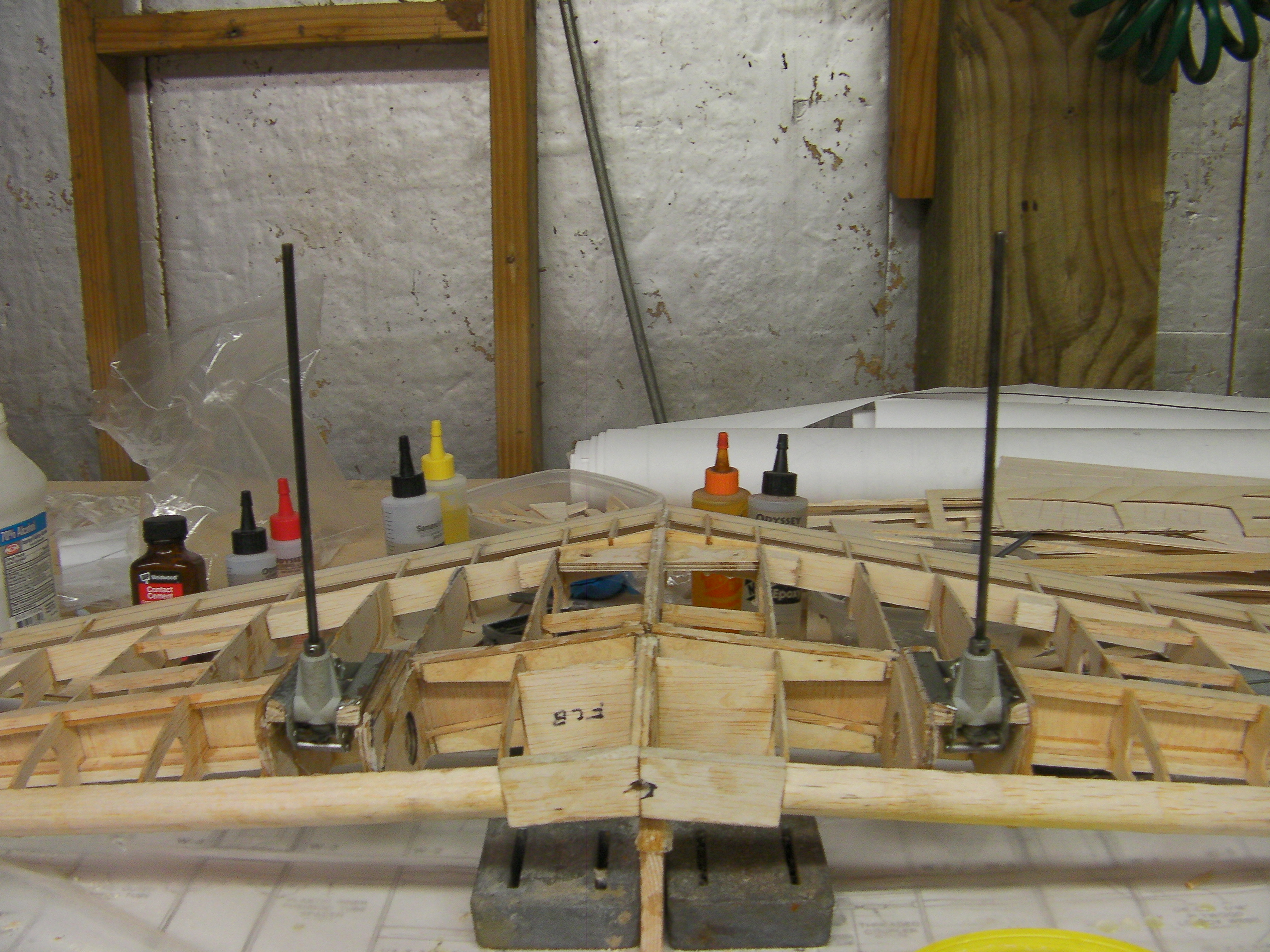

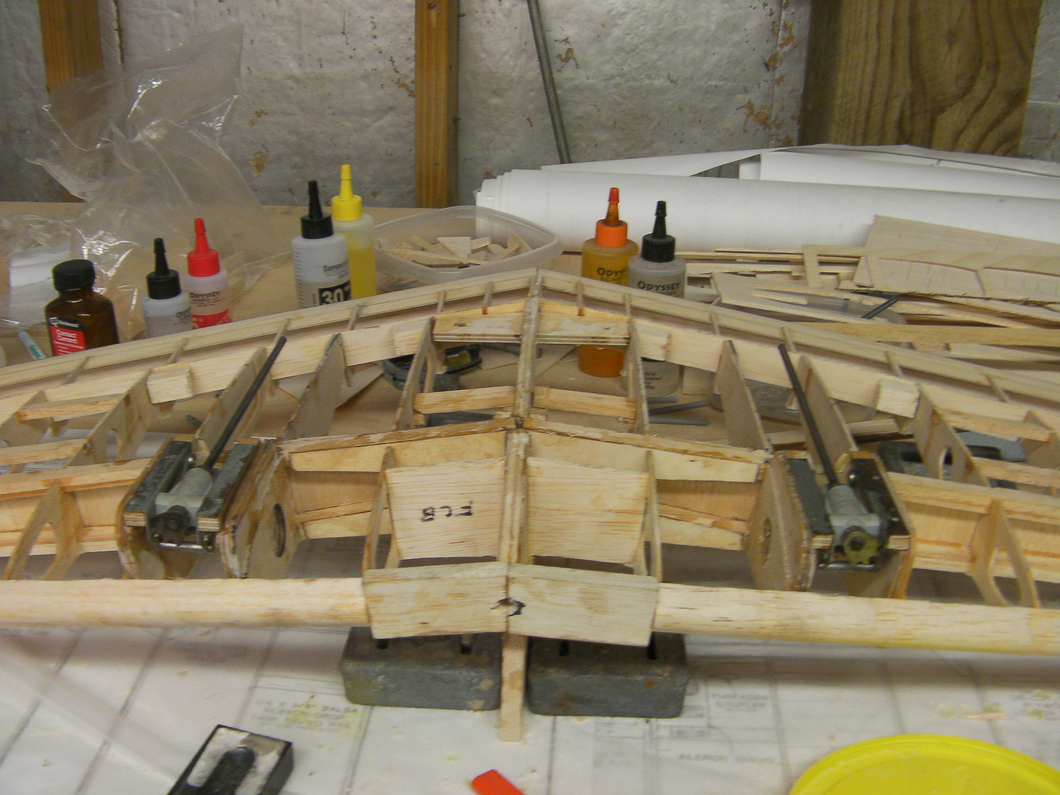

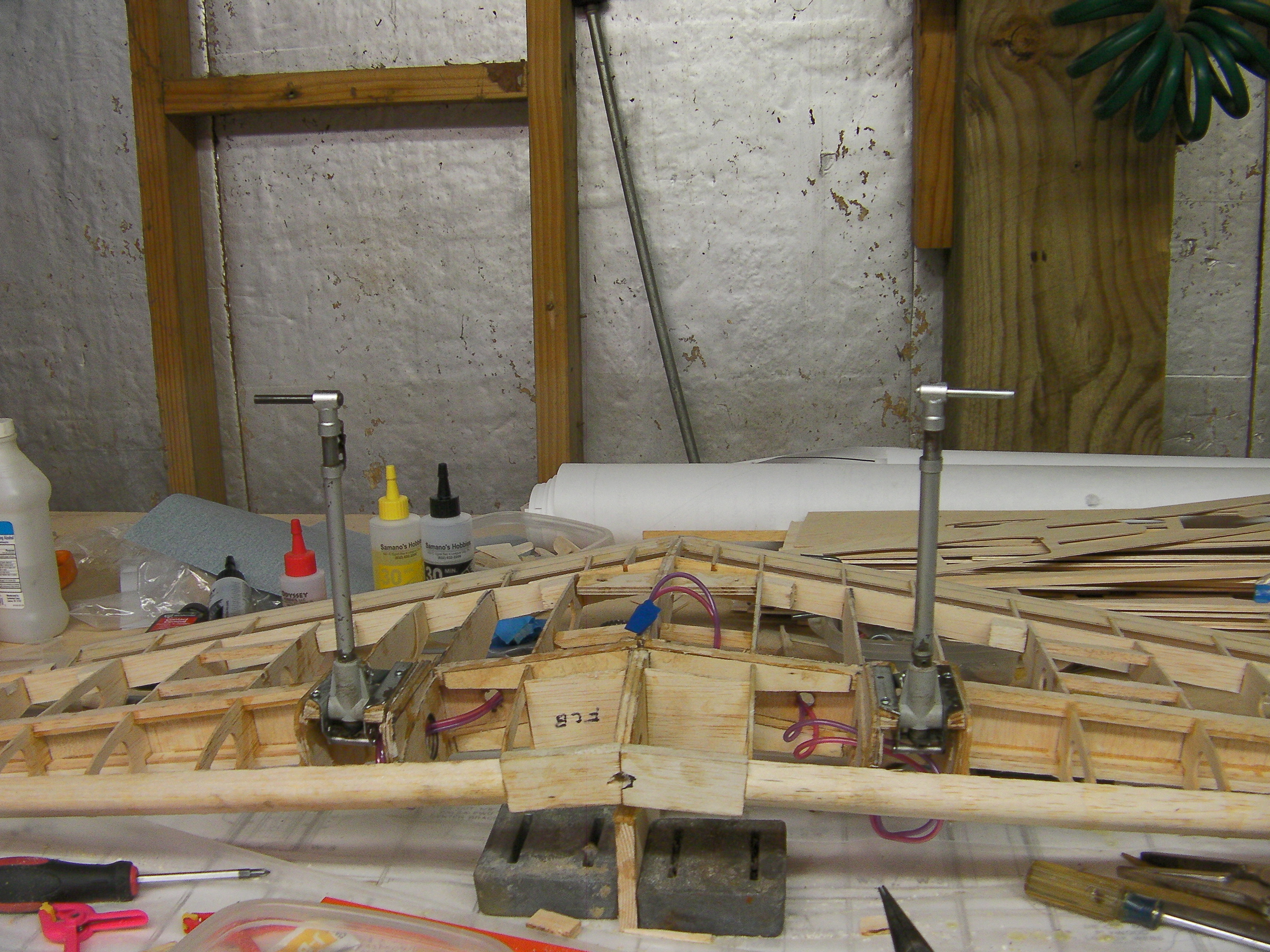

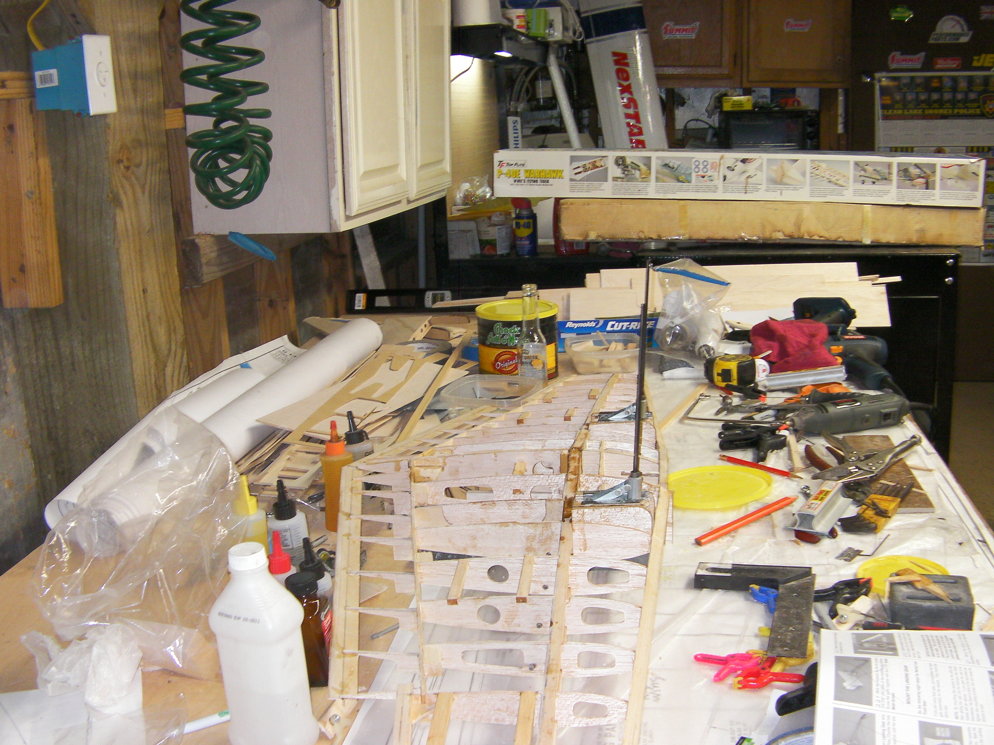

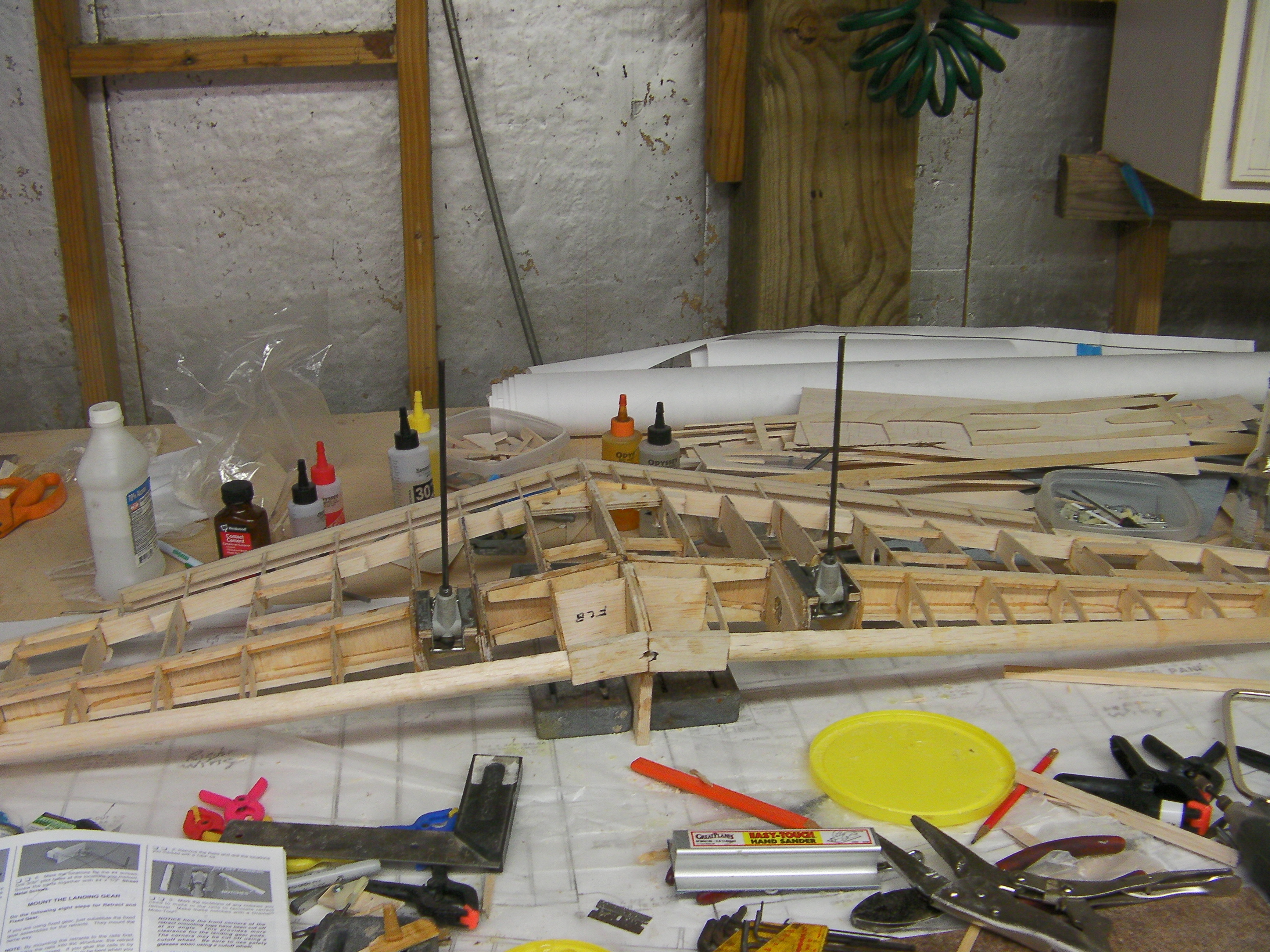

Worked for a couple hours and got 2014-09-07 20.26.09.jpg2014-09-07 20.26.52.jpg2014-09-07 20.24.26.jpg2014-09-07 20.34.41.jpg2014-09-07 20.35.43.jpg2014-09-07 21.01.58.jpgmy rusty old Robart retracts mounted then after everything fitted the mounts were epoxed in place.

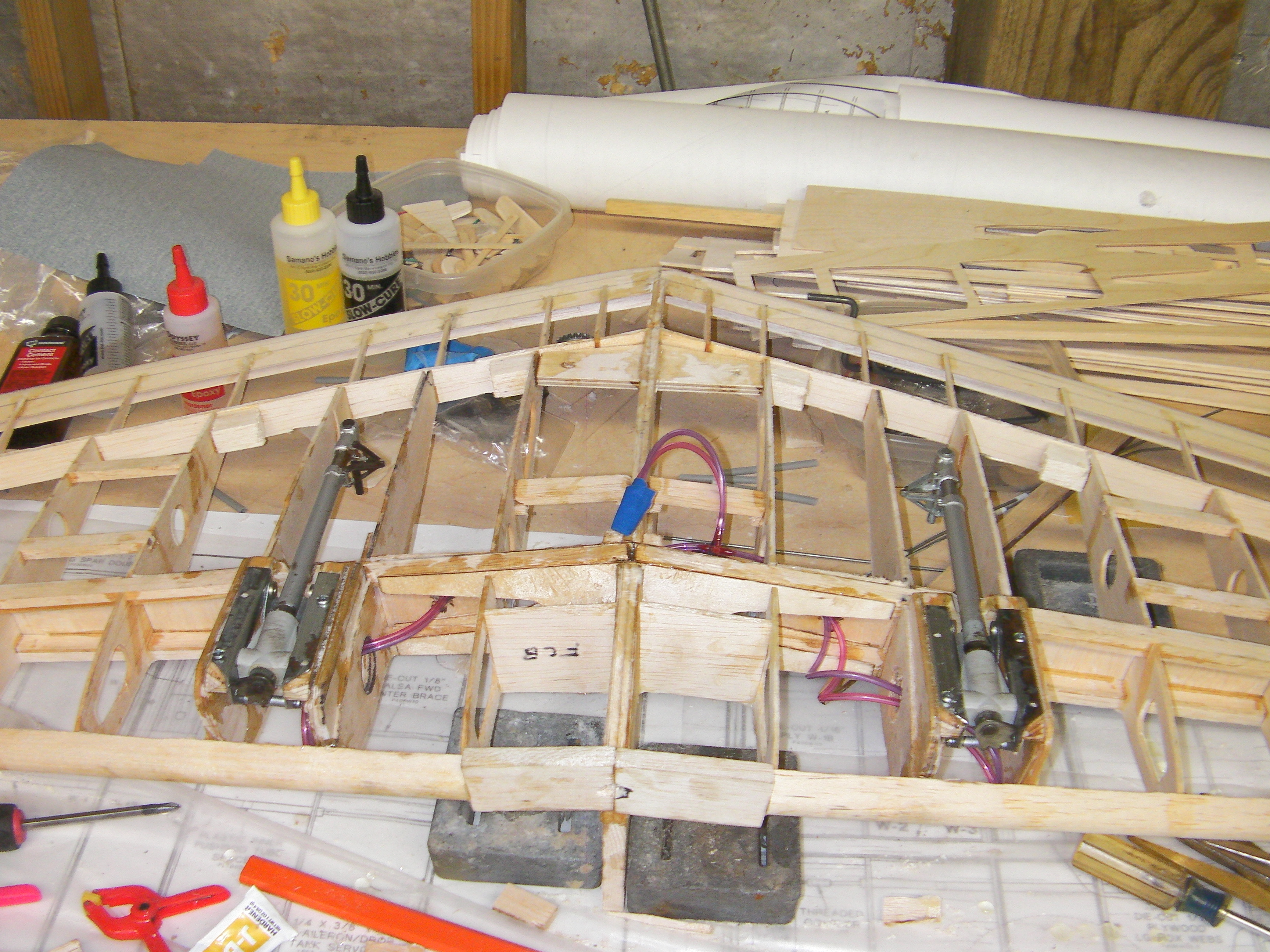

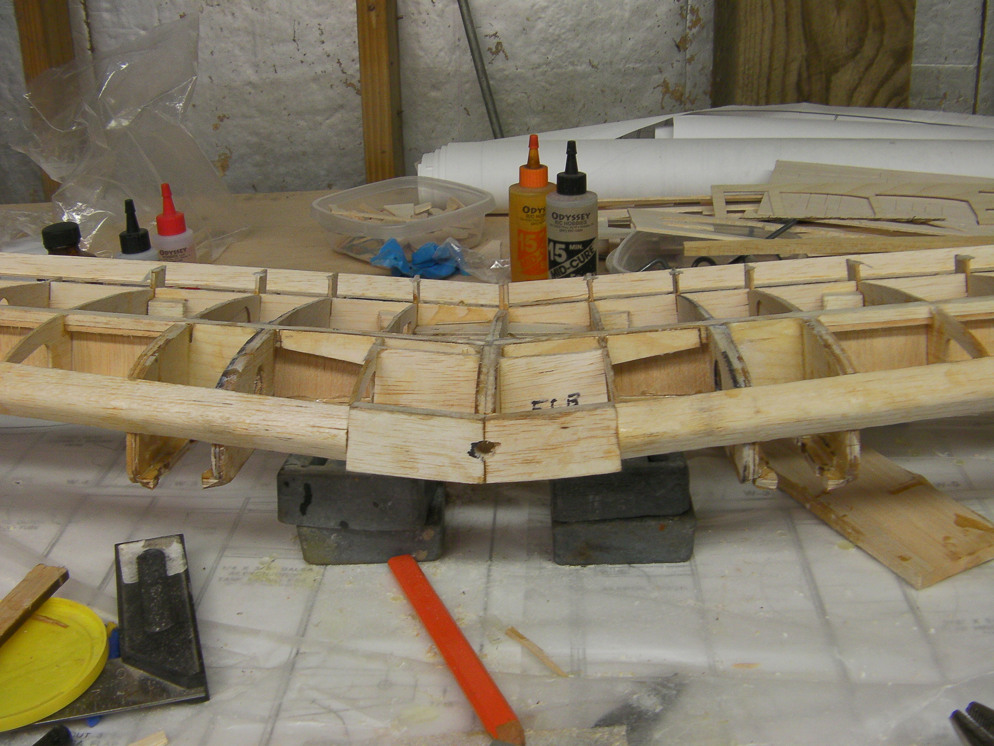

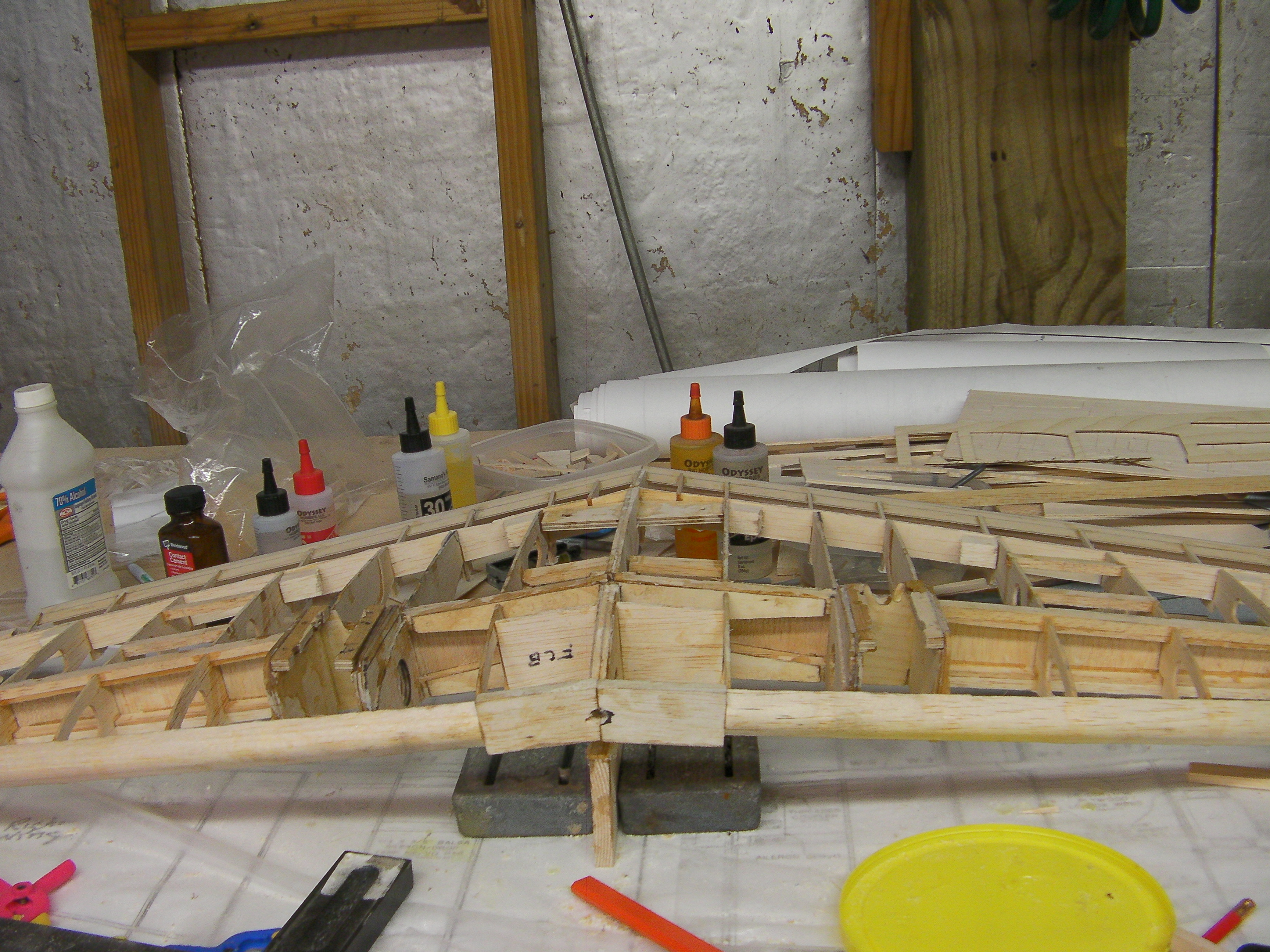

I worked a little more on the plane today and finished assemblying the retracts and got them mounted. I am not impressed by the quality of Robart nothing seemed to fit and had to end up really improvising to get them together. Something that expensive should be better quality. I dont care if they did go under water. After that did a little sheeting.2014-09-12 16.56.22.jpg2014-09-12 16.56.31.jpgp-40-2.jpg

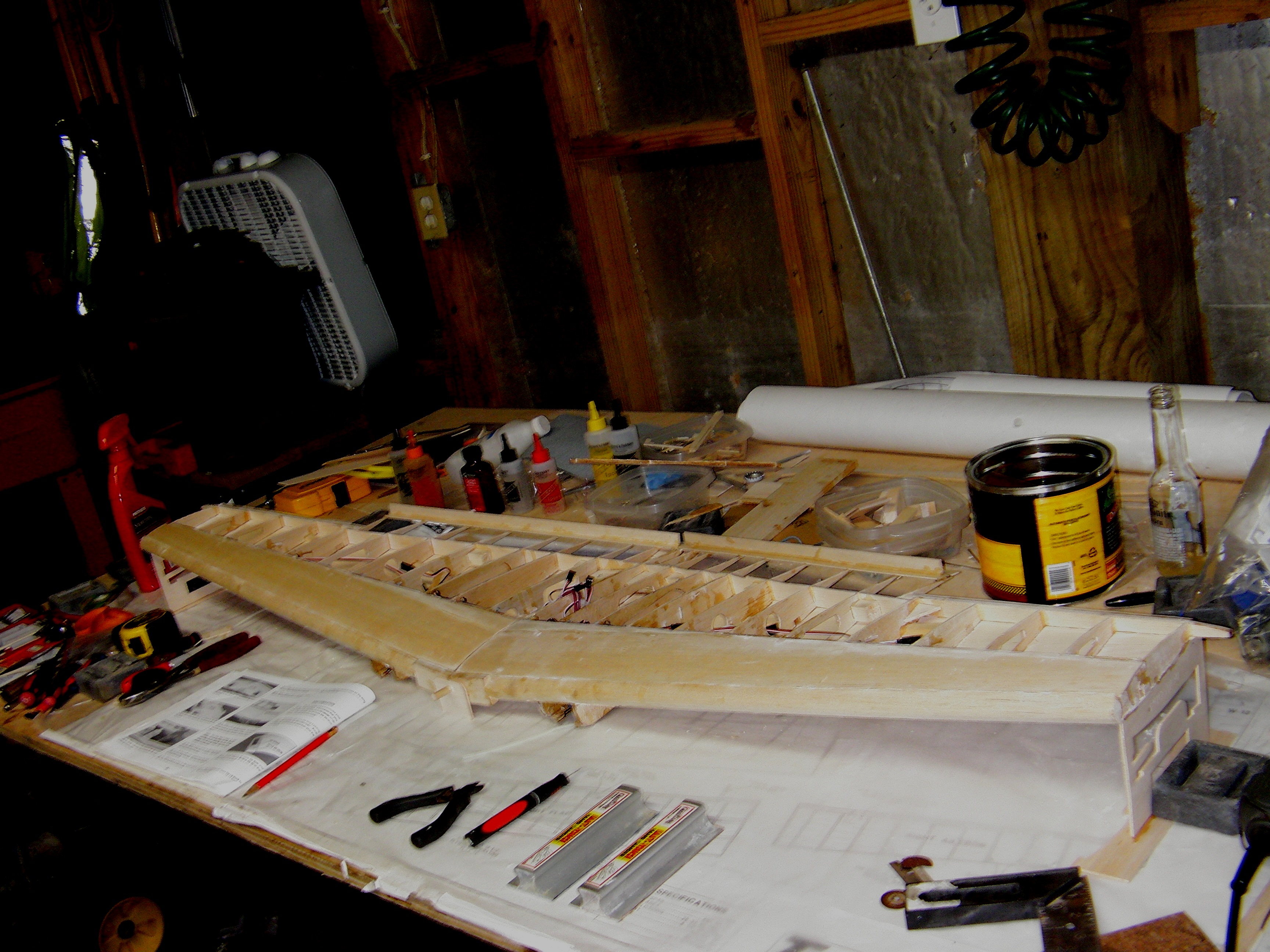

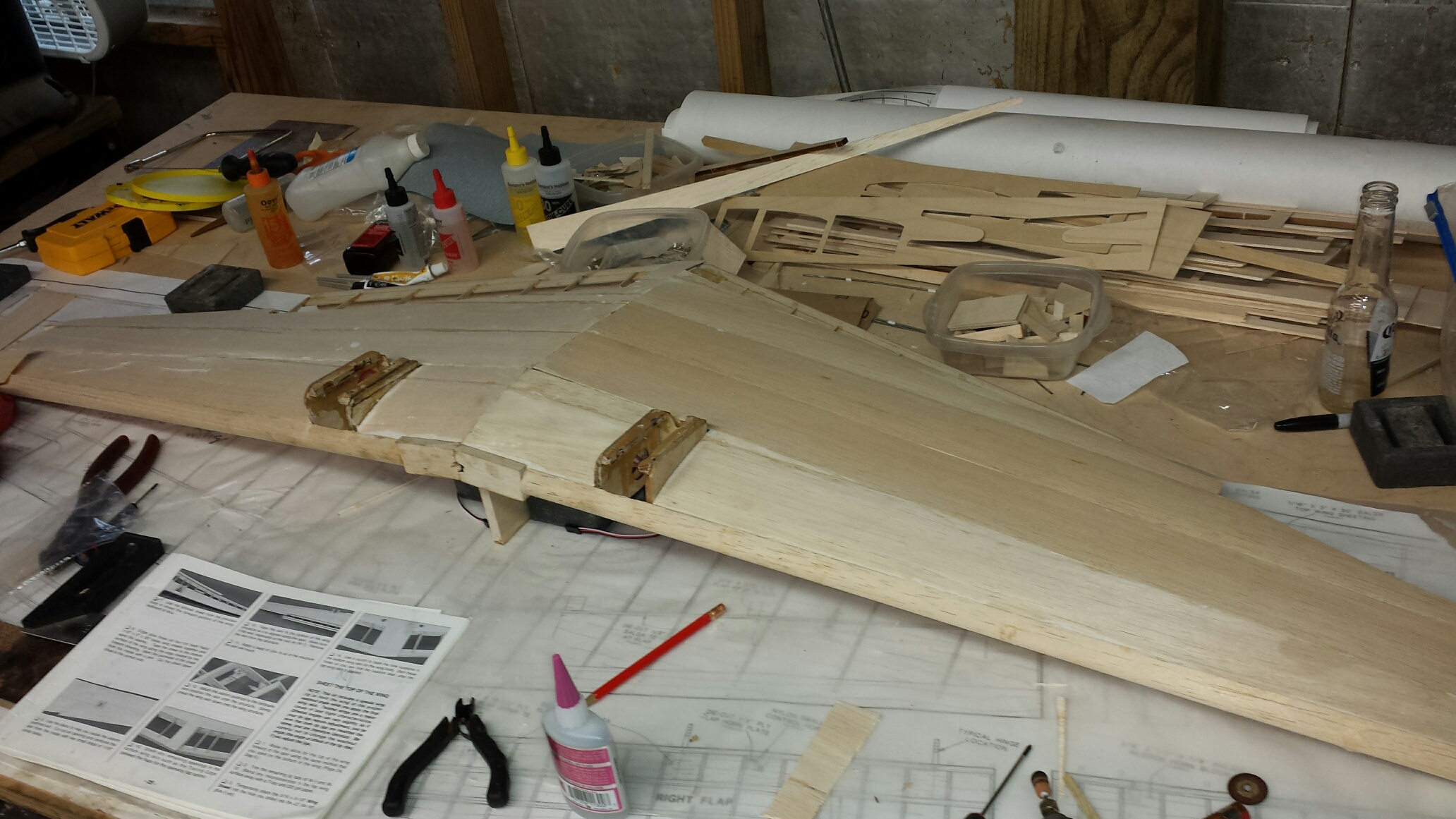

ThanksP 40-4.jpgp-40-5.jpgGot the Underside of the wing sheeted and servo wiring run.

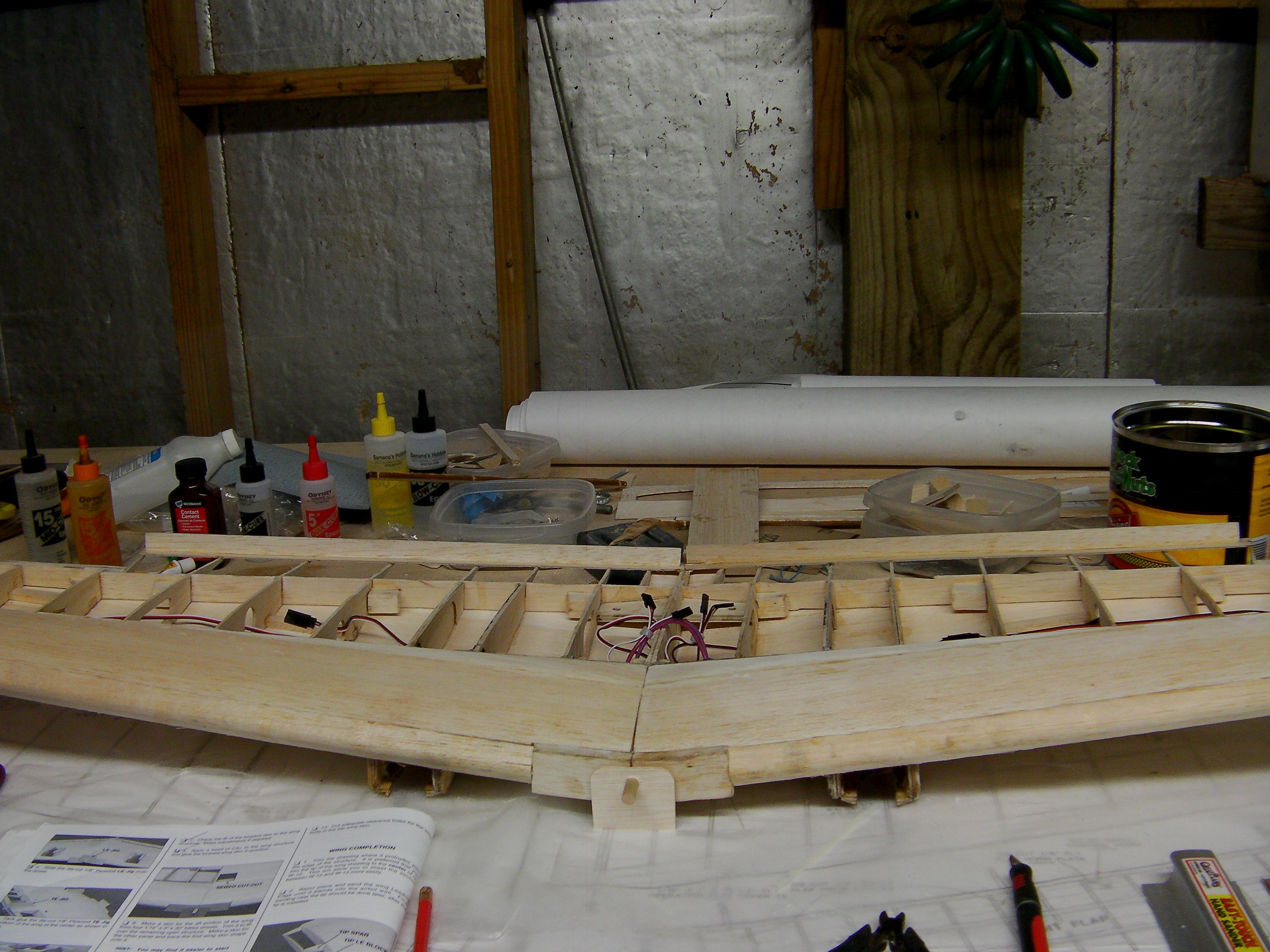

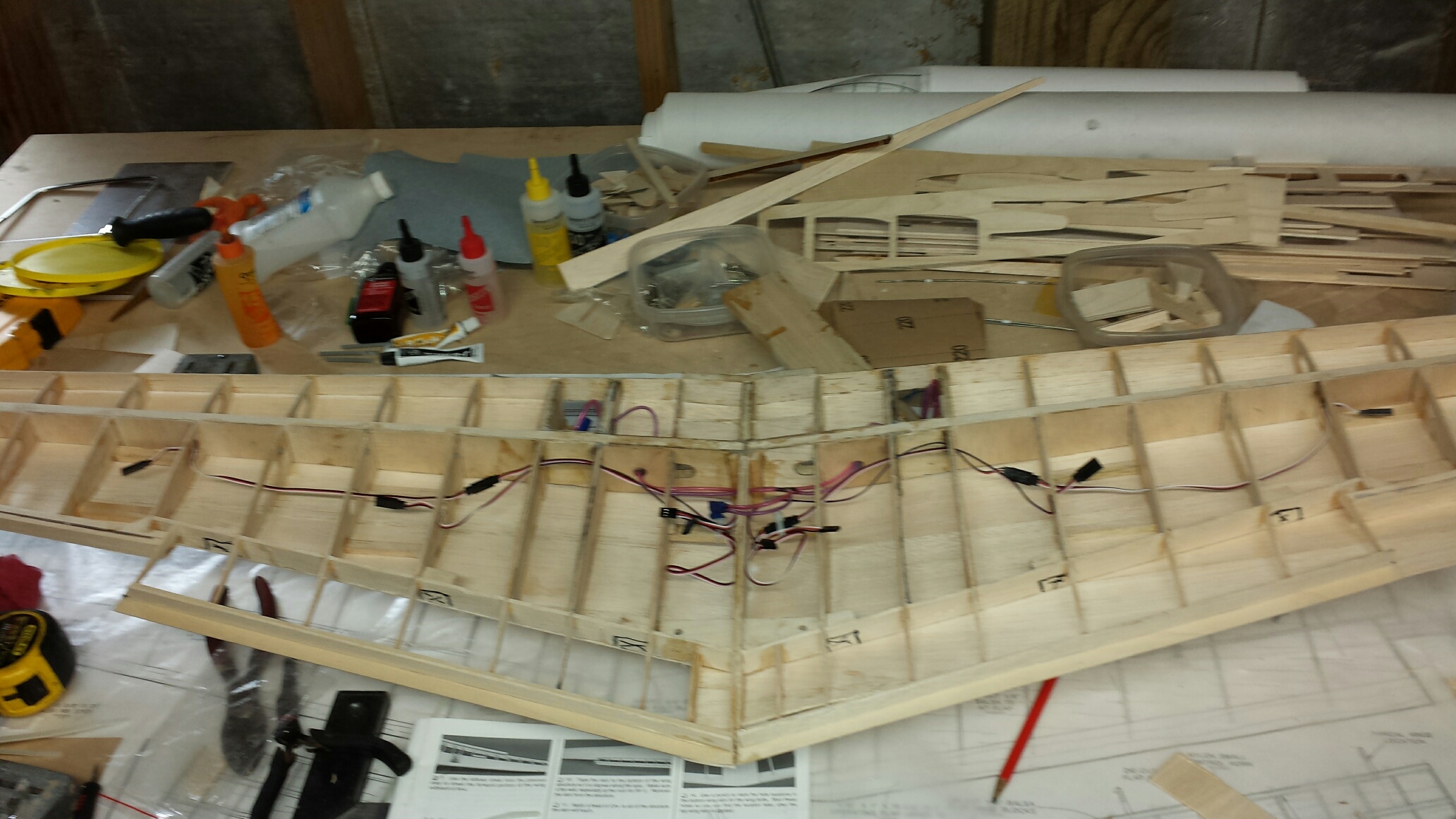

Trimmed the lower sheeting, added last piece and tied up loose servo wiring and marked servo location and rear wing bolts.p-40 wing sheeting bottom.jpgP-40 wing servo wiring.jpg

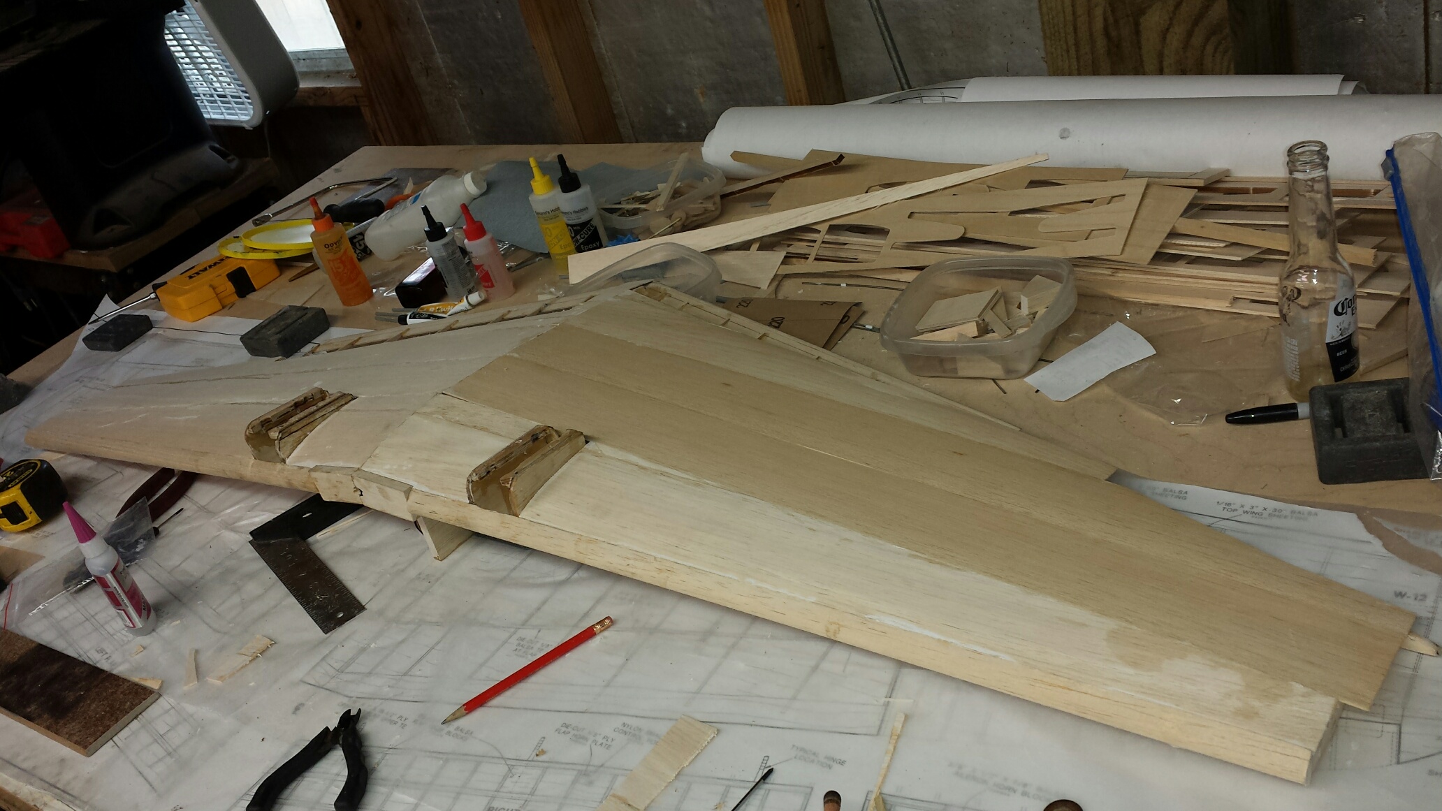

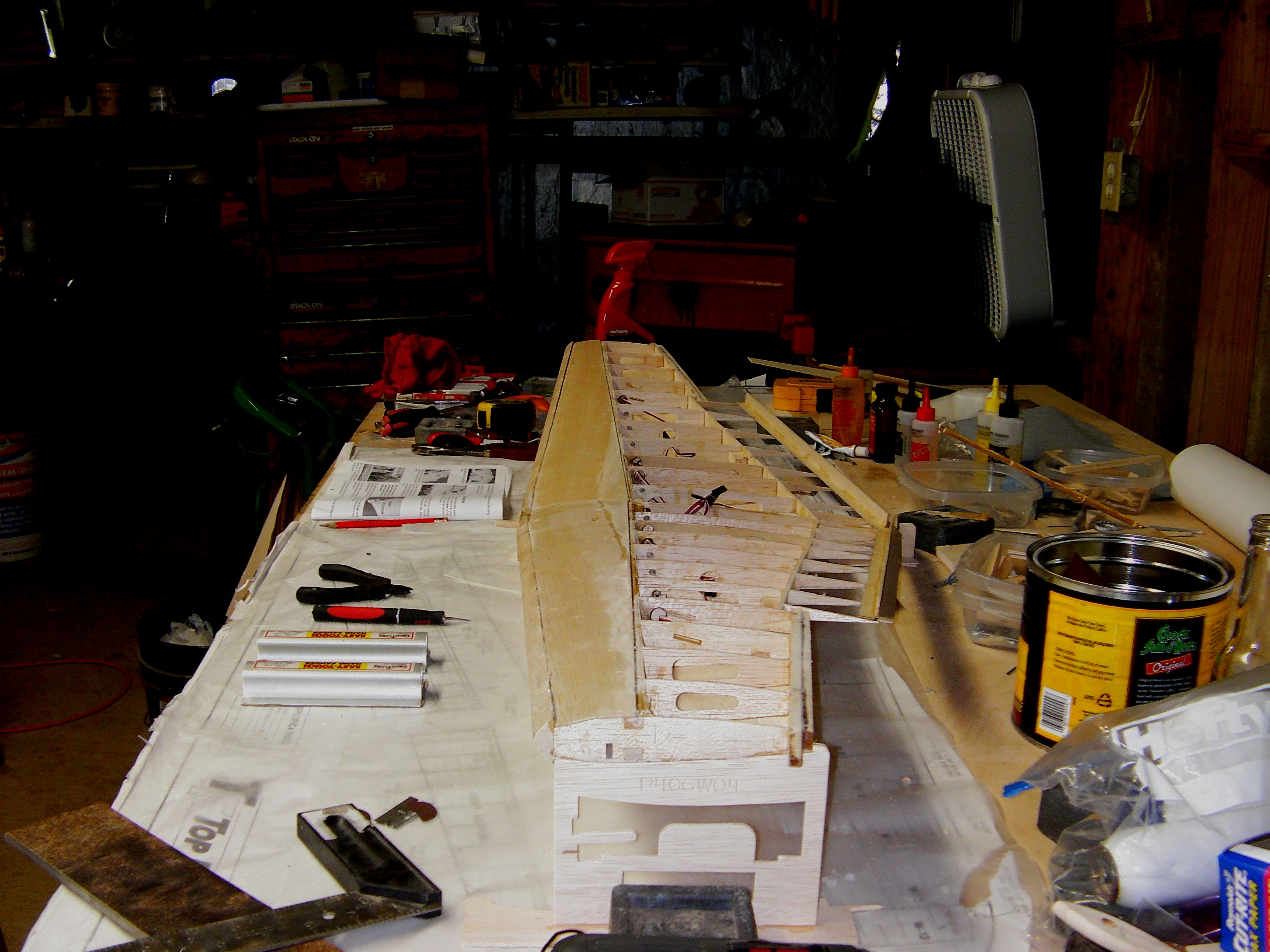

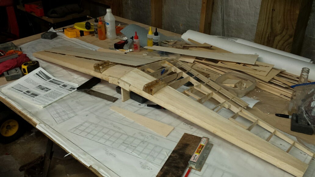

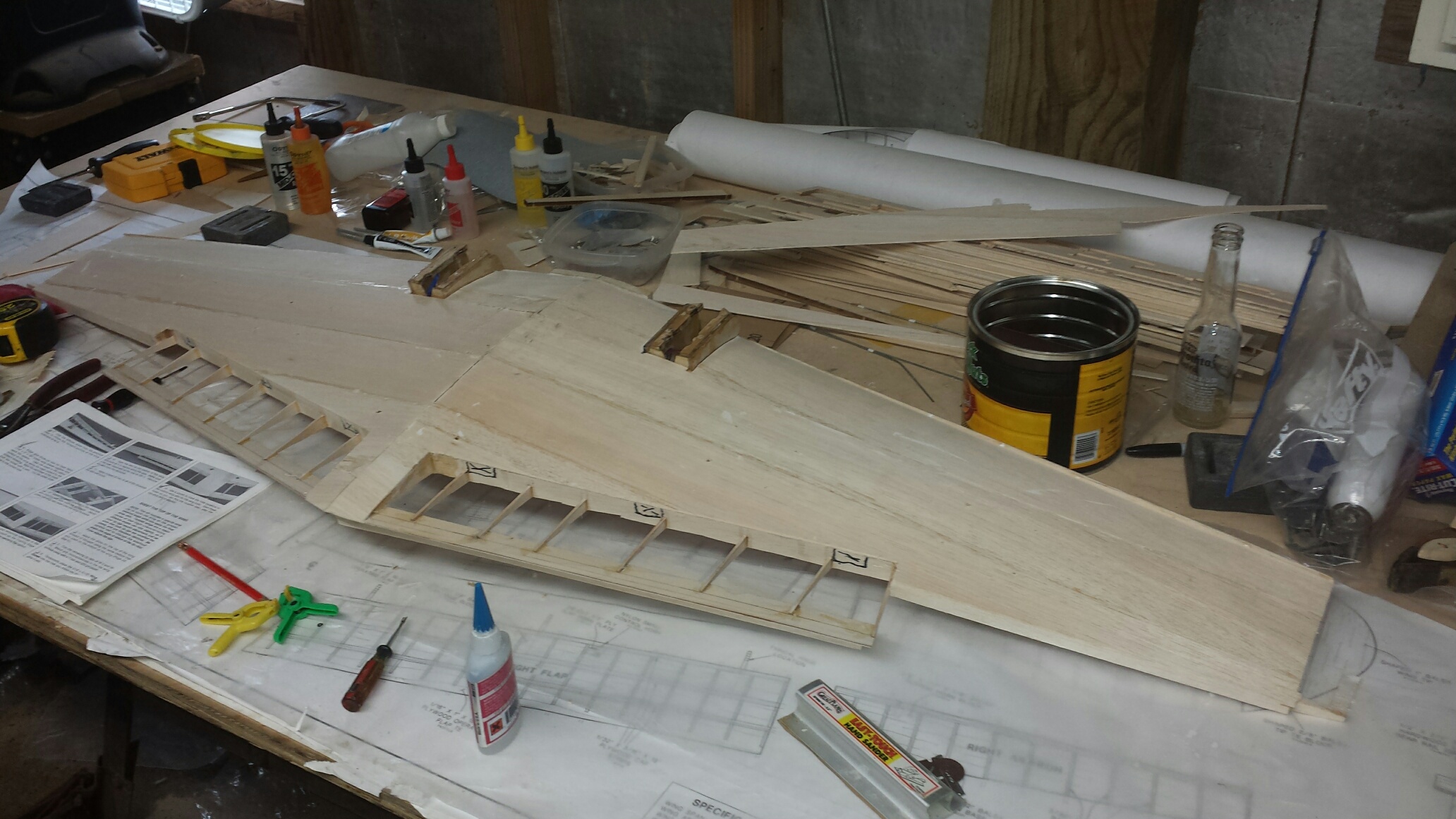

put the wing in a jig and sheeted the forward section of the top of the wing. Page 26 in the assembly manuel.2014-09-14 22.23.55.jpg2014-09-14 22.24.06.jpg2014-09-14 22.25.25.jpg
