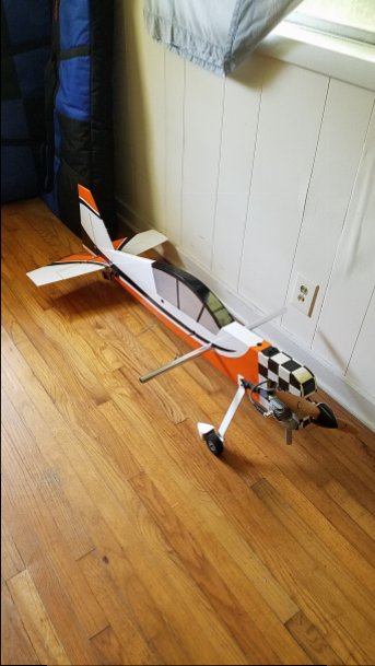

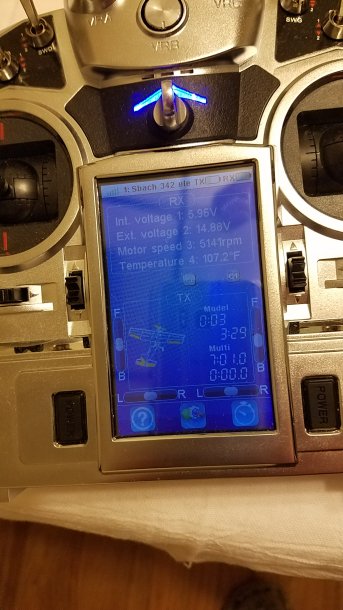

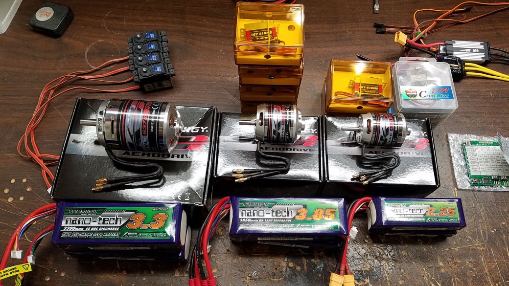

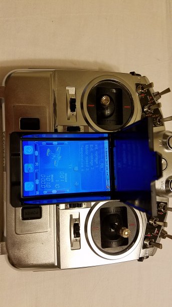

Now this rpm and temperature telemetry really really helps finding issues and problems. Since it was so windy today I did not fly the plane and most likely kept me from burning up another motor. I went ahead and pulled the G32 and installed the 4258 again.
Hovers the plane right at 5000 rpm AND..........Motor never got over 90 degrees!!!!
Still have an issue however with the motor!
. At stated hover rpm the motor starts to shake when applying pull out power.
I ran the motor with nothing on it and to my dismay noticed it could be one of those motors in a personal massage vibrator
So I am going to pull the motor and balance the bell. Then just maybe......did I say maybe......get this CHEAP HK plane back in the air so we can continue evaluating this CHEAP HK radio

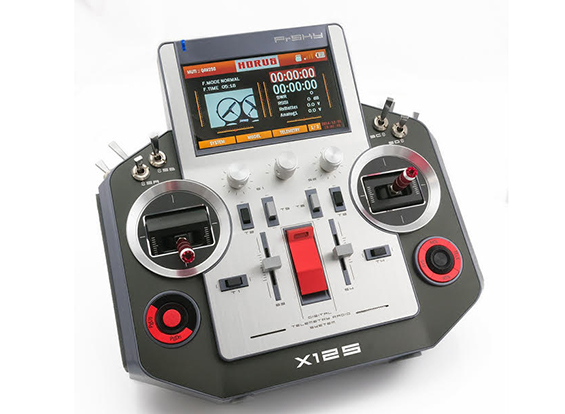

Also I am waiting to see when the "HORUS" releases and its price. FrSky did a real good job giving Jetti owners something to talk about
