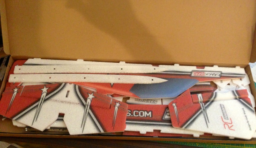

Time for some Crack!

I'll put the gear on today. Thanks for the pointers. I love the one I flew in NJ, I just hope I did an okay job building this one and it flies straight. Build wasn't as hard to do as I thought it would be!
