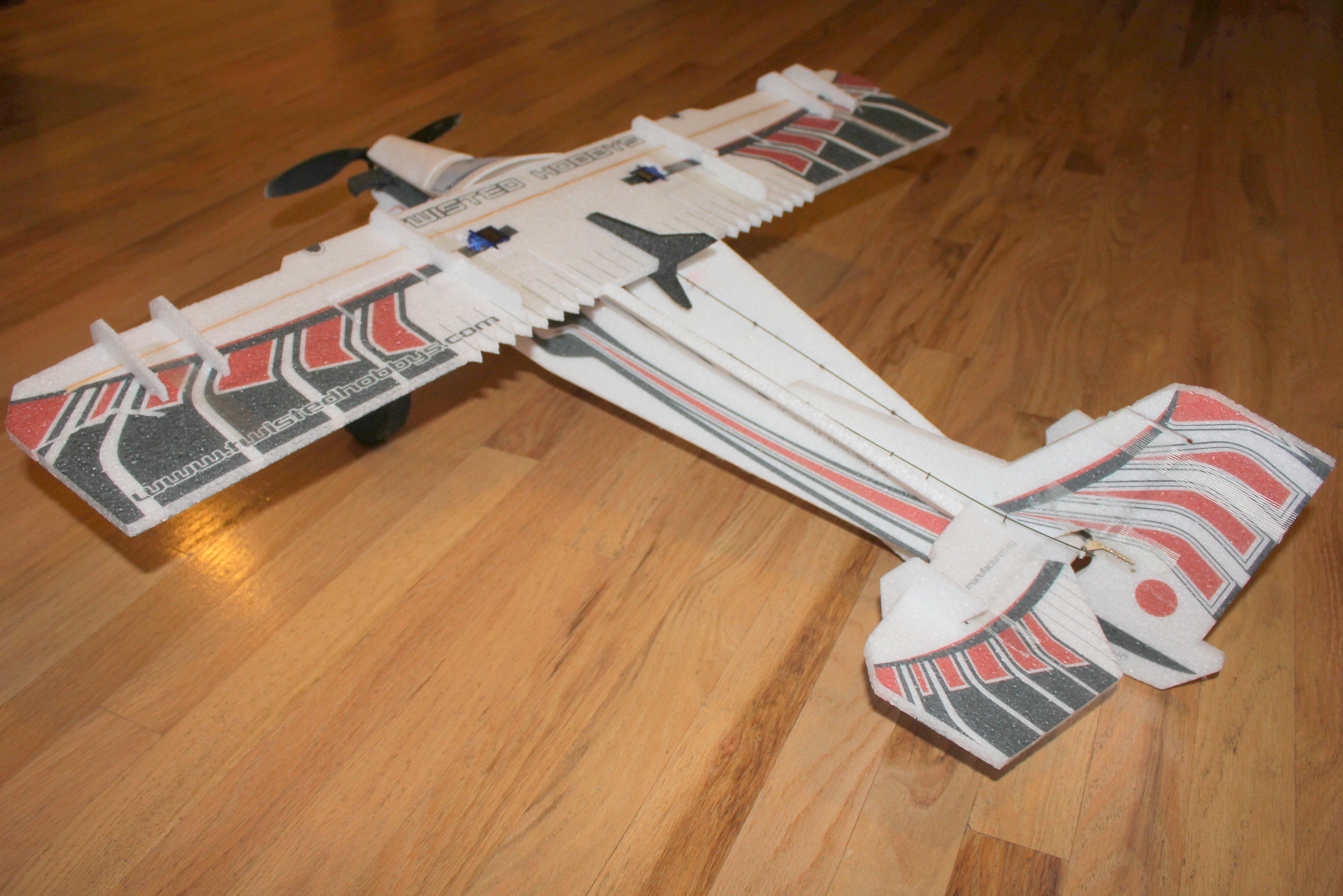

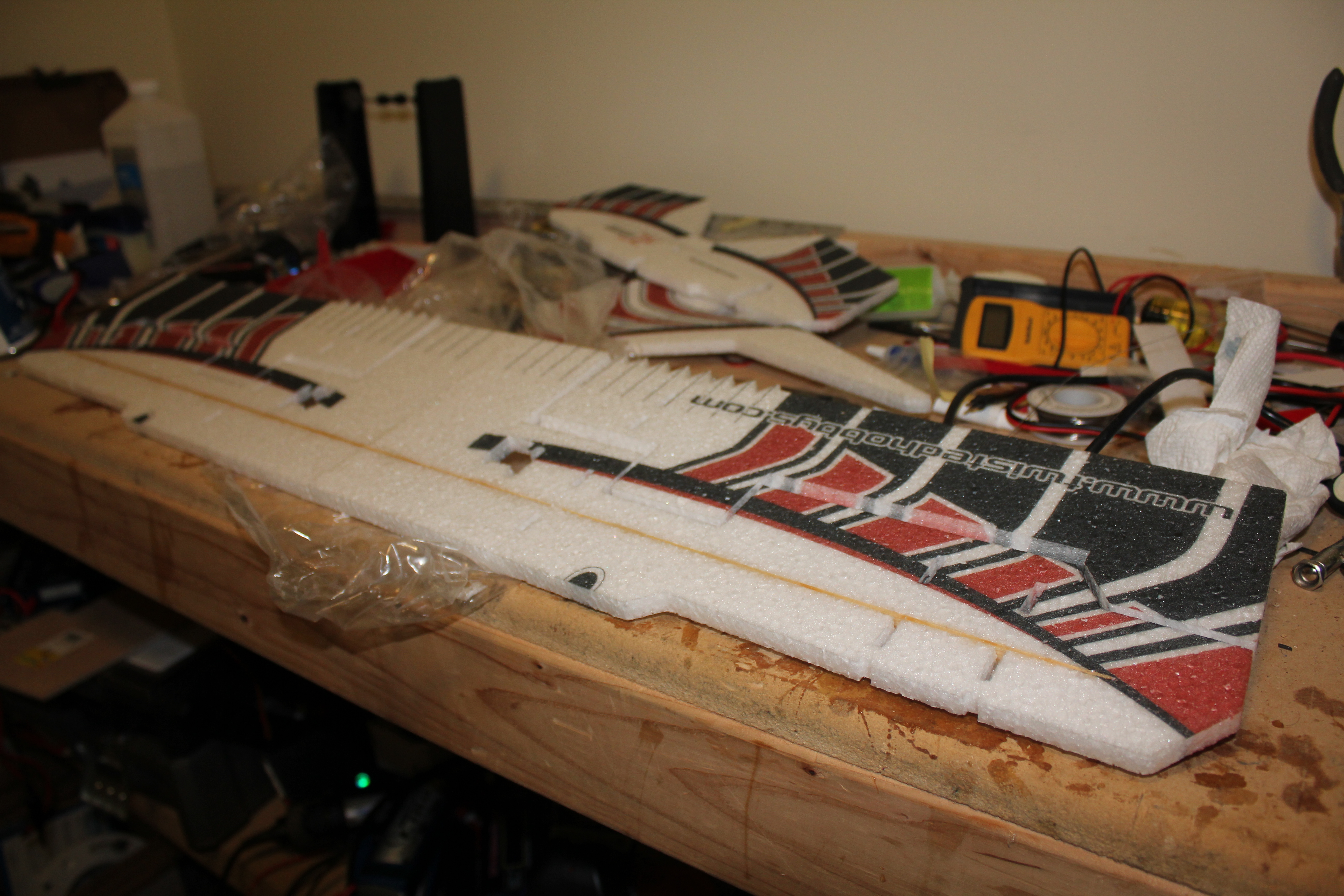

The wing comes in two pieces and needs to be glued together and the wooden wing spar inserted. Make sure you follow Chris' advice and put some tape or plastic under the wing while the glue is drying, or it WILL bond to the workbench and you'll probably end up with paint stripped off or pieces of foam ripped out of the wing.
![IMG_6363.JPG IMG_6363.JPG](https://www.giantscalenews.com/data/attachments/65/65905-311c6e37cc2dd5ebc9eab60177eac035.jpg)
(Yes, its a messy workbench)

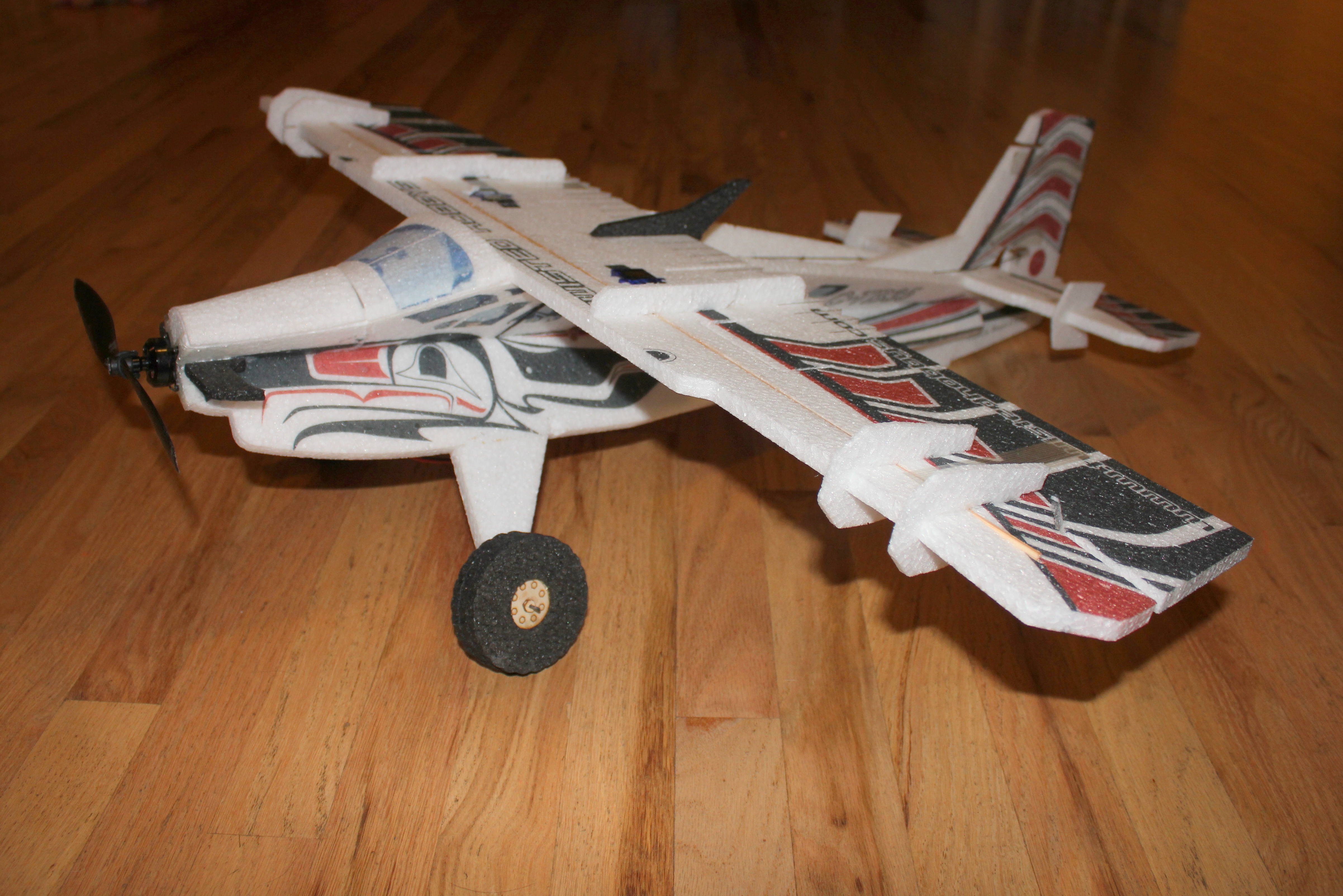

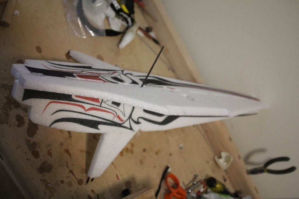

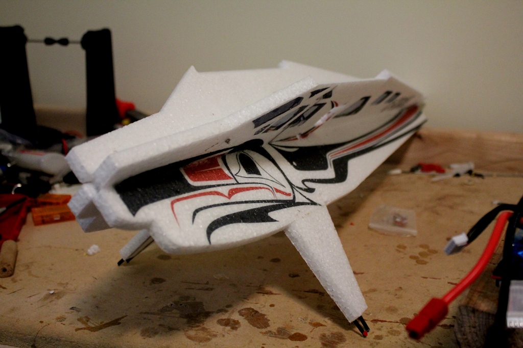

The fuselage is designed as four interlocking pieces that form and X-profile when glued together. Building the fuselage is very easy, thanks to the interlocking tabs. There's simply no way of getting it wrong. The fuselage comes together very quickly and very sturdy and stable thanks to the X-design. The CF rods for the landing gear are installed during the fuselage assembly, so make sure to watch the build video so you don't miss any steps!
![IMG_6485.JPG IMG_6485.JPG](https://www.giantscalenews.com/data/attachments/65/65906-ba41f707709f4db57f5fcde414a210d2.jpg)
![IMG_6491.JPG IMG_6491.JPG](https://www.giantscalenews.com/data/attachments/65/65908-a96b33fa0e3af9de68273f685cb4471e.jpg)
![IMG_6489.JPG IMG_6489.JPG](https://www.giantscalenews.com/data/attachments/65/65907-135f82eb207f023d6b15d8a79bc12f23.jpg)

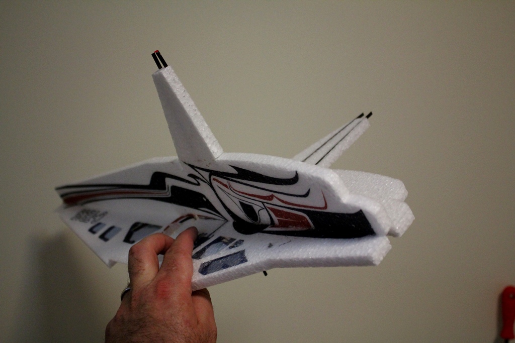

The landing gear requires a bit of attention when building. First of all, when you glue together the the wheels, make sure you get the three discs perfectly aligned or you'll have problems installing the wheel axle. Also, bad alignment will make for a wobbly wheel and your model will have a slight limp when taxiing.

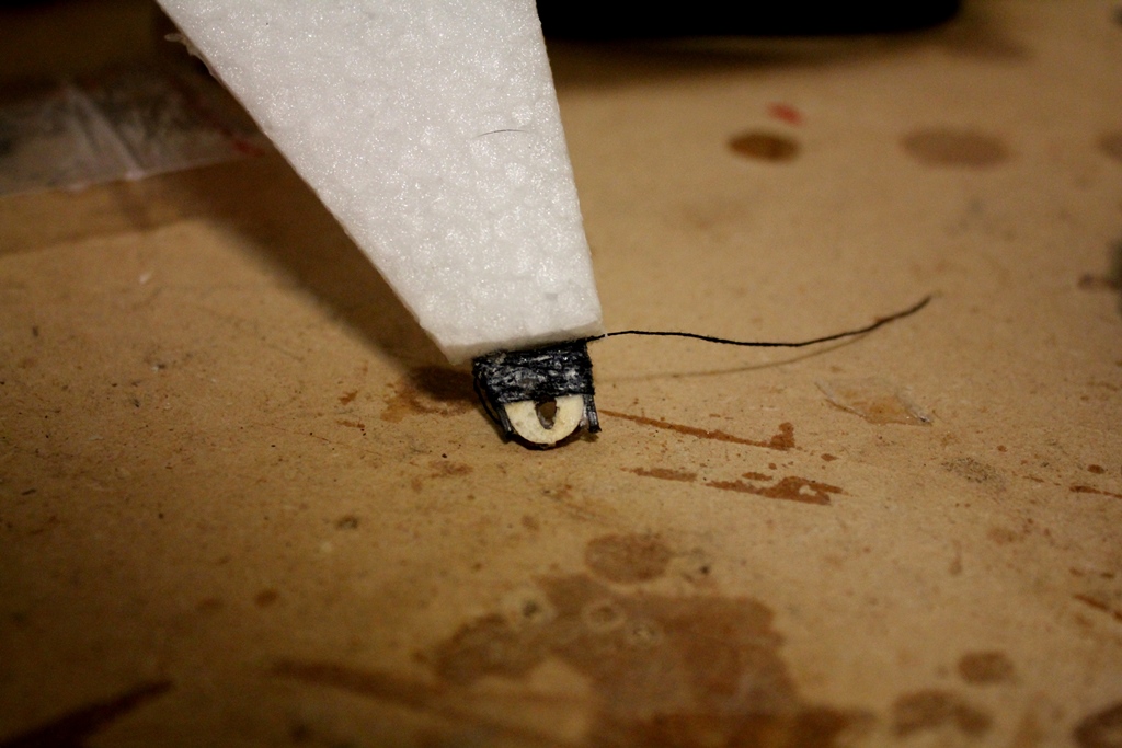

You also need to make sure the holes in the wheel hubs at the end of the struts are free of any CF drops or other obstructions. Even the smallest debris will affect the wheel axle angle resulting in badly aligned wheels.
![IMG_6493.JPG IMG_6493.JPG](https://www.giantscalenews.com/data/attachments/65/65909-ac5018a2d7b5bb44a94bb291a98e5108.jpg)

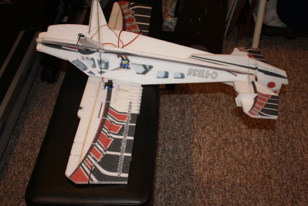

When installing the servos, the best results are achieved by hooking all the servos up to the receiver on the bench (before installing it in the aircraft), powering up and installing the servo arms to make sure they are aligned perfectly perpendicular to the servos. Remember to make sure your sub trims are at zero on the radio! Install the pushrods and secure the servo with some Welders.
![IMG_6557.JPG IMG_6557.JPG](https://www.giantscalenews.com/data/attachments/66/66060-c82d8d06c1177f954186f198e926e8dd.jpg)
![IMG_6559.JPG IMG_6559.JPG](https://www.giantscalenews.com/data/attachments/66/66063-bec20c7922c85fc6169c3462b582bfea.jpg)

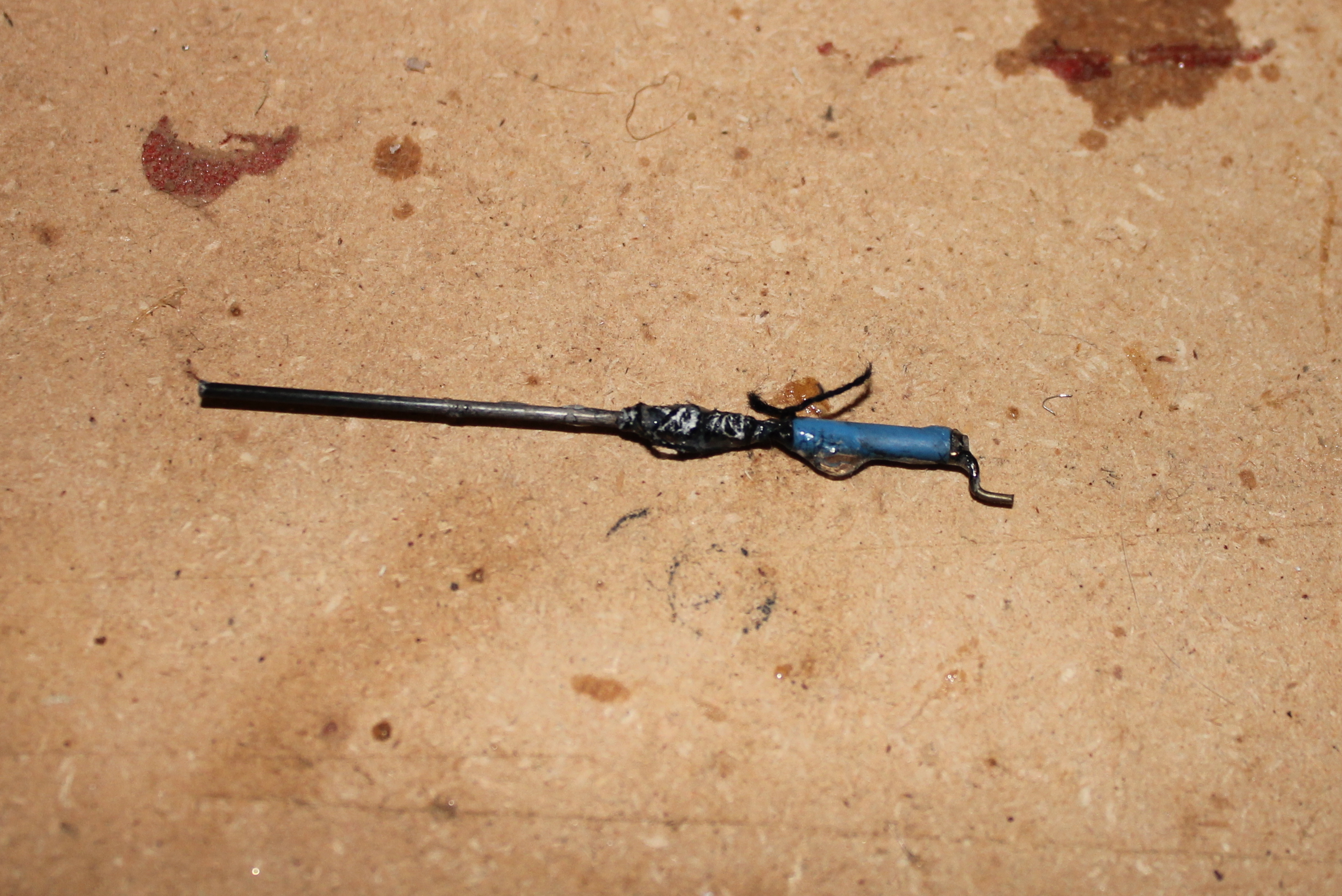

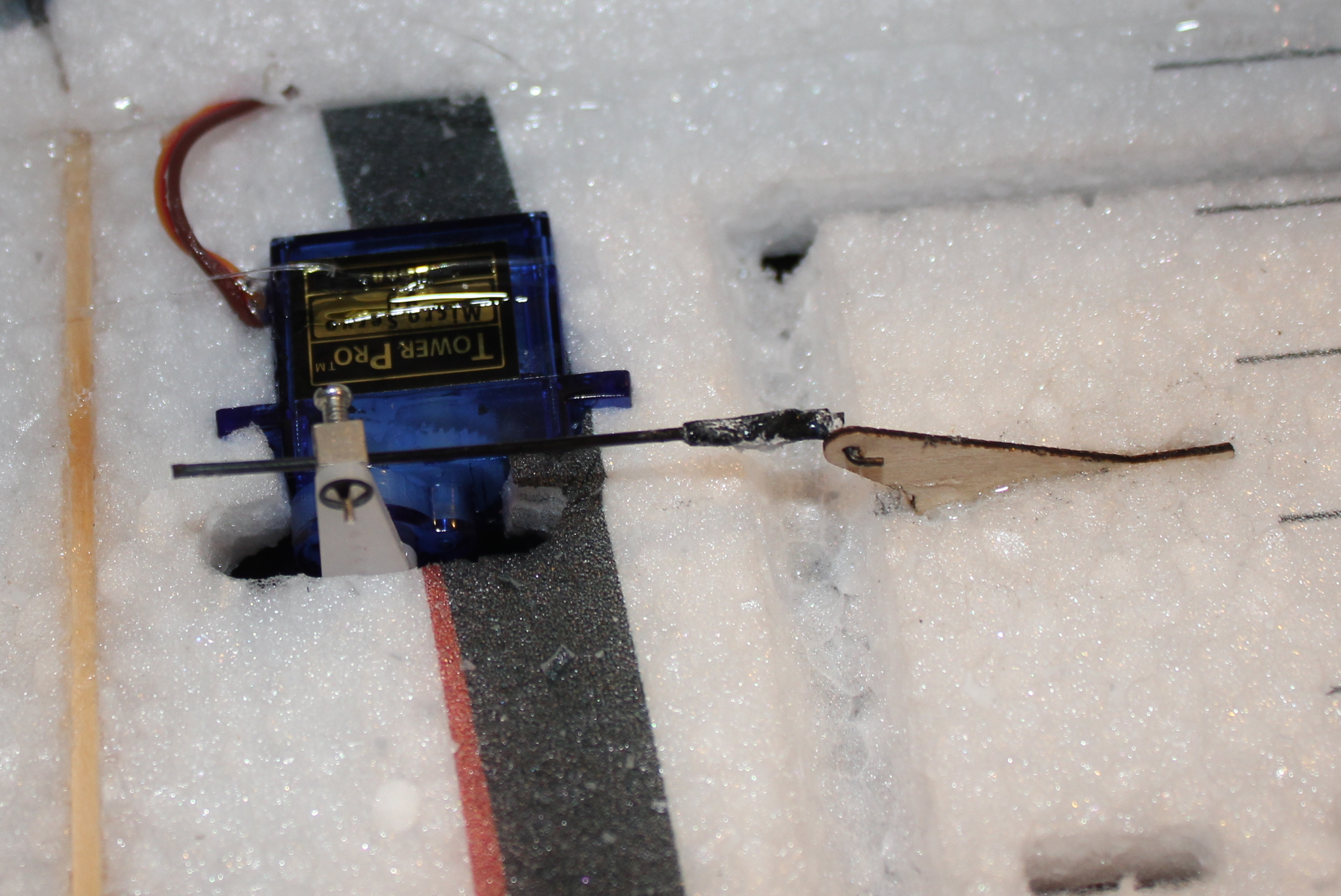

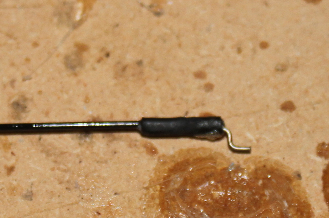

In our opinion, one of the more challenging parts of any TwistedHobbys foamy build is making and installing the pushrods. The build video suggests hitting the shrink tube and glue with a torch to push out and burn excessive glue. Make sure you only let the flame burn for about a second or less! Carbon fiber is combustible and will weaken if you let the flame burn too long. We had that happen on one of the pushrods but strengthened it by wrapping the affected area with thread and hitting it with thin CA and kicker.
Also, make sure you are very careful with the glue when you install the elevator and rudder pushrod guides. A tiny drop of CA near the hole where the pushrod passes through, and you'll spend the next hour with de-bonder trying to make the pushrod slide through the guide again.
There are a lot of very tiny parts involved when building and installing the pushrods, and the kit doesn't include any spares, so make sure you're working over a clean work area where it's easy to find the pieces you will inevitably drop!
![IMG_6558.JPG IMG_6558.JPG](https://www.giantscalenews.com/data/attachments/66/66061-925b62554b1877f80d7afdd3e79840ae.jpg)
![IMG_6561.JPG IMG_6561.JPG](https://www.giantscalenews.com/data/attachments/66/66062-aedfd116cbecdd243d68edad14bc9ef0.jpg)
