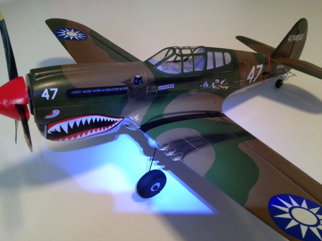

I received this little bird as a gift from my wife. I'm officially a P-40 Warhawk fan and wanted the micro bird to accompany my Top Flite P-40E Gold Edition kit.
Unboxing:
The UM P-40 is a beauty. Lots a scale lines to give it the scale appearance.
Large/beefy wheels. Compare to previous generations of ultra micros whose wheels were useless, these wheels are big enough to give the plenty plenty of prop clearance on smooth surfaces.
