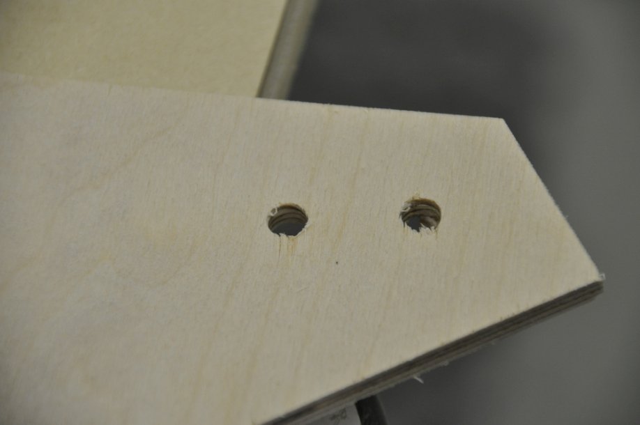

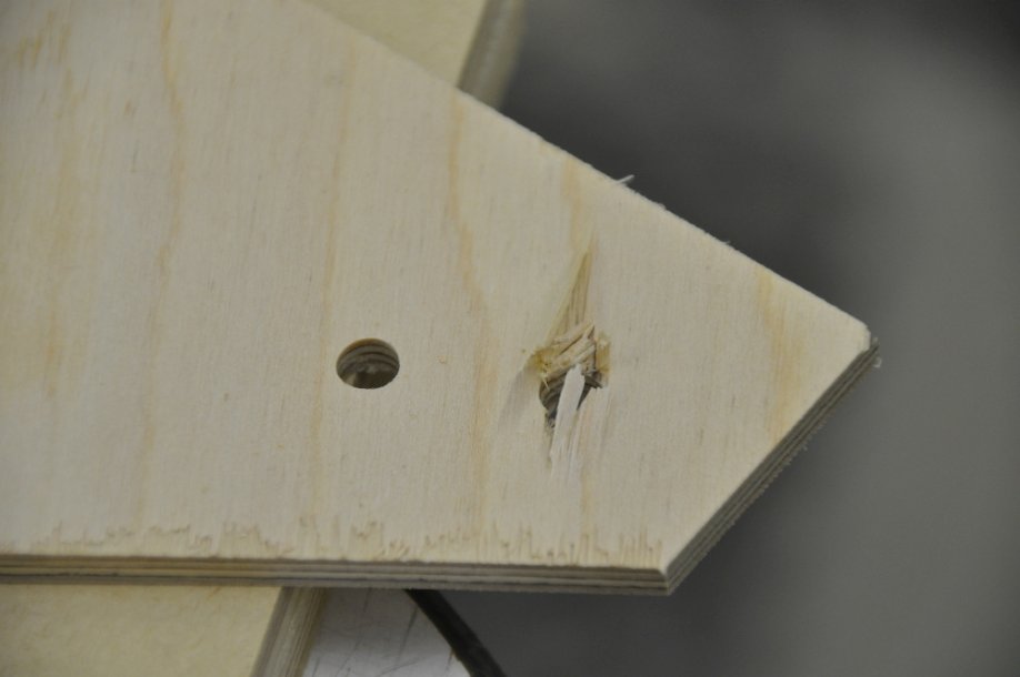

Nice demo Bart. Really glad that you showed the block on the inside of the plywood. I wanted to show a picture of what you are trying to get away from by doing that since I've seen a lot of people punch holes in places inside their airplane and not consider what could potentially happen.
Here is a pic, one with a block and one without a block in birch ply typical of what the engine box structure is made of. If you punch a hole in that without a block and it blasts out on the backside what you have done is create a focal point for vibration and stress. Sort of a "chain is only as strong as it's weakest link" kinda deal.....you just created the weak link.
