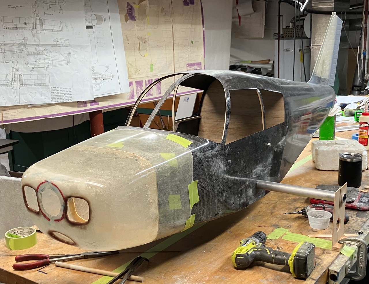

Work on the Cherokee has slowed to a crawl so I decided to rework the cowk for the next build. The front of the cowl is incorrect, the headlight recess is pointing down at 20 degree angle while the actual cowl is closer to flat has shown below.

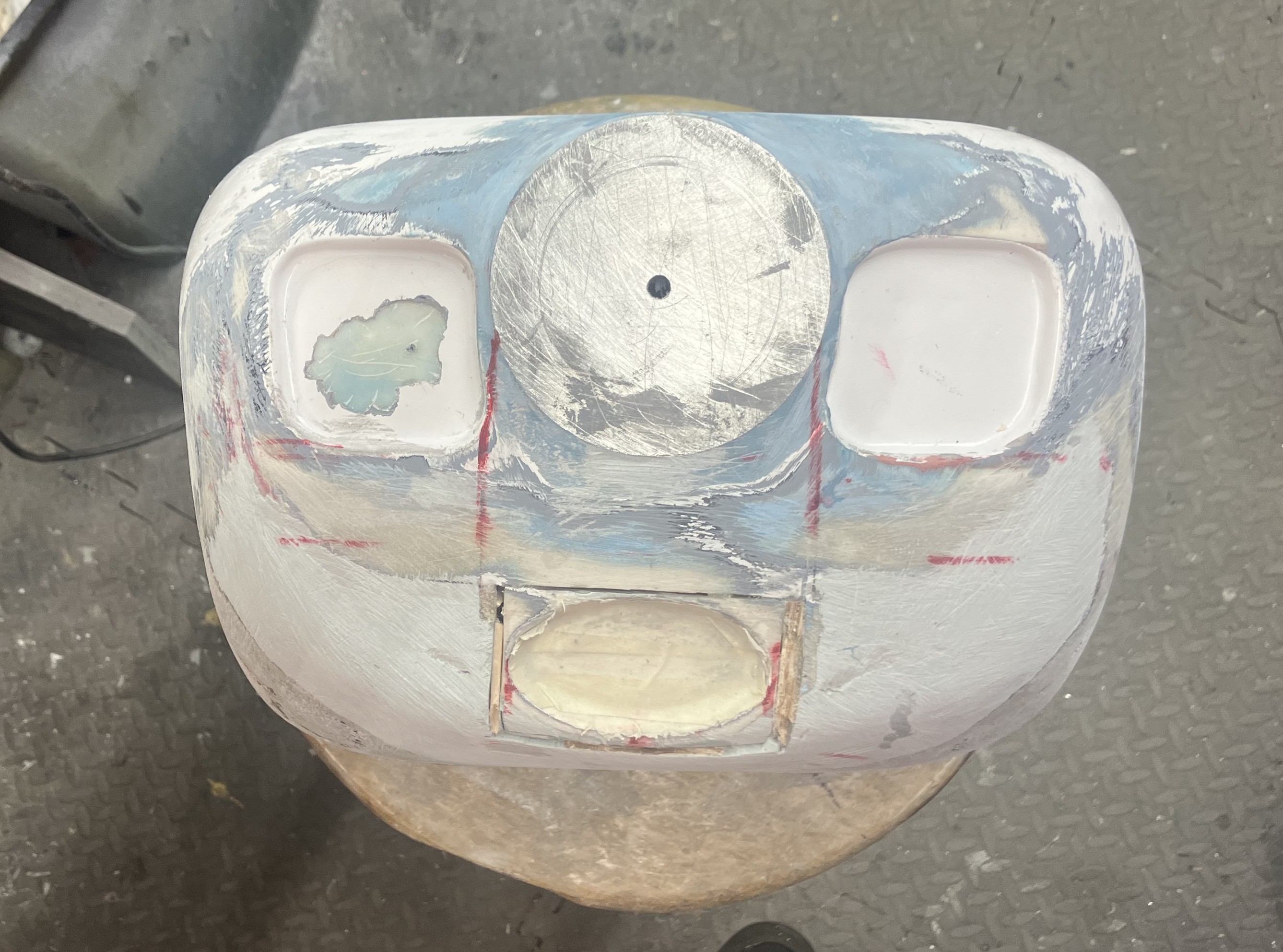

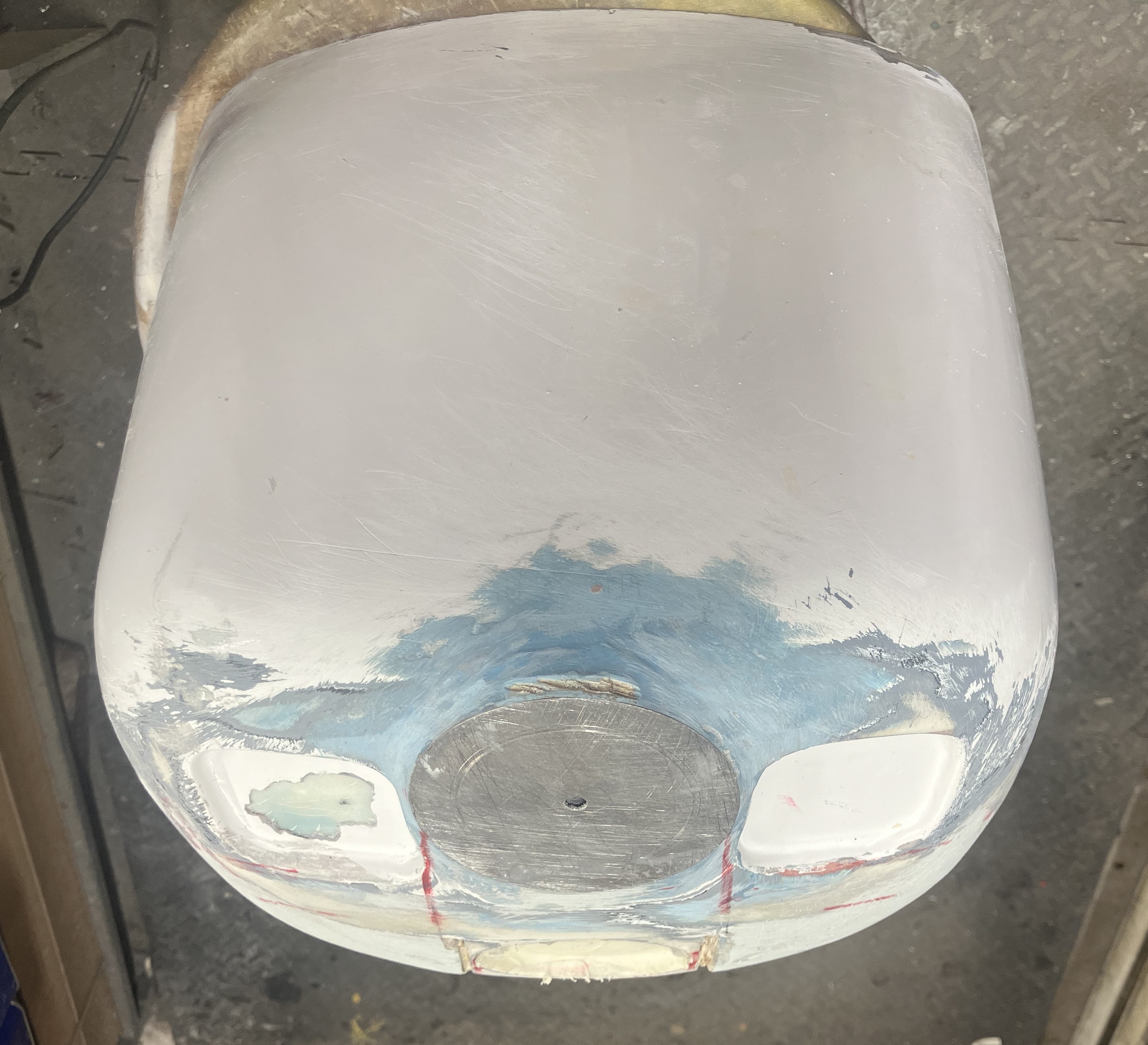

The headlight recess was cut free and positioned closer to the vertical plane and the adjacent corners were filled with Bondo. A 3 1/2" 1/16" thick steel disc was installed at 3 degrees down to define engine center. When it's all said and gone it will be a little closer to the full scale. I plan to make a 3 piece mold with the parting lines at lines of the full scale, nose bowl, top and bottom section

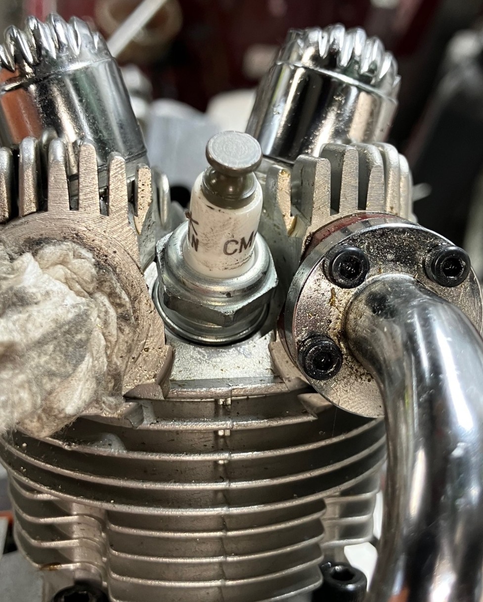

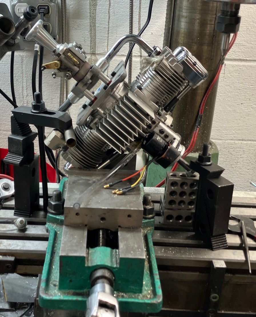

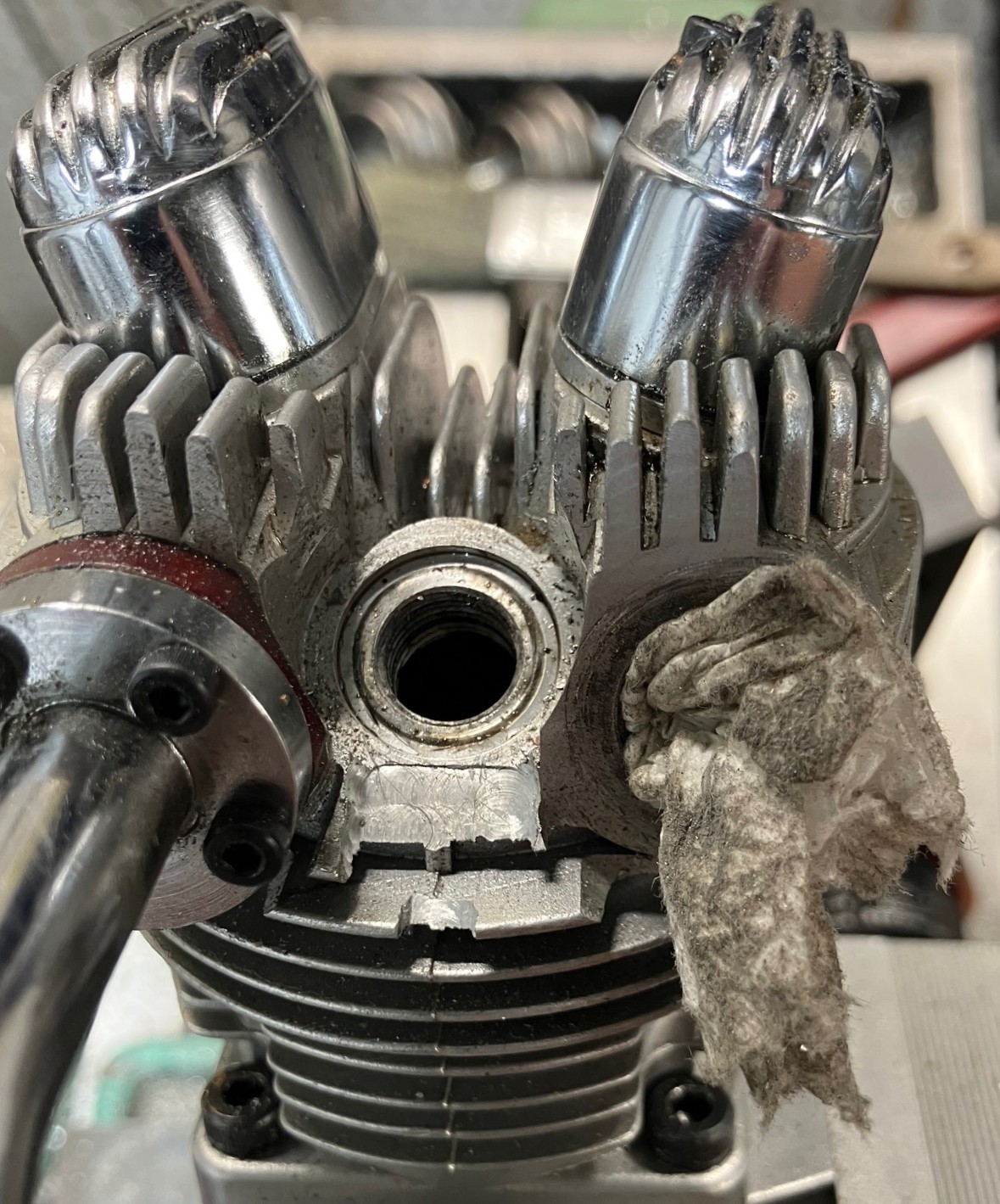

While running the engine the spark plug wire came off one cylinder, I thought it wasn't pushed on far enough so I pushed it back on, after coming off the second time discovered that the temperature sensor wasn't allowing the plug cover to go past the hex. The plug gasket fits into a counterbore and the hex is captured in somewhat of a larger counterbore that caused the sensor to bend up and interfere. After studying the the heads and determined there is no good place to measure the temperature decided to mill off the larger counterbore on the back side of the head to allow the sensor to sit flat. The sensor is now sits flat between the gasket and the plug.

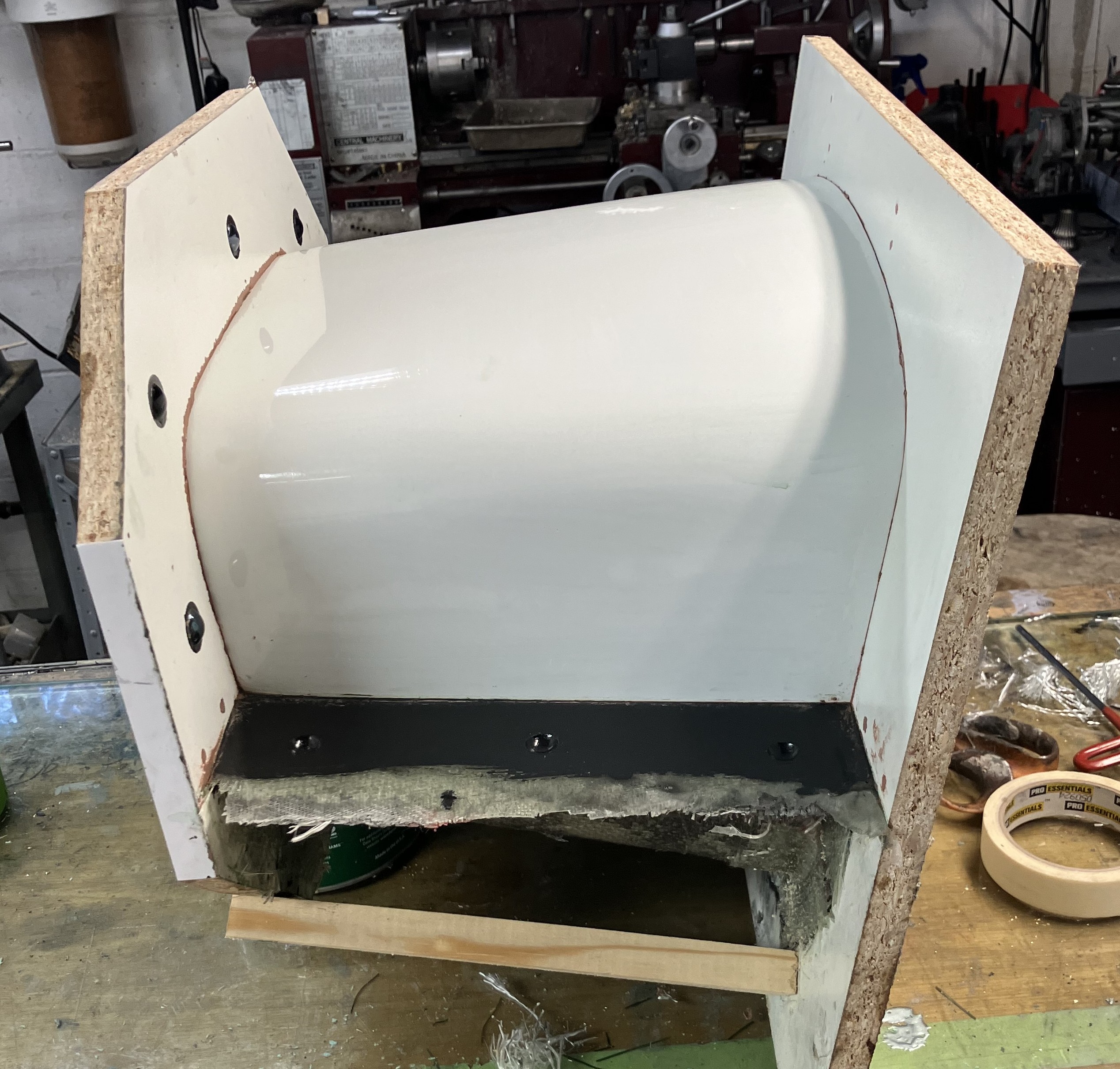

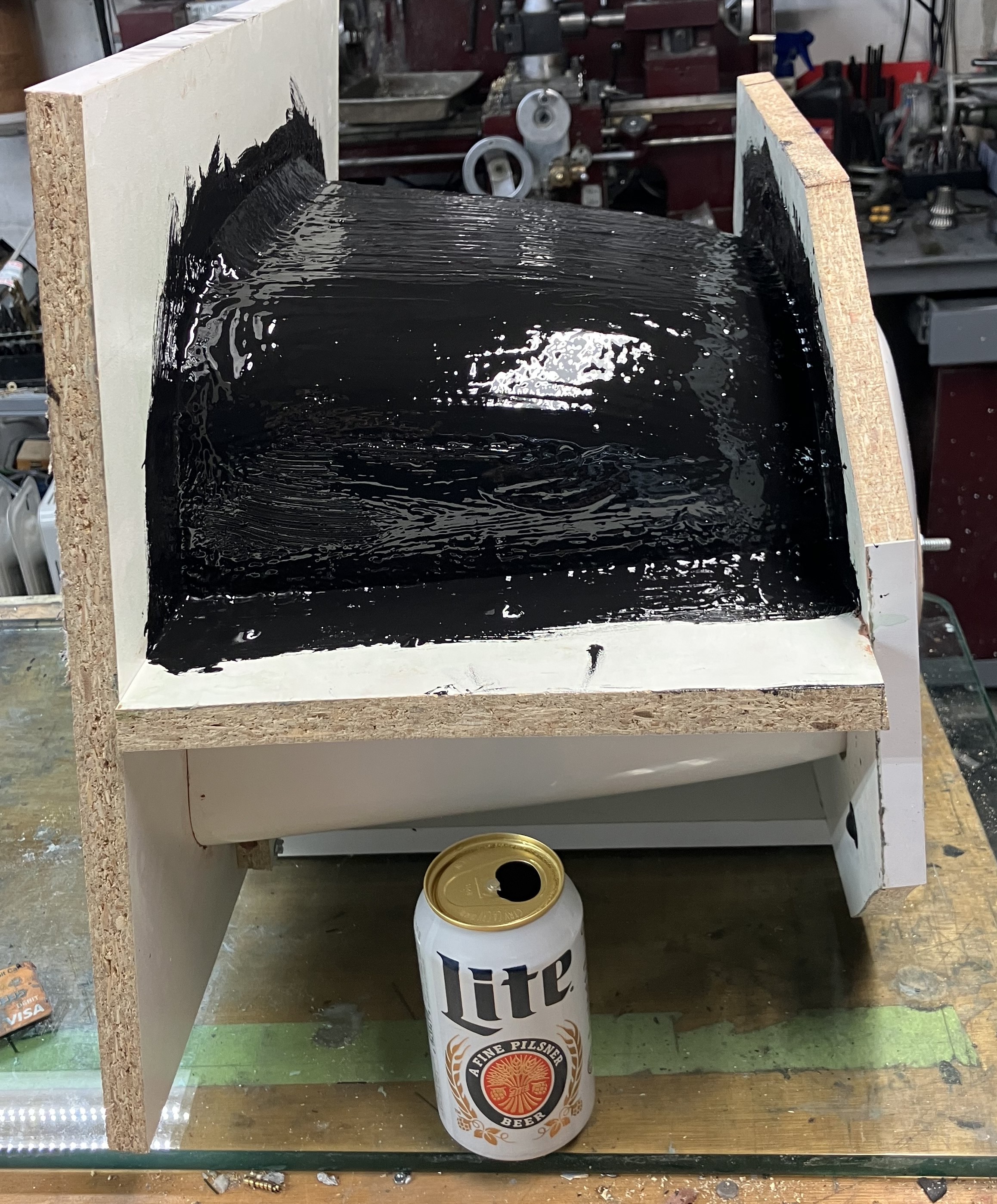

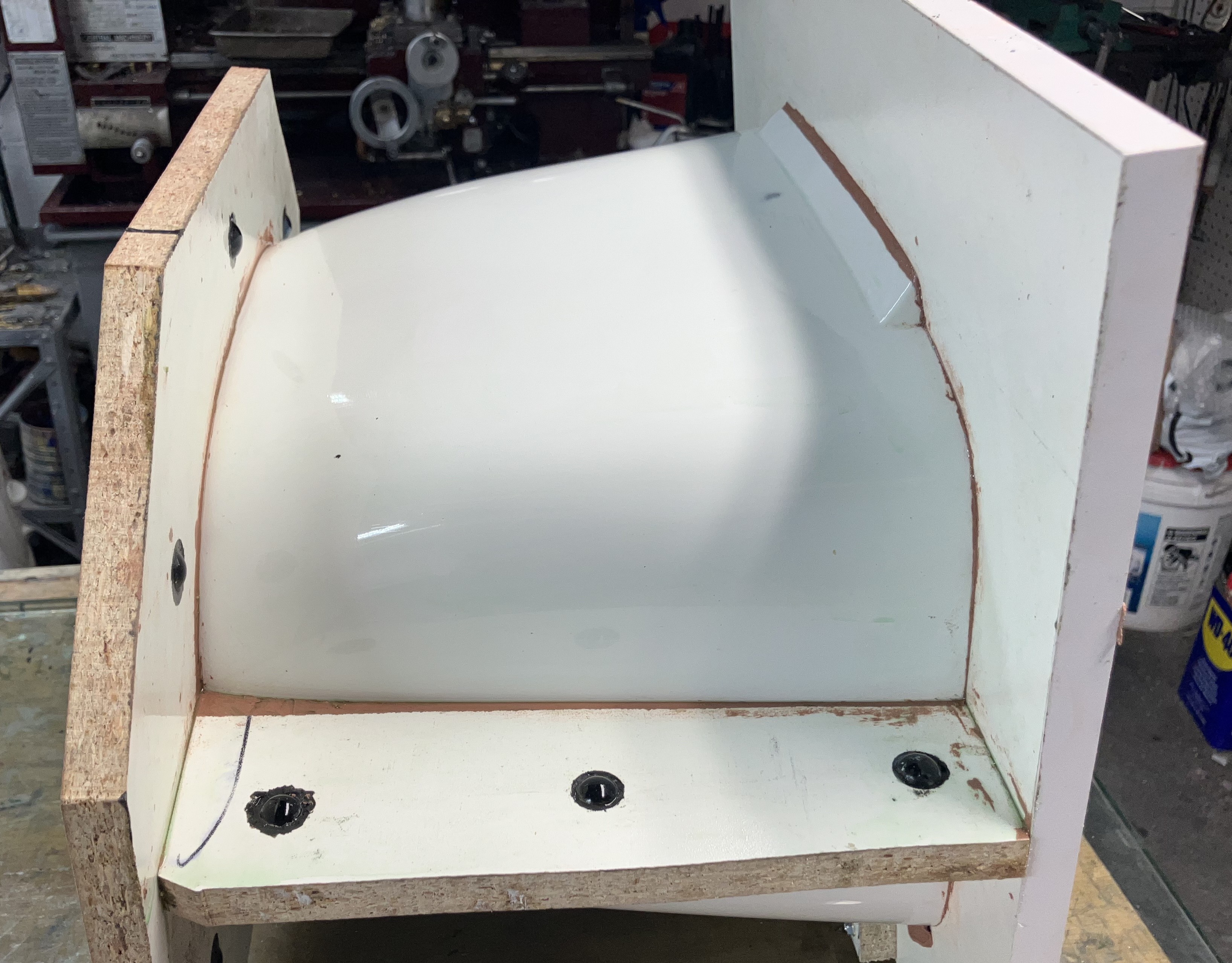

Have the parting boards removed and ready to start the upper half of the cowl. No rush only sufficient resin for the tooling coats. More on the way sometime next week. The bottom lay up was 2 tooling coats, 1 layer 1 1/2 ounce cloth, 4 layers of 4 ounce cloth, 1 layer of 40 ounce cloth, that 40 ounce really soaks up the resin but builds fast.
