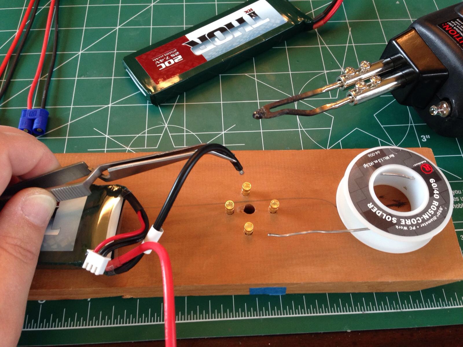

I use EC5's on all the 10S lipos and am slowly converting to EC3's on all my 3S and 2S. With that said you need a high temp iron to solder these pain free. Also try to understand what a cold solder joint looks like, I learned when a brand new PL6 charger had a cold joint on input and it would never charge at a full throttle 40 amp. I use a wood block with hole to fixture them. image.jpg
