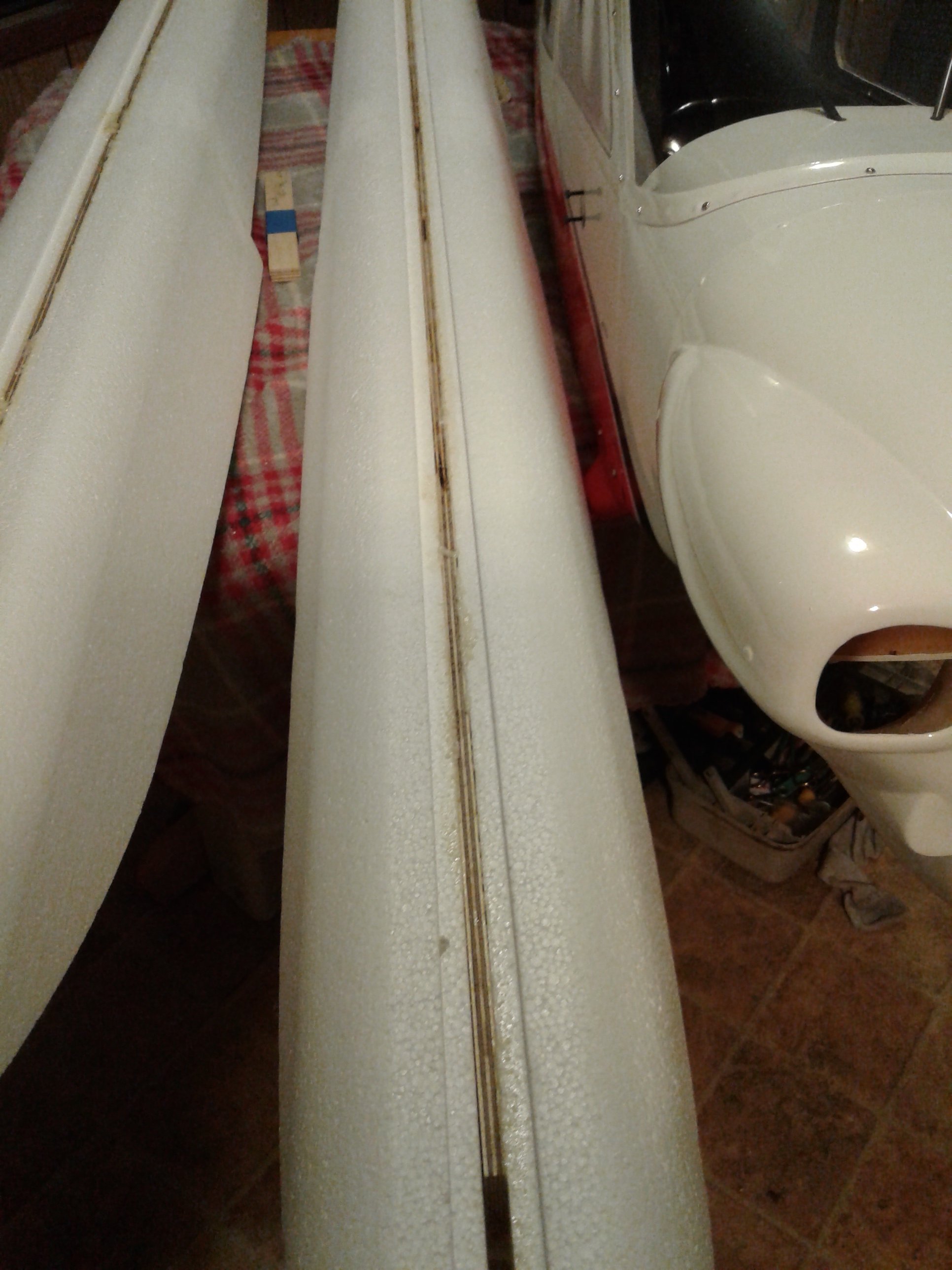

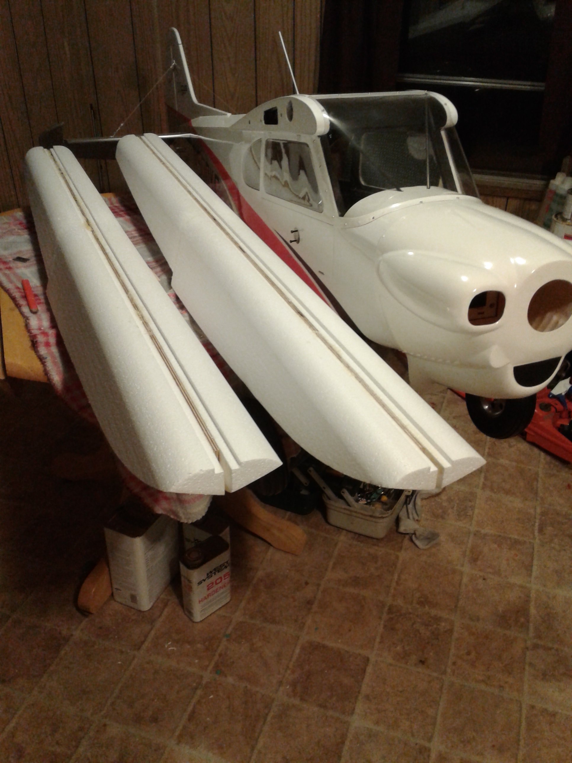

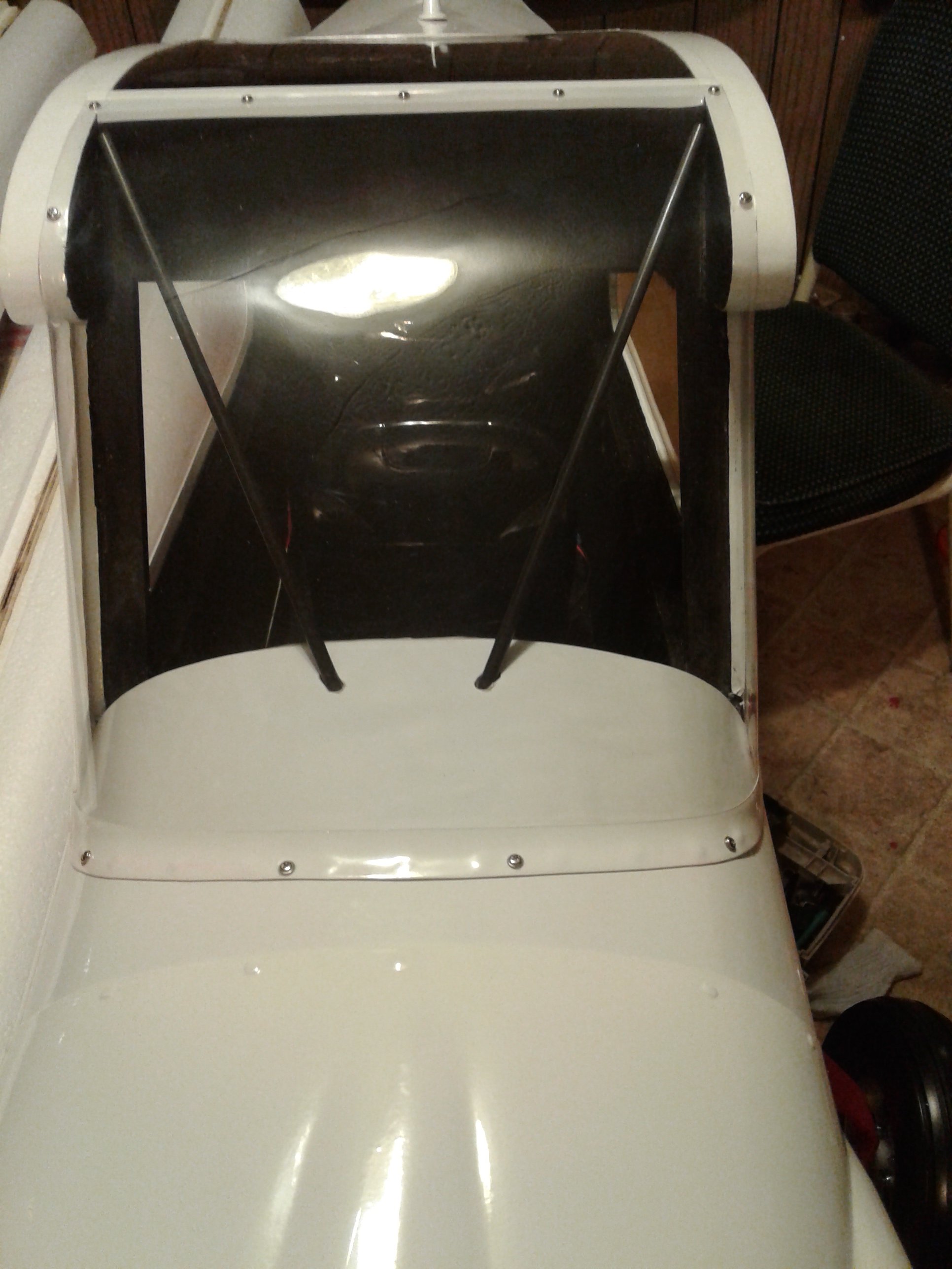

Some more work accomplished. Windows and front windshield installed..front windshield I screwed on turned out nice and clean. Got my floats from Mark at seaplane supply! There very well cut and got them joined today and just now glued in center spar..Got to love that gorilla glue, just as much as expanding foam! Lol. Floats lots to do yet..

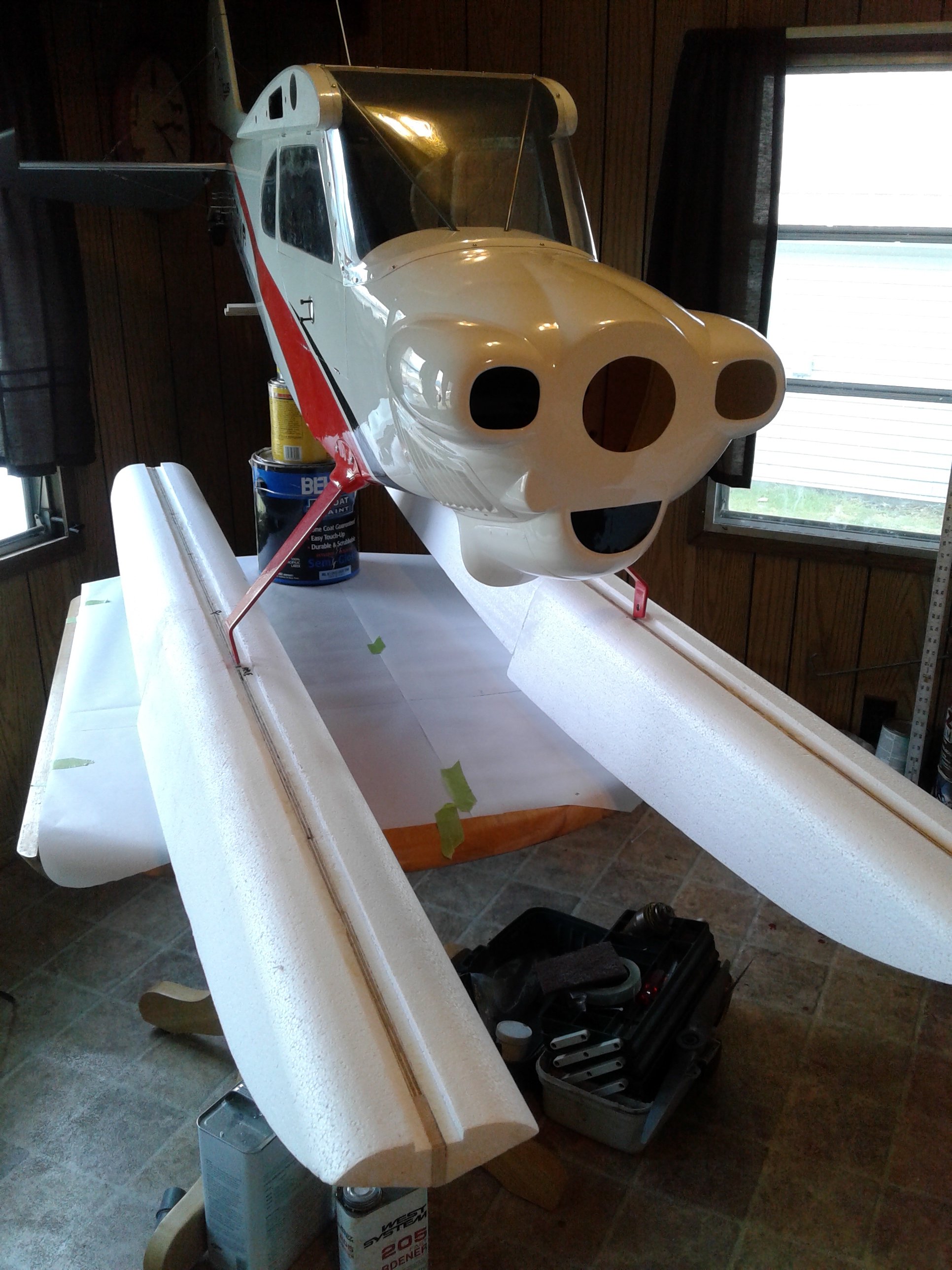

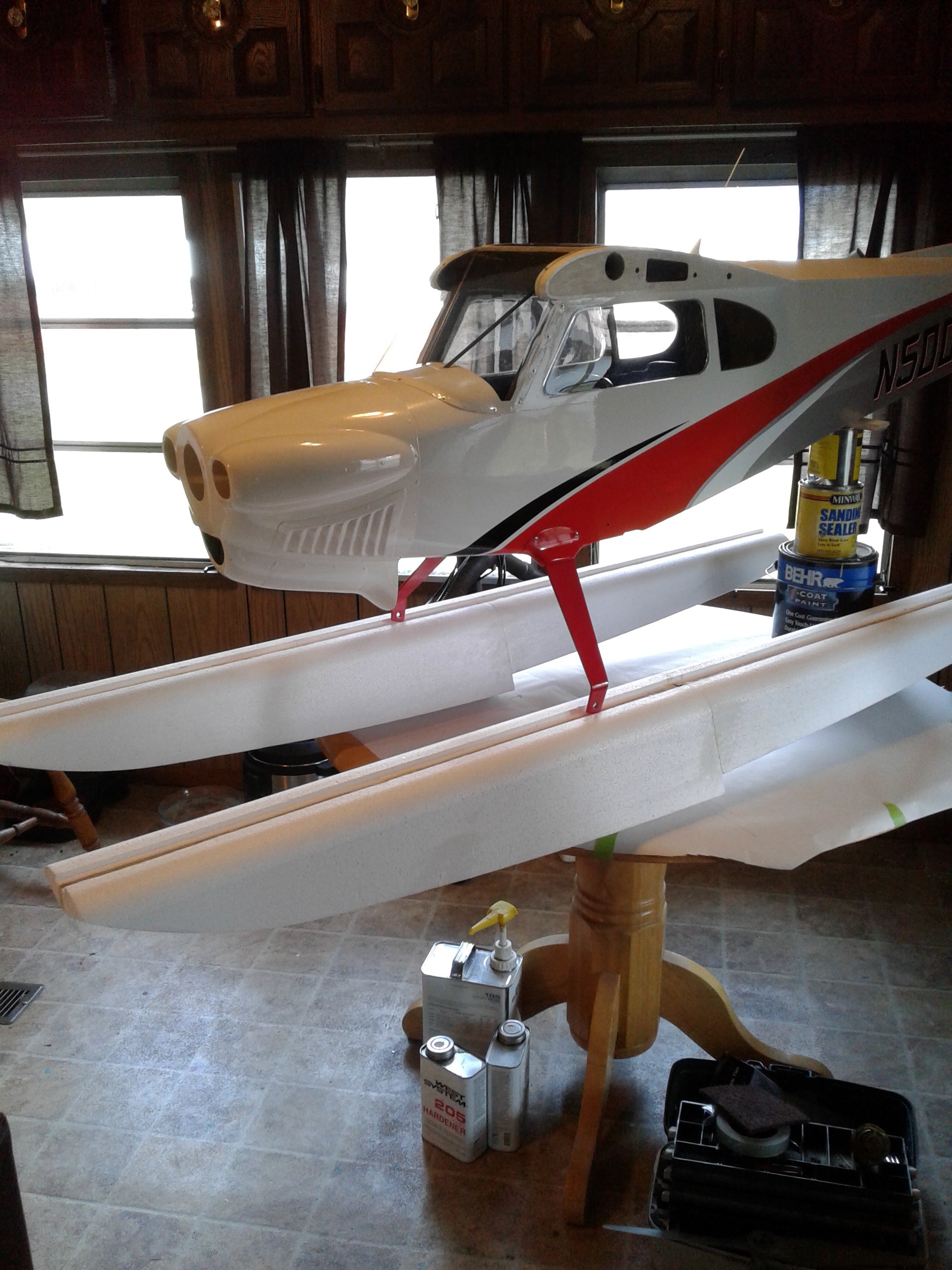

Set my plane on floats to day to see where front ply plates need located. Float step 1/2 inch behind cg..have to construct rear brace to floats. I think she looks great on her pontoons!

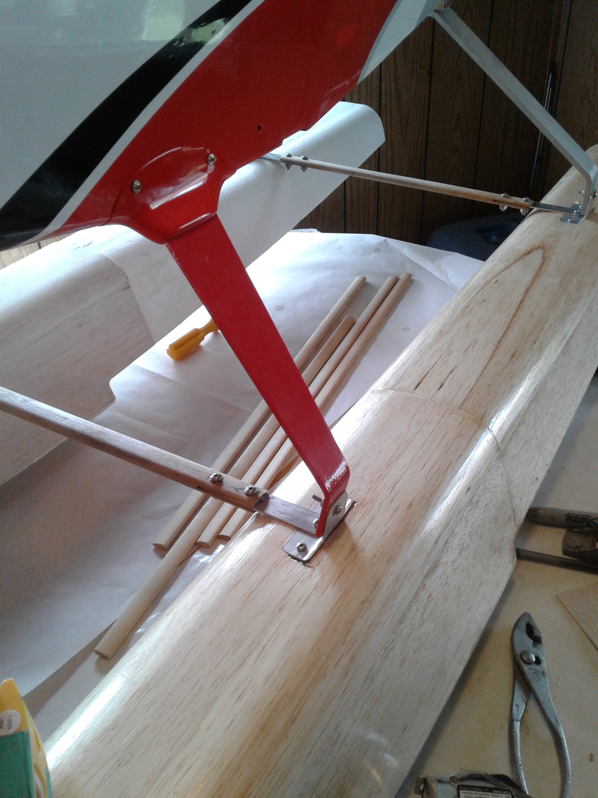

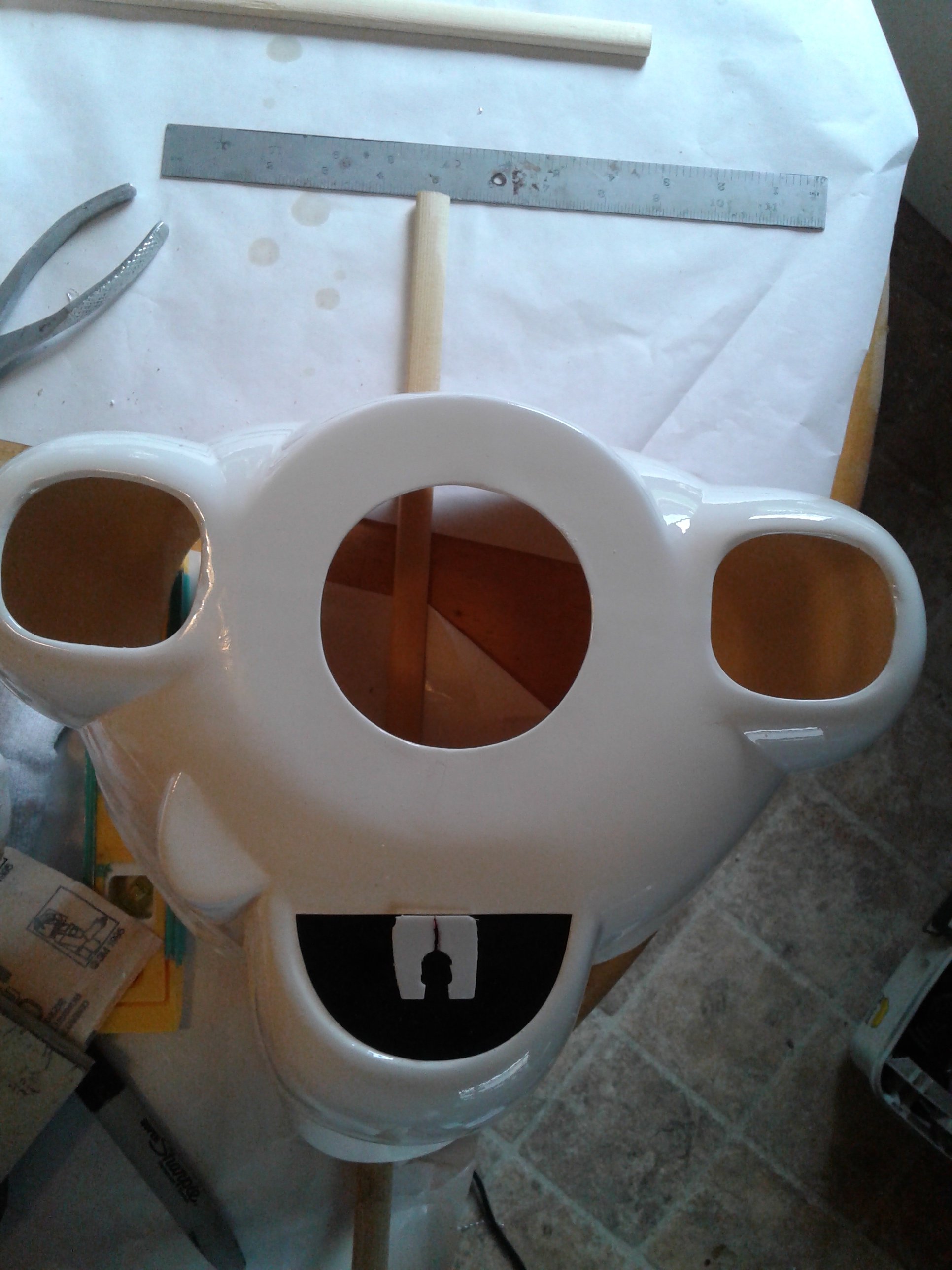

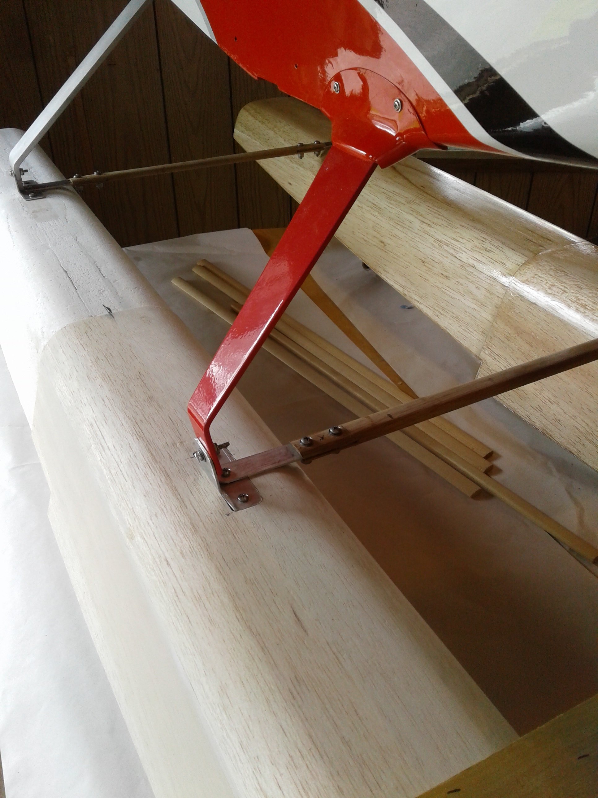

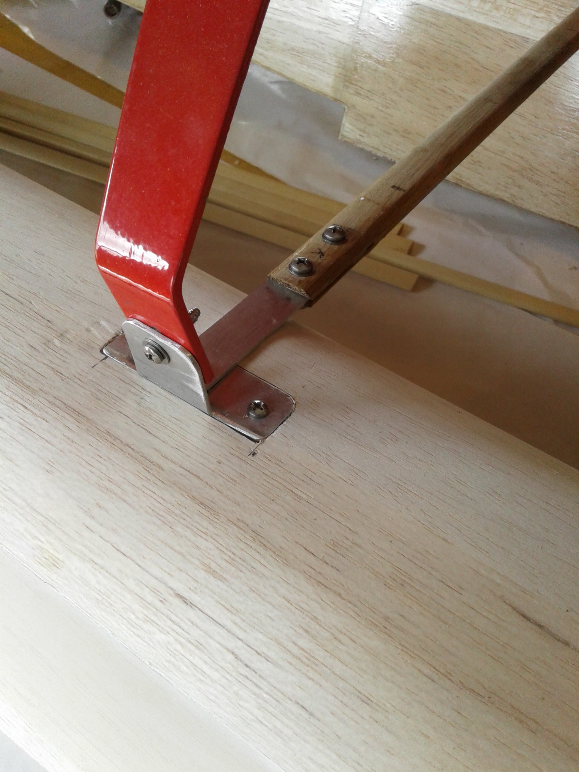

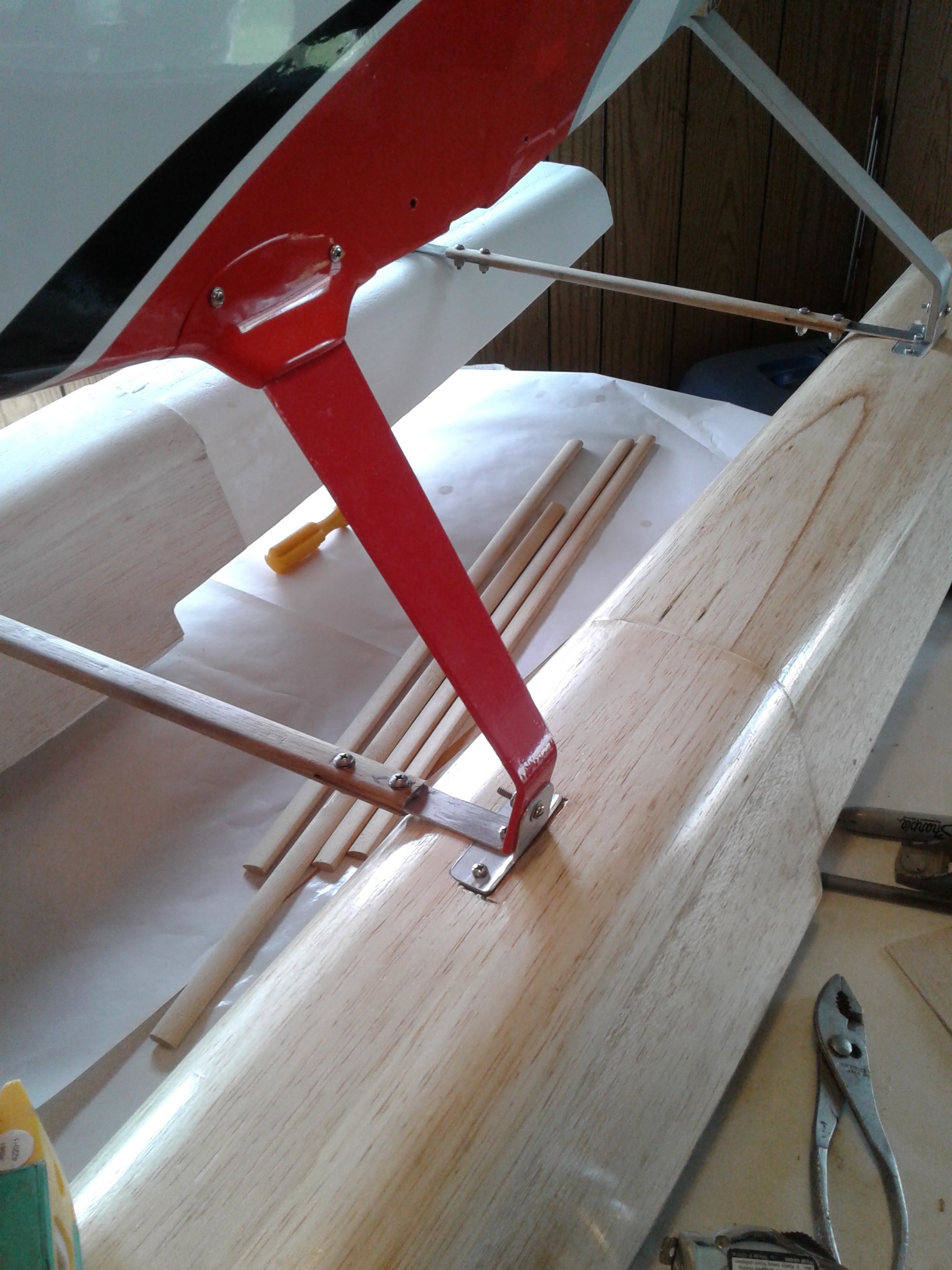

Got some work done on my xcub.x been working on the float mounts. Made some aluminum brackets and cross braces. Ran out of balsa and ply to finish sheeting right float. Made cross braces from some white oak I had and put an airfoil profile on it..now have to come up with those diagonal struts that go from front gear to aft gear..Just been studying pictures of the real x cub on floats and going with that.
