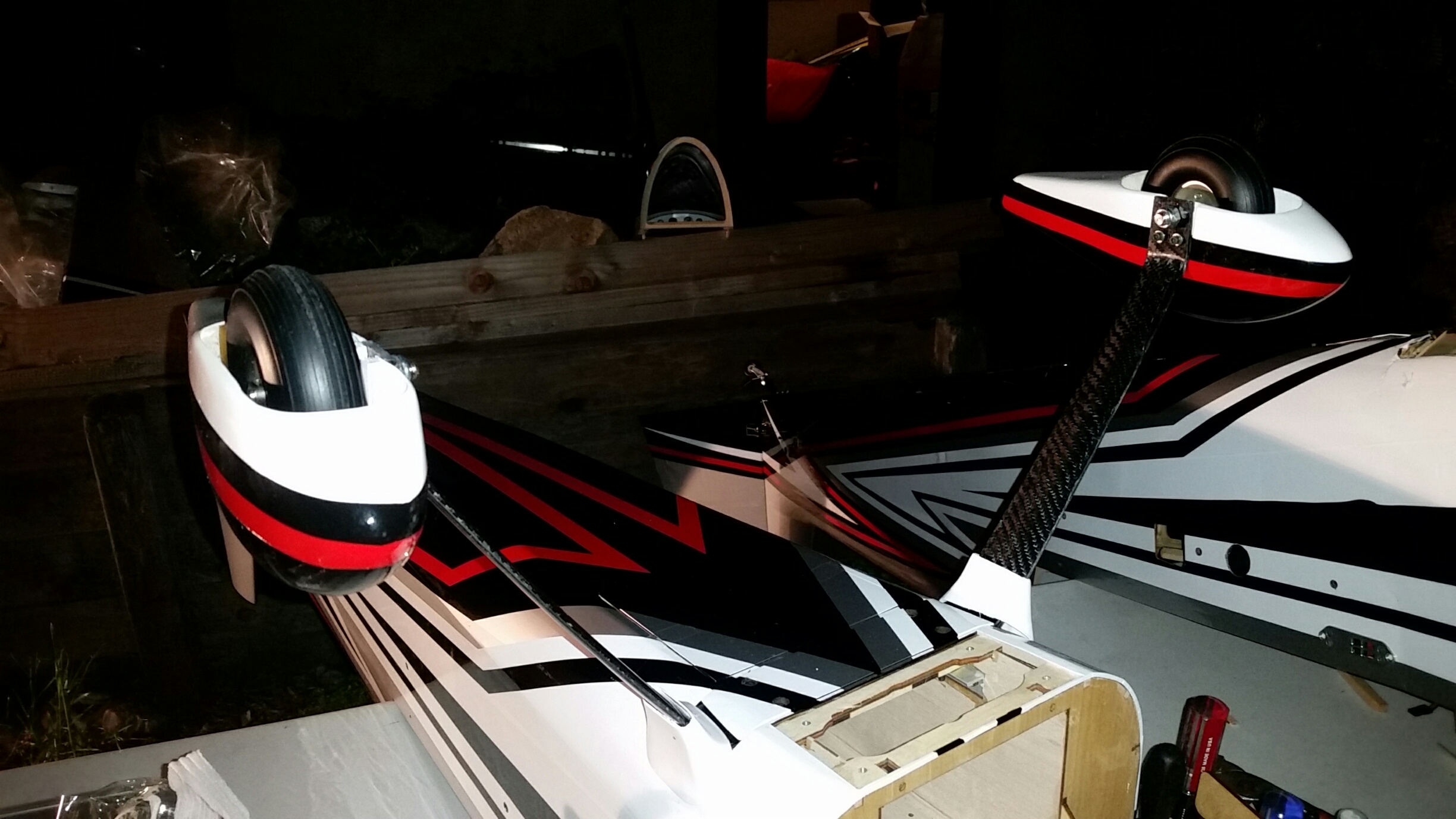

Progressing forward.
Landing gear on.

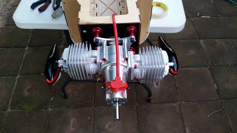

Engine back on.

Just a couple of hours of work left really, most of the work is going to be cutting the cowl again. What I hated the most was measuring the holes for the exhaust, anybody have any tips to make that process easier with a 1 piece cowl?
