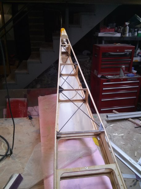

mikeh

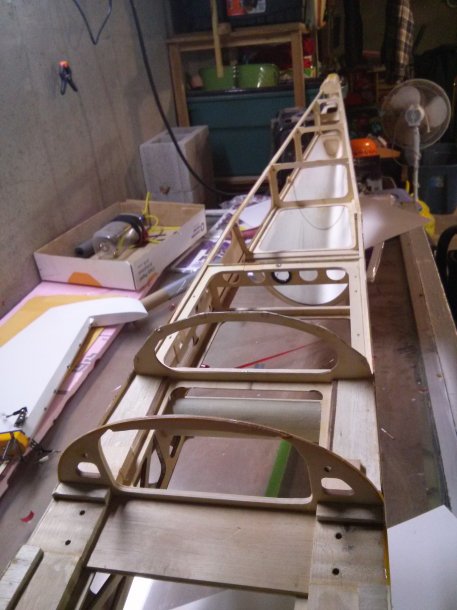

I have most of the work done but I thought I would share my progress. CAM00078.jpg CAM00082.jpg

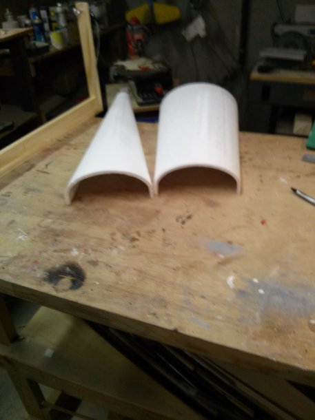

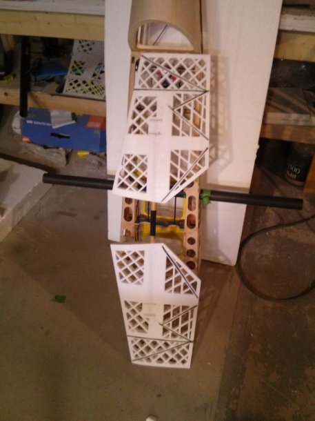

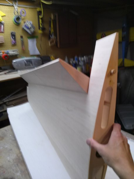

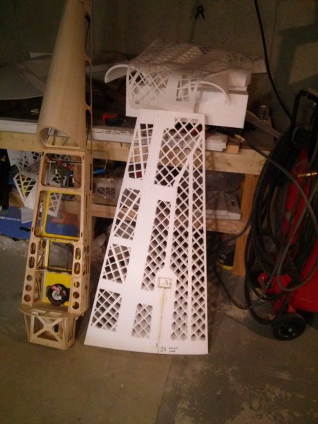

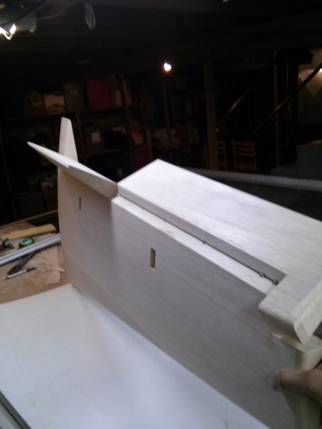

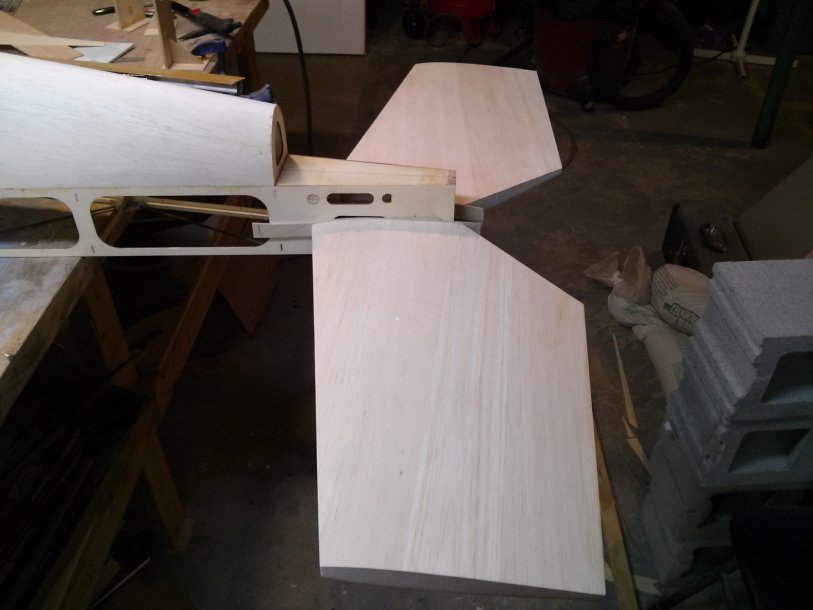

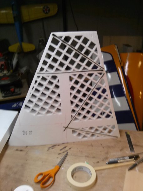

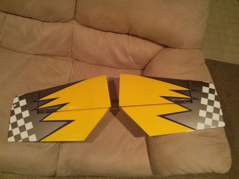

mikeh
Stabs ready for incidence. All that coring and I don't think I will do it again. Alot of work and the weight Savings are peanuts.

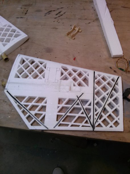

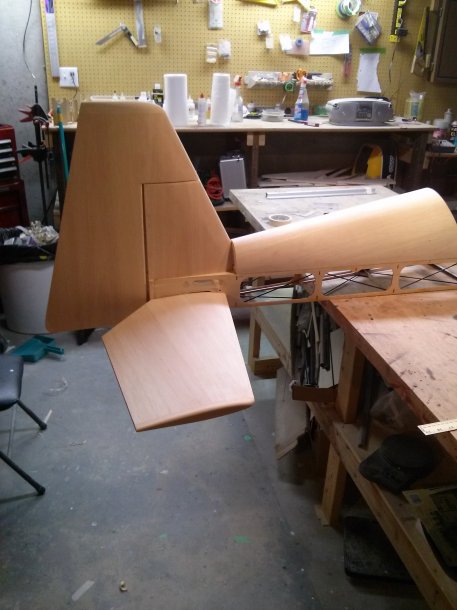

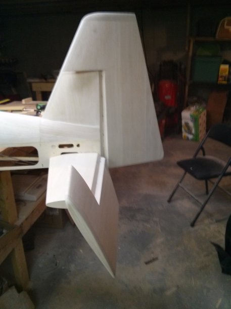

mikeh
Vertical stab is ready for glueing after incidence is set.

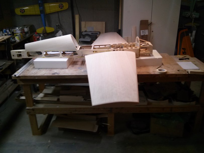

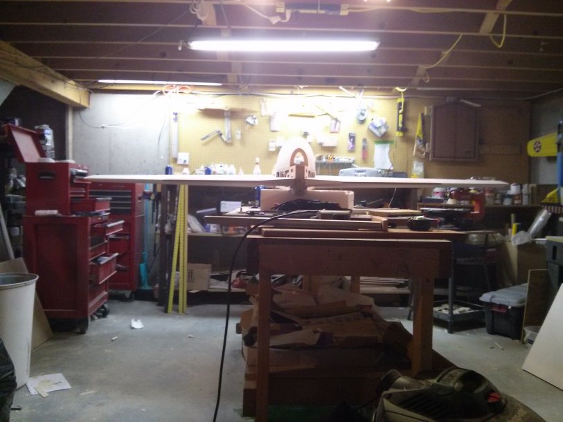

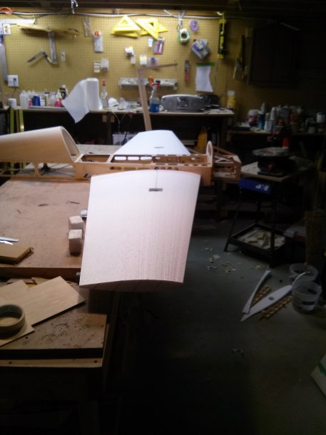

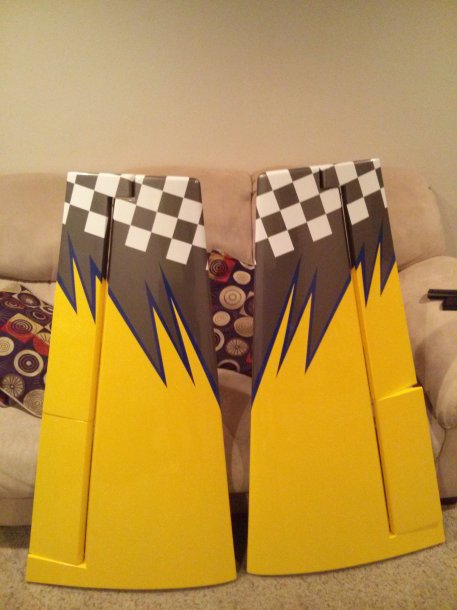

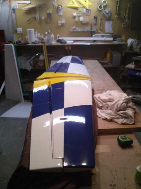

mikeh
A couple pics of the wings, coring, sheeted, and incidence set. Also checking for squareness.

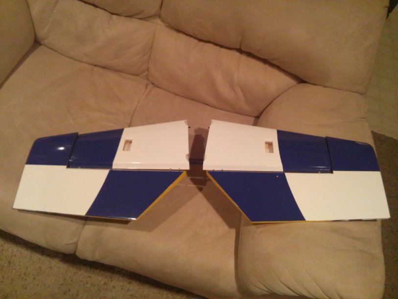

mikeh
All control surfaces cut loose. Thought I would play with the split ailerons on this build.

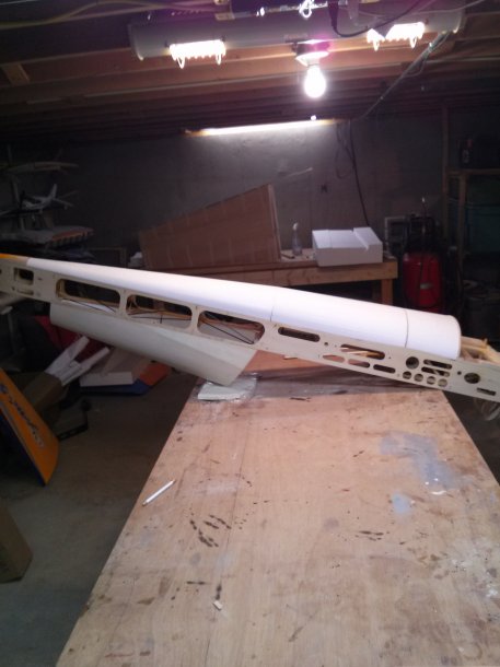

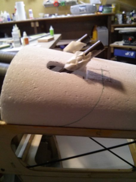

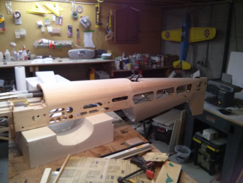

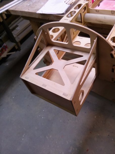

mikeh
Foam belly was cut, I made it a half inch deeper to make room for the pipes.

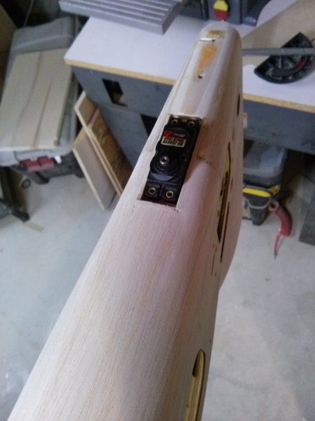

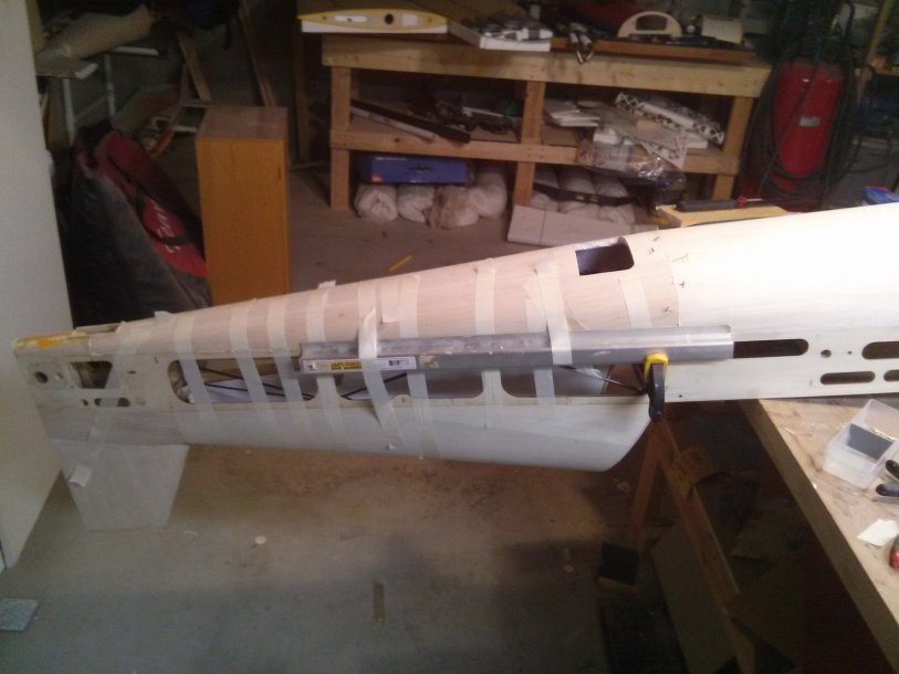

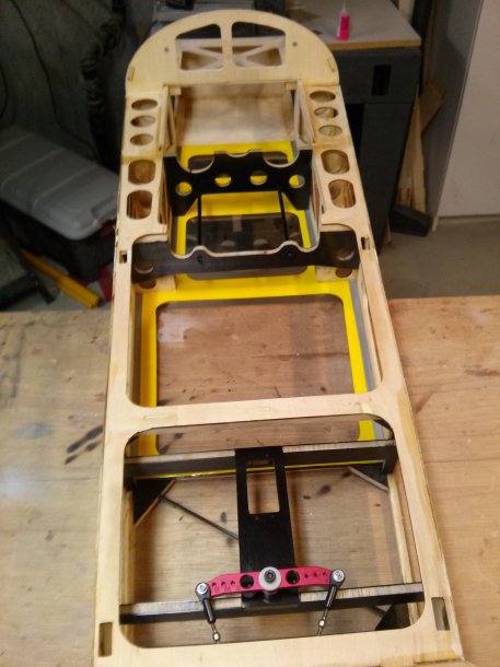

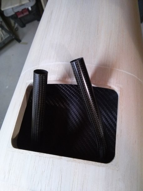

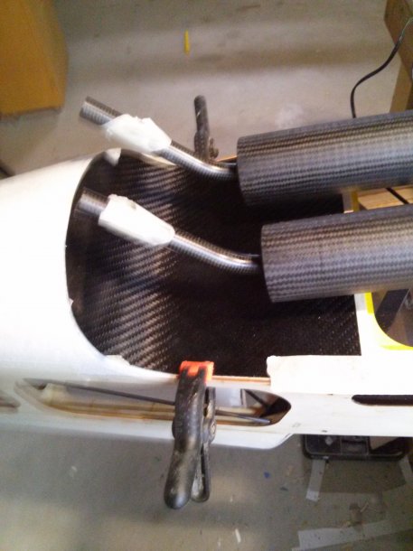

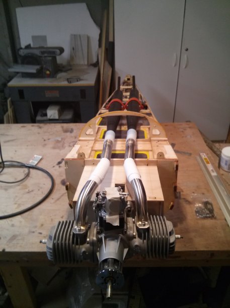

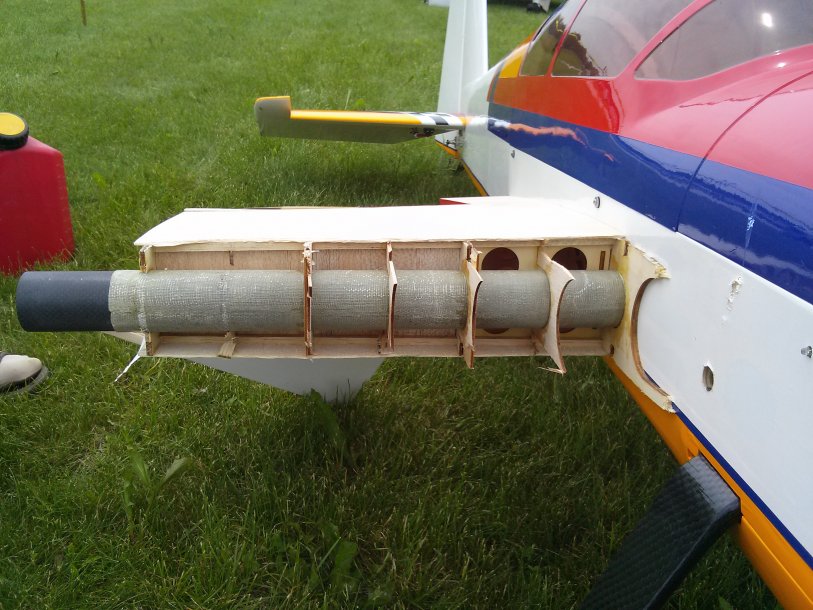

mikeh
Motor and pipes were mounted and the belly all glued up. I also moved my rudder servo to the back in front of the tail wheel.

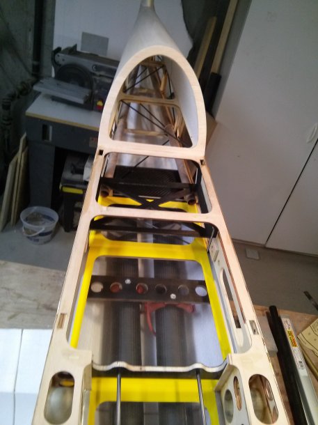

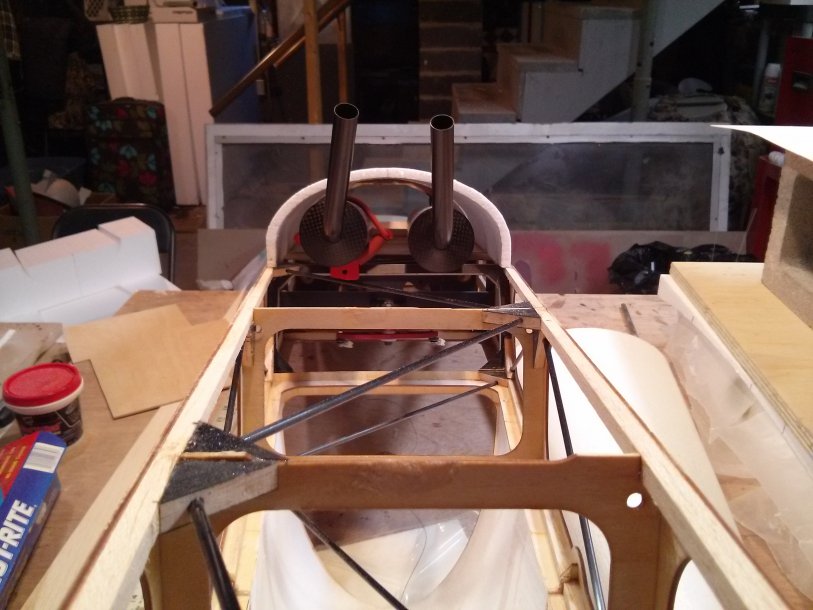

mikeh
Looking from the inside, I put down clear Monokote. I have some louvers coming from taildragger rc. These will go on the bottom beneath the pipe mounts. I need to be able to put on the silicone bands.
