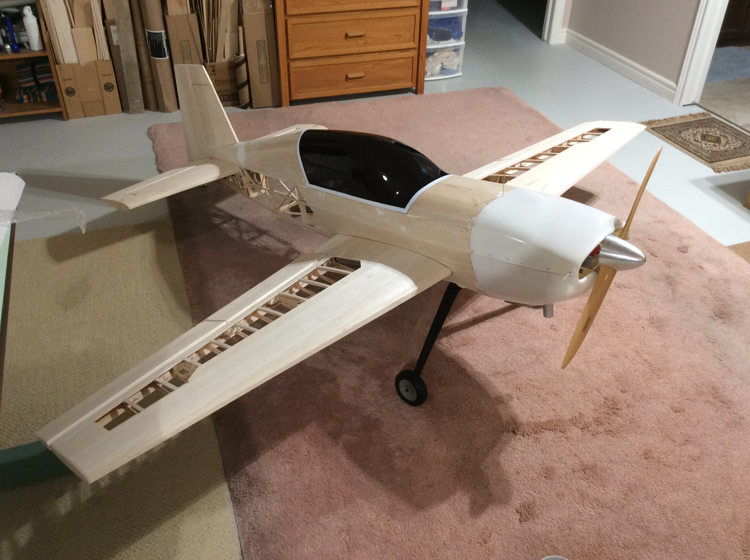

    Well the first time it has been assembled, at least it looks like a plane. All I can say all my other extra’s do not even look close this plane it has a big bold round fuselage. It actually looks cool if I may say so. I hate to say this the so called 10% rule ? somebody needs a new pair glasses and a better ruler.

    NICE WORK!! It does look cool!
    Somehow I missed the split ailerons. Those will be fun!
    Paint scheme selected yet?
    Snoopy1 and pawnshopmike like this.

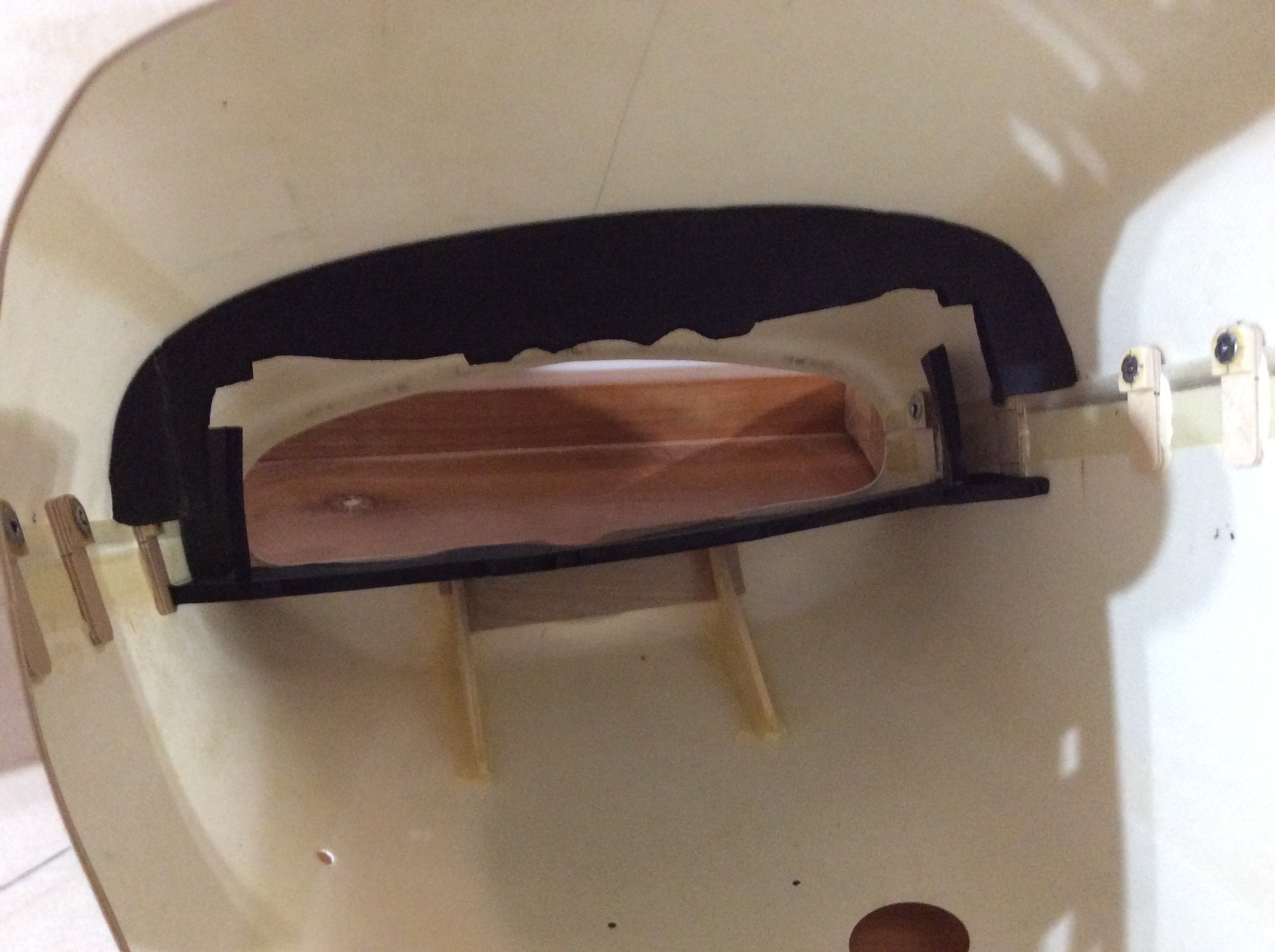

  9. What, no photos?

    @TonyHallo as requested.
    I removed the cowl this I think shows a little better if you need more let me know. Picture is taken from the fuselage side looking into the cowl from the back.
