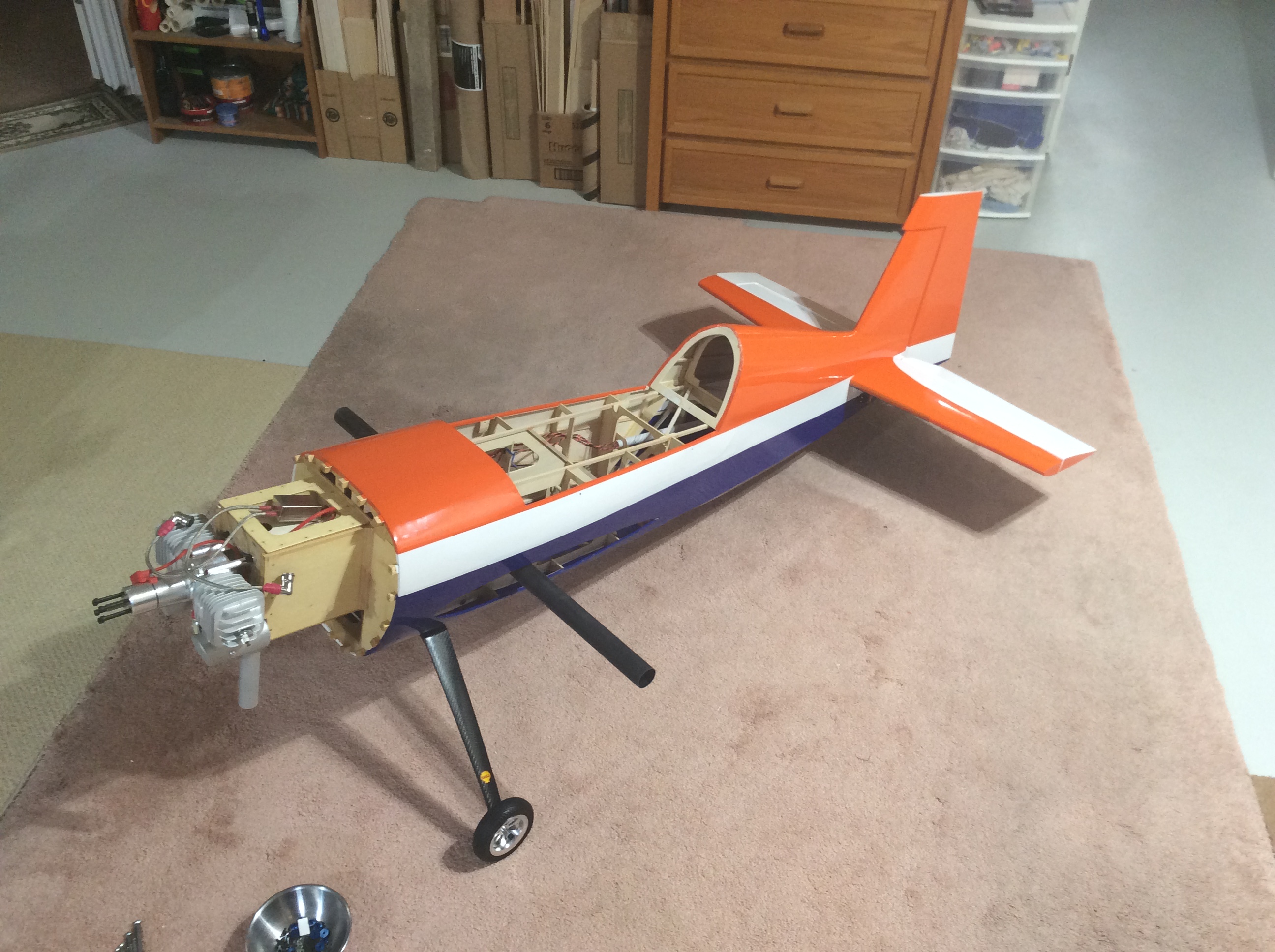

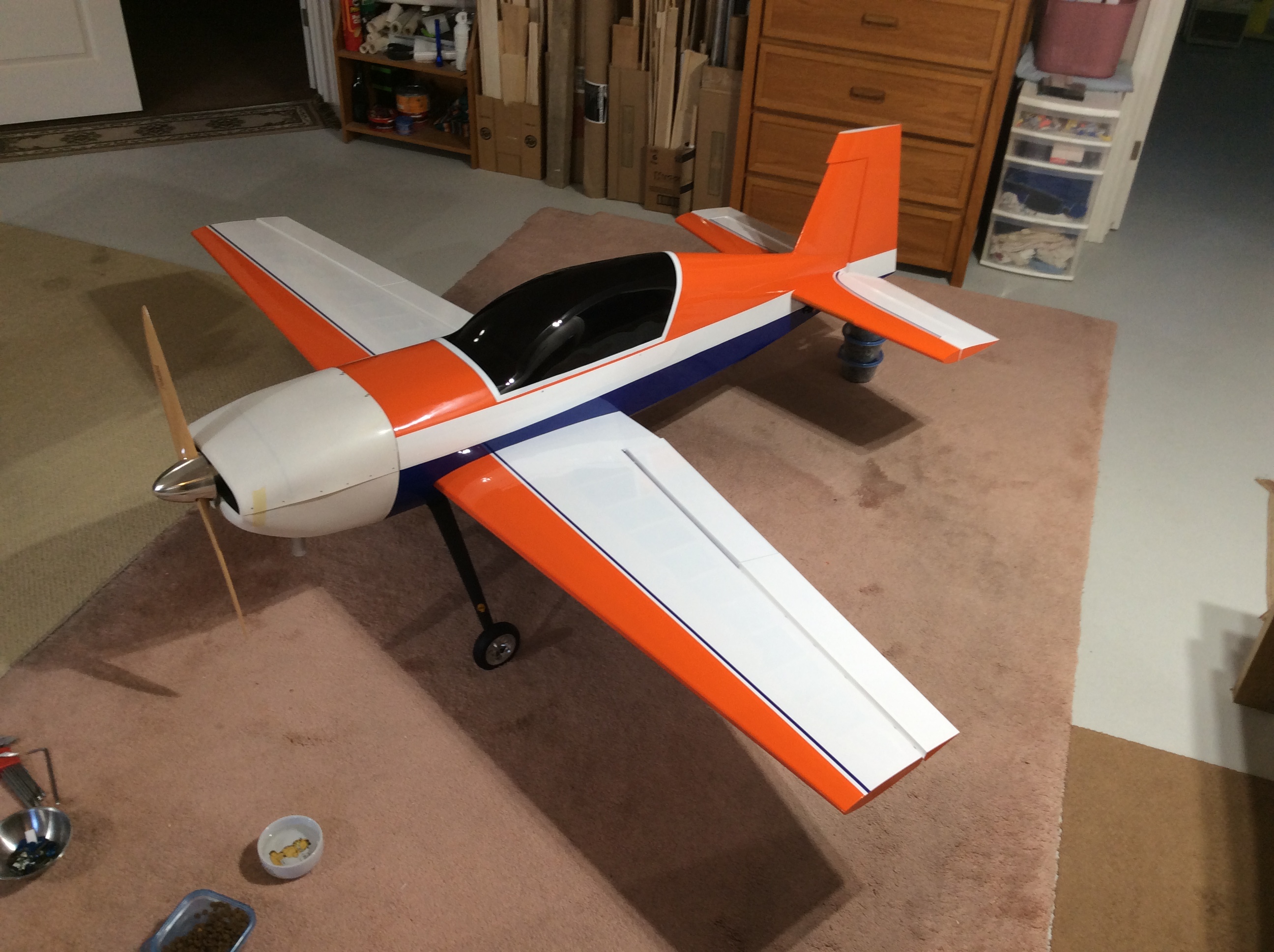

Making progress started the assembly so far so good. Just looking for the odd part but nothing important. Soon I will be able to do a CG check and see if it is possible to balance the plane with out having to add weight.

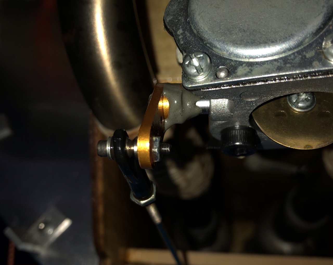

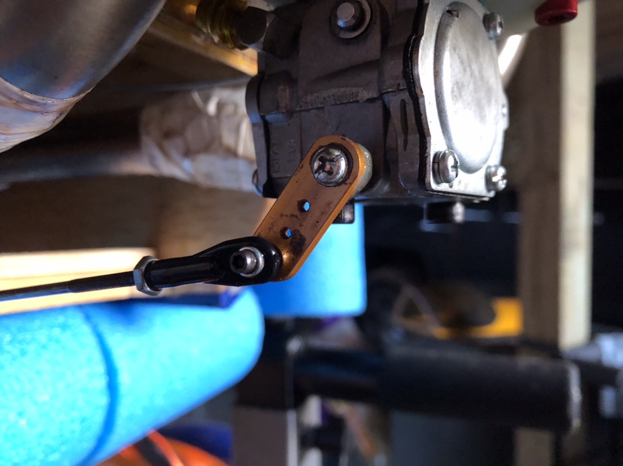

Finally lowered the Python, and pulled the cowling off today to adjust the throttle linkage.
Interesting fix for the choke arm. JBWeld possibly?

Well I thought I was reasonable close to the required CG. It turned out the plane is quite tail heavy. When I moved everything in the plane as far forward as I can it barely balanced. I was going to install two 2600 mah batteries but changed to two 4000 mah batteries and it balanced on the money. So now building a removable tray up front so that everything can be fitted and maintained. Now just have to wait for the batteries to show up and the extra weight from the paint that will be added to the cowl will add a little nose weight.
Plane looks awesome buddy, you do quick work!
:oblong: Is it just a servo arm JB had welded to the choke linkage? Whatever works 'eh!
