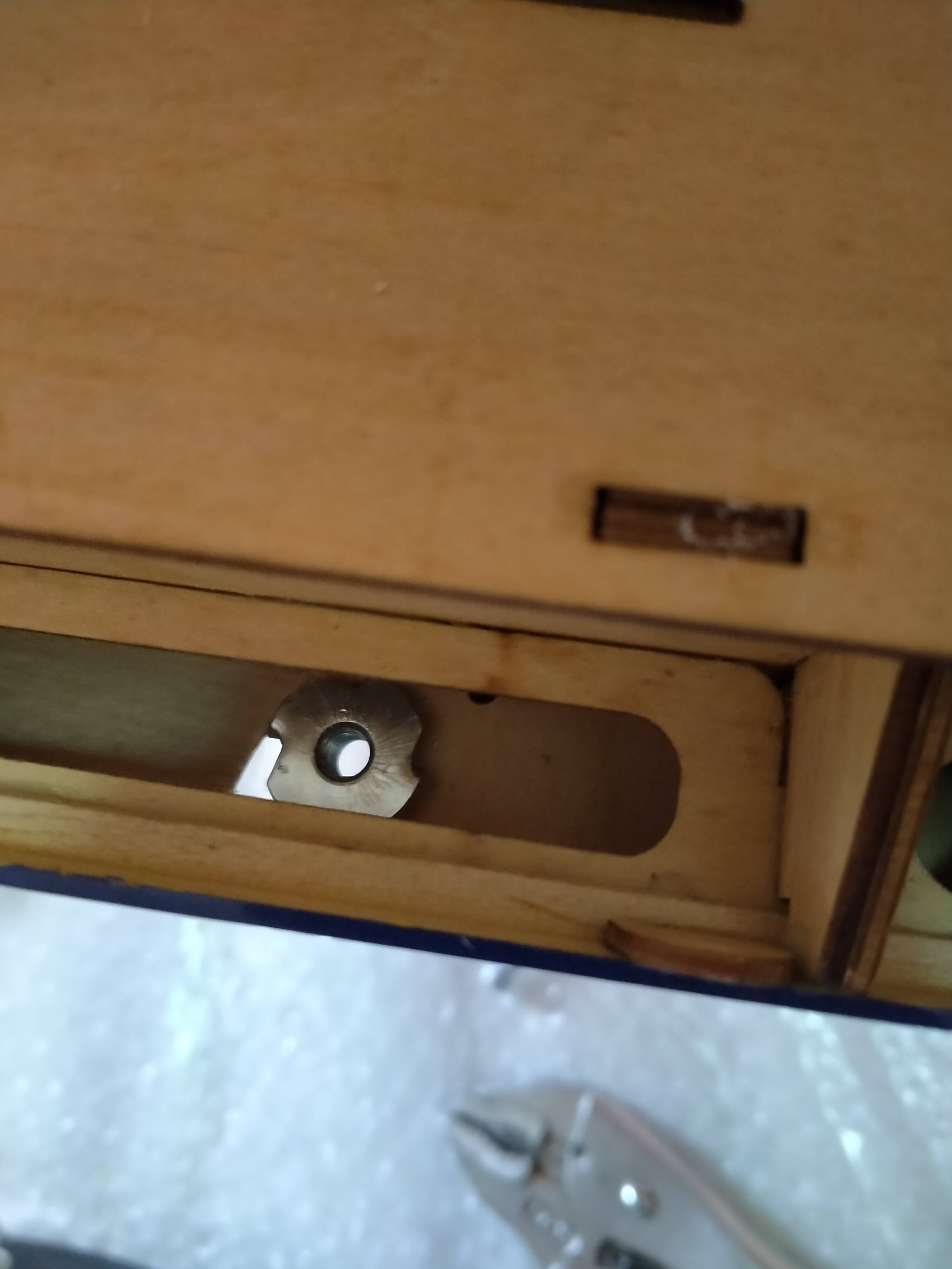

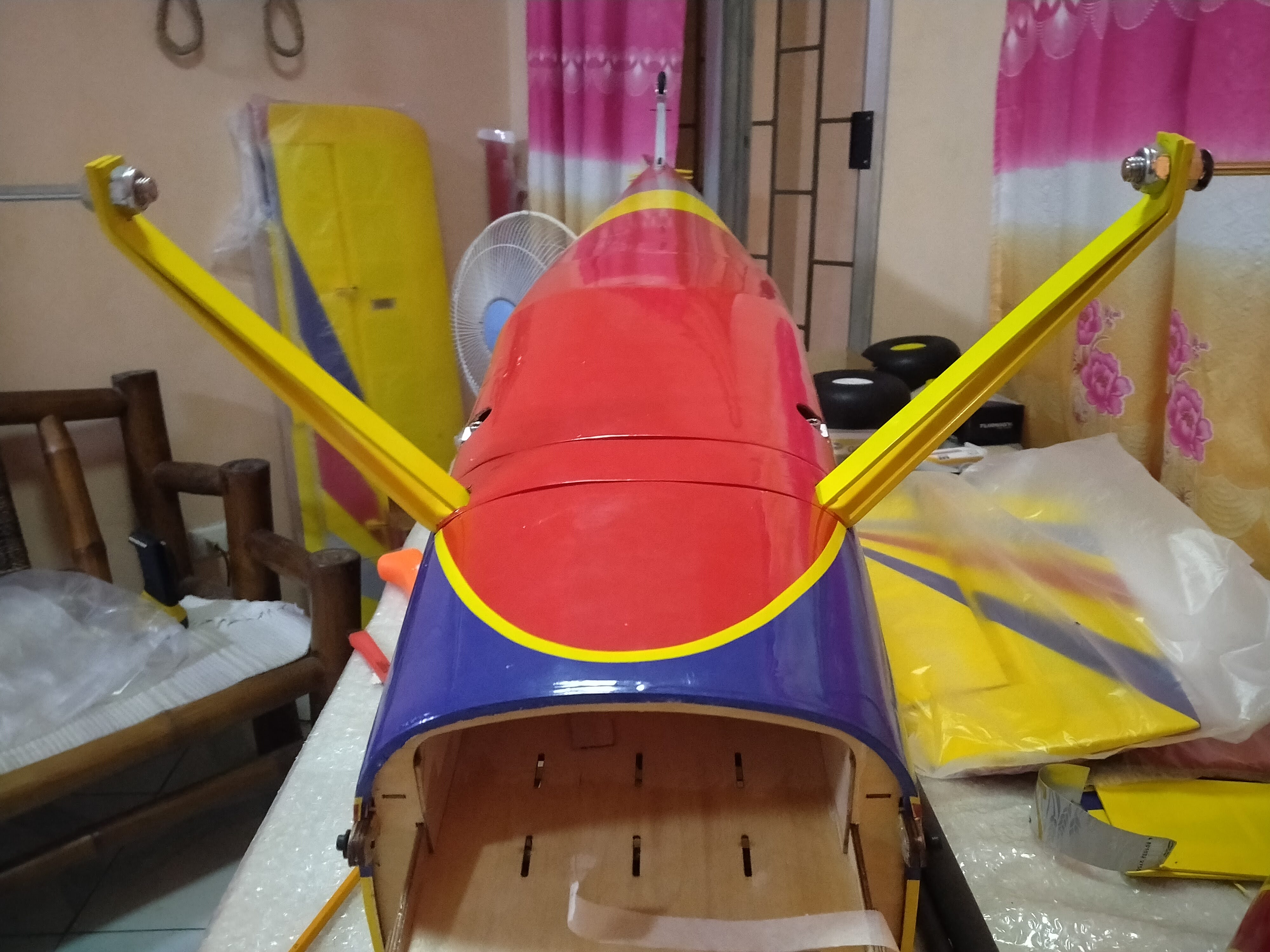

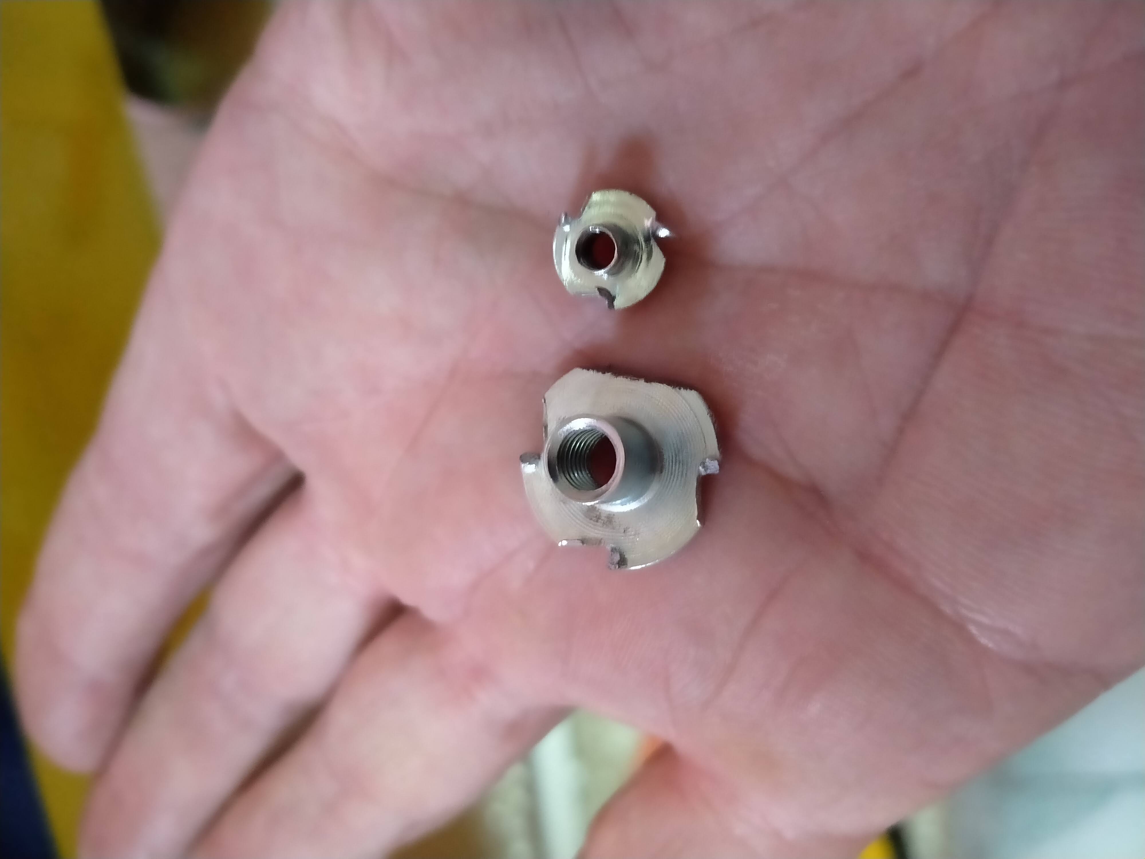

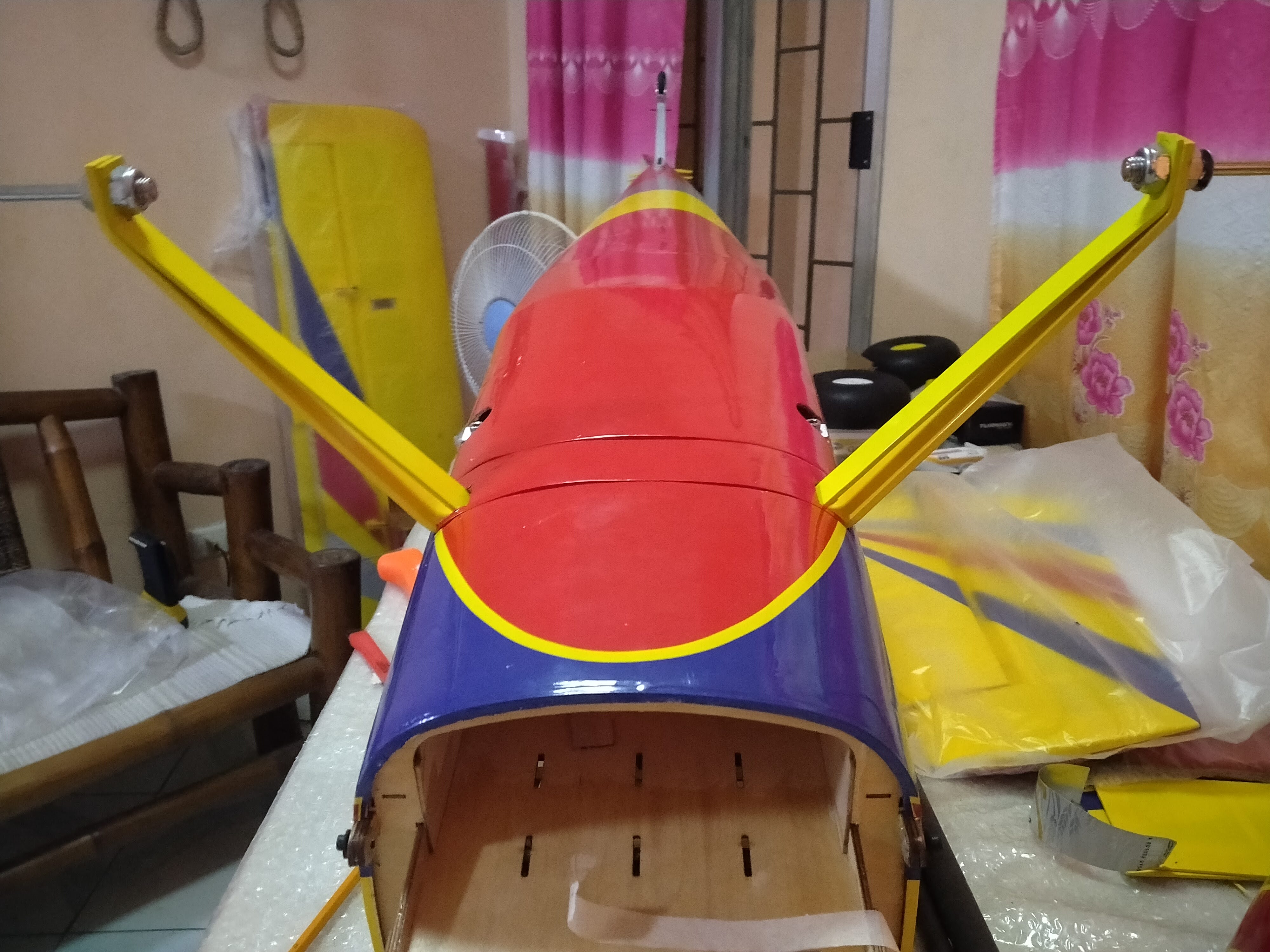

Did you replace the blind nuts? This seemed to be the weak point for me, the ones included are pretty weak/thin and will eventually give up by stripping or shearing unless they've addressed this already.

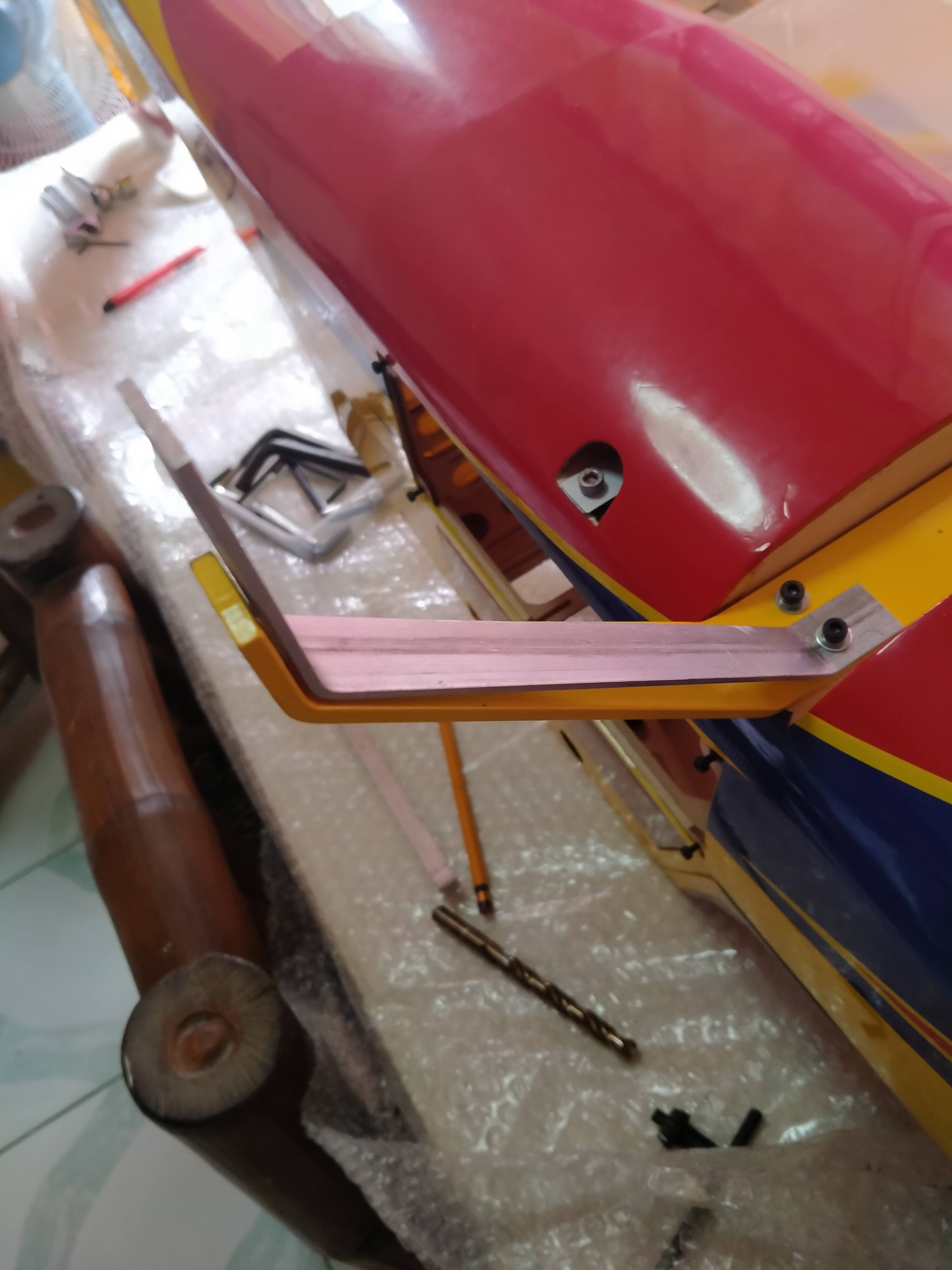

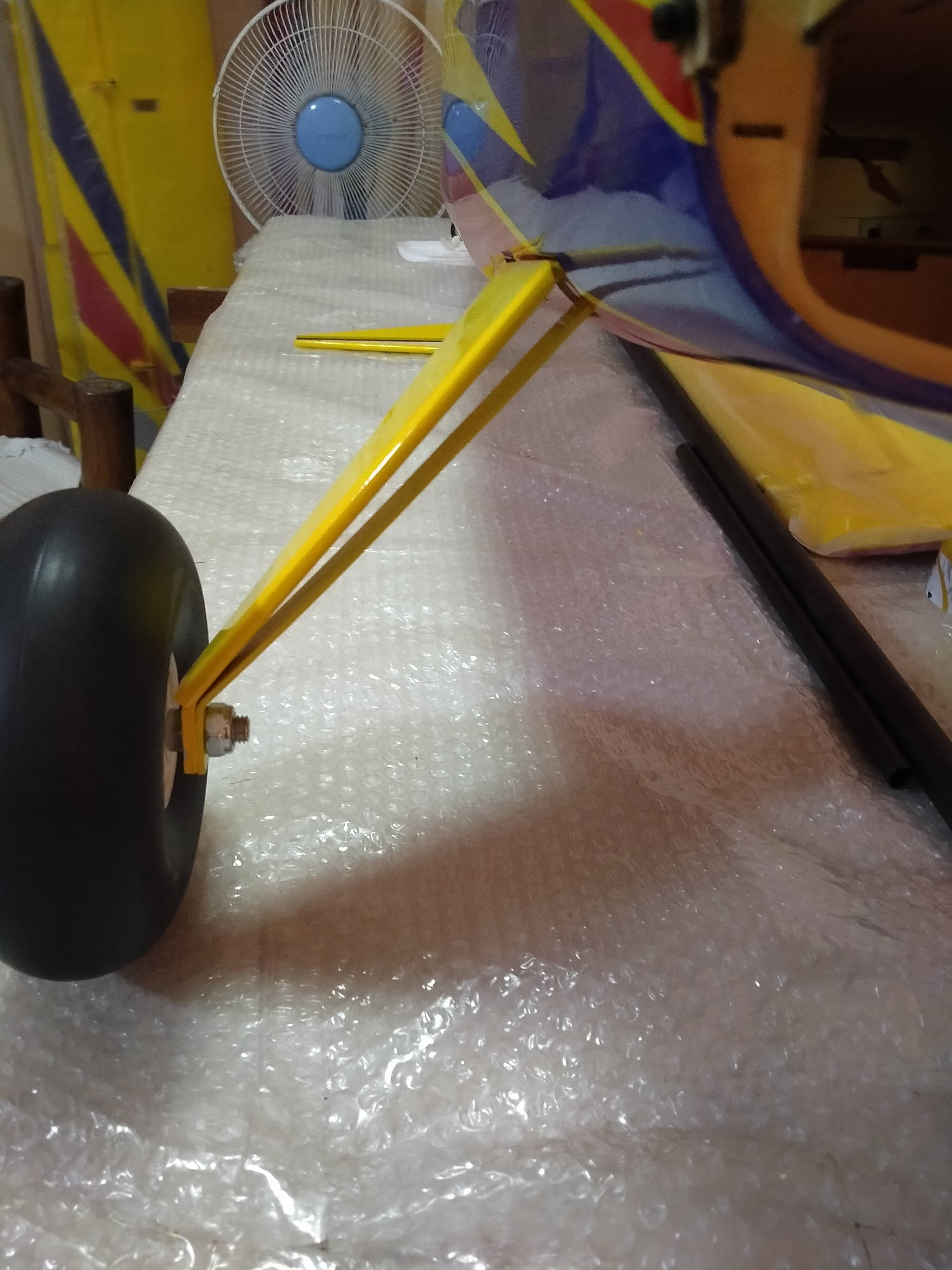

That's a good point, I did not, but I was just looking at it this morning and thinking 3mm bolts and blind nuts here look pretty wimpy. With the aluminum strap the forces no longer transfer to the Tnuts but each strut to the other, the hole is tight no slop, but it sure wouldn't hurt to pop out those T nuts for something a little stronger.

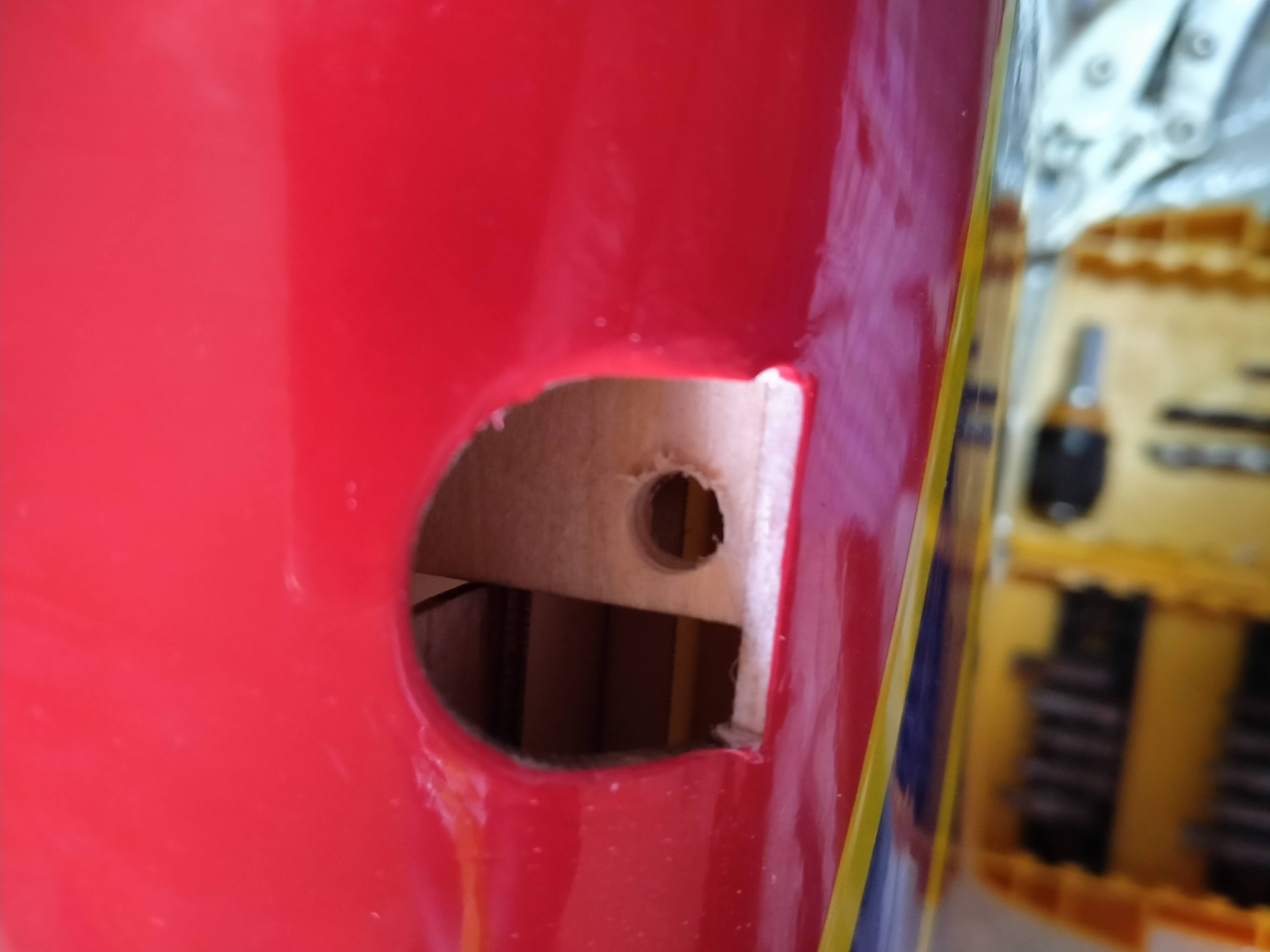

I'm wondering if anyone has opened the little holes in the wing to see what the wing situation is with regards to the strut attachments.

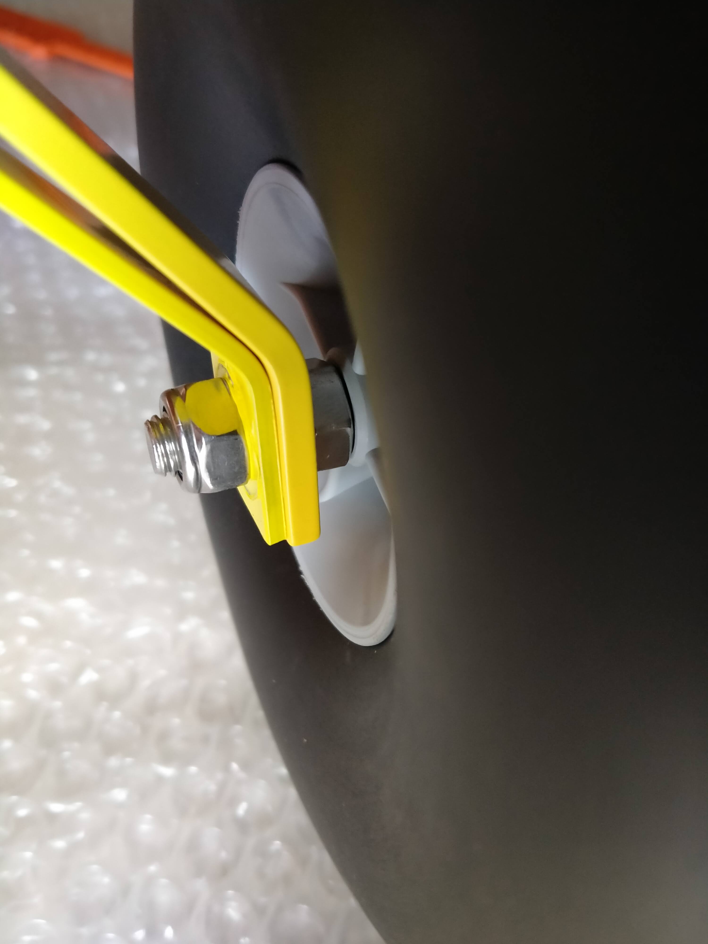

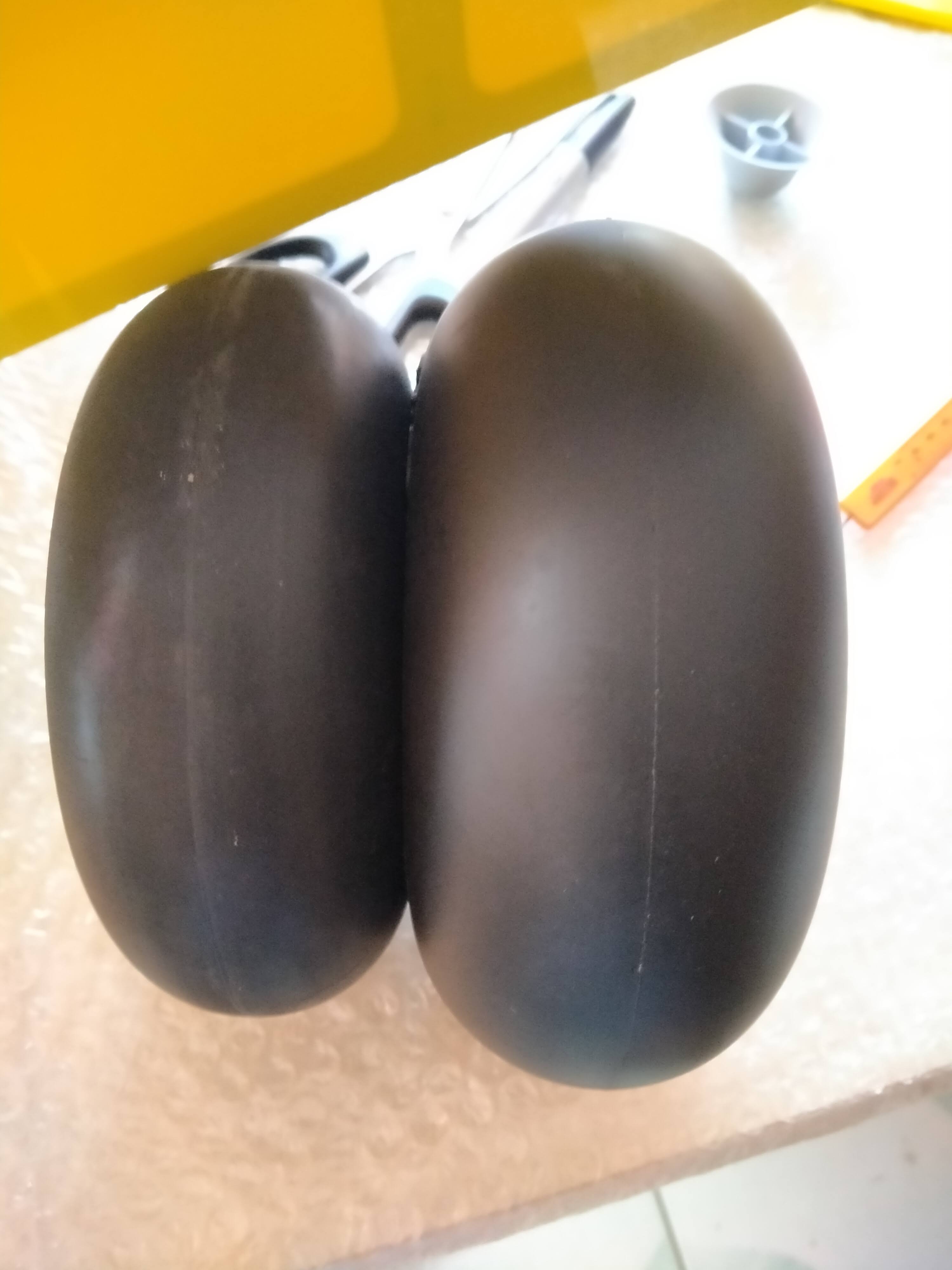

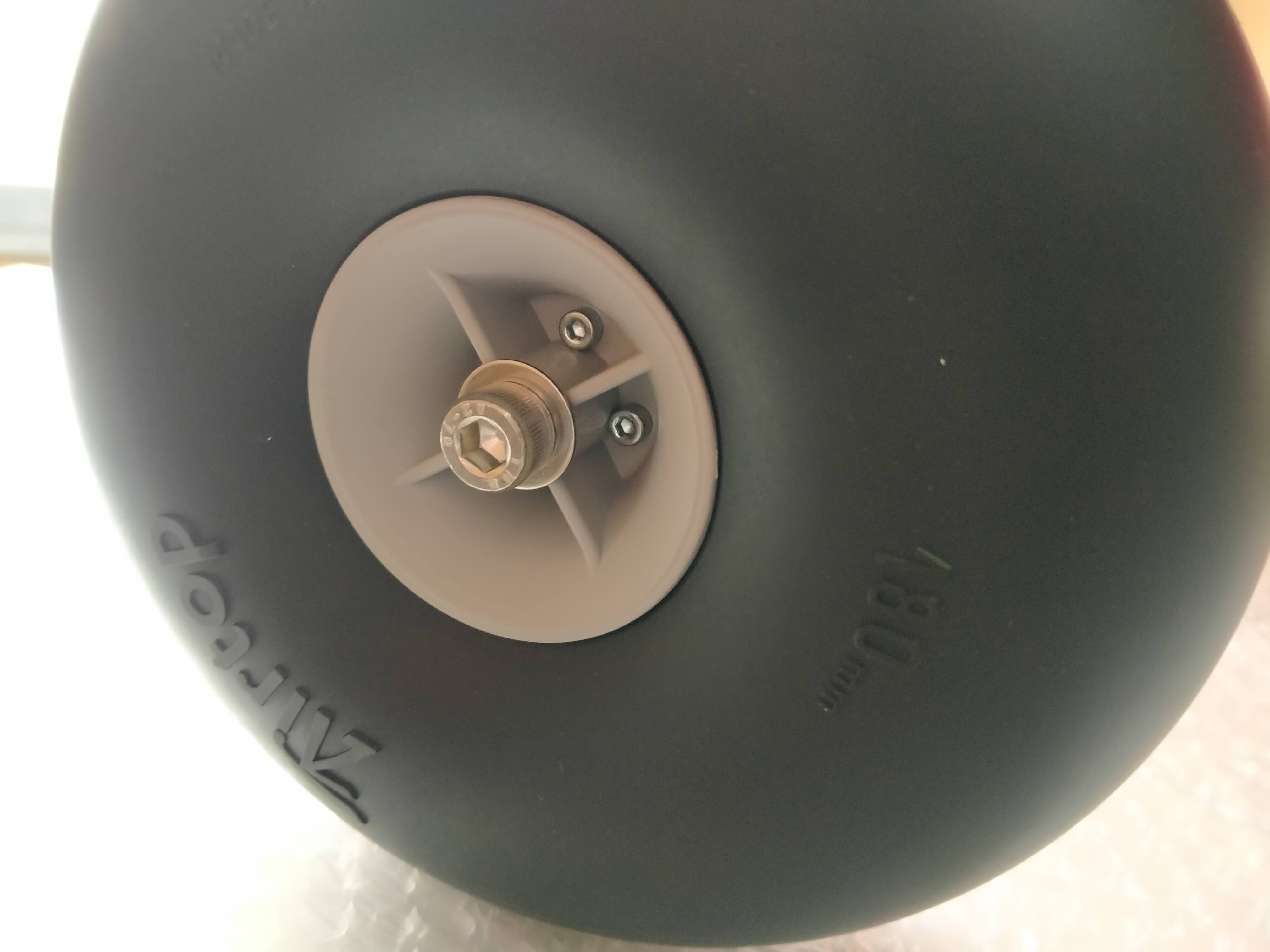

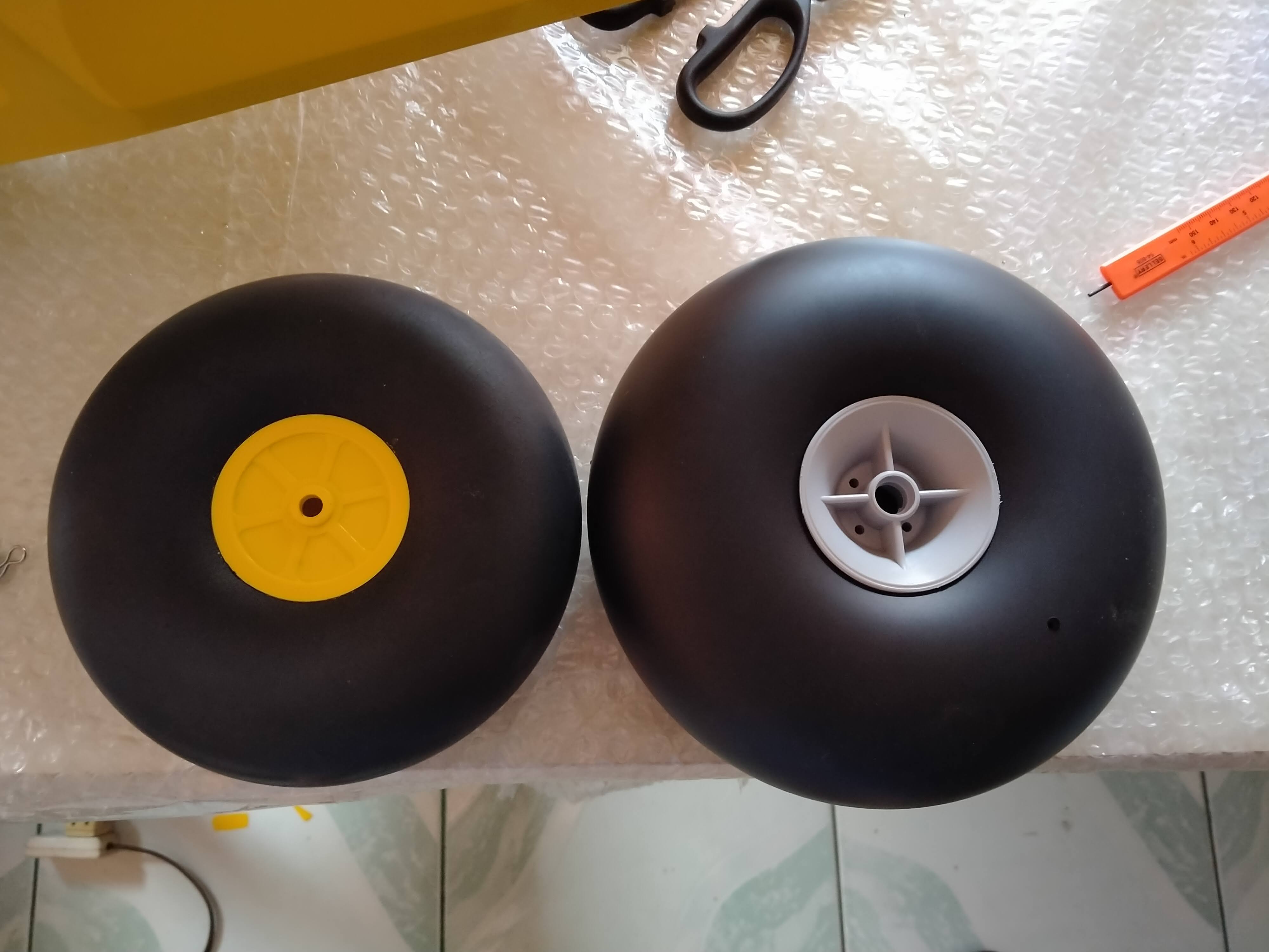

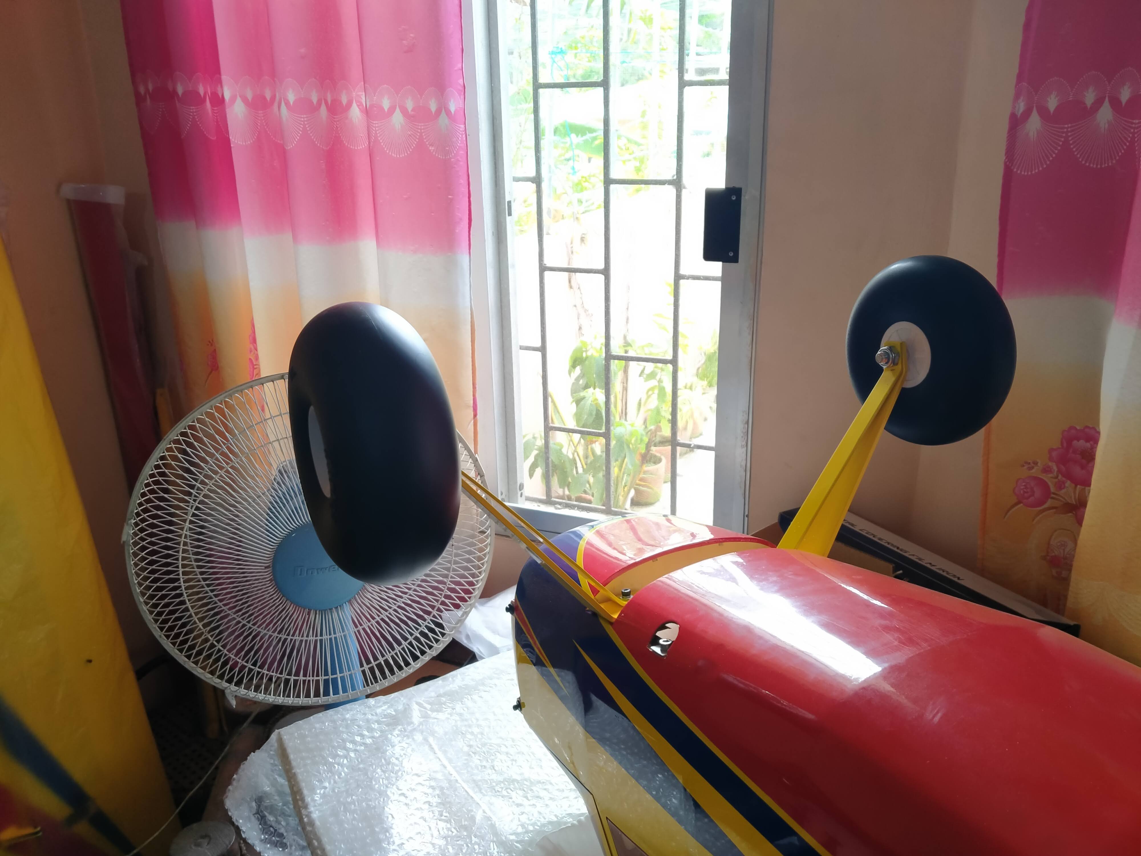

My home field is rough, so I'm erring on the side of caution with everything, plus the flying loads alone on struts. In addition Looking at the Ohio superstar 1/3 scale tailwheel as an option. already ordered Airtop wheels from Top model will be here in a day or two. (three days from France to Cebu City) Looking at gear and tying to decide if I want to bend the original before replacing
