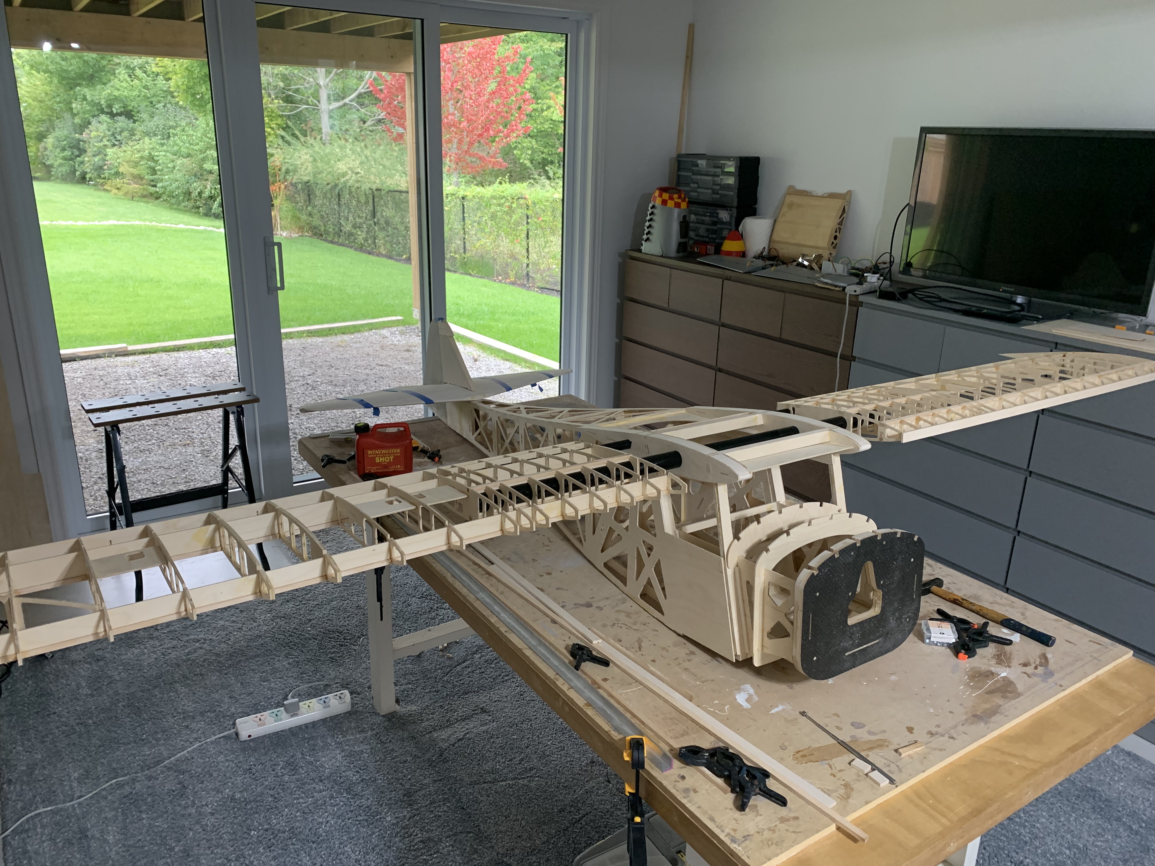

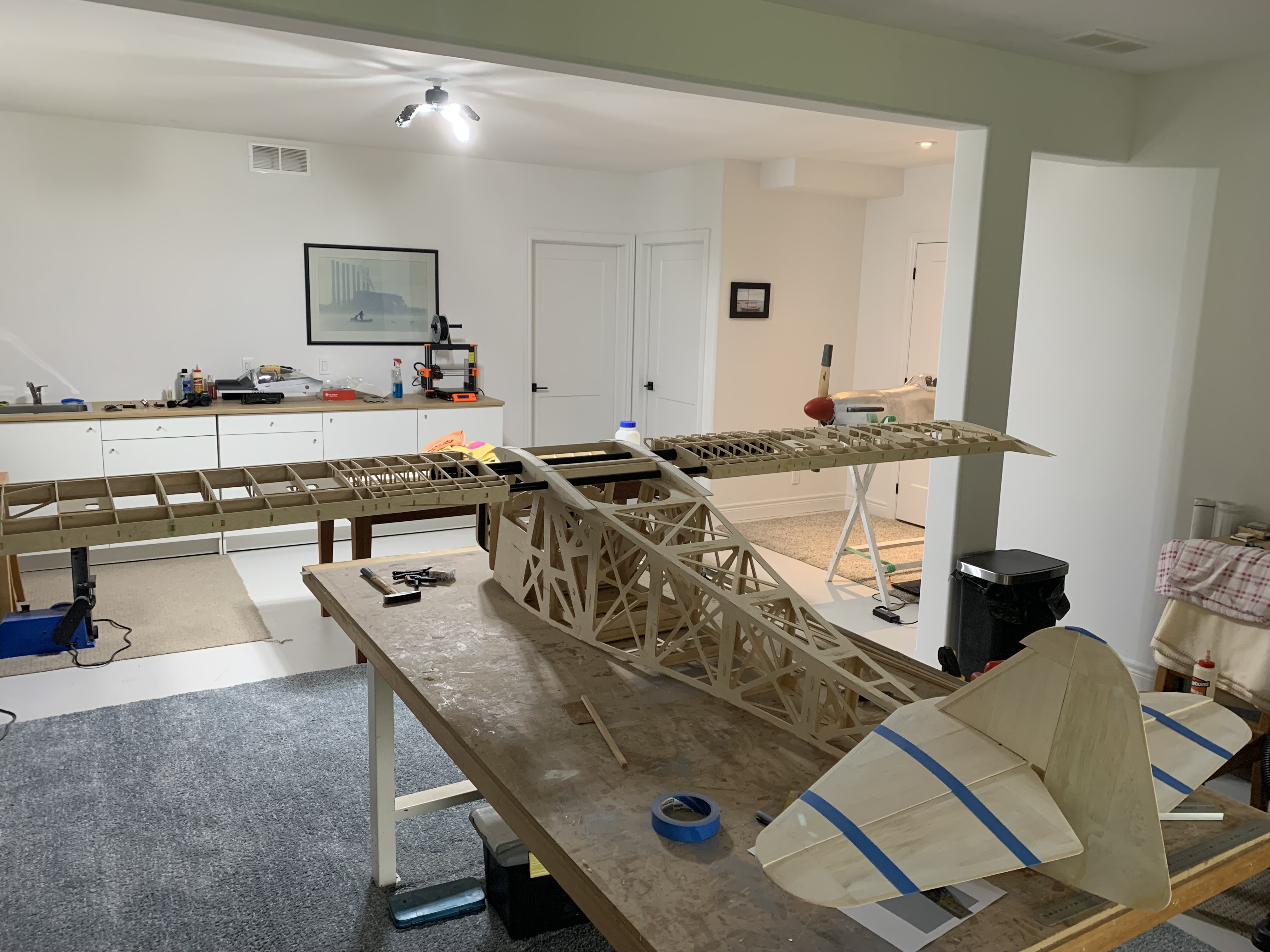

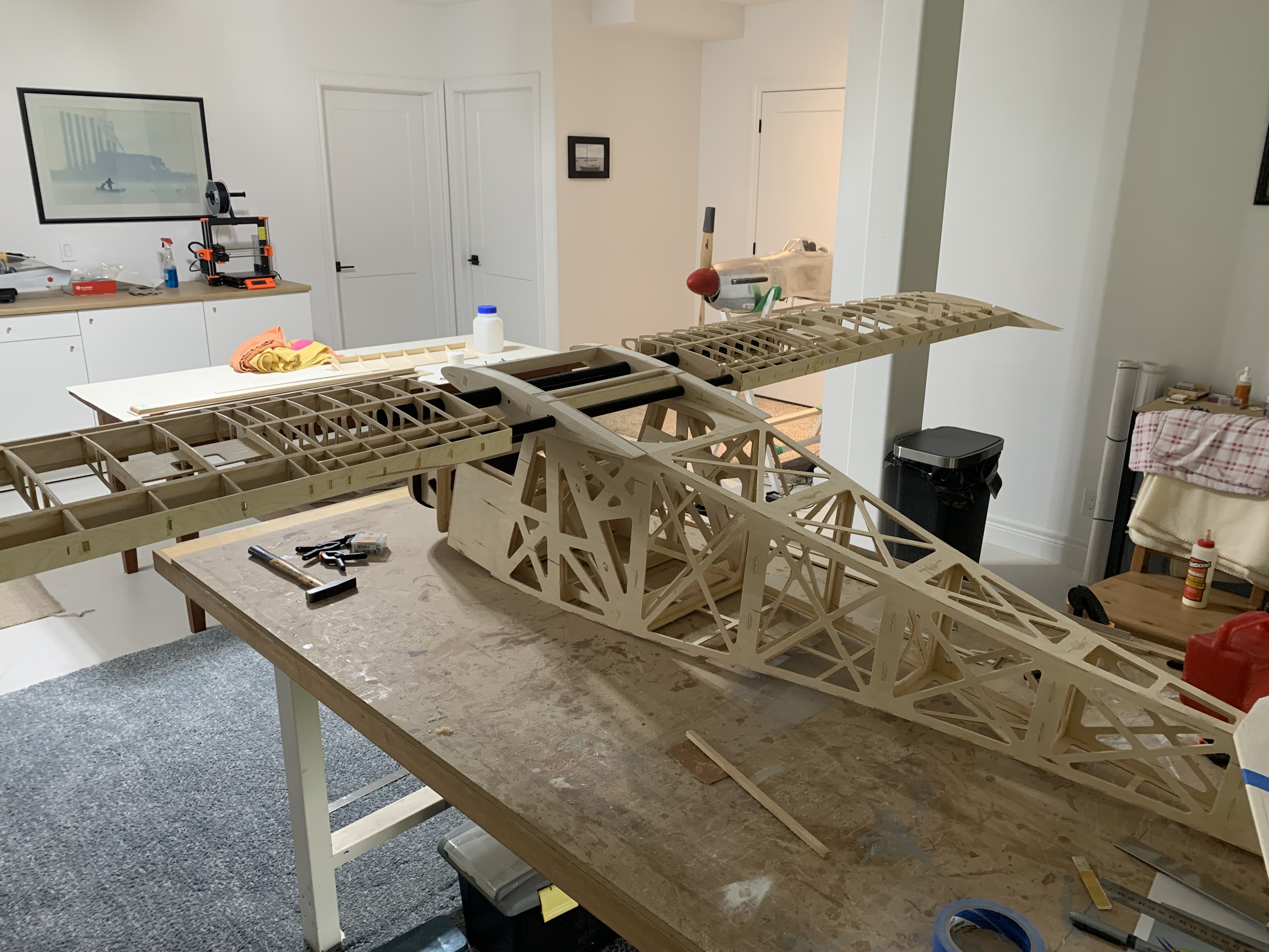

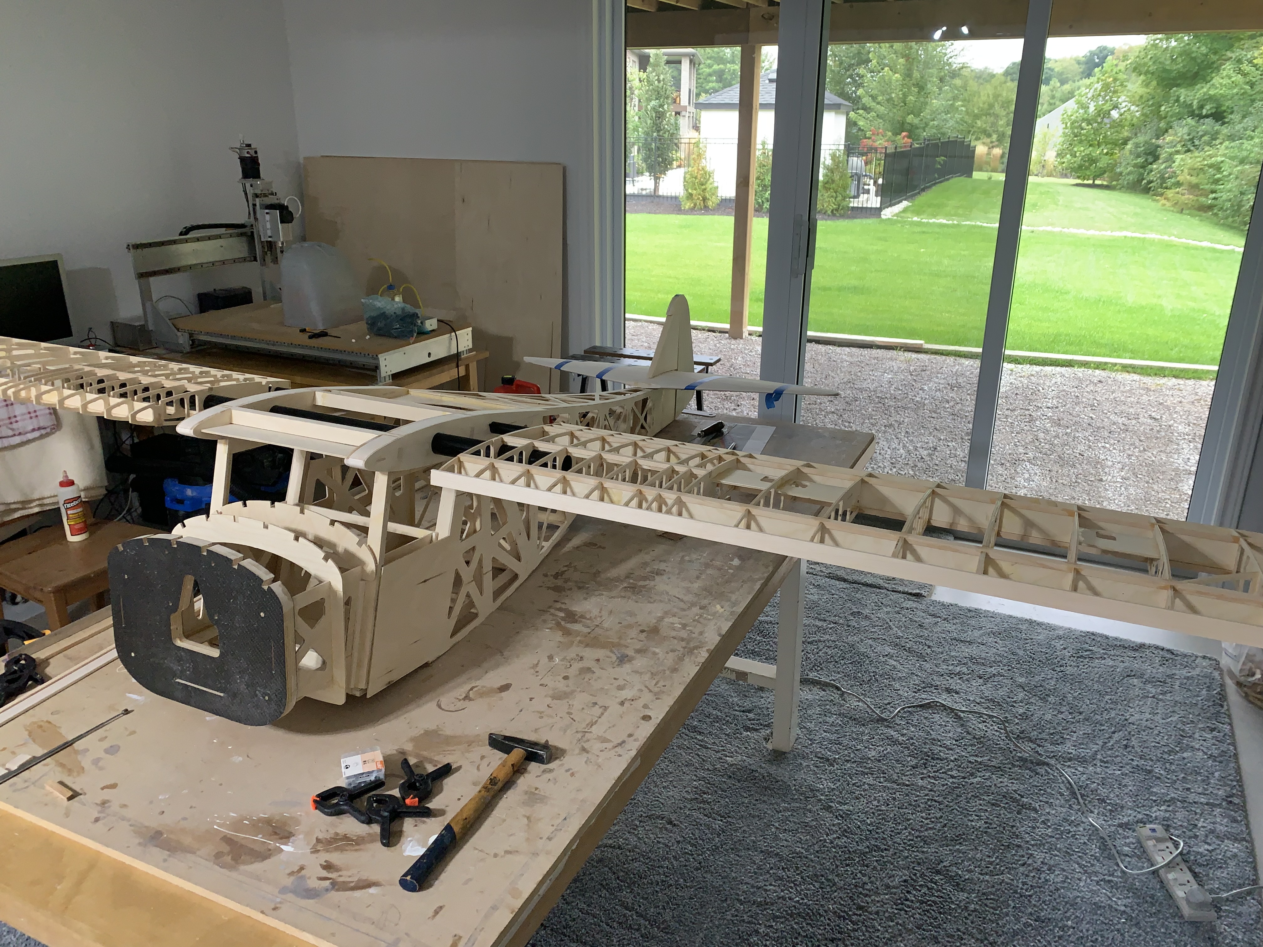

Well after days of gluing parts and making parts I am still not done. Got ribs standing up and in location and the basic structure on the table but nothing glued. Still making sure of how to assemble the hole wing without getting my self into trouble.
Doing a lot of splicing because the wing panel will over 48 in long so every piece that goes from one end to the other needs to be spliced. Will start planing the sheeting tomorrow another job I do not like is edge gluing sheeting but it to has to be done and that will be another job for tomorrow.

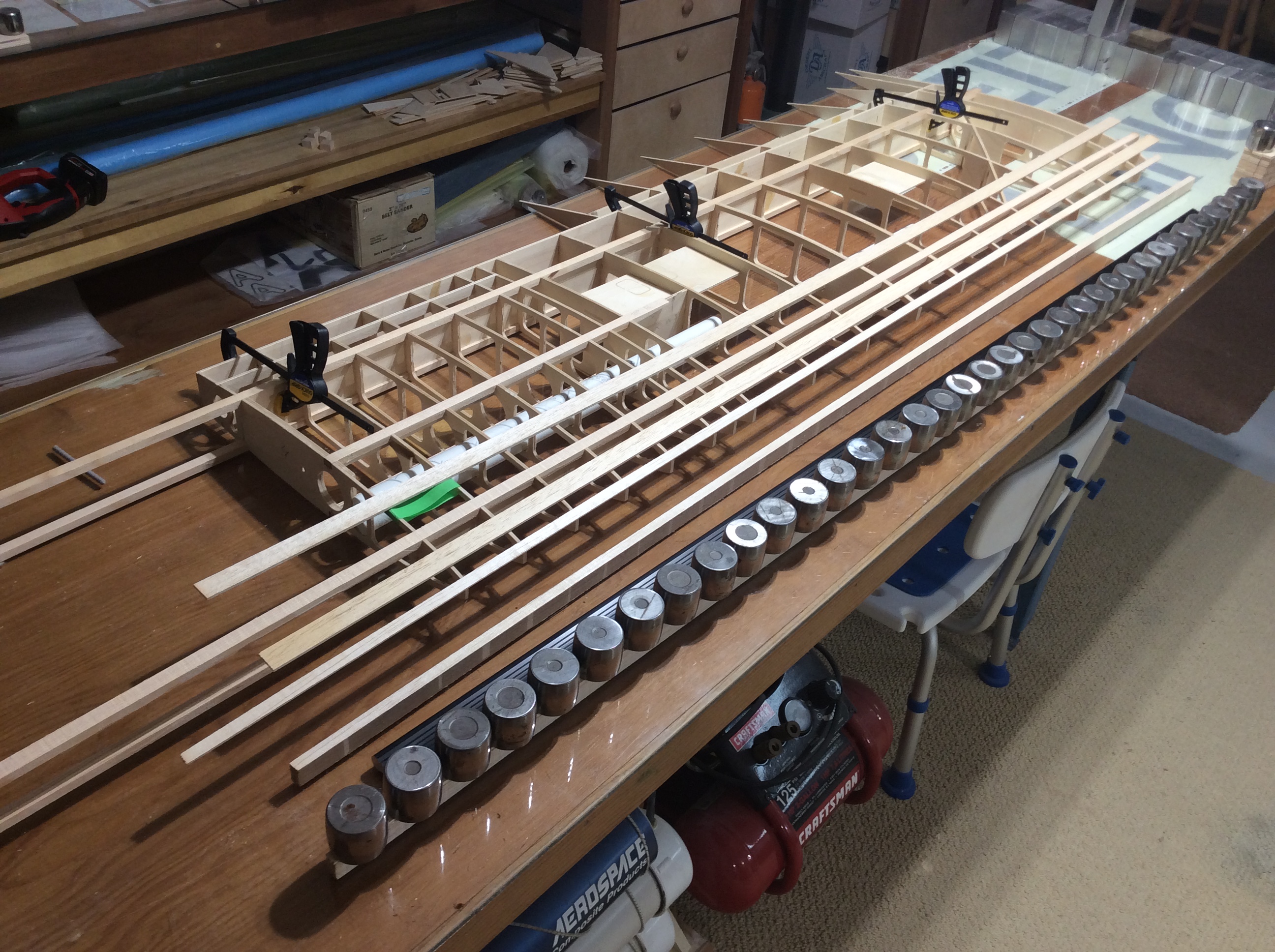

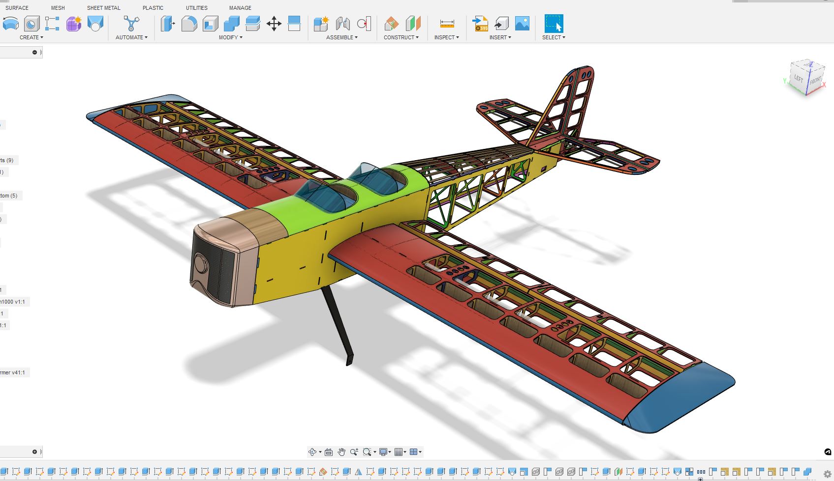

@heyluc Looks nice. Might I ask what design software you are using? Also just my opinion. Fuse and tail look great but to me the wing has way to many ribs in it. For reference I attached a picture of a design I have just finished up. Similar in size at 110" span. There are 10 ribs in each wing panel plus 2 half ribs in each that support the servo mounts.
Hi BalsaDust, I like the plane you are working on. It looks like a SpaceWalker II. Any more details? Luc
