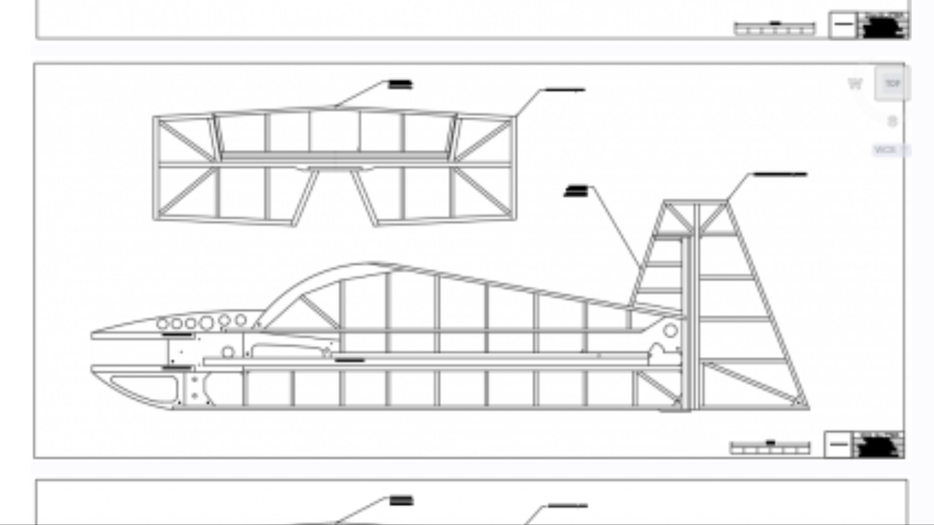

    Plans A vs B.
    Correct me if I’m wrong, A is a little more Rigid but just weighs a little more? What’s preferred?

    I’m not on my computer right now. This is the screen shot of the one in the first post that I would use if I’m building. I feel it will be more rigid with a slight wieght penelty but I don’t think it will be much.

    OK Thanks! That would be option "A" with the extra piece running parallel to the fuse tube.

    Not being argumentative but rather just voicing my opinion. I would think that is just another joint between the top and the tube so I would think B would be stronger. I would think using that extra balsa for diagonals between those ribs would be much stronger.

    It is very possible. I based A off of another profile in this size I once had that had that extra piece running the length of the fuse and it had no tail twist at all which is something a lot of profiles this size and up start to suffer from.
