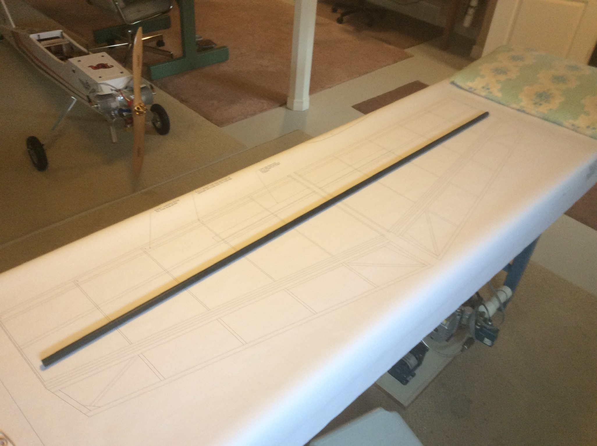

    Well got a start to the parts collection for the profile. One set of drawings and one 0.605 tube. And the drawings are perfectly to scale which is another plus.
    Alky6 and BalsaDust like this.
