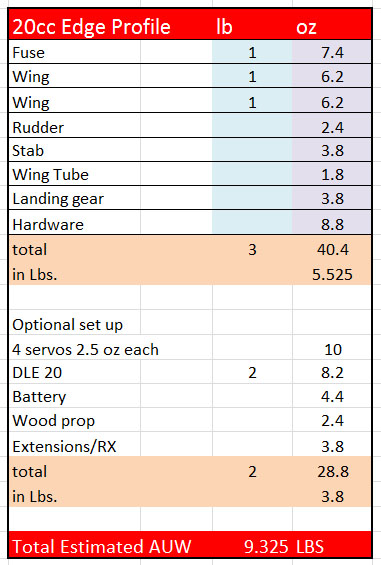

Found an old weight sheet of a 20cc profile. Will be interesting to see how we compare to some of the older designs. And discuss what we find to be correct and incorrect.
The only thing I can say is the present 20cc profile that I am repairing that I just put on a scale just the fuselage nothing on it no wheels , Tailwheel or anything, but it does include all the tail feathers . Now I did make the fuselage 4 inches longer at one time and the repair it now weighs 1 pound 10 Oz which is still almost 4 oz lighter than the spec sheet above, the spec sheet looks heavy to me by quite a dit, my plane is an 10 year old AW Pro260.
If this things comes out that heavy then you used crappy wood and way to much glue. I’m really hopeful that it will be 7-1/2 or less.
Have to agree with you. Built a 50cc plane and everything and it came out 12 lbs 3 oz.
Just weighed one wing and it was 13.75 oz and the chart is 1 lbs 6.2 oz which is more 8 oz heavier than the wing on the Pro260 that is a big difference for just one wing panel.
When our new plane is built and we come out 7 1/2 lbs or less I will be one happy person. Can just imagine how it will fly.
