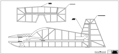

    Would you be so kind as to snap a photo of your fuselage reinforcements/Wing Tube support structure? Thanks!

    Hi Nick, ok cannot take a picture because all you will see is the covering. I do know if I built another one what I would do. I can give you a description if you like let me know.

    Ok the balsa block that supports the wing in the fuselage I would use bass wood with a lot of lightning holes cut into it at the appropriate locations.
    Also cut two root ribs from light plywood with the appropriate amount of lighting holes. Glue them to either side of the fuselage. This gives the wings something to work against and also an extra 3/16 of an inch to the width of the fuselage to support the wing tube.
