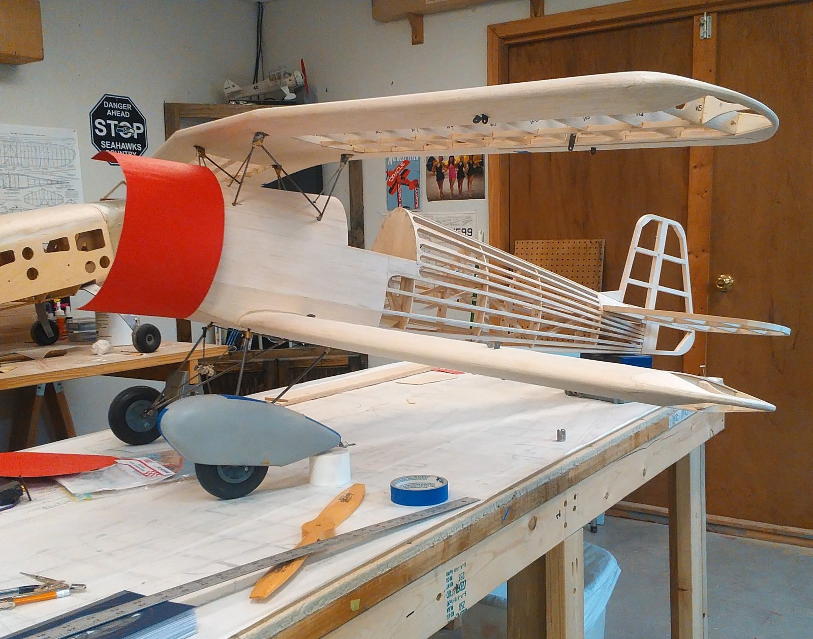

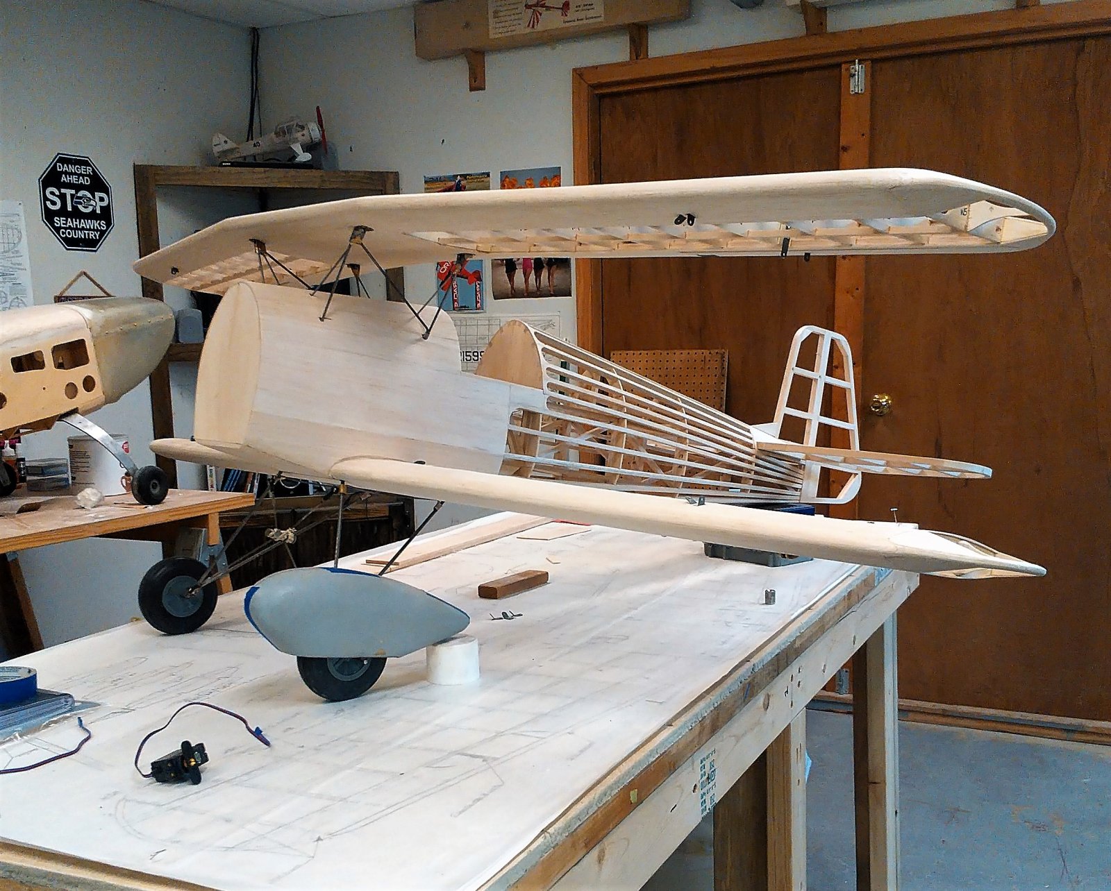

I stole a hour and played with the Krier this evening. Even though I still have to put caps on the top wing I pinned it all together with the intention of starting to make the "N" struts but got sidetracked lol. Sitting on my tookus and eyeballing it I decided to play around with a cowling mock up.
Still occasionally just have to eyeball it and do some "planning"..... AKA Daydream.
My really quick, fast, ugly and does not look anything like what the finished product will look like or I'll tear it all apart and start over cowling mock up ;)

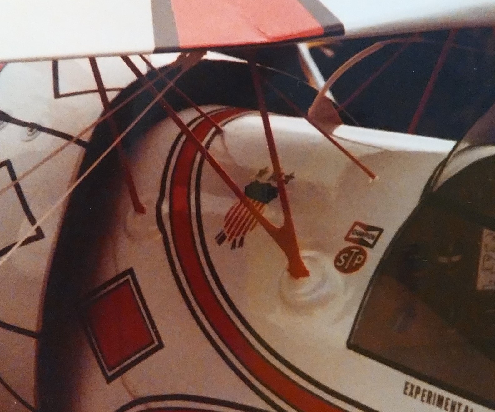

At the top of post 255 I don't see a tab for the rear flying wire, does it mount differently? Just haven't gotten around to mounting it or what. Really nice clean work on this.
